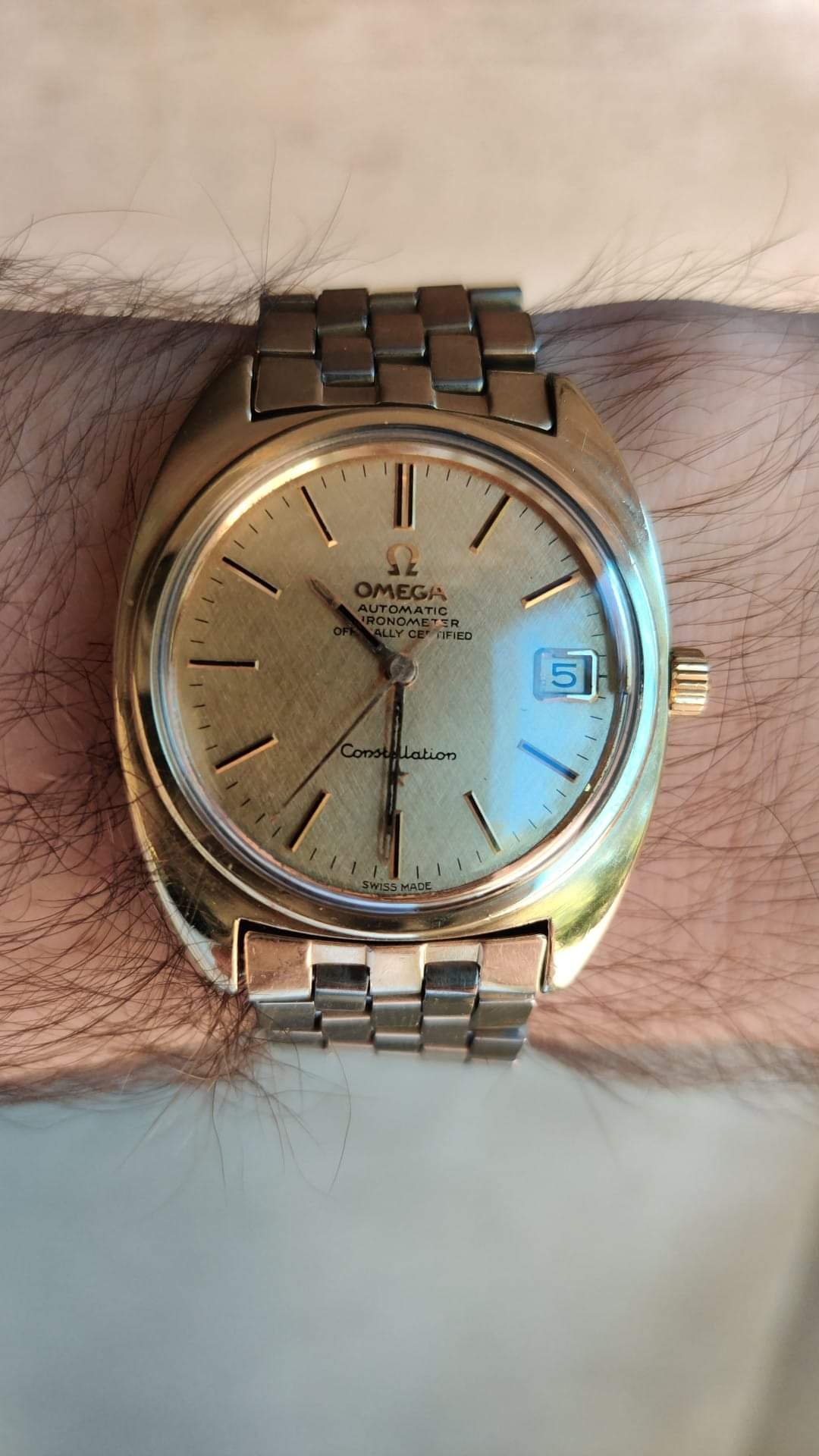

Hi Omega lovers! I have recently bought this beautiful watch that unfortunately doesn't have an original crystal. I am looking for an original one, but I can't find any information on the internet about the name/code/refference on it. If anyone would be kind to let me know that, I would kindly appreciate it! Thank you everybody in advance!

It's a PX5022
Be careful though, most "NOS" crystals are defective / hard to press
You can just buy an ATGR 296 crystal from Cousions and it's so easy that you can press it with hand

Thank you very much! By ATGR 296 you mean
Ø29.6mm (5.20mm) Steel Ring right?

Thank you very much! By the way, I am a big fan of yours. Wonderful collection you have over there!

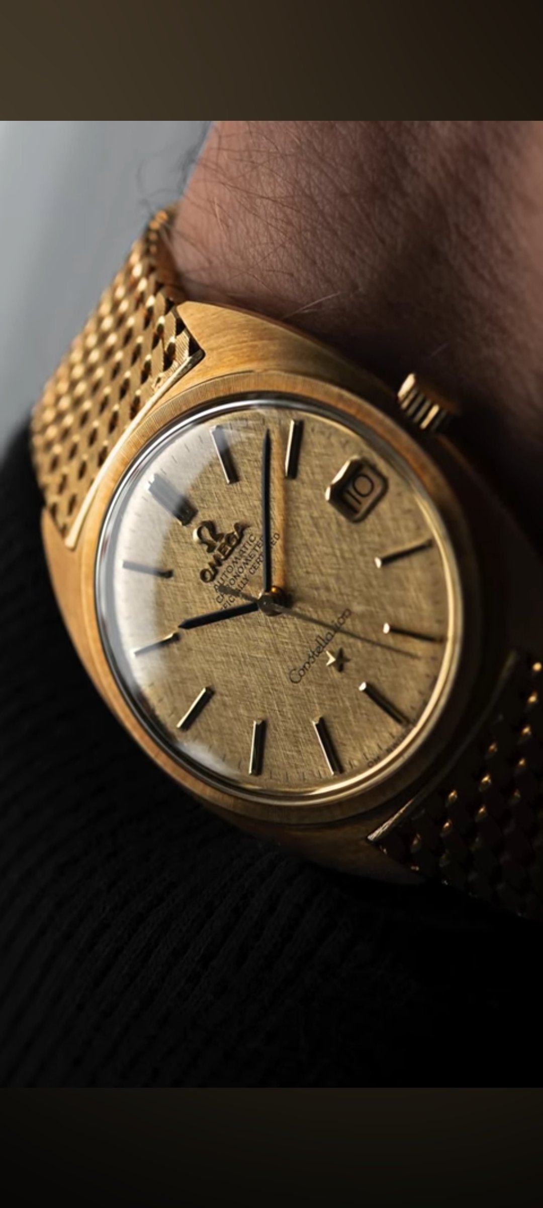

I am also looking for black hands for this dial and original crown. I know it's so hard to find 8.5-9mm/12.5-13mm black hands but if you have any idea where to look for that I'd also appreciate that a lot.
Also, what crown should I buy for this one? If you can recommend that too, I would greatly appreciate it.

Thank you!
This is the crown, and from a good batch at that, it's the thin version of the crown: https://www.ebay.com/itm/Omega-Wate...pid=5338899135&customid=&toolid=10001&mkevt=1
As far as the hands go, you are out of luck sadly, no baton set on eBay currently
I don't normally sell C-Case compatible hands as they are hard to find, but if you're in a rush I can consider selling a set, it just won't be a logical price though as a warning

If you have these hands, I'd definitely consider it 😀
Let me know your price in a private message
