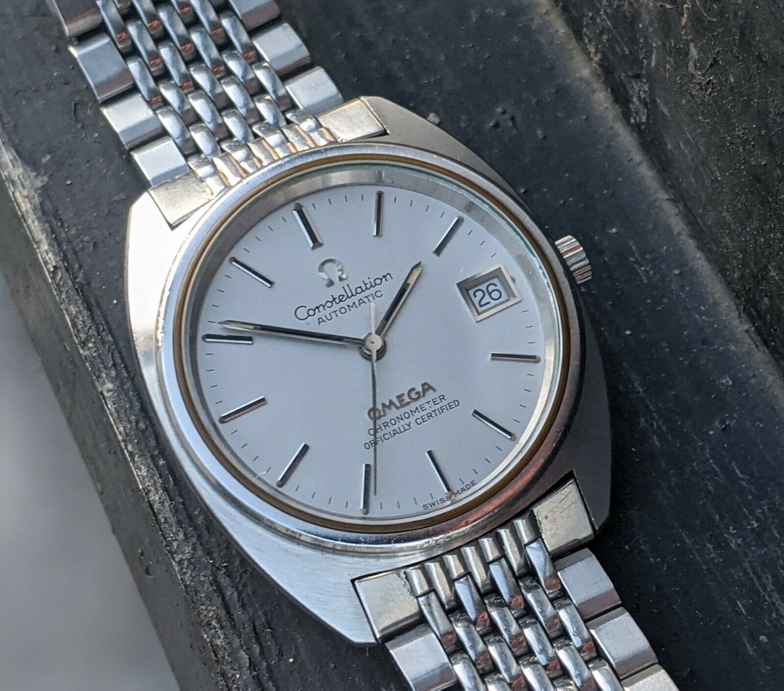

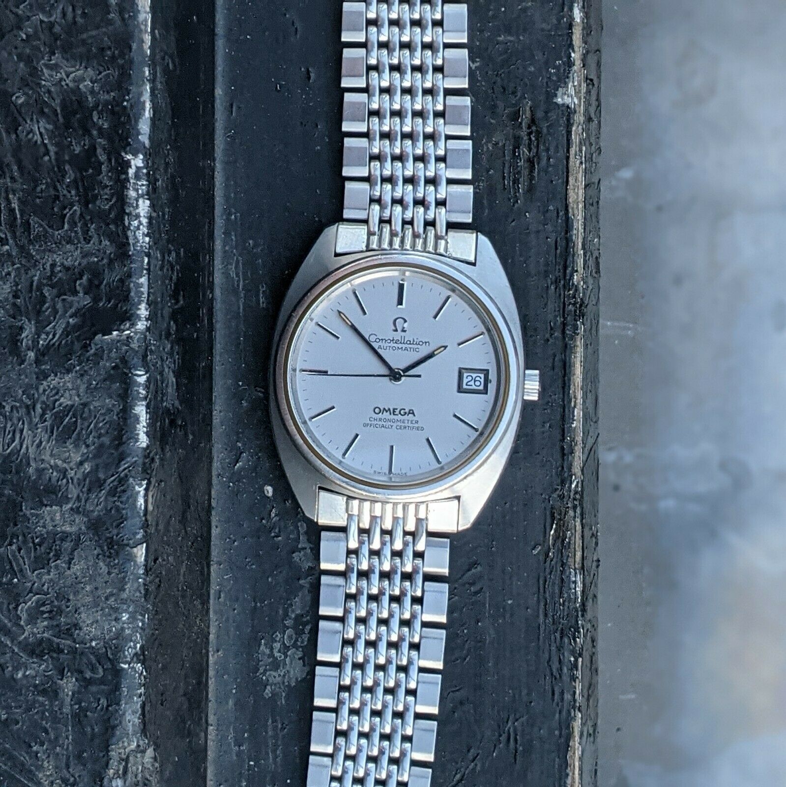

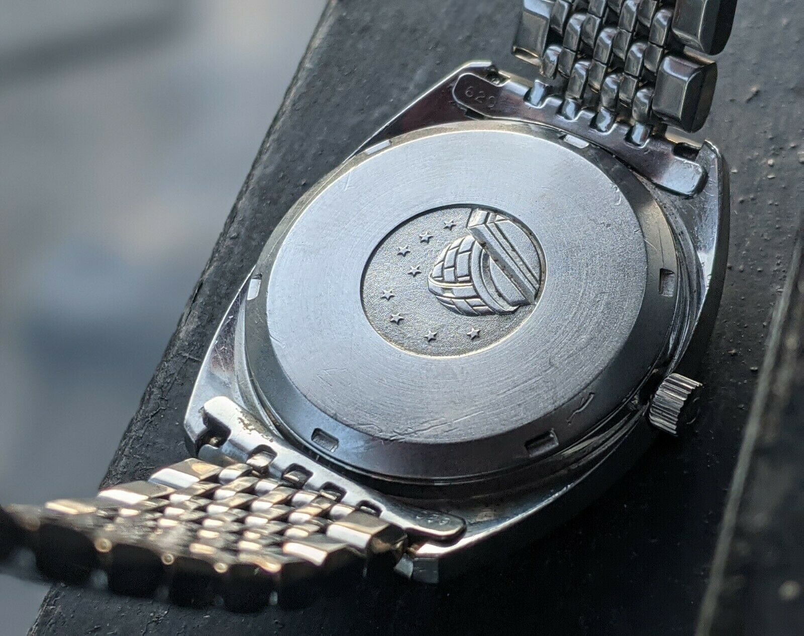

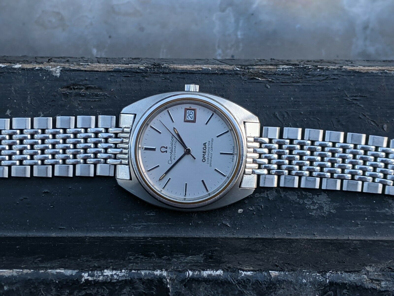

Just curious if the facets of this Connie checks out. It looks very mint. Been trying to compare to images available on the forum and on the web and I can't seem to find one with this variation of bracelet - is it original?
As always, I appreciate your time in advance.

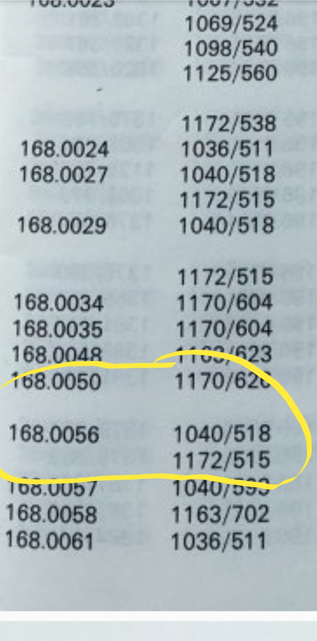

Looks like a nice example of a 1970s Connie, with a 10xx calibre inside - maybe a 168.0056. I can’t comment on the bracelet's authenticity with this model. I know that a brick style bracelet was an option on earlier Connies and that many were shipped with leather straps. This beads of rice bracelet looks nice, though!
EDIT - sorry, just saw you’d already posted the reference in the title... ::facepalm1::

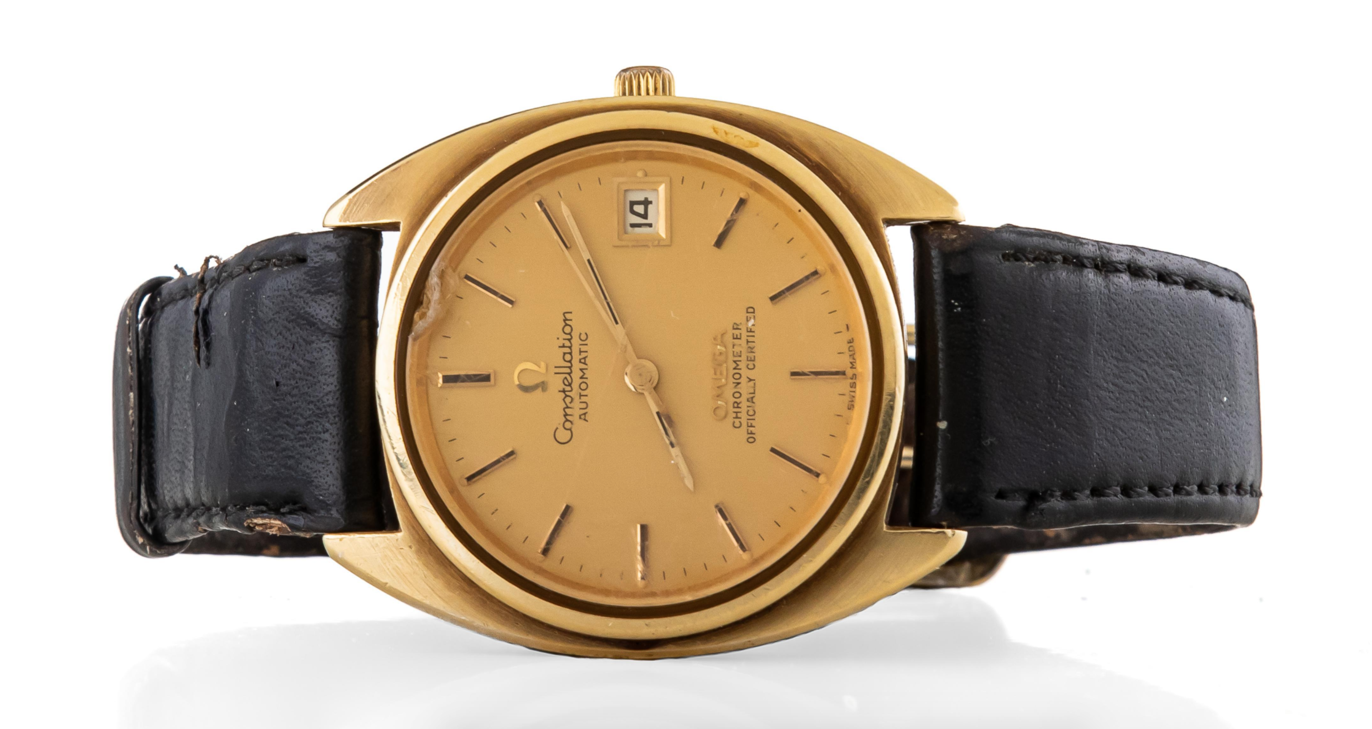

You don´t happen to know where to find a correct crystal for these? Unfortunately mine looks like this (pic from the auction house):

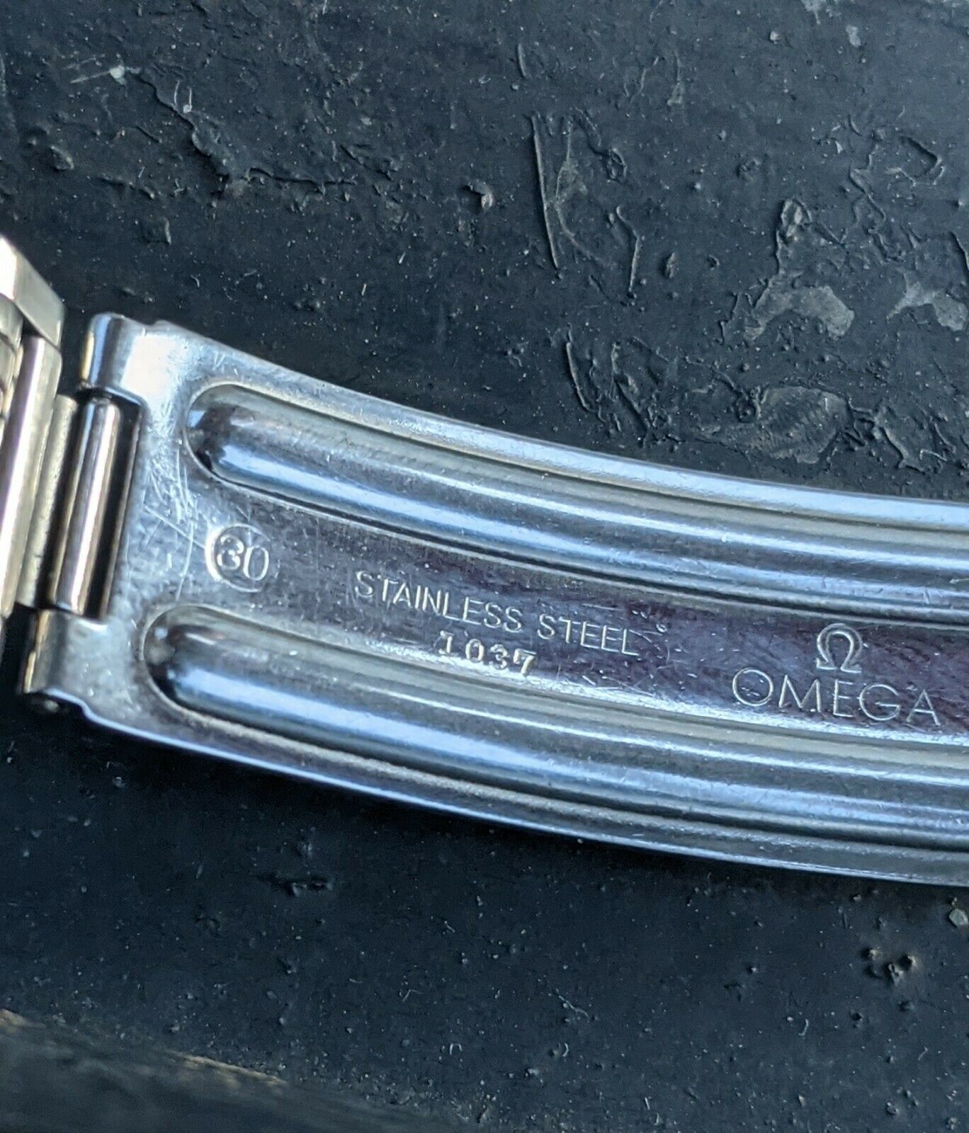

Cheers Shabbaz, just to confirm it does not appear to be an original bracelet for the Connie right? The bracelet in the picture being a 1037.
Incidentally, where have you sourced your above image? Tremendously useful.
Thanks for your post mate.
You can ask @Archer. I get mine from a watchmaker in the Netherlands with a Omega account.

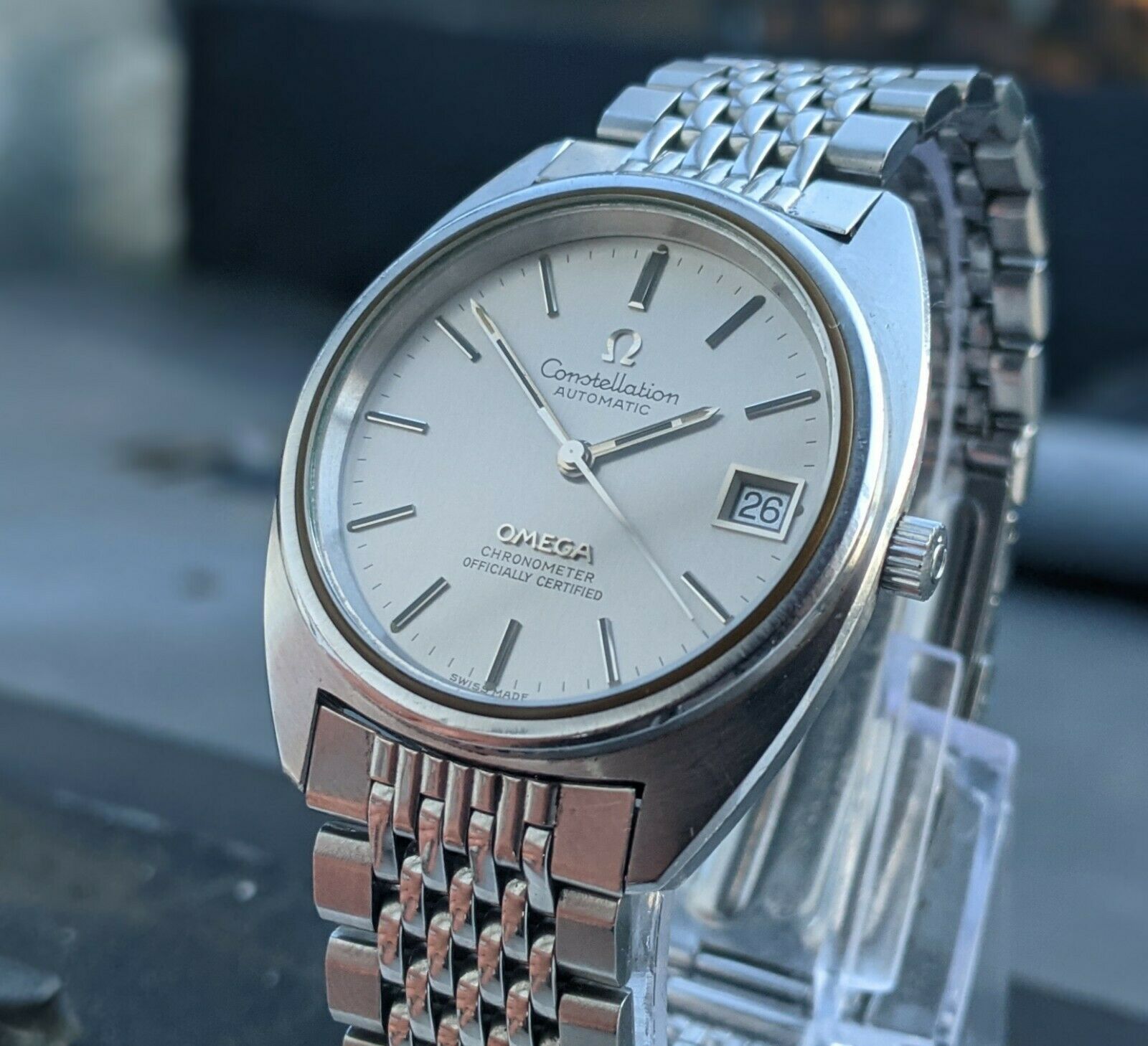

Edges look sharp- nice one!
