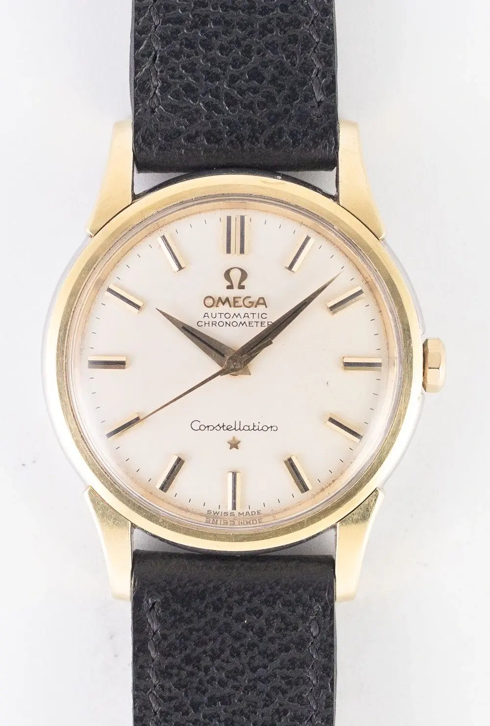

If a watch of this reference were to be for sale on this forum, and given that I live in France, do you know whether shipping would be complicated?
A good amount of users here is based in EU, so a european deal is possible.

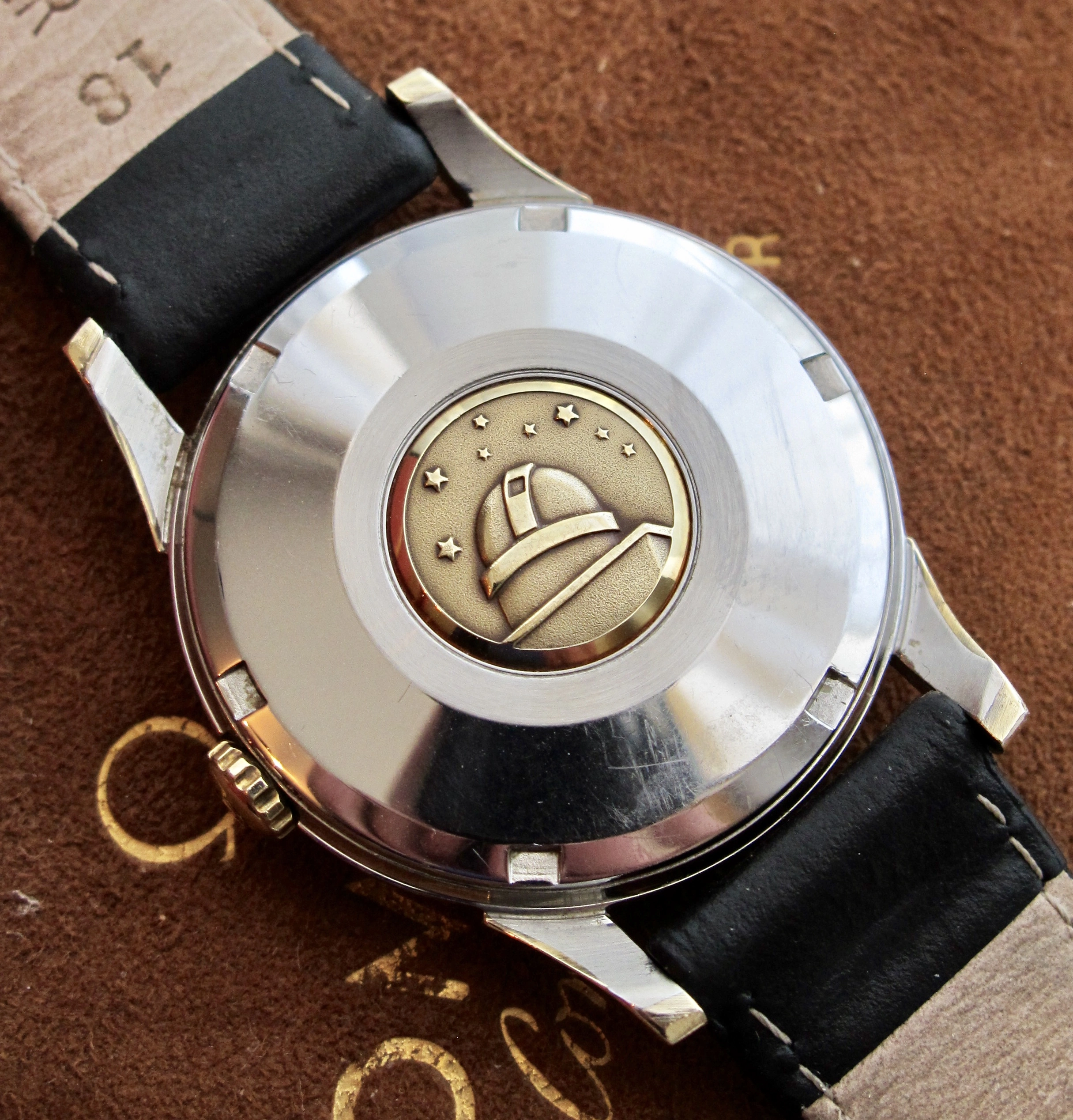

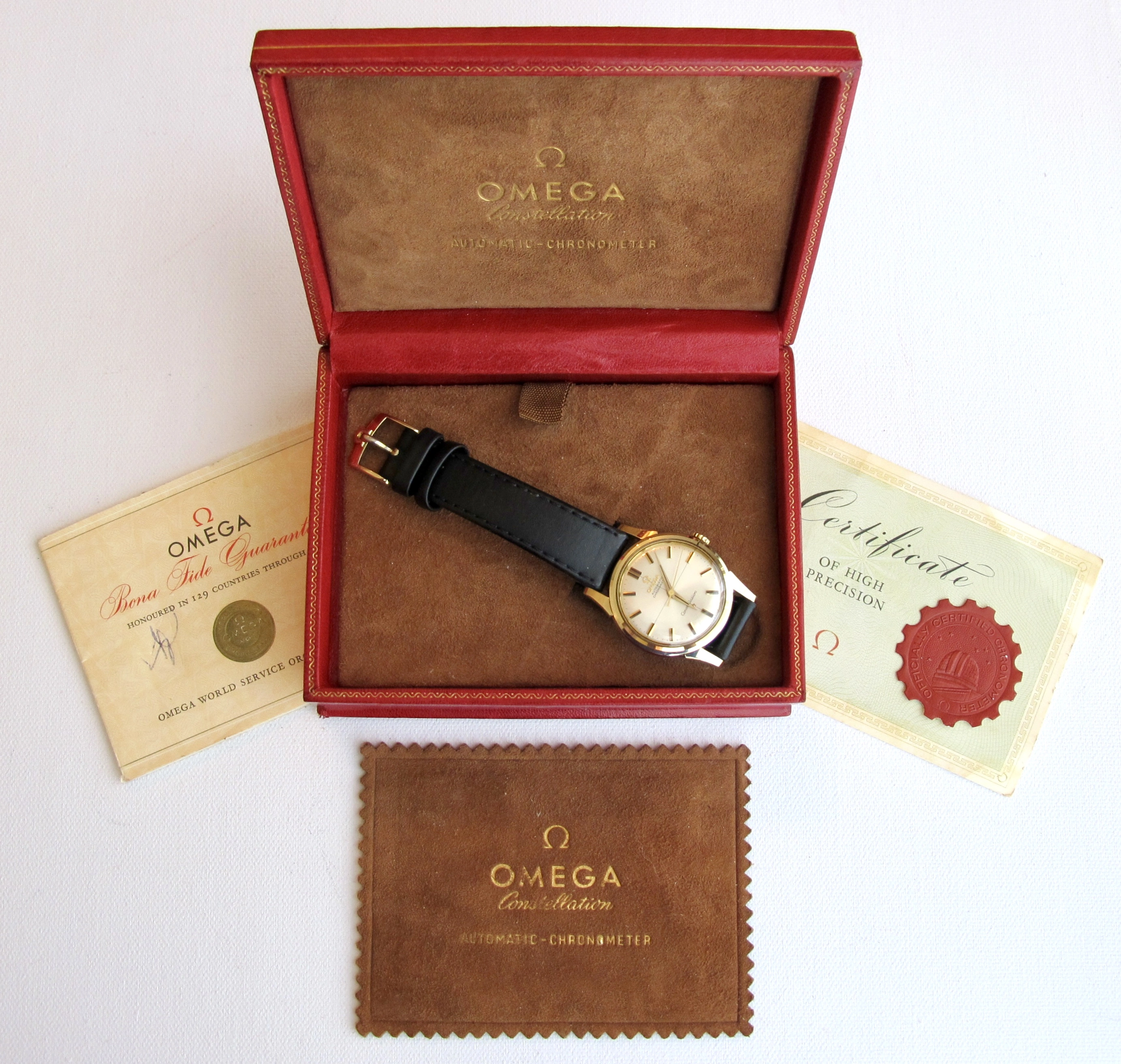

Yes, I listened carefully and therefore declined the offer. As mentioned previously, I have no problem waiting. This is exactly what I am looking for. I originally imagined it with a date, but without one I find it just as beautiful, if not even more charming. With the box and papers, it would be perfect. In your opinion, what budget should be expected?

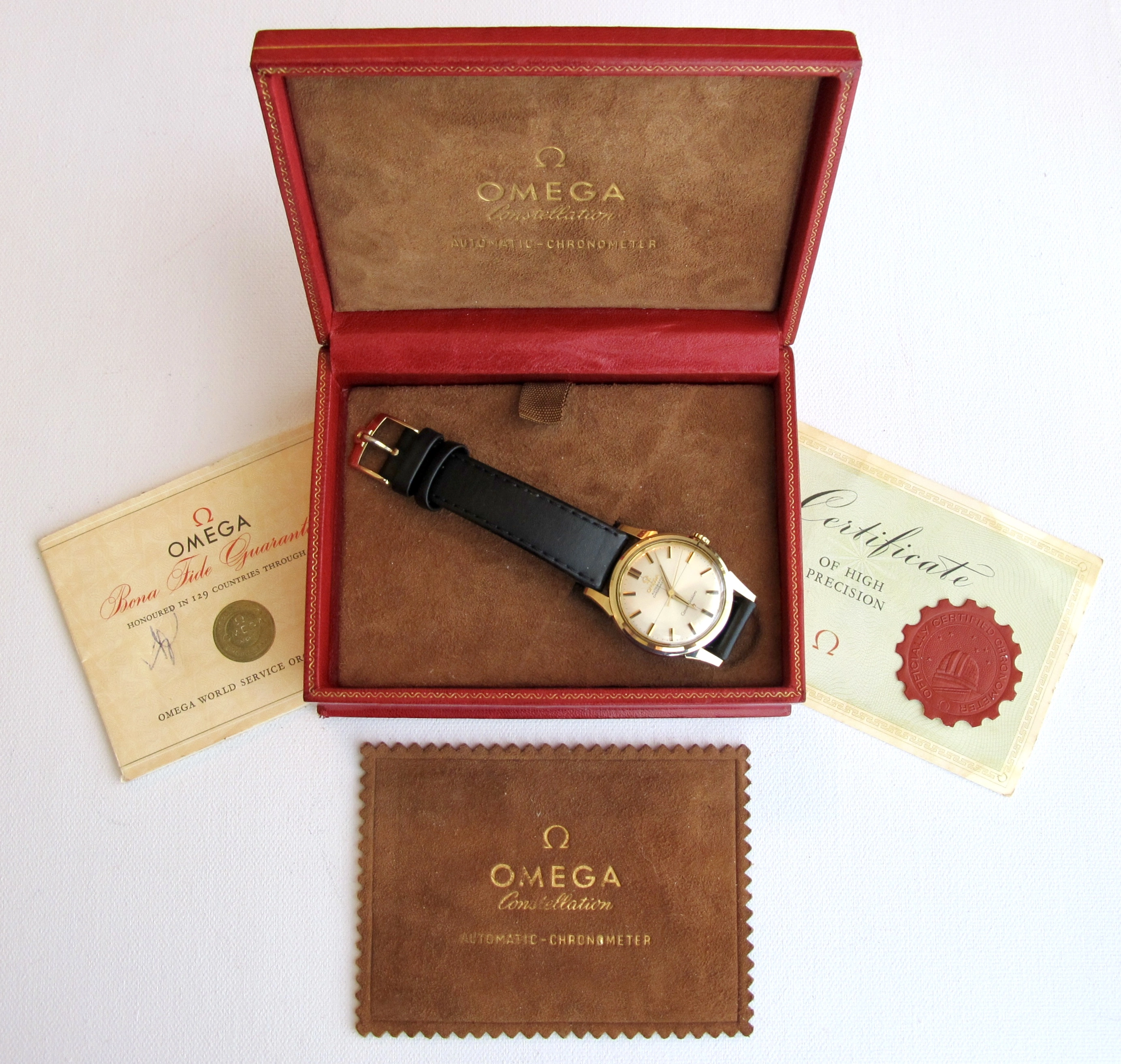

Hi @Mel57. I believe an example as nice as this (which I was very lucky to get) would now sell between collectors for about USD 1800. A watch dealer would charge quite a lot more, maybe 30%. Other OF members might have different ideas but I am confident that I am on the low side.
The case is almost pristine and the original box is superb.
Thank you, that’s a superb example you have there, truly beautiful! It’s exactly what i’m looking for.
If anyone from the forum happens to come across this and would like to sell a watch like yours, that would be perfect.
Due to the exceptional condition and having the original box and papers makes this watch quite special and I agree that it would definitely command a significant premium over similar watches.

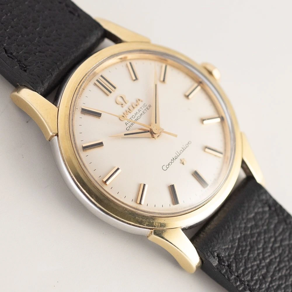

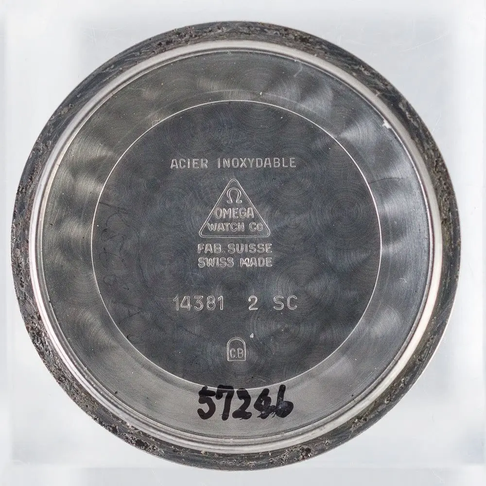

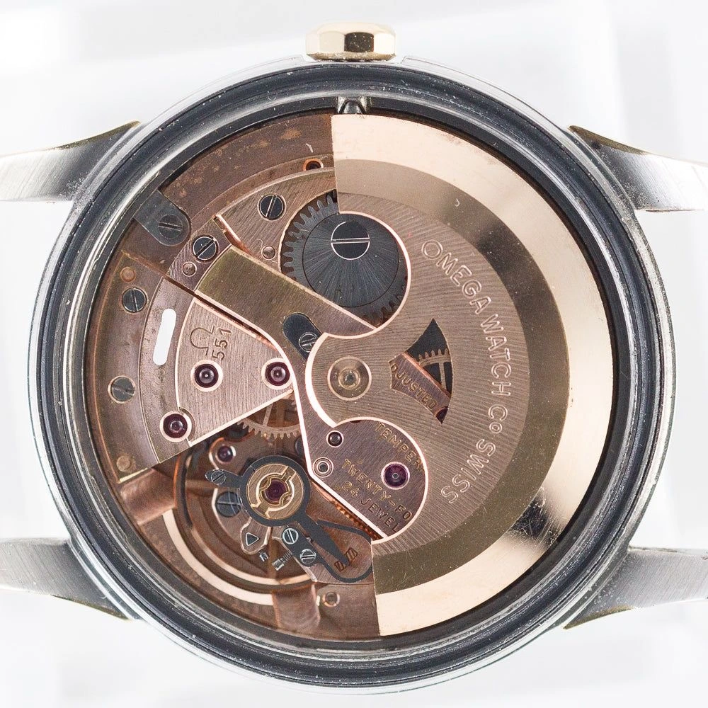

Hello,
I have received another offer: Omega constellation ref 14381, from 1959 from, caliber 551.
The watch will be serviced and cleaned, with light polishing available if i wish. The crystal is signes, and the crown is believed to be original.
He will also source an original Omega buckle.
The price is 2200€.
I would appreciate your opinion, please. Thank you very much!

I would say that is a much nicer watch.
It doesn’t have the crosshairs but it does have onyx inserts.
The price is still high - but if the watch will be properly serviced this would save you a few hundred Euro.
However, if it’s a watch you like then the money will be quickly forgotten.
Personally, I would say “no polishing” but that would be up to you.

Looks like a winner. Very nice condition and no date ref is preferable.
With service buckle etc price is reasonable for a special purchase. And if local dealer don’t have to worry about shipping customs etc.

Yes, in much better condition and completely original, i really like it.
Indeed, the absence of a date gives the dial a beautiful harmony and symmetry. I think I might give in.
And you’re right, polishing is not necessary.
