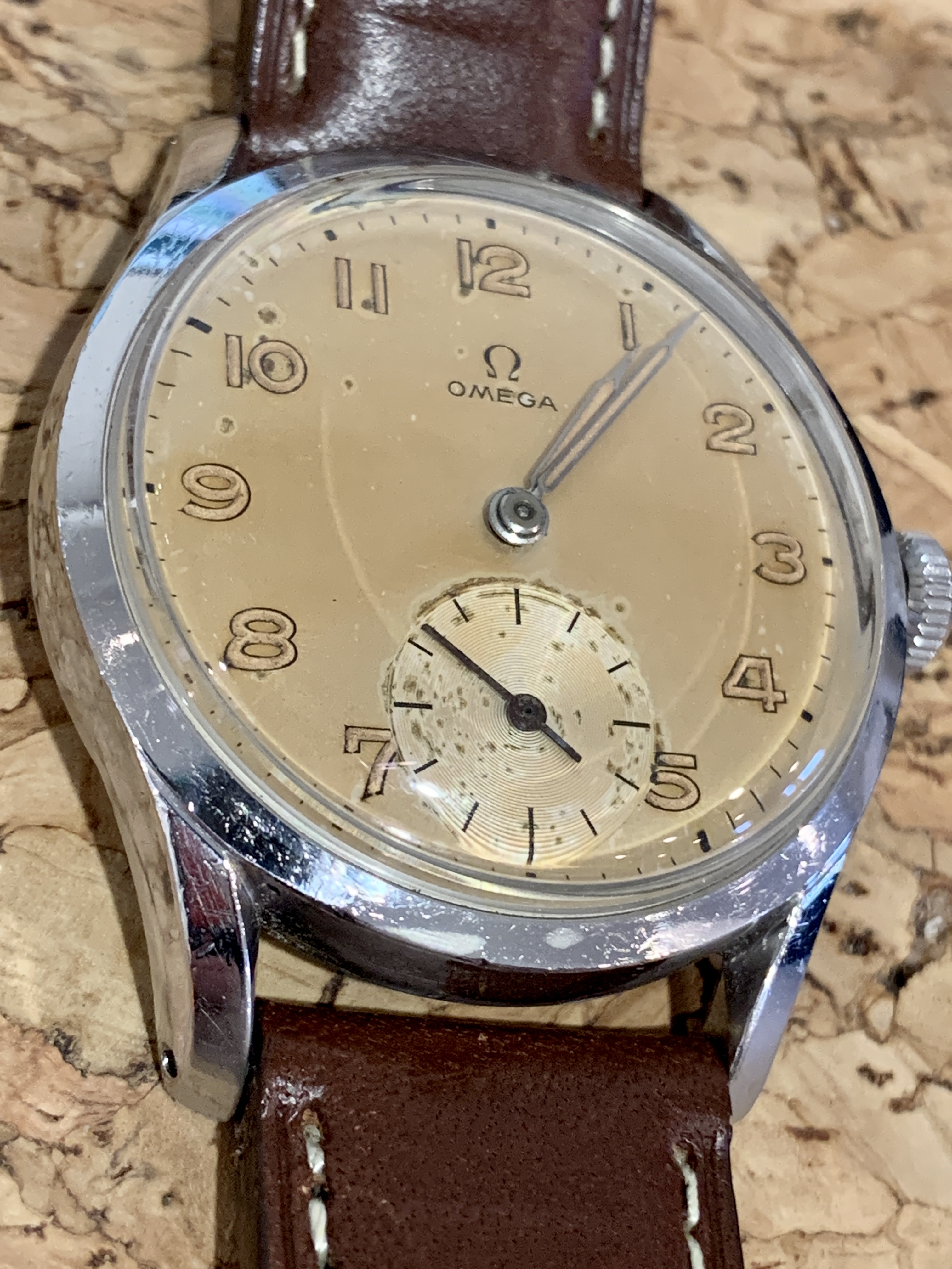

How about posting some photos of your watch, we'd love to see it, we thrive on pictures here.

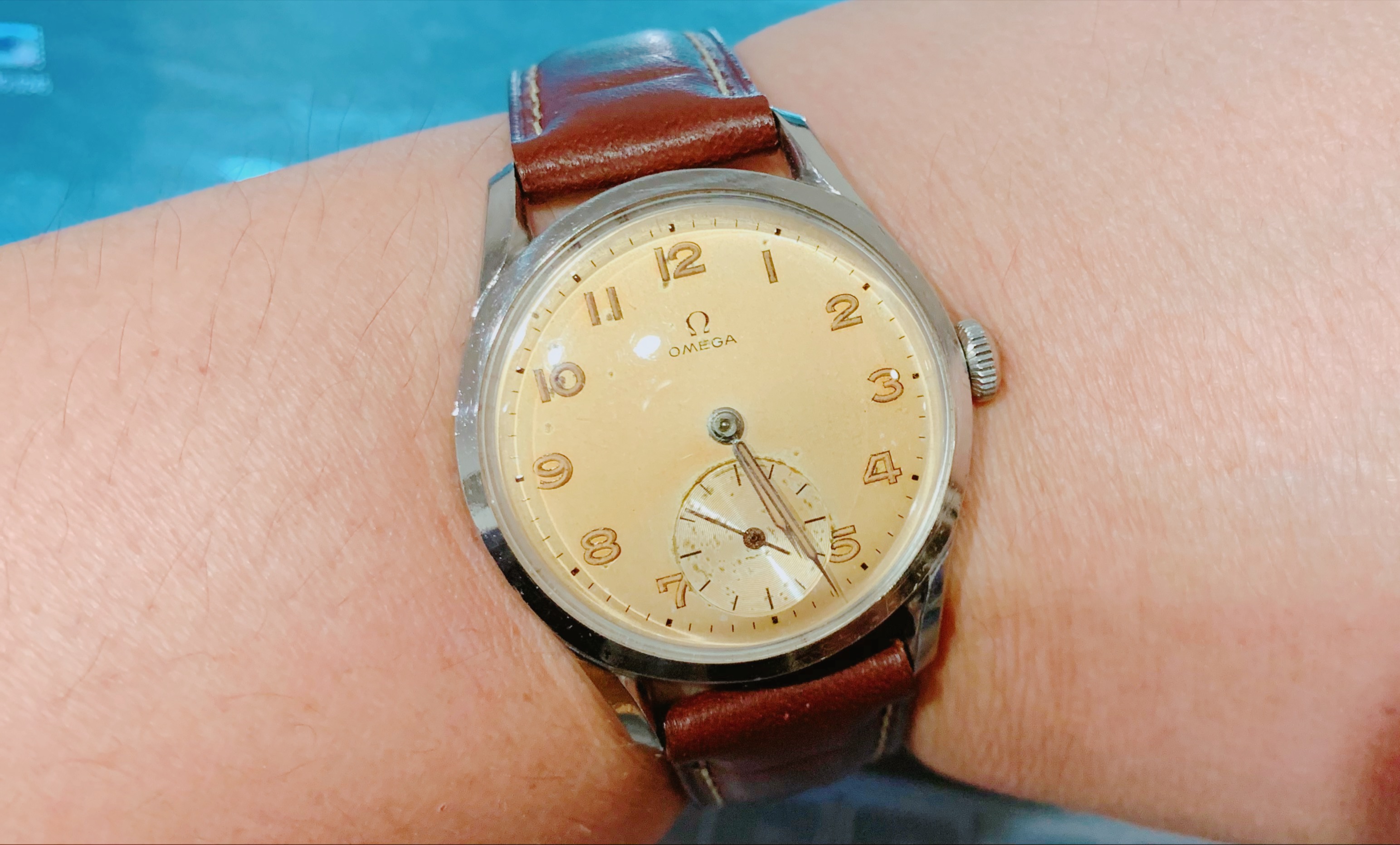

Thank you both! Open to any comments or suggestions on the watch.
Here are two photos. Happy to post more photos upon request.

If you plan to wear and use the watch, then have the movement serviced. A watchmaker will tell you what is needed once the movement is disassembled and inspected.
Personally that's all I'd do. But if you want to replace or restore other parts, that's your choice because it's your watch.
The dial is damaged, but there's not much to be done about it except perhaps hunting down a correct replacement and matching hands. Not worth the trouble IMO.
The case has already been polished, but it's tolerable. I wouldn't make it worse with more polishing.

The dial itself - What are the obvious signs it is damaged?
There is visible deterioration all over the dial, especially around the subdial, the numerals 10 and 11, etc.

What would cause this deterioration and how would one have prevented this? While doing some homework, I read somewhere (I forget where - apologies) this is Radium burn? Not sure if true or if I have been misinformed.

It's just a guess, but it is probably water damage.
Radium burn tends to occur when radium-filled hands are left in one position for a long time. You would see a burn pattern roughly in the shape of the hand lume. I imagine it can also occur around the numerals.
Your numerals look to be radium, so I wouldn't be opening the case and sniffing around in there.
