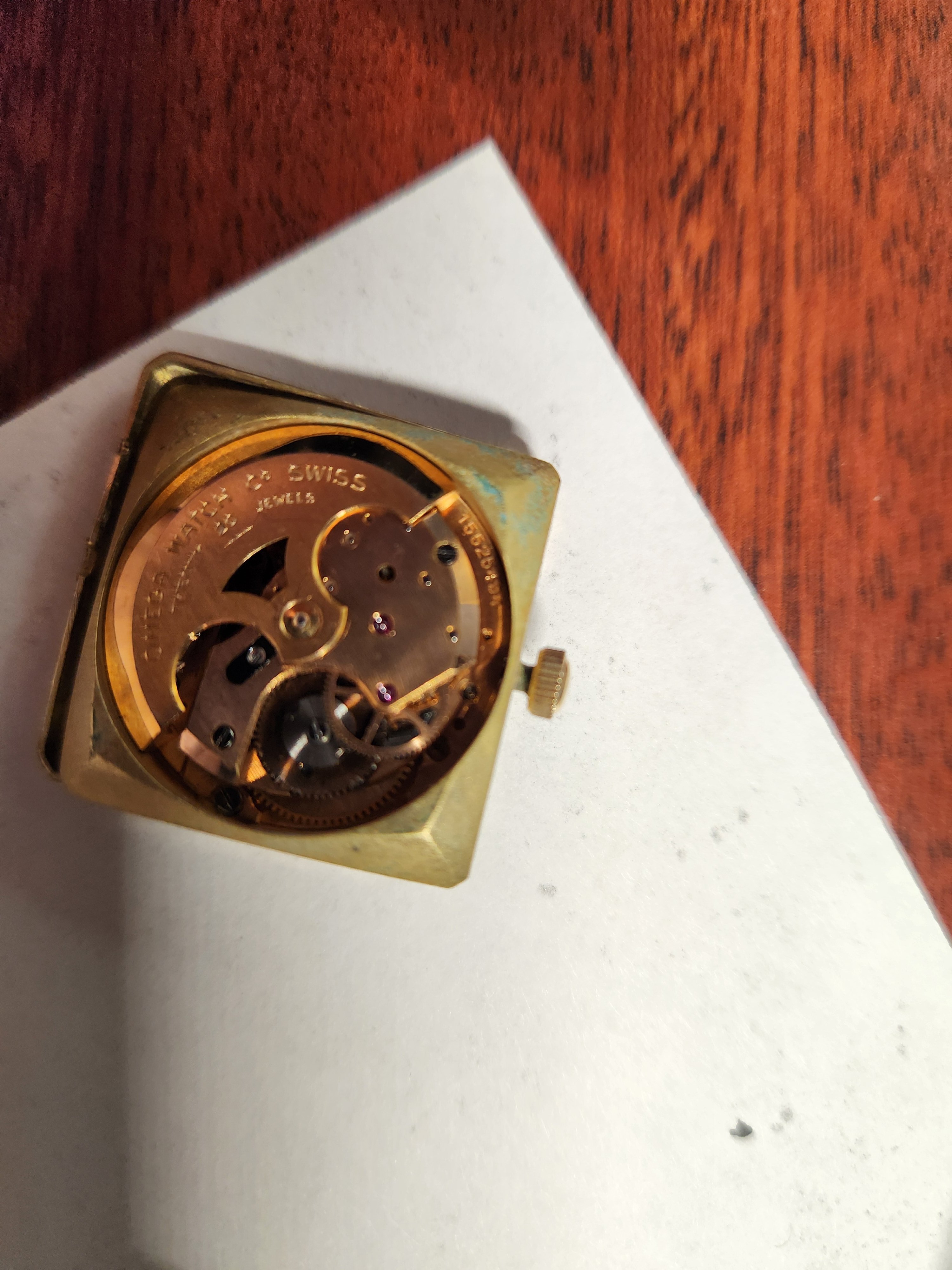

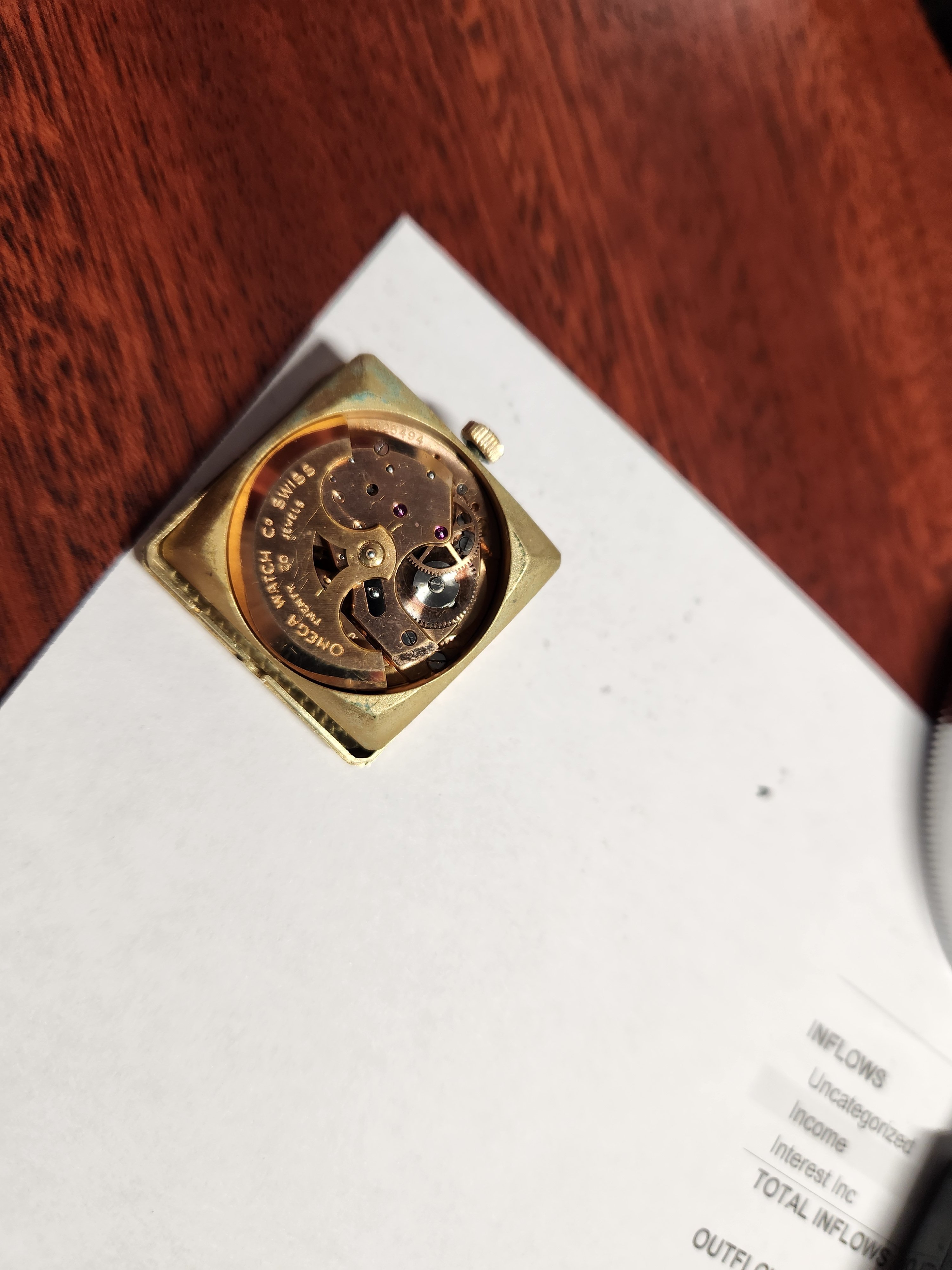

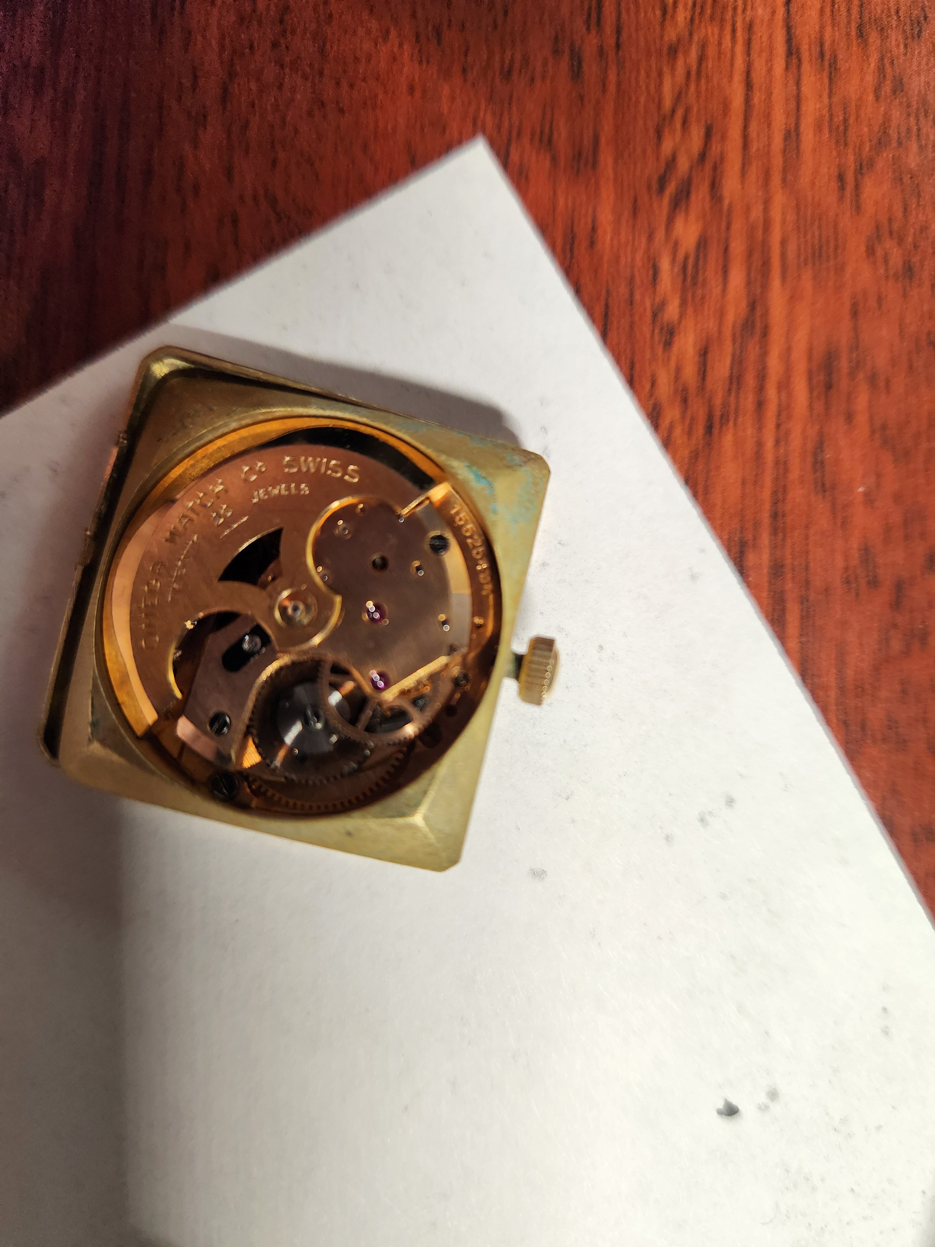

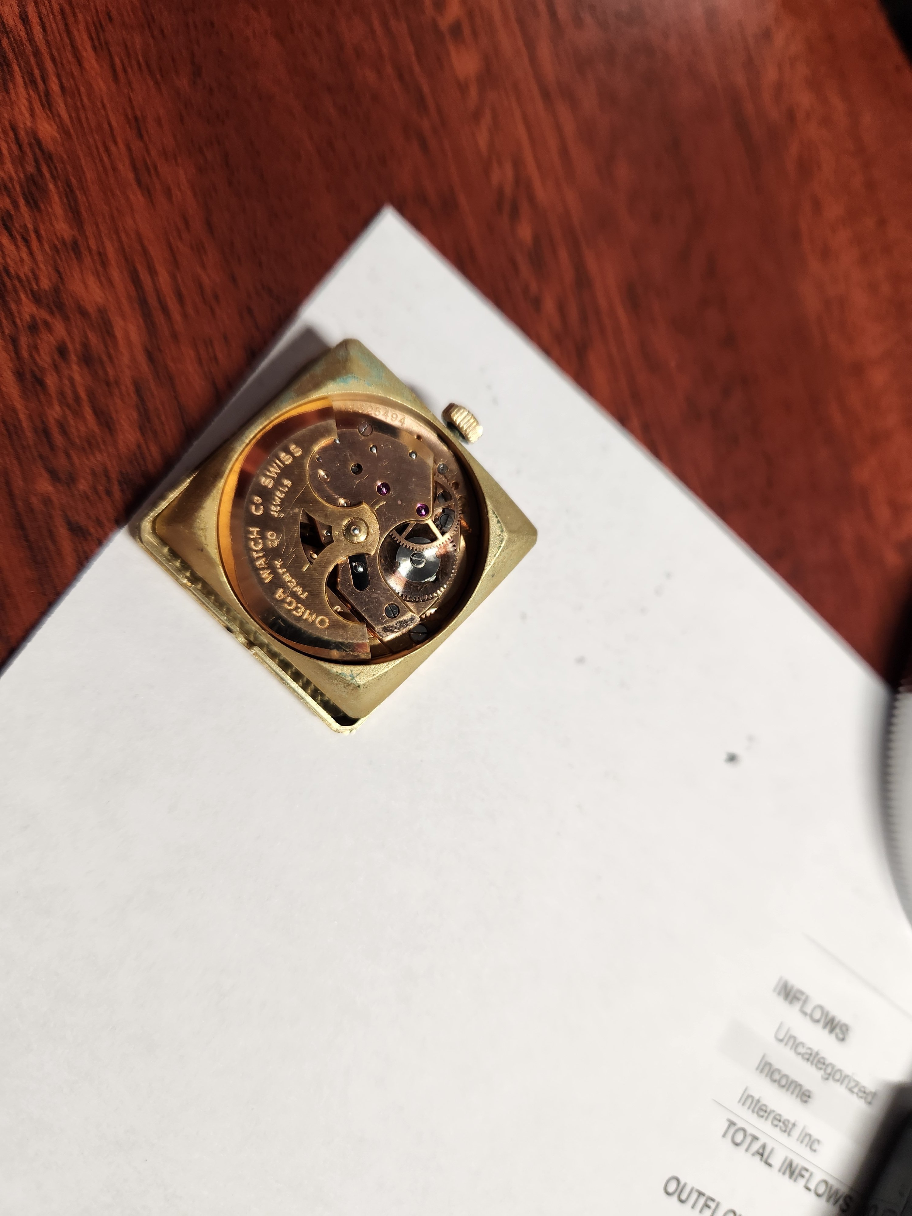

Dating Omegas reliably is best done from the movement serial number, which is not the same as any case serial which may be present. I don’t see that listed in this thread so I wouldn’t be too certain on the 1956 date as yet. Post some more pics of the movement with the rotor in different places.
I was able to get the movement serial number and matched that in the Omega database. I don't have the pic right here, though. Thanks!

For those wondering about the serial number..

The movement serial suggests approximately 1957. Regarding the dial, you can search for a replacement using the reference number of the watch, or just search for square/rectangular Omega dials and use the dimensions of yours to compare. Another option is to buy a parts watch with a better dial. In either case, it's an obscure model, so it could take a long time to find one, but you never know, something could pop up at any time.
