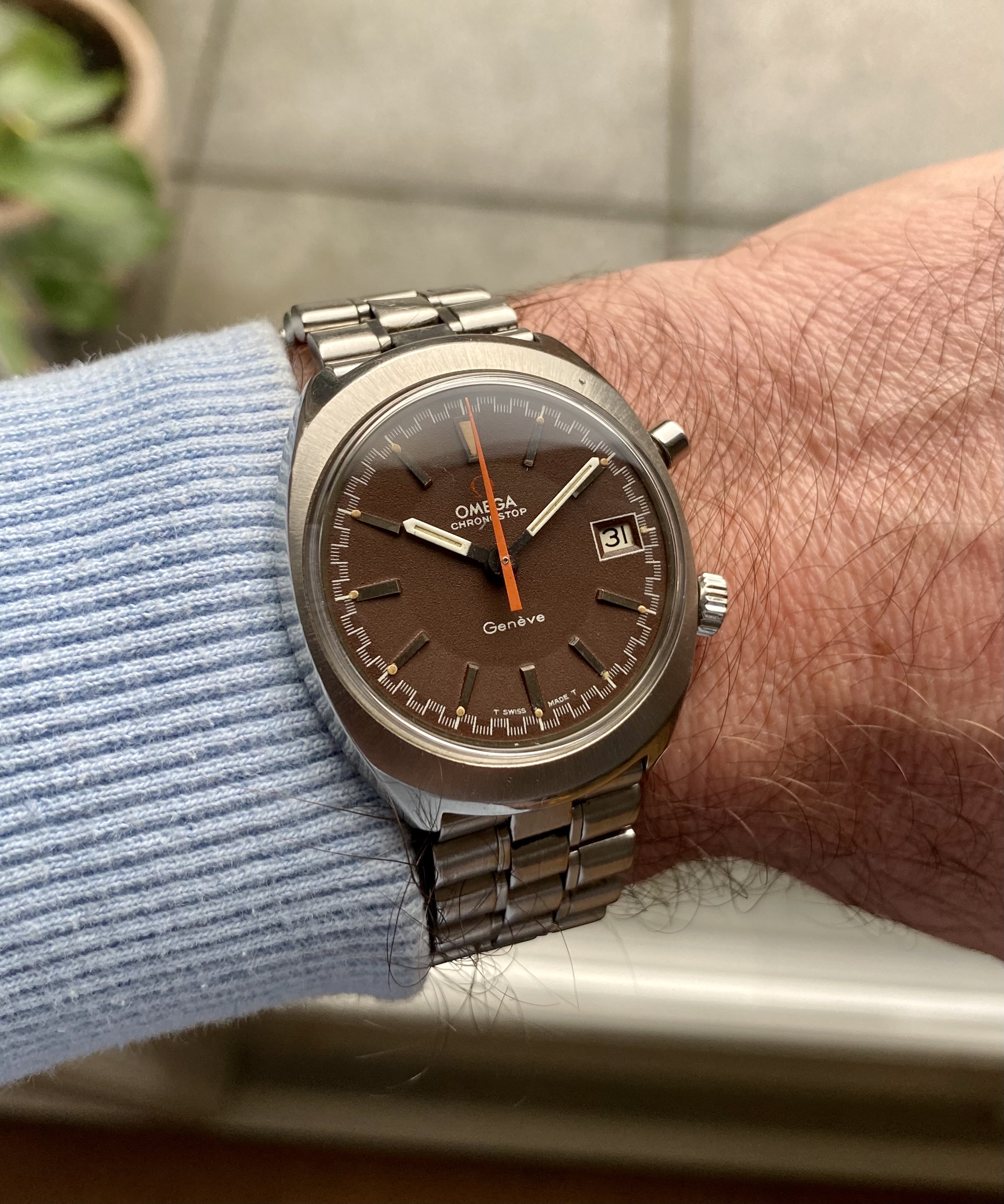

The watch on the pic is a 145.009 Cal. 865, I think it has 18 mm lugs.
Kind regards Max
edit: I just recognized it is a driver, so 145.010 is correct. Lugs should still be 18 mm.

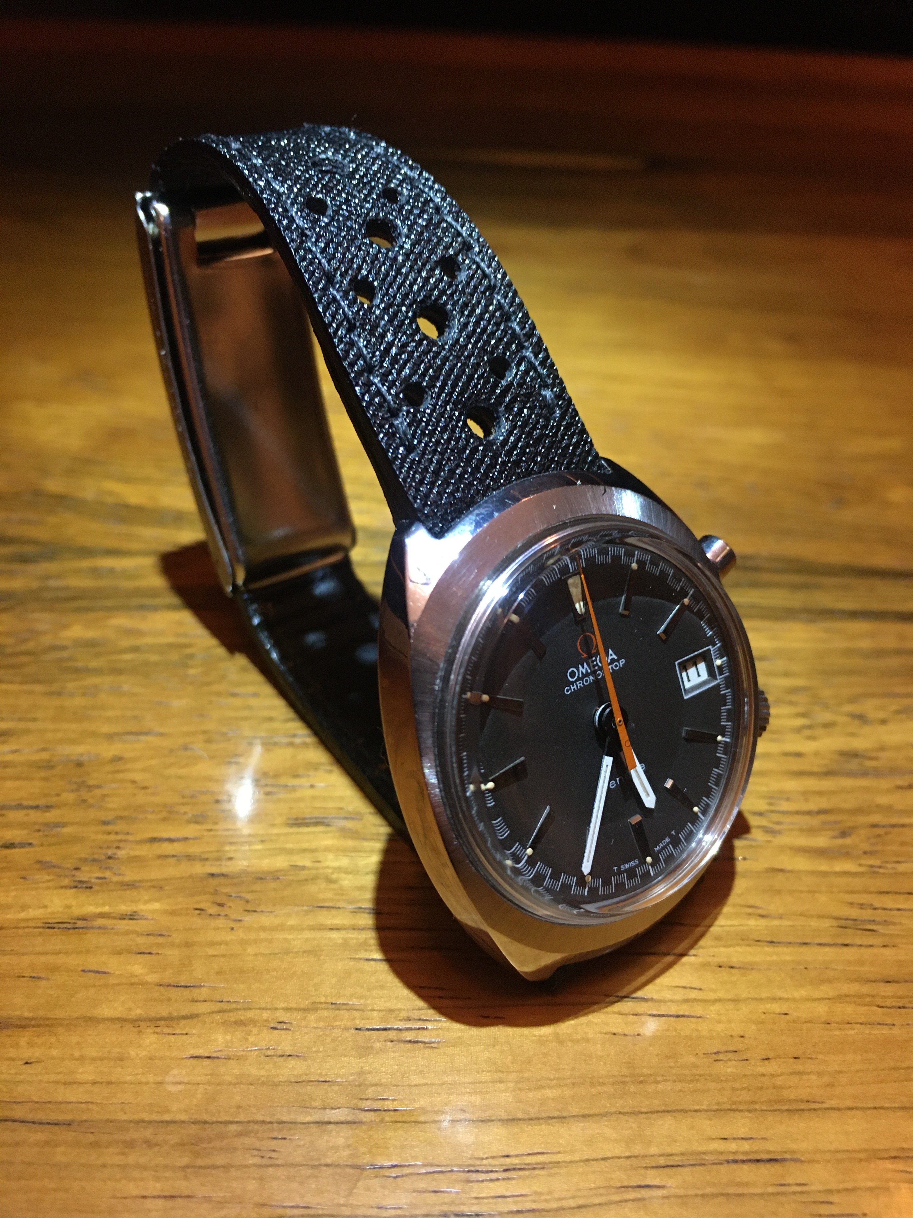

I know this also isn't what you asked for but I bought a black leather strap with white stitching and used an orange fine tip sharpy to do basically the same thing as the one below.. It looks good with the Chronohand being orange. https://www.cheapestnatostraps.com/...s/products/bronco-black-with-orange-stitching

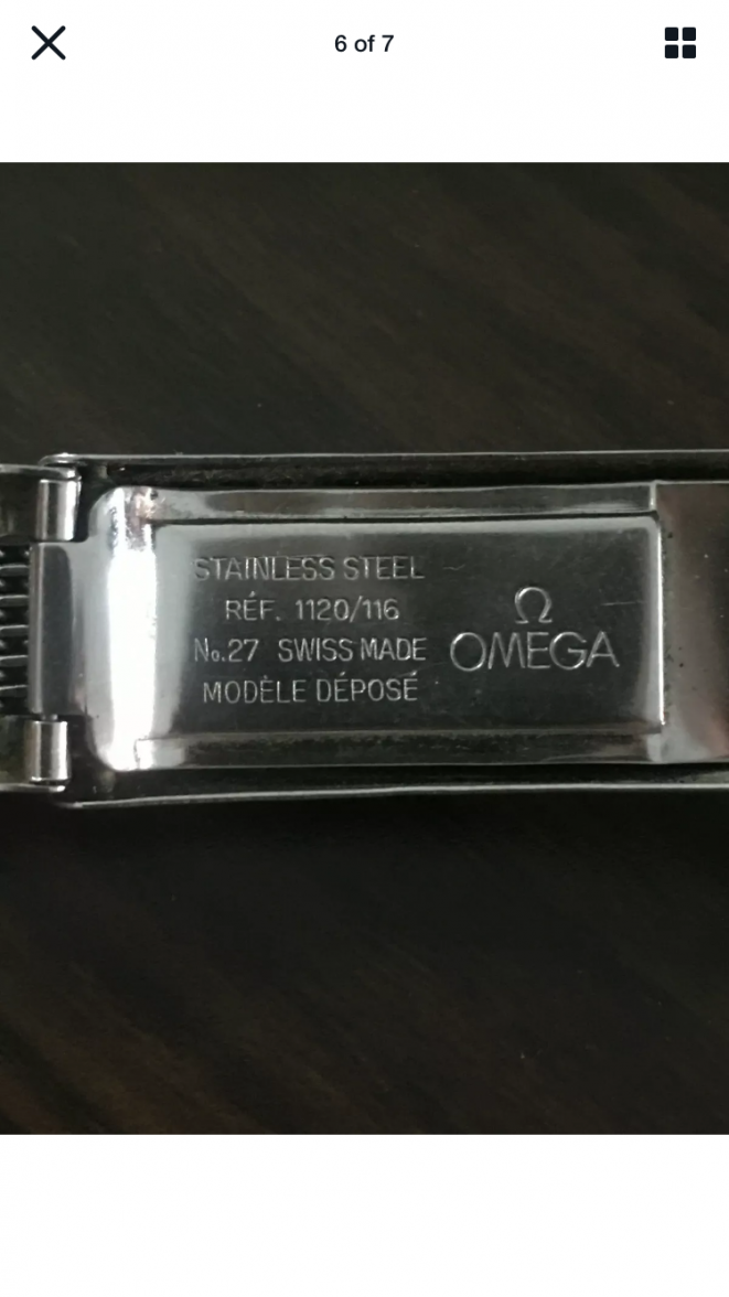

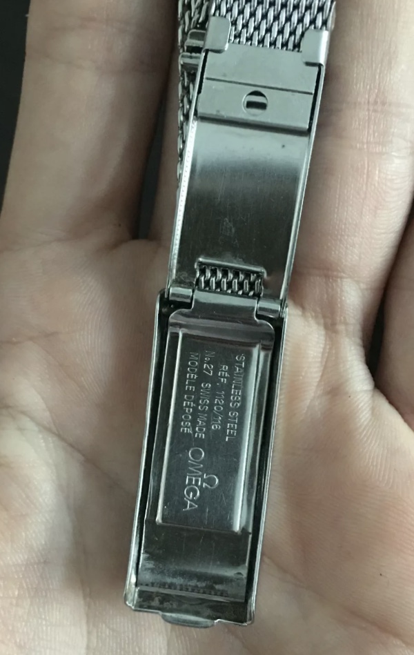

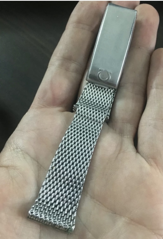

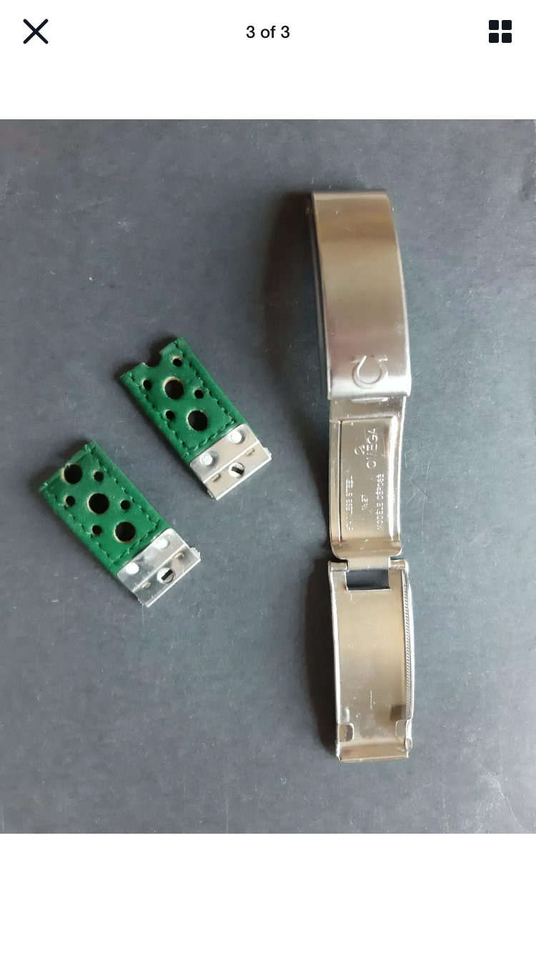

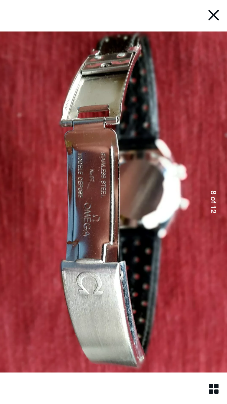

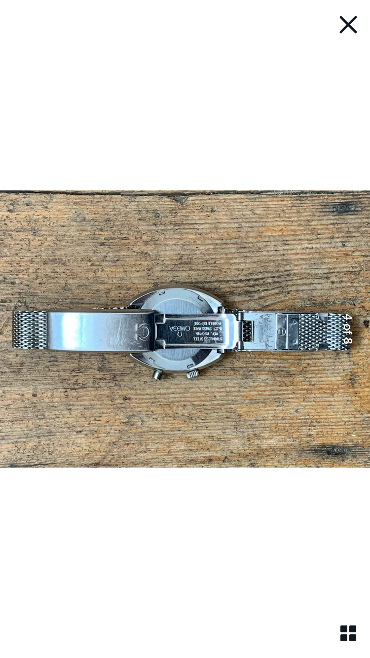

From my research (I’m a Chronostop 146.009 owner) The following clasps and bracelets are correct:
No.27 clasp (they made two sizes, so make sure you get the correct one)

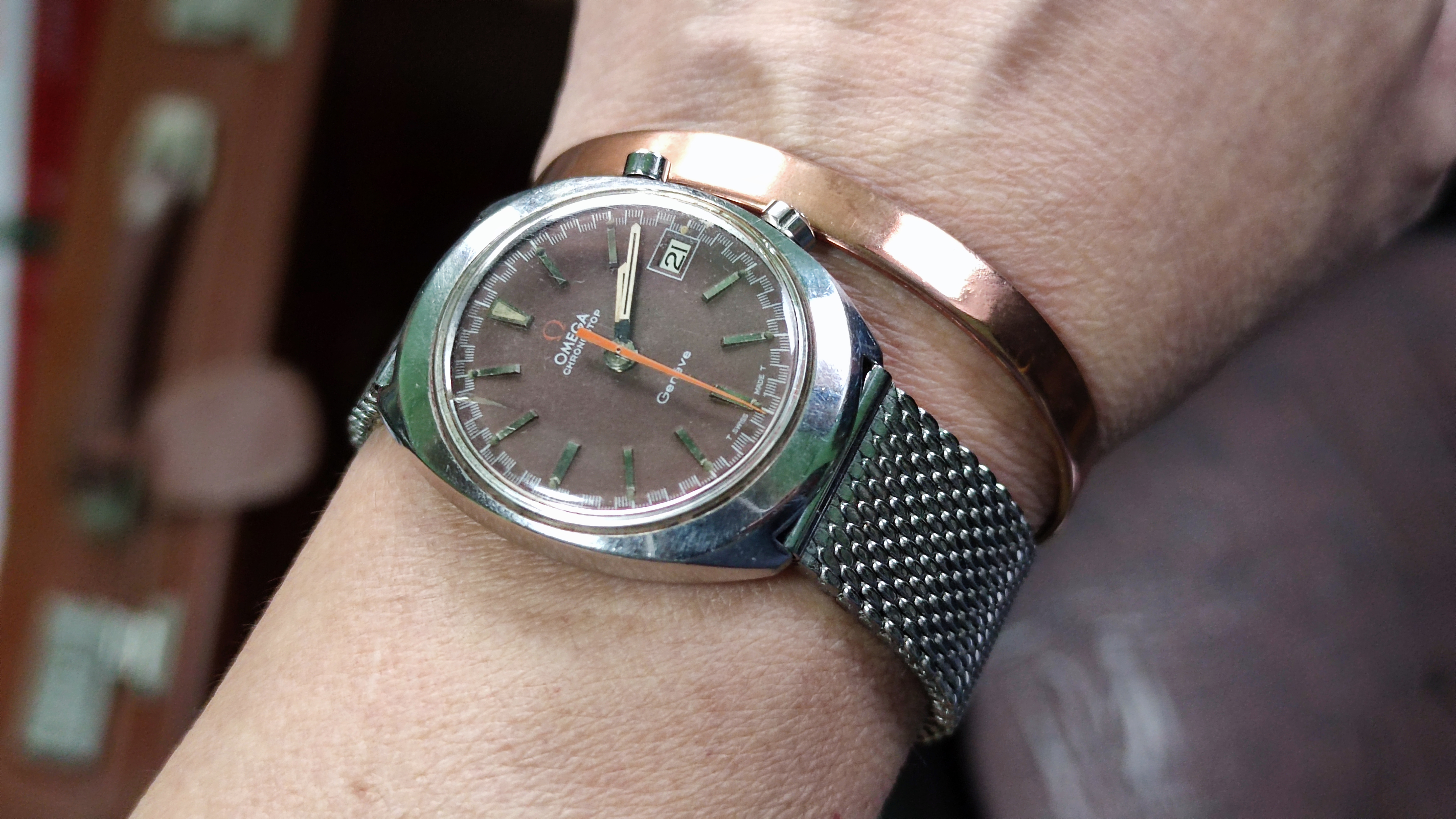

Milanese mesh Bracelet and clasp (ref 1120/116) the clasp is the same as a No.27 clasp, but stamped 1120/116 from what I can see.
I had a lovely strap made up by Steveostraps with my no. 27 clasp and correct locking cam end pieces, but he can make a strap using his own version of the end pieces.
I have added some photos of my straps and clasps to help.

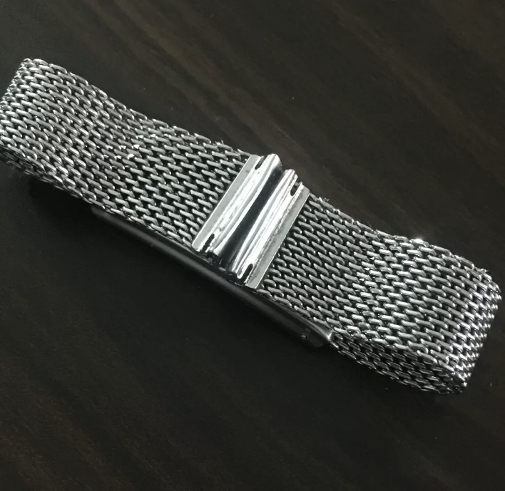

There is also the 1118 bracelet that would need the 123 end links for the chronostop. It can bee seen on the archived listing at bulang and sons, link and photo listed below. I saw in an archive book, that my local Omega Boutique had in store, that the 1118 bracelet w/ 123 end links was an option for 145.009 (the previously posted 1120/116 was the metal bracelet option for the 145.010) but I thought the 1118/123 looked so good that I dropped it on my 145.010 drivers reference.
https://bulangandsons.com/products/omega-chronostop-driver-s-watch-reference-145-010-w890
And yes, I know my profile photo is one of the one from the listing. I have a similar145.010 reference with the same bracelet and end links, so I figured why not use it until I take some good photos of my watch.
I believe the seller that I bought my bracelet and end links from has another 1118 bracelet available listed as well, but had different end links.

I've got the same as @SeaMSTR on my two chronostop watches. The clasps pop up regularly on eBay, if I remember correctly I paid around £60 for mine without the end links and had a strap made from Steveostraps.: https://www.steveostraps.com/straps-2/top-end-stuff
I also purchased my milanese strap on eBay, again, they pop up on eBay occasionally, just need to be patient.

The 1118/123 is a nice option is you ask me.
You can also find the mesh bracelet on eBay once in a while, but it doesn’t come very cheap most of the times.
