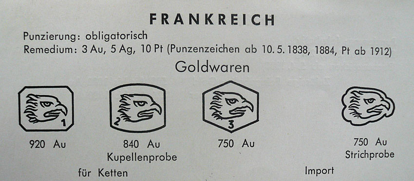

The eagle head hallmark is also found on cases of different gold content. (edited)

As far as I know, for the French law, and this is true since a long time ago, gold is only 18K or more. Thus a French product with less than 18K (or gold filled) could not have any of the French hallmarks concerning (solid) gold. But there are French hallmarks for imported products.
How do your hallmarks look like?

The eagle head hallmark is also found on 14K cases
Hi Erich,
Do you have an example of that? As far as I know, the French hallmark for 14K (which is not exactly considered as solid gold) is a shell.

Edit: my message may be not clear enough. There are obviously French hallmarks for 14K and even 9K, but there are not considered as (solid) gold. For the French law, a true gold product must contain at least 75% of pure gold.

Francois,
I stand corrected and have edited my post.
I remembered wrongly and mixed it up with the eagle heads for higher gold content.
You are perfectly right with your previous statement.
I have searched in my data and have found the sheet with the French poincons
best
Erich

Great, thank you for the help.

Francois,
best
Erich
Outstanding... thank you

Are these French stamps from a book, if so, which one if I may ask.

No, not a book. I have them loose in a ring binder - got them gifted from a friend

There are books and detailed data online. I have looked at some of them when I was trying to identify a maker. But concerning the main "poinçons de garantie ou de titre", I would recommend this document - from the French customs:
http://www.douane.gouv.fr/Portals/0/fichiers/professionnel/fiscalite/garantie-metaux-france.pdf
