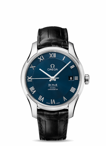

  9. dsio Ash @ ΩF Staff Member Aug 14, 2012
    26,988
    32,696
  10. cicindela Steve @ ΩF Staff Member Aug 14, 2012
    15,047
    23,790
    My personal favorite of the 8500's is this one:
    The sapphire case sides as well as case back really looks cool in person and the size is great
