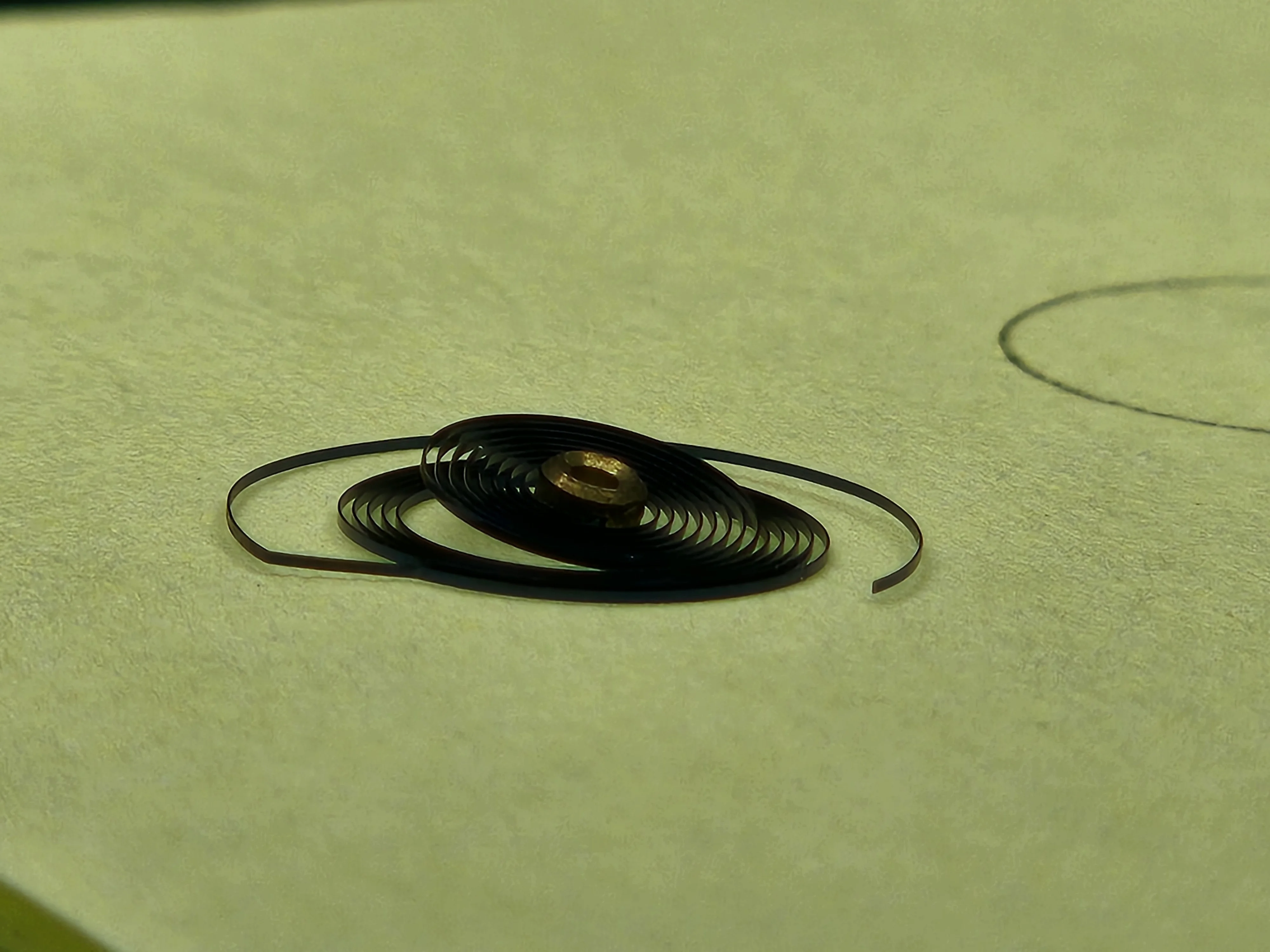

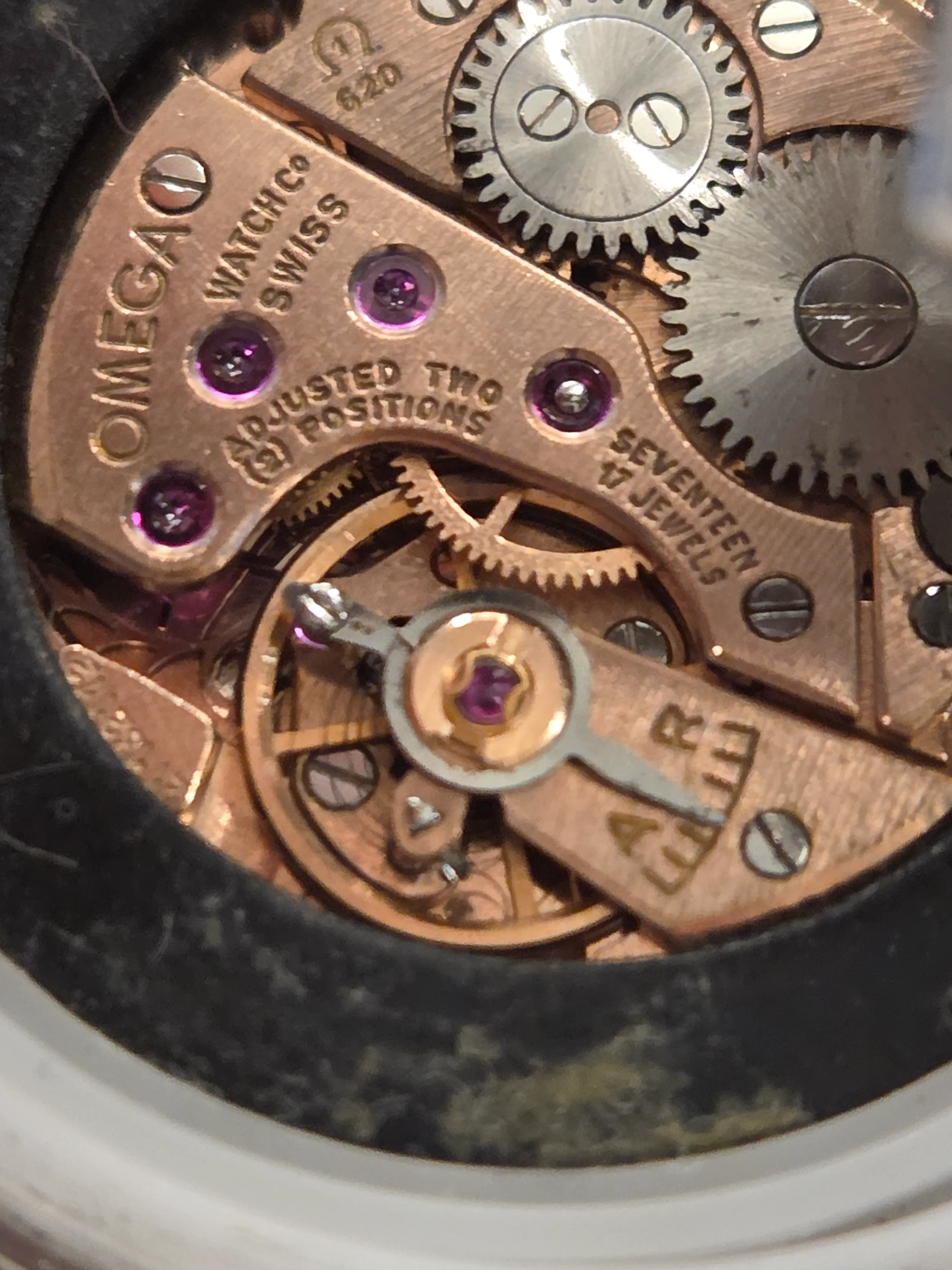

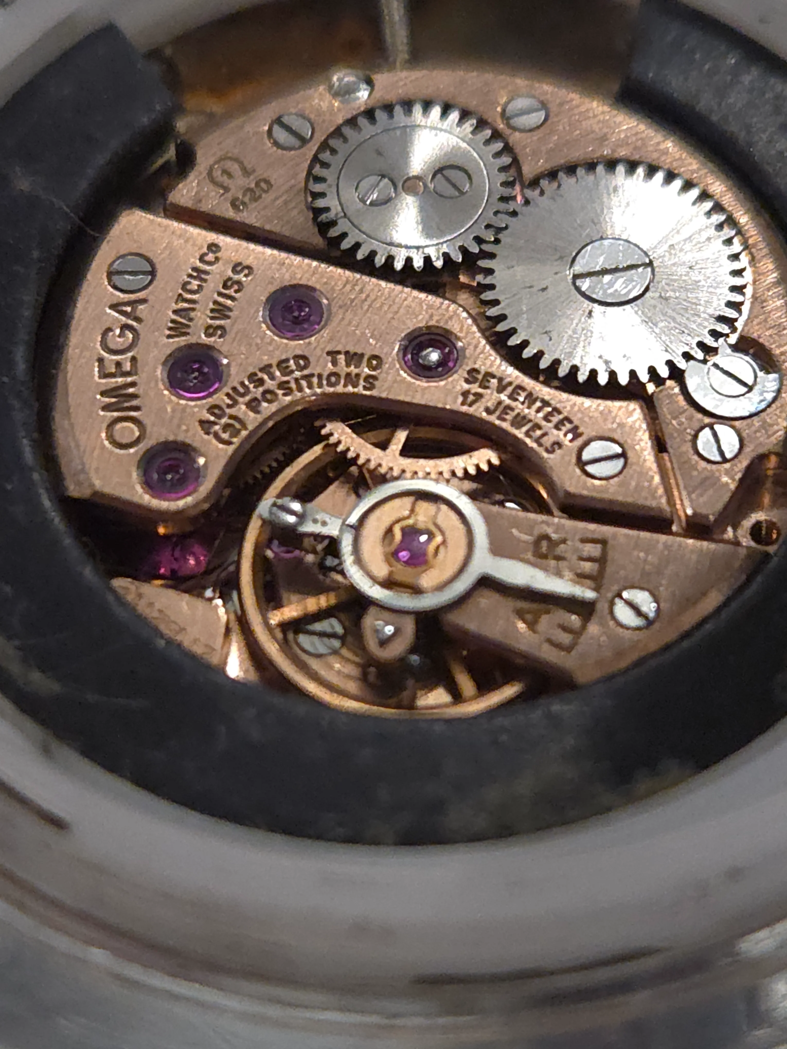

Hey everyone

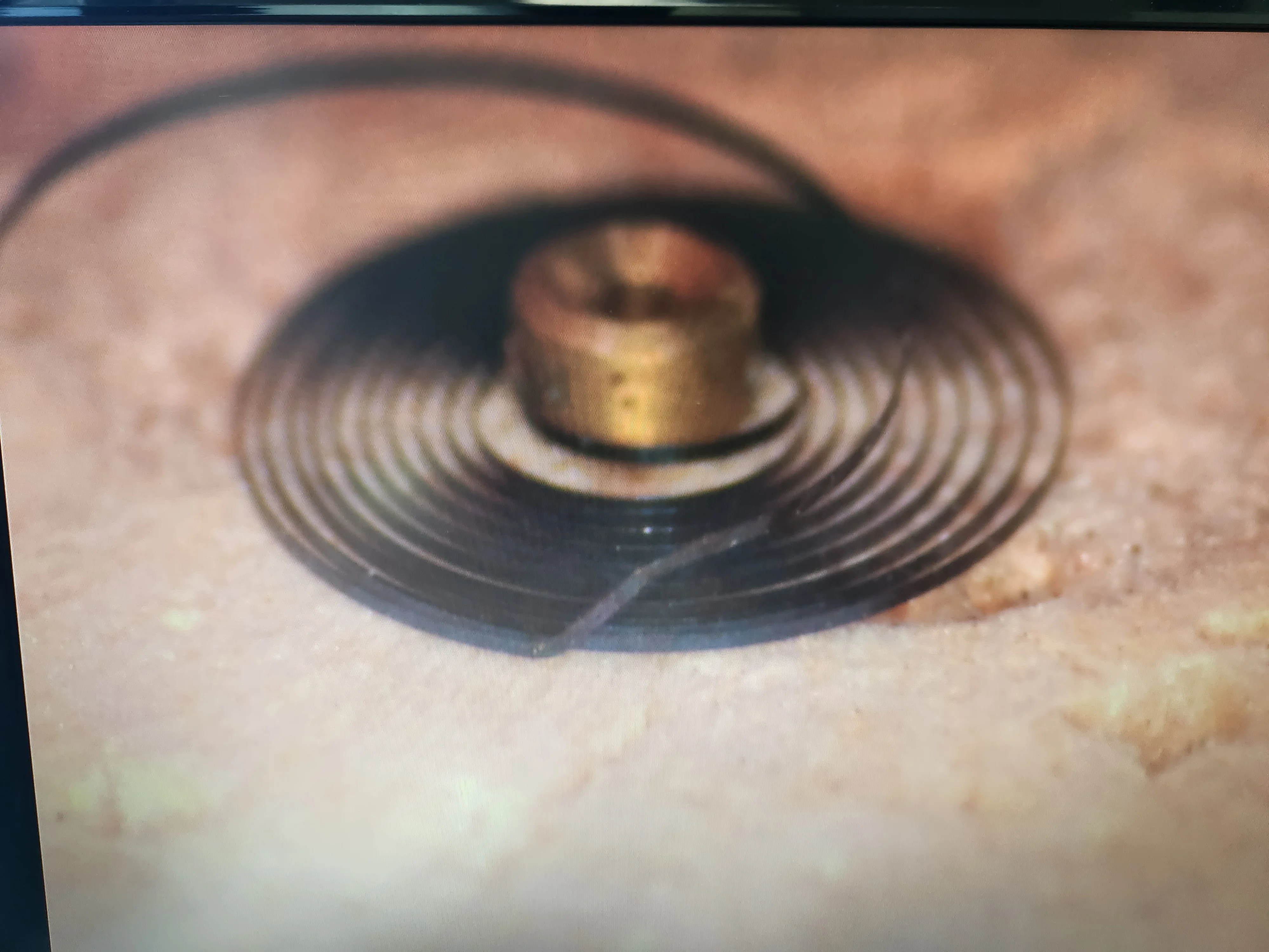

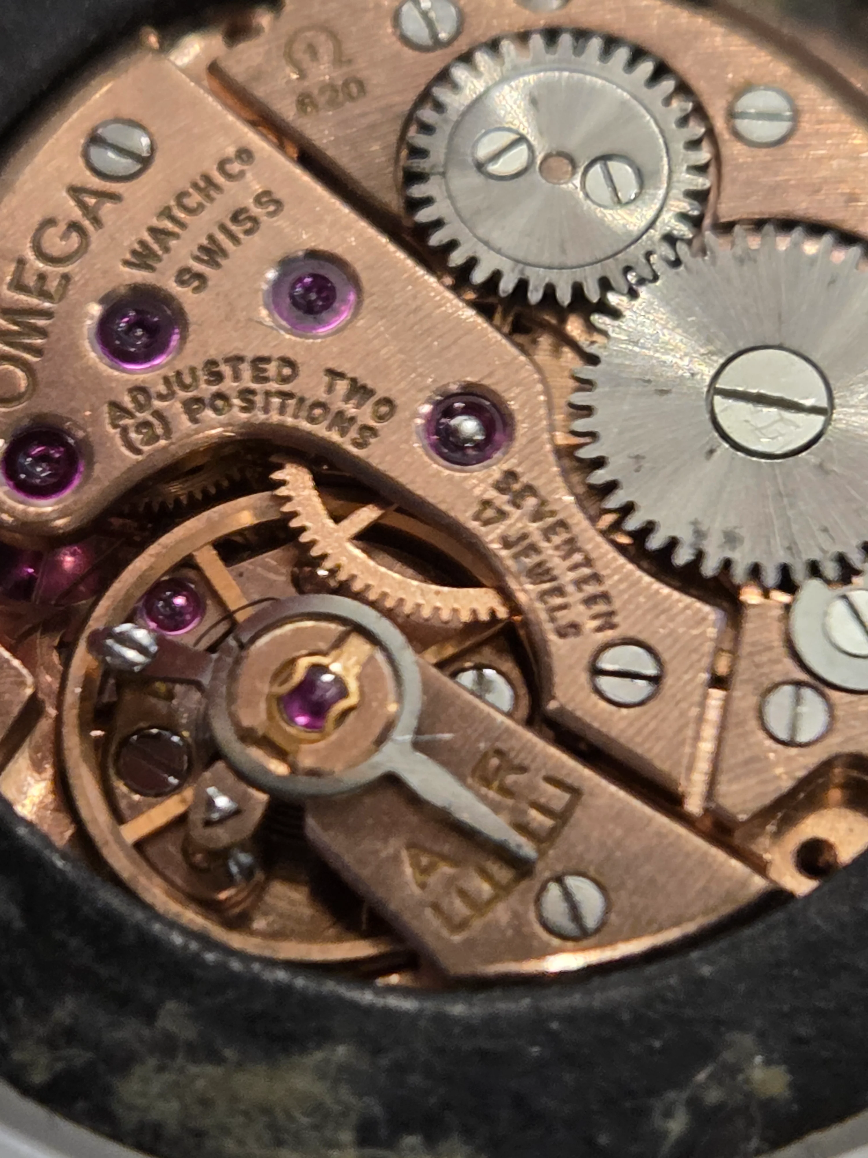

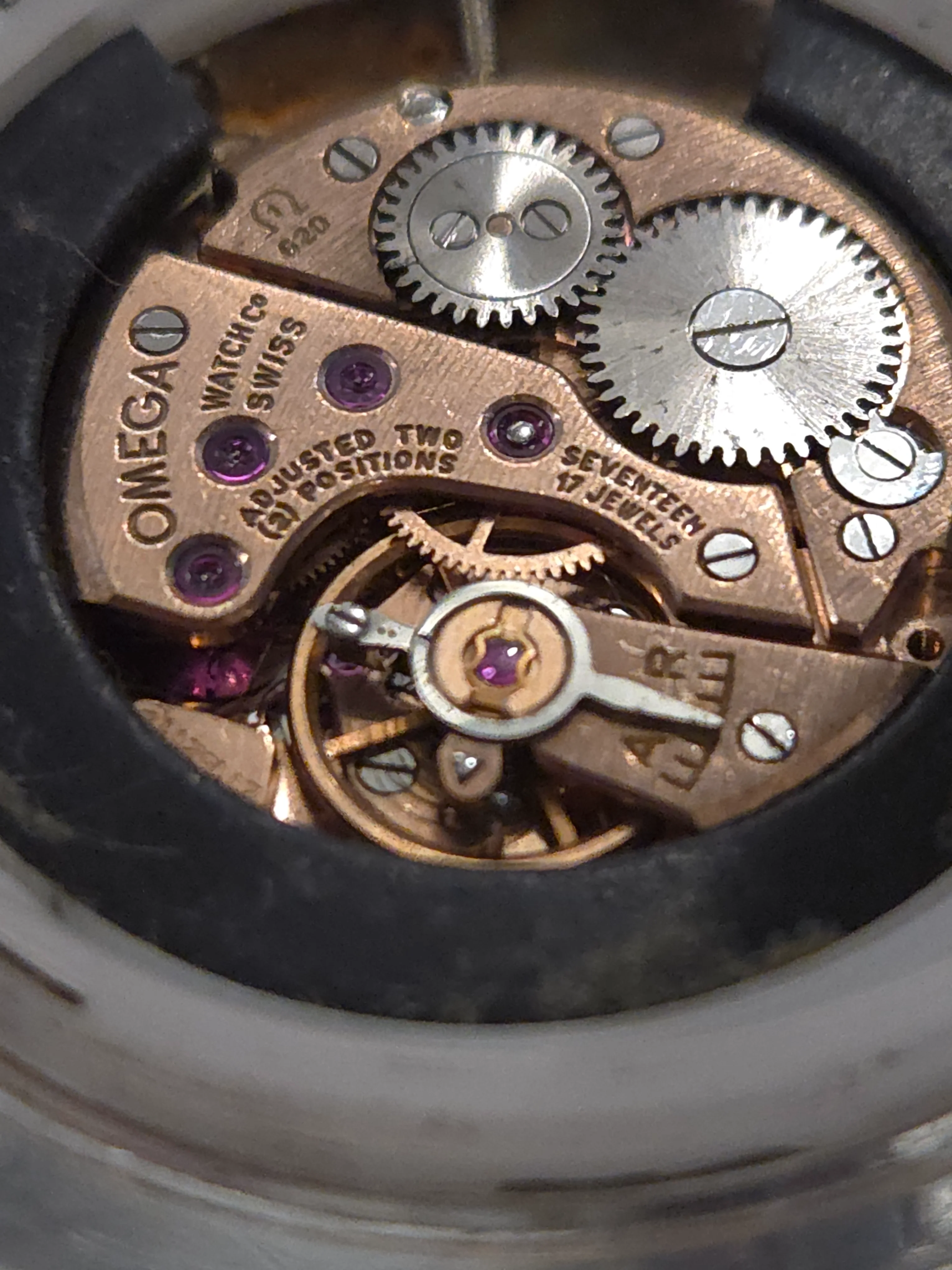

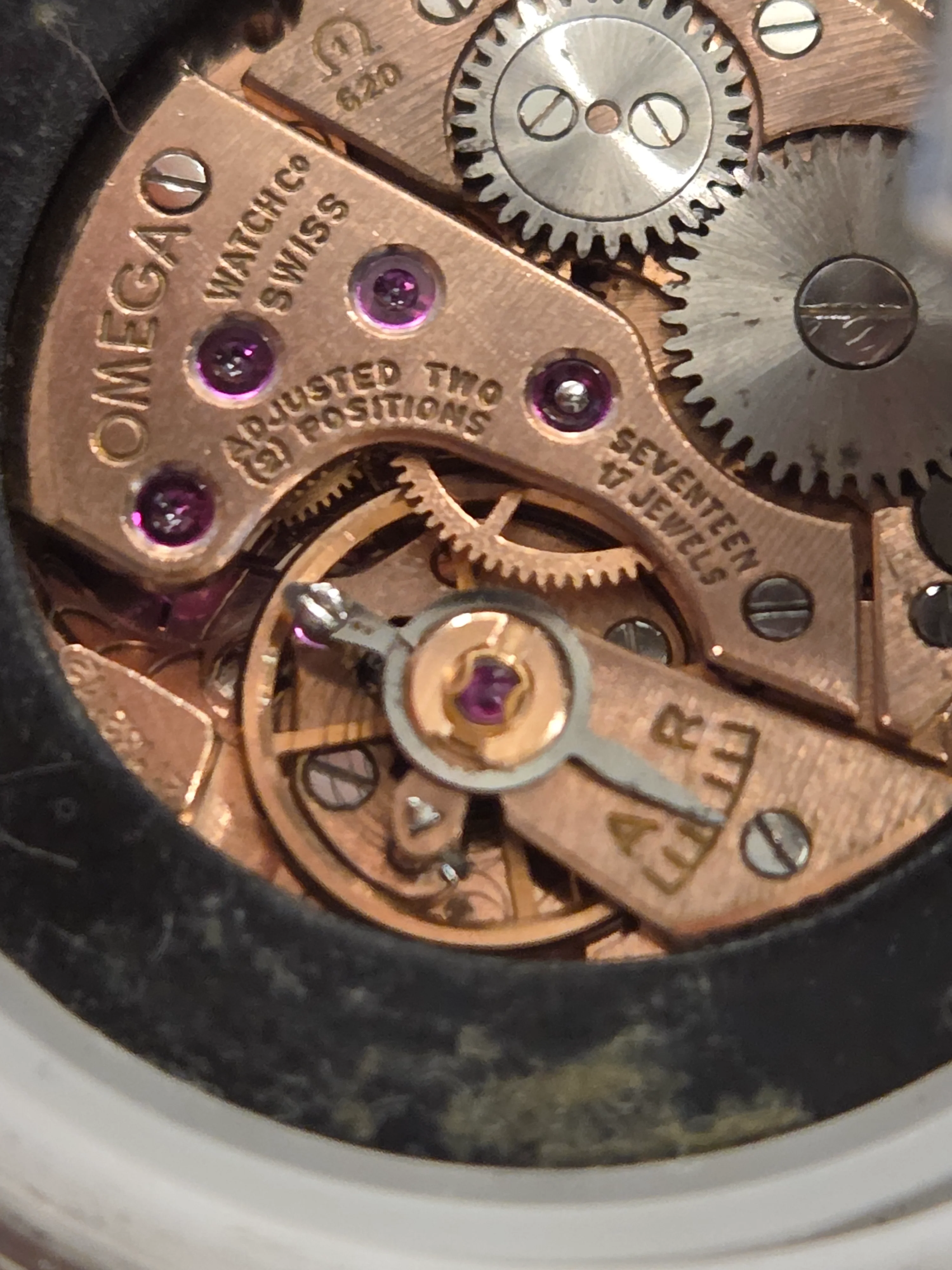

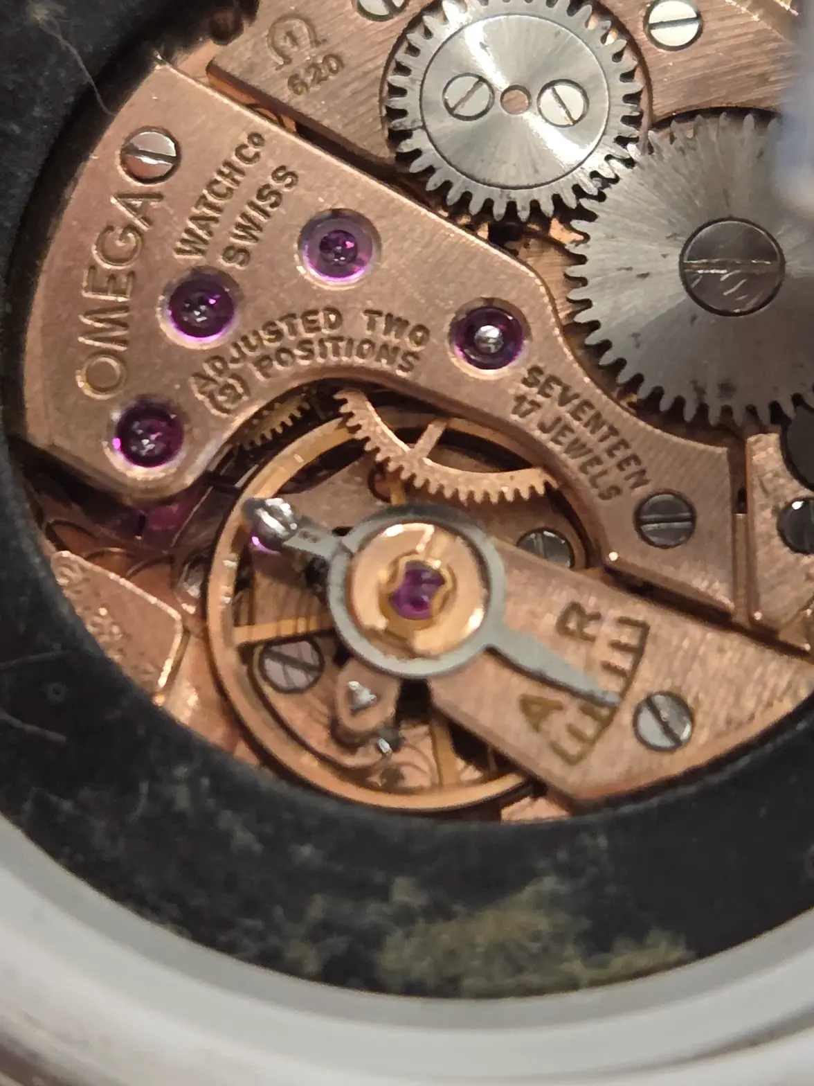

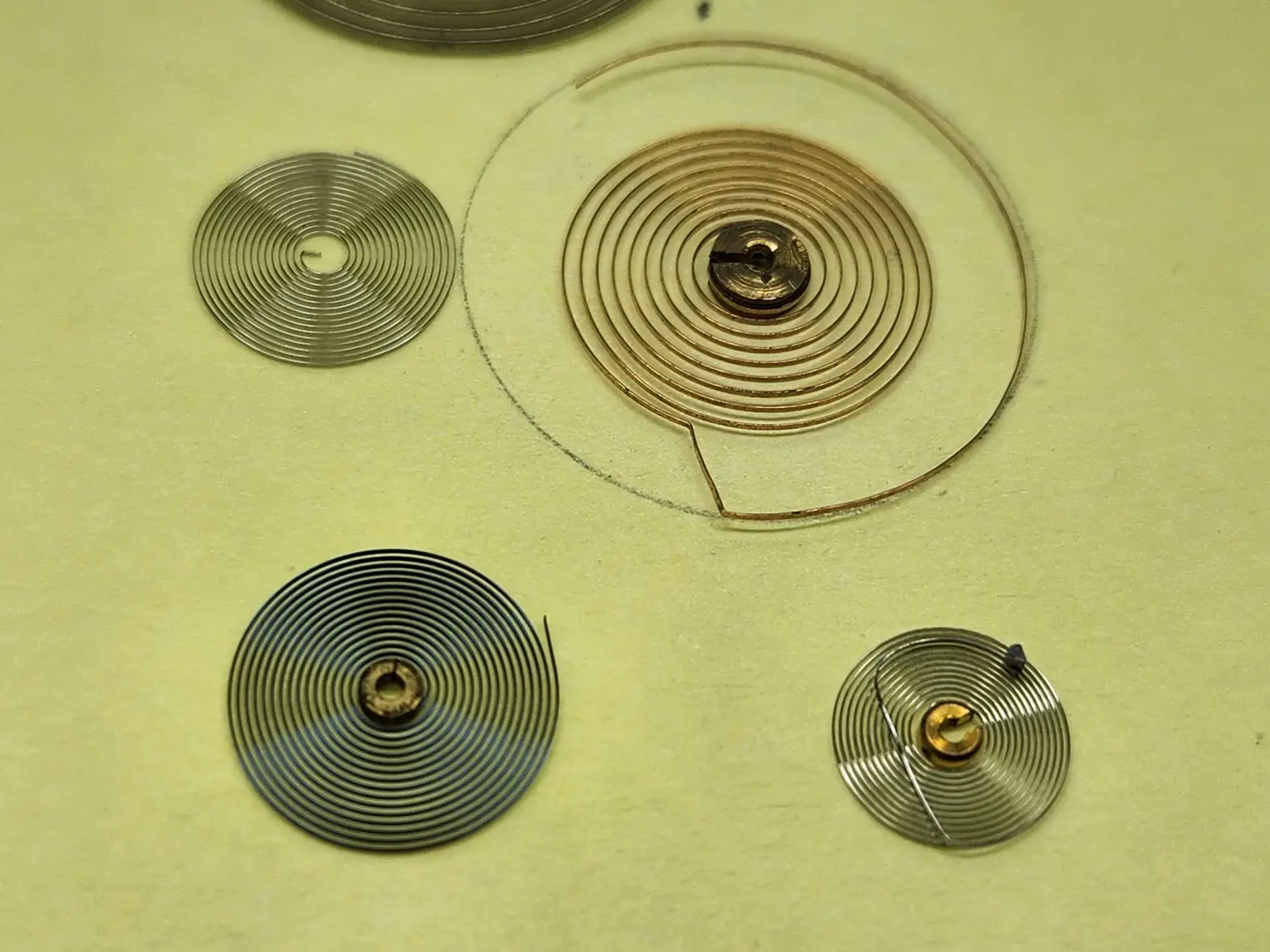

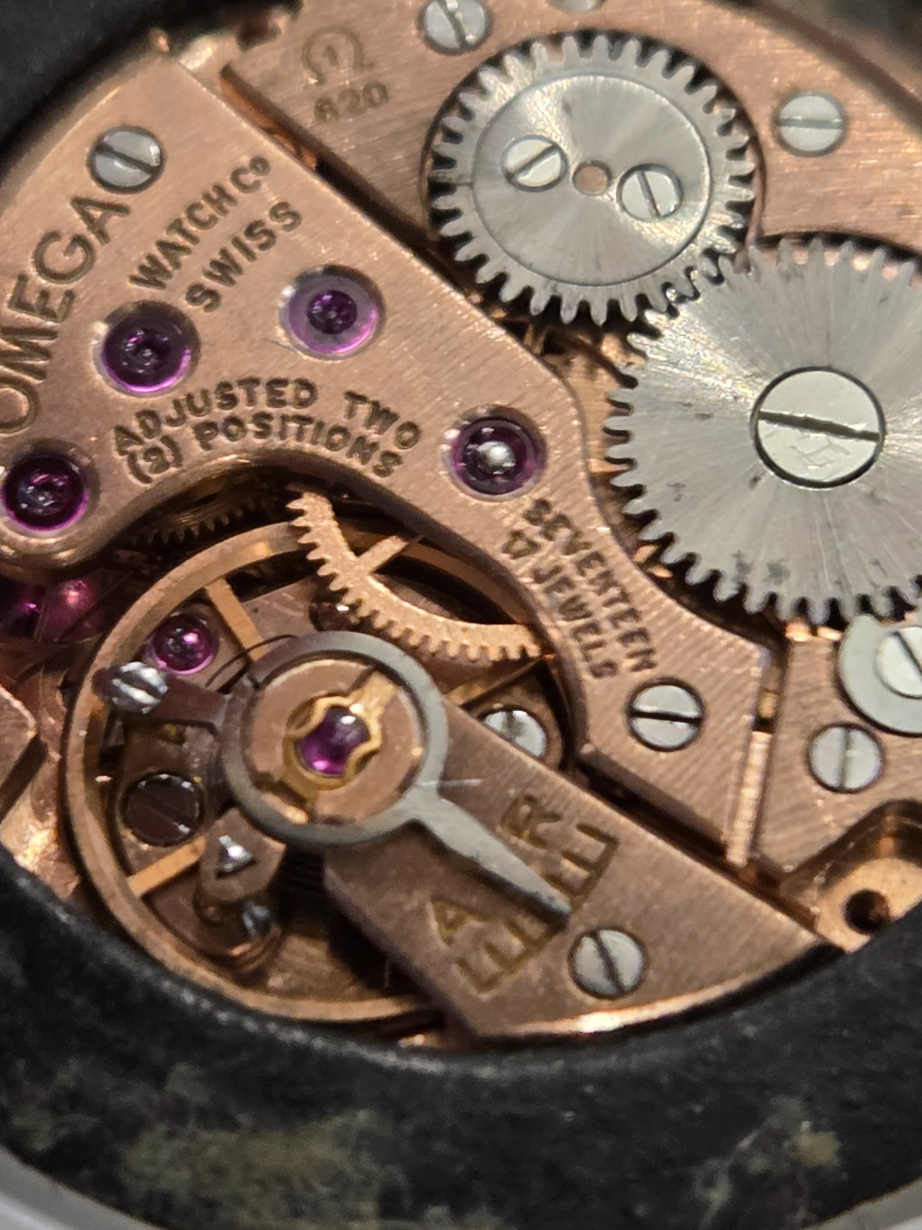

I was regulating my Cal 620 and looks like I've tangled my hairspring. Does anyone know the best way I can fix this myself?
29,669
76,826
If you are asking this question, then I assume you have no experience with repairing balance springs that are this distorted, or at all. o if that is the case, I would suggest finding a watchmaker to help you. To be honest from what I can see in the photos, it doesn't look bad, but unless you have some experience you are very likely to make it worse.
5
Thank you, trying to learn how to repair balance springs and have messed up a few previous ones. For this, what exactly would I need to do to fix it?
29,669
76,826
The photos are not clear enough to give you much advice.
2,842
4,536

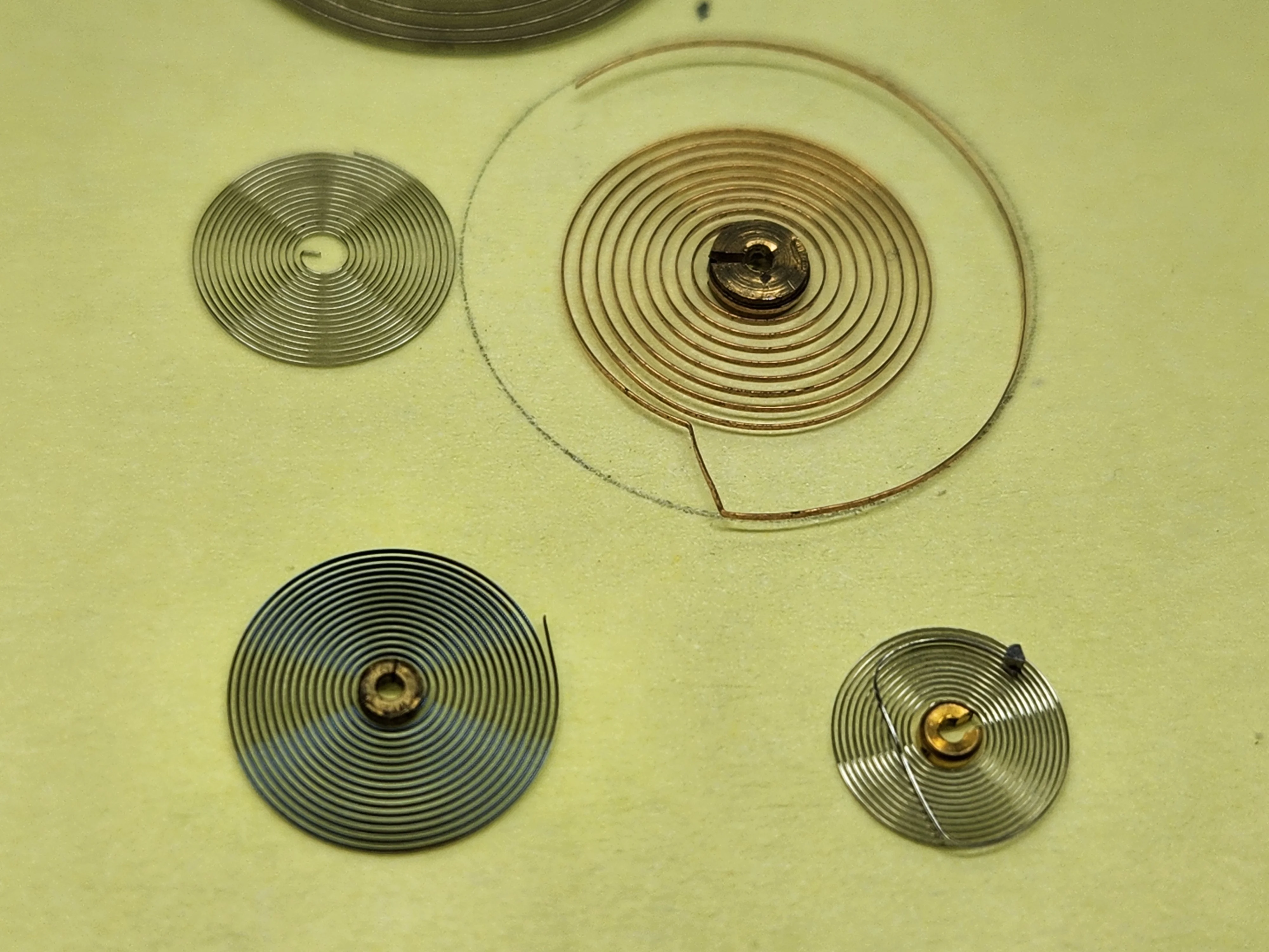

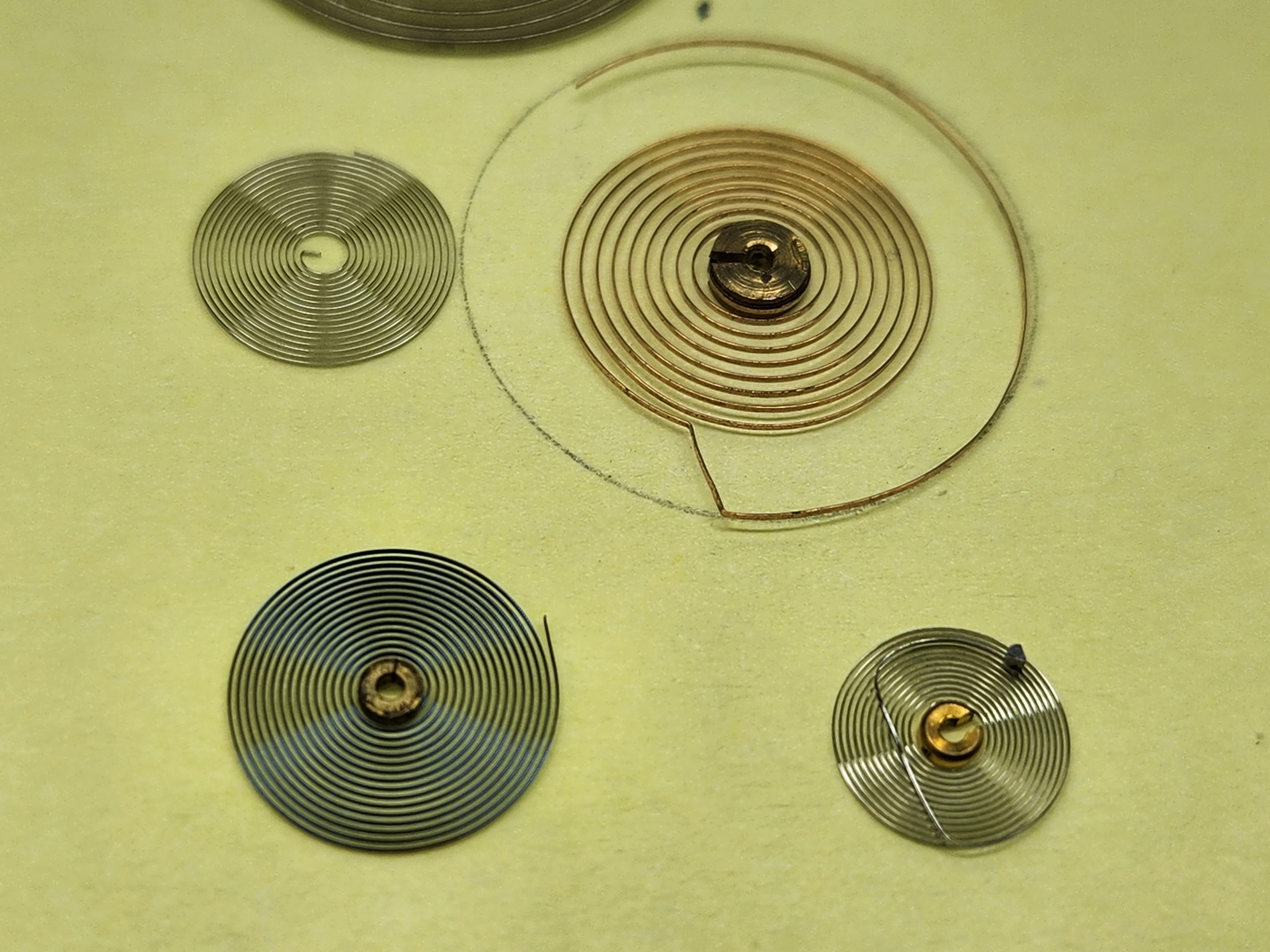

If you want to learn how to repair balances, get some good off brand (and fairly large) movements in tip top shape. I like A Schild, but anything from ETA, Felsa, or the other myriad of Swiss manufactures who were active between 1940 and 1970.
It is best to start with a working watch what keeps time. That way one learns what the results should be. Get watches by the dozen and work with 100s of them.
Ideally one would also learn in person from some one who can fill in the gaps that not book or video could do. Books and Videos are great for theory. They do not tell you things like how high the bench should be. How to hold tools and such. One is going to be spending the time sitting for hours if not days or months staring at what was called the 144, which is the square foot in inches that becomes ones world. One also has to train the muscles to work for long hours in an Alice and wonderland world where the center of gravity is not what you think. Where static attraction and magnetic fields outweighs the mass of the part. Air has mass too which also outweighs the parts.
Another note about books most were written before the 1930s and deal with pocket watches, large movements and stuff what could be manufactured in the fireplace or on the stove cook top.
Starting with a tiny Ladies movement, will only lead to frustration and remorse.
505
2,067

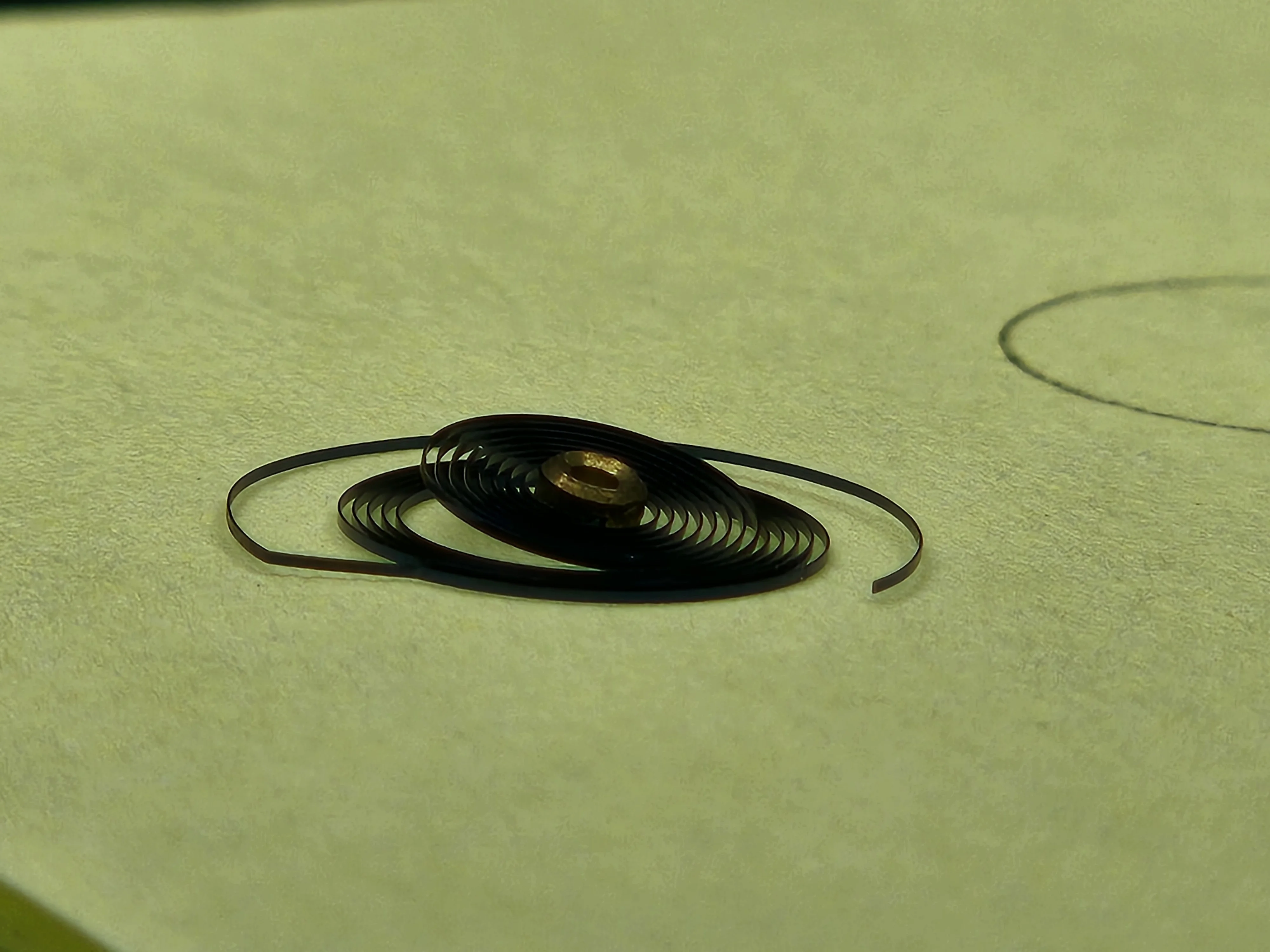

This is probably not a feasible option for you, But as a general message to anyone interested, I took a week long class on hairsprings last year at AWCI. If you took this class, this would be a really easy 10 minute repair. It is really not as scary or anxiety provoking once you know what you are doing. Like mentioned above, get some larger springs to learn the fundamentals on before going to the smaller stuff. Two pairs of 5a tweezers help tremendously at keeping the plane flat during tweaks. We learned on clock springs first, making z bends, building the regulating curve, then making Breguet overcoils (just another z bend in the axial axis). Progress moved to 6497 springs, then 2824 springs, then to small little blued lady caliber springs. Cool stuff.
The meat and potatoes of corrections are: If you have a error in the round (radial), make a correction 90deg from that error. if you have an error in the flat (axial), make a correction 180deg from that error. Understand that the spring is in an archemedal sprial that grows in diamter with the length, but the regulating curve is a fixed radius to the center point. The regulating curve should be cetered in the regulating pins throughout the entire arc of the regulation arm.
They only offer this class once a year but I dont see it on the 2026 calendar. I would email them and let them know you are interested, they may open it up to enrollment. There were only two people in my class and its mostly just seat time to learn this skill. https://www.awci.com/event/watch-431-hairsprings-2-2/#

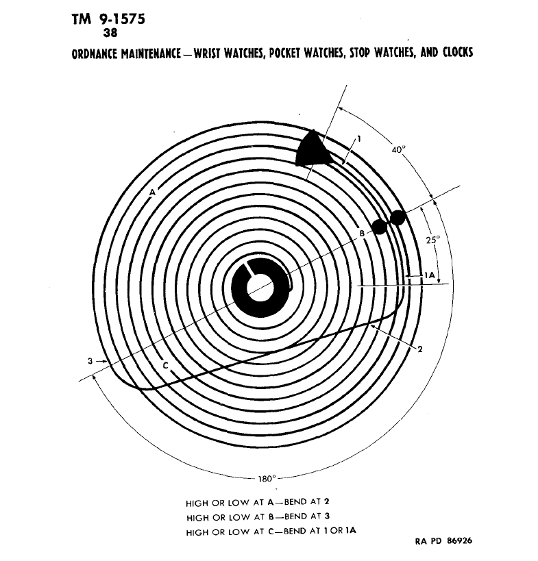

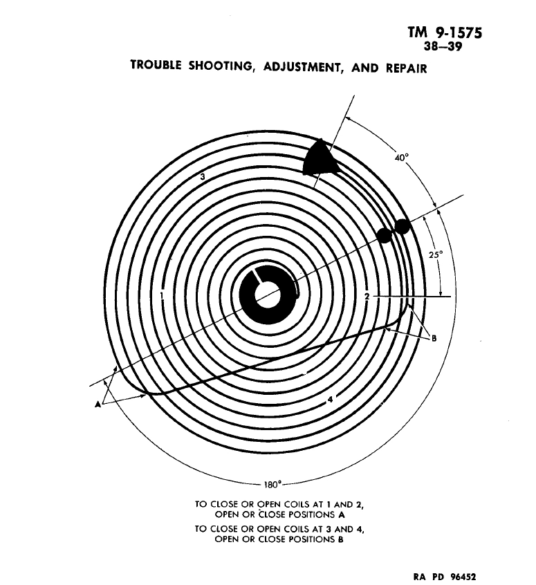

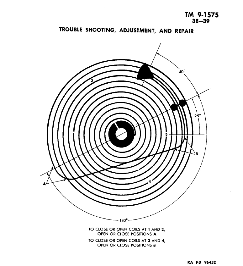

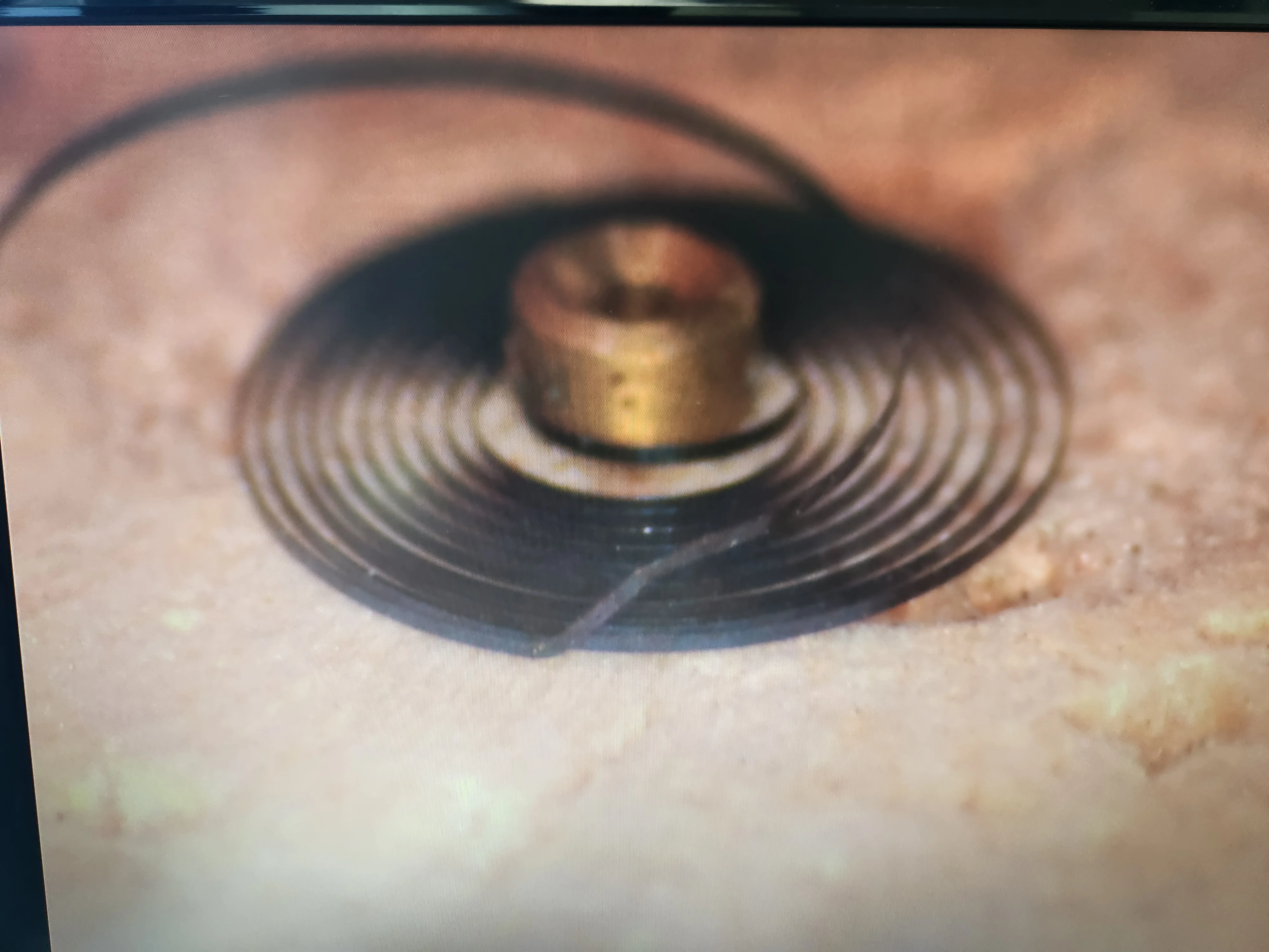

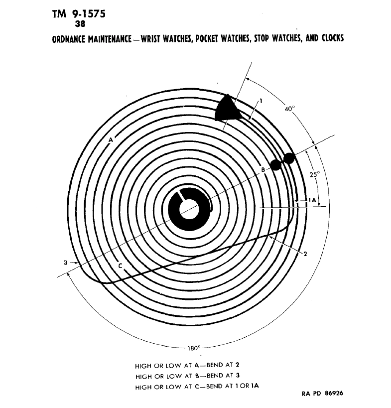

There are lots of resources out there, like this old military training manual - the balance spring adjustment diagrams give you lots of good things, at least for overcoil springs. First for centering:
Then making adjustments to make it flat:
17,938
37,510
One of my early learning guides before I found ΩF.
So much stuff in there that I still do.
