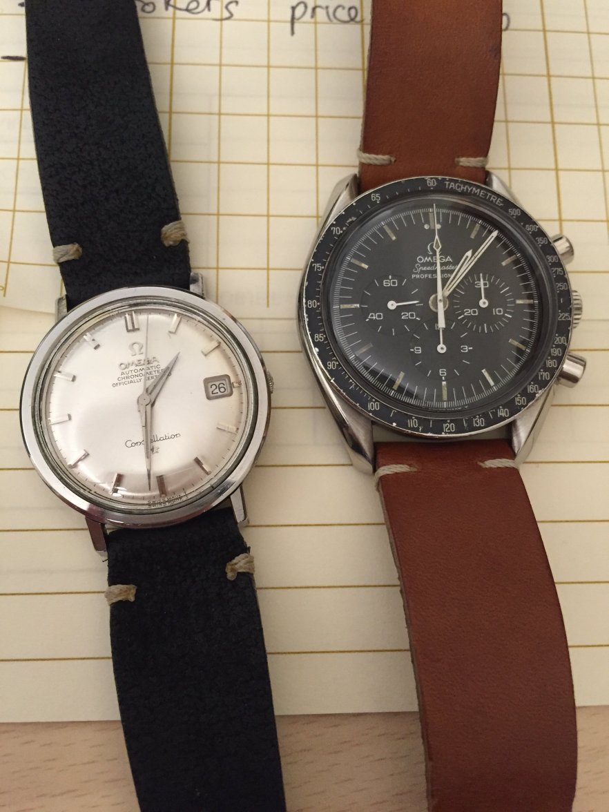

    Thanks a lot for your answer. I bought it for my girlfriend, she is going to wear it for a bit and probably service it soon, even if the hard-to-wind part is not really an issue since it is automatic. Here is a pic of it next to my '75 speedy, I'm going to take better pics at home.
    I must say she is really lucky that the 36mm feel a bit small on me otherwise I would have kept it for myself: what a spectacular timepiece! The dial is crisp and really stunning, as is the case.

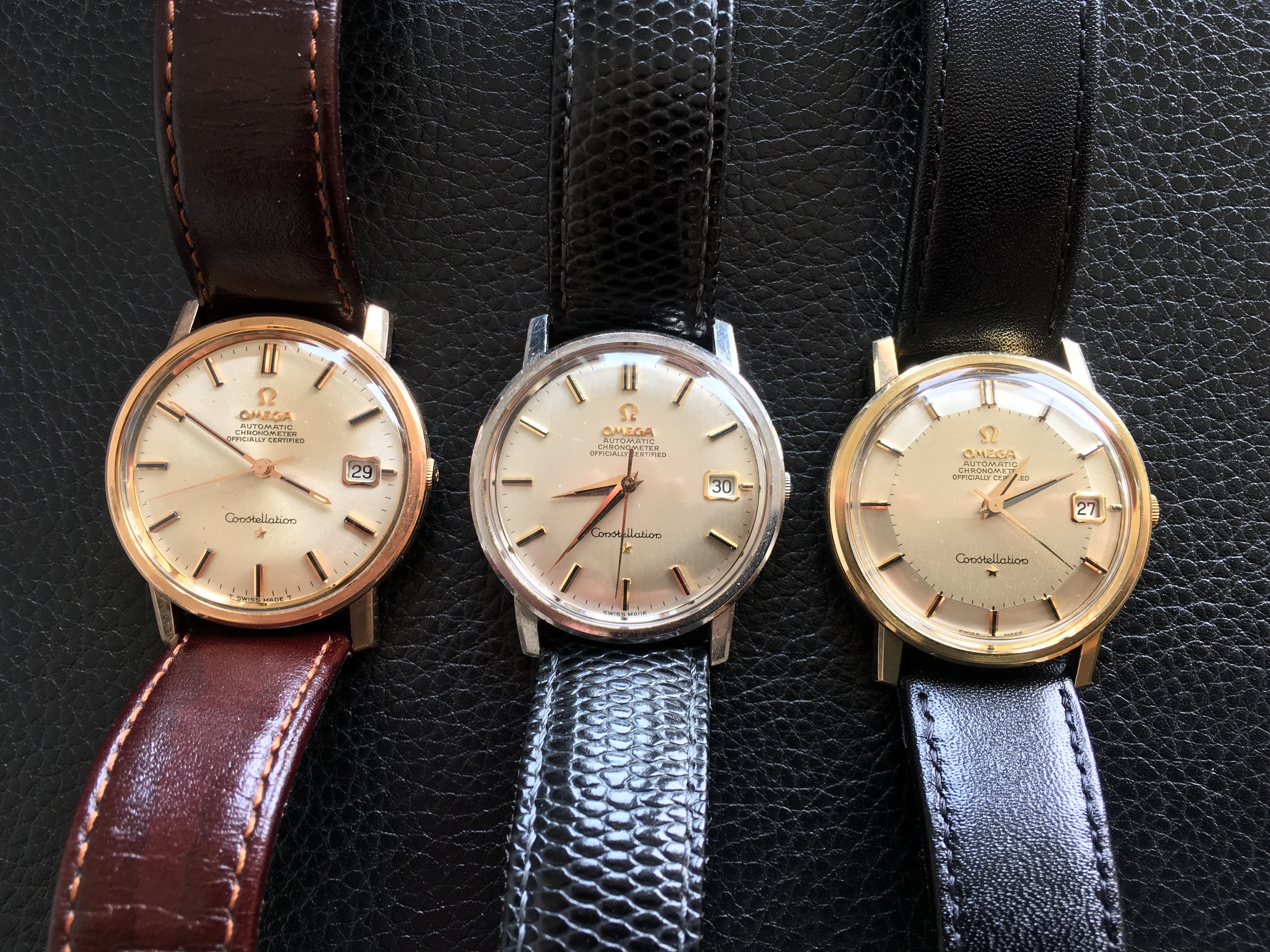

    mine posted in 'three of a kind' recently
