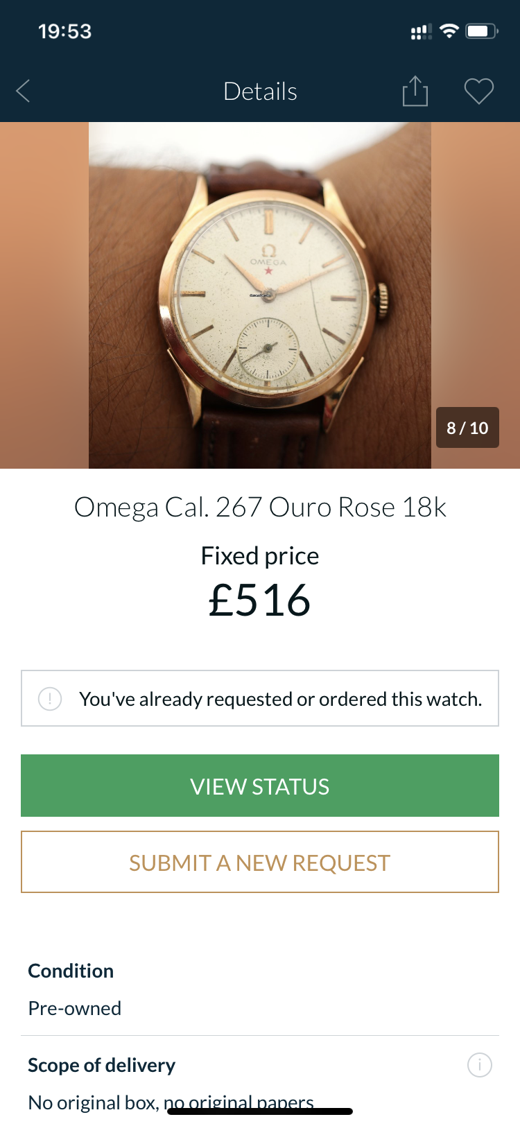

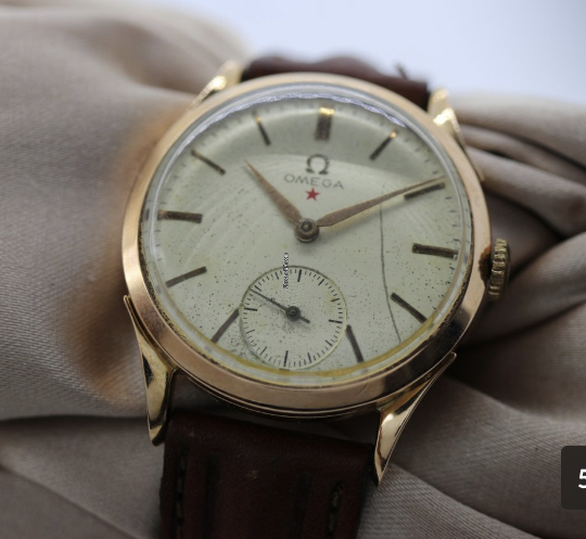

Some advice if possible on this Omega I have found on Chrono24
Seller hails from Brazil

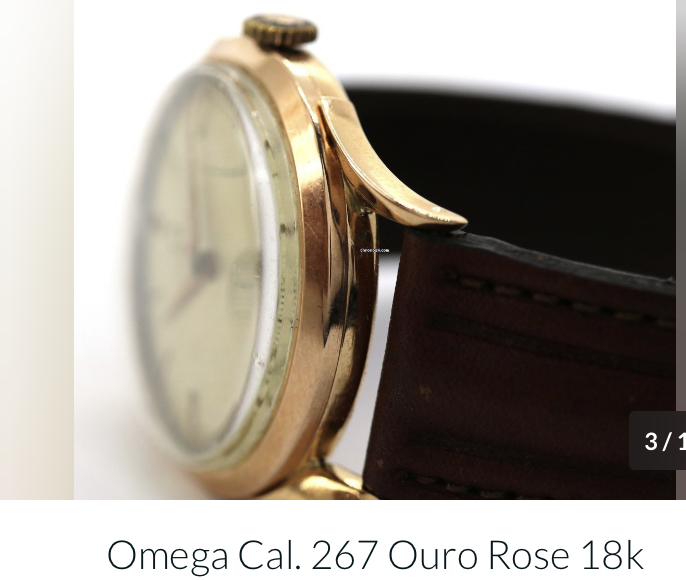

Appears a crack in the crystal, not sure if it is the picture but it’s on all so suggest it’s the crystal
Any advice or guidance gratefully received.
Priced at £516
Thanks in advance
Russ
1,588
12,730

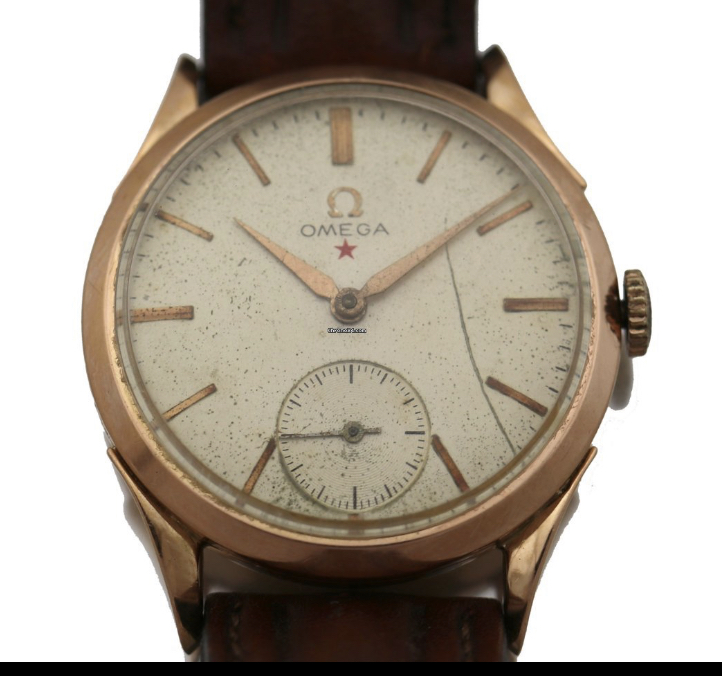

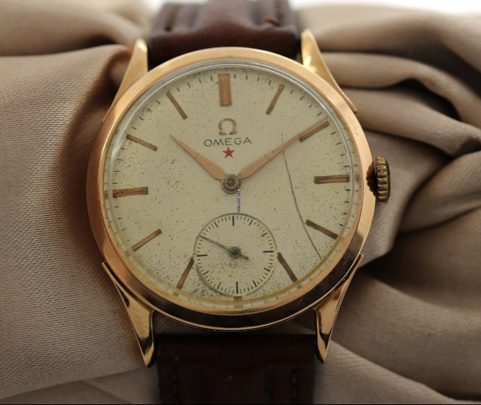

"crack" appears to be under minute hand and not on the glass
80
92
That’s a good spot-thanks!
The seller mentions the dial is Mother of Pearl.
What are the options do you feel? Worth having restored/replaced?
It’s my birth year (59) and I like the look of the watch
Russ

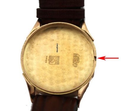

Why is the case marked "Universal Geneve?"
3,790
6,452
The Omega logo is round which is quite new. Not a vintage dial.

Thanks Guys. All good info, may have to pass on this as well!
Will keep looking

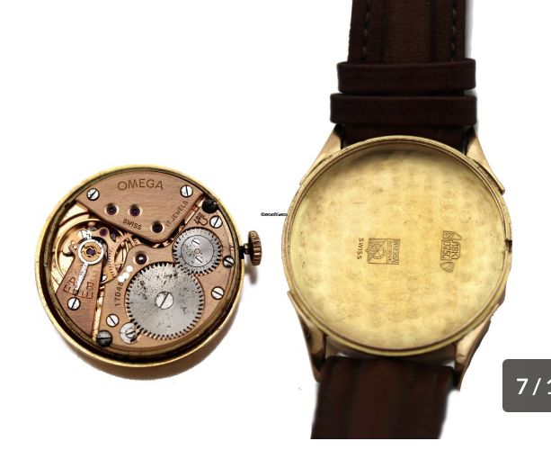

Is it just me or it looks like movement and dial have been extracted from the front? How is that possible, can't br a split stem on a 267
13,493
31,814

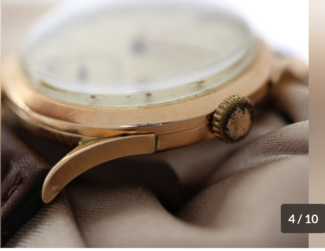

The case is notched with a separate removable bezel.

Mother of Pearl dial ? must be a Prototype in the elusive " SeaHamster" line.....

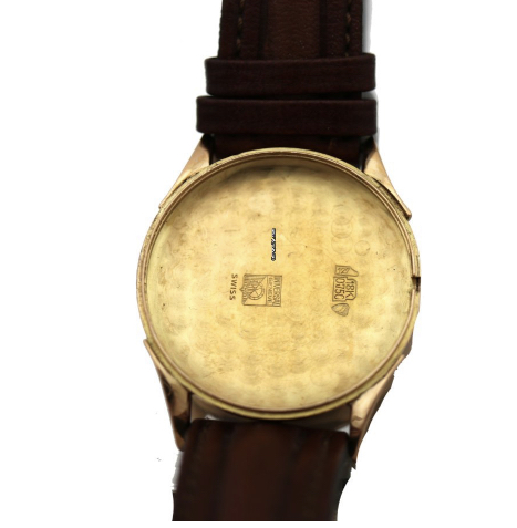

Just out of curiosity, let's see the back. Maybe it has a UG code.
