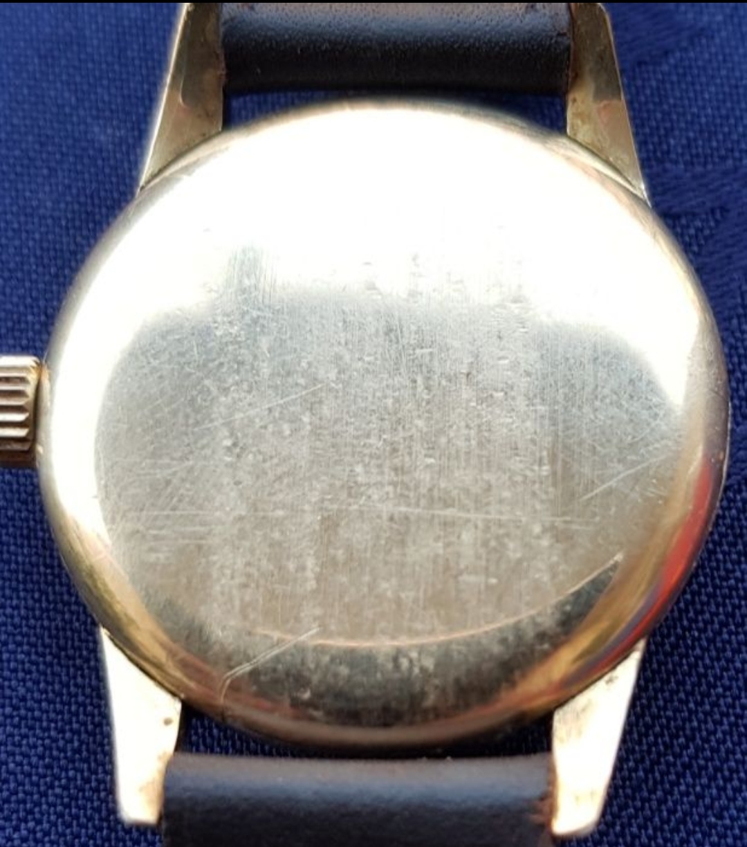

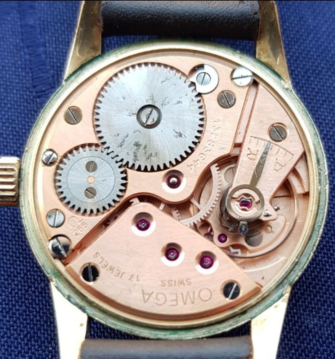

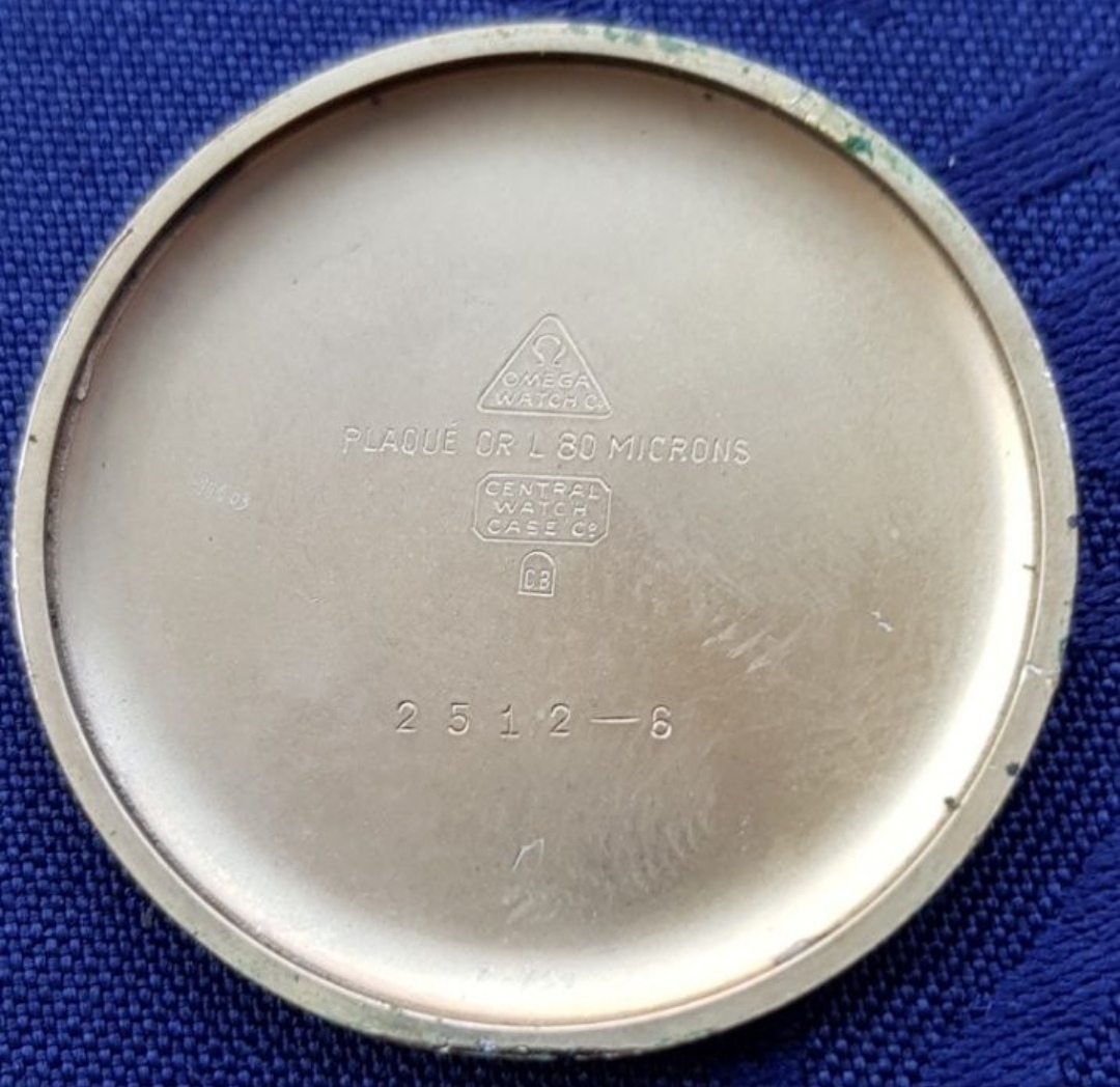

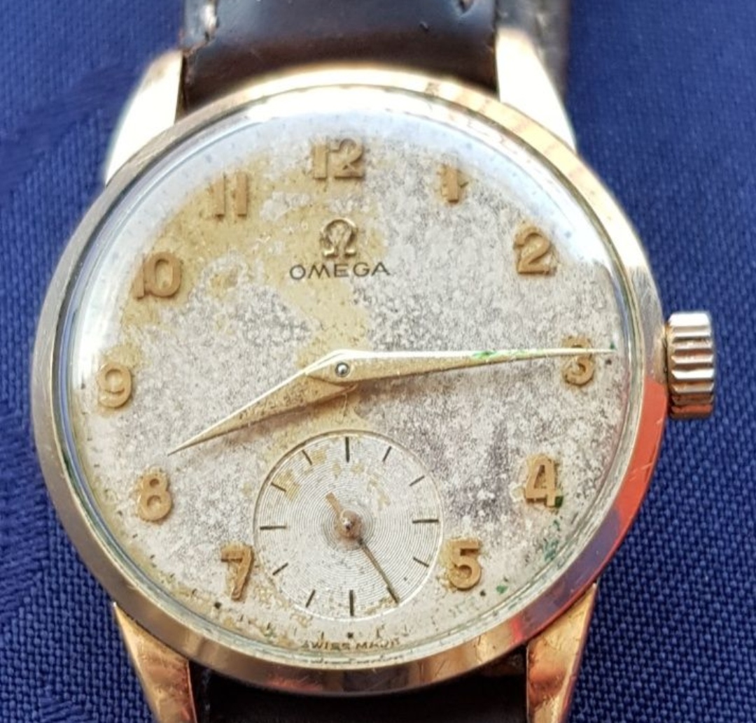

Hi to all!
I just saw these days this watch, Omega cal 266 ref 2512-6 on a local web site.
The seller wants around 260 USD, do you think it is whort the price?
On the other side, I never seen before such a case back.
The pictures belongs to the seller.
Thank you a lot.
Stephan
1,501
5,694
Hello, Dial is completely fried. Case is gold plated, but not worn to much. Movement will need a service but isn't damaged. I would wait for a better piece. If you buy this one, you will probably have to replace the dial. Often those "projects" become a money pit.
