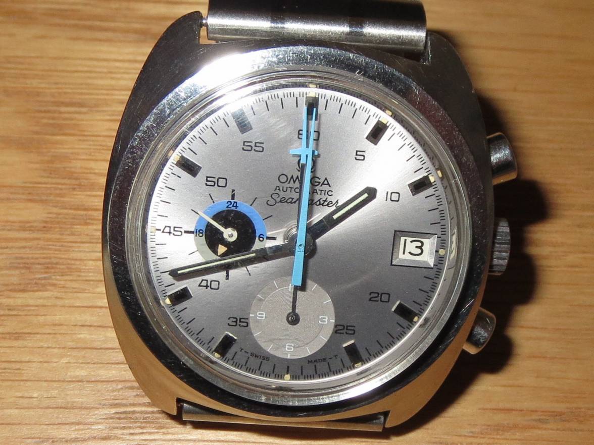

    This is my 176.001 from 1971/2, or whenever! I've owned it for 30 years and have serviced it a couple of times. The 1040 goes on forever with a touch of oil and check. It keeps to +/- 2 secs a day which can be corrected with overnight laying flat. I spoke to a long standing Omega exec some years ago who told me that a couple of hundred of these were made, but the line was quickly 'upgraded' with the inner tacky early on to fit in with modern trends. I like both the .001 and .007 models and any other with the 1040. I think the .001 hasn't dated as quickly as the others. The dials were blue or silver. The inner 24 hr disk should be grey or dark blue/black. They tried a few colours with the hands. These were very much experimental in design so different colour set ups should be expected. This model of Omega is real, did exist, wasn't a prototype, but did get replaced very quickly. This model did not have an outer bezel, as has been suggested. Most of the pics on the web are of the same watch. Given the strength of the 1040, I would guess that a good few .001s still exist.
