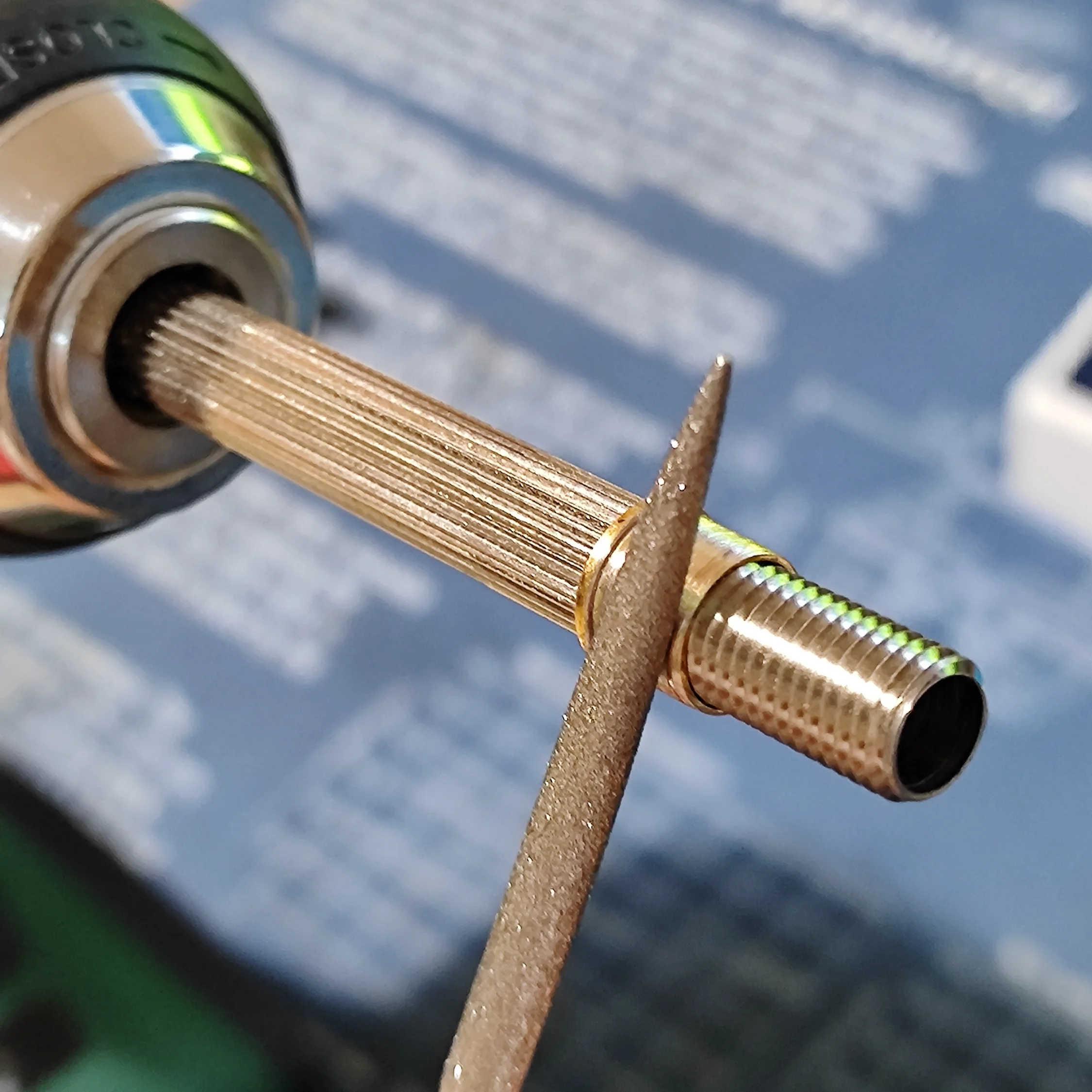

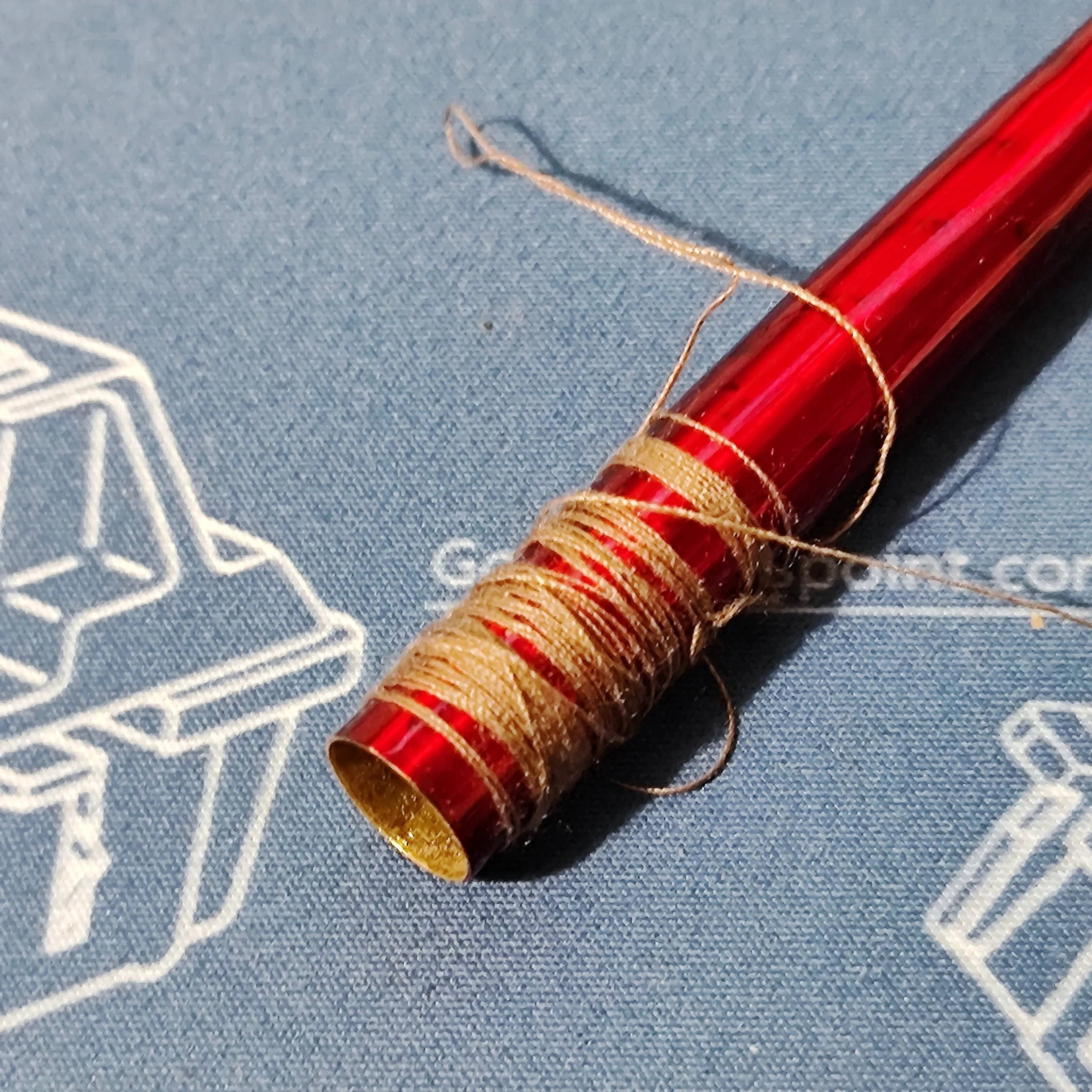

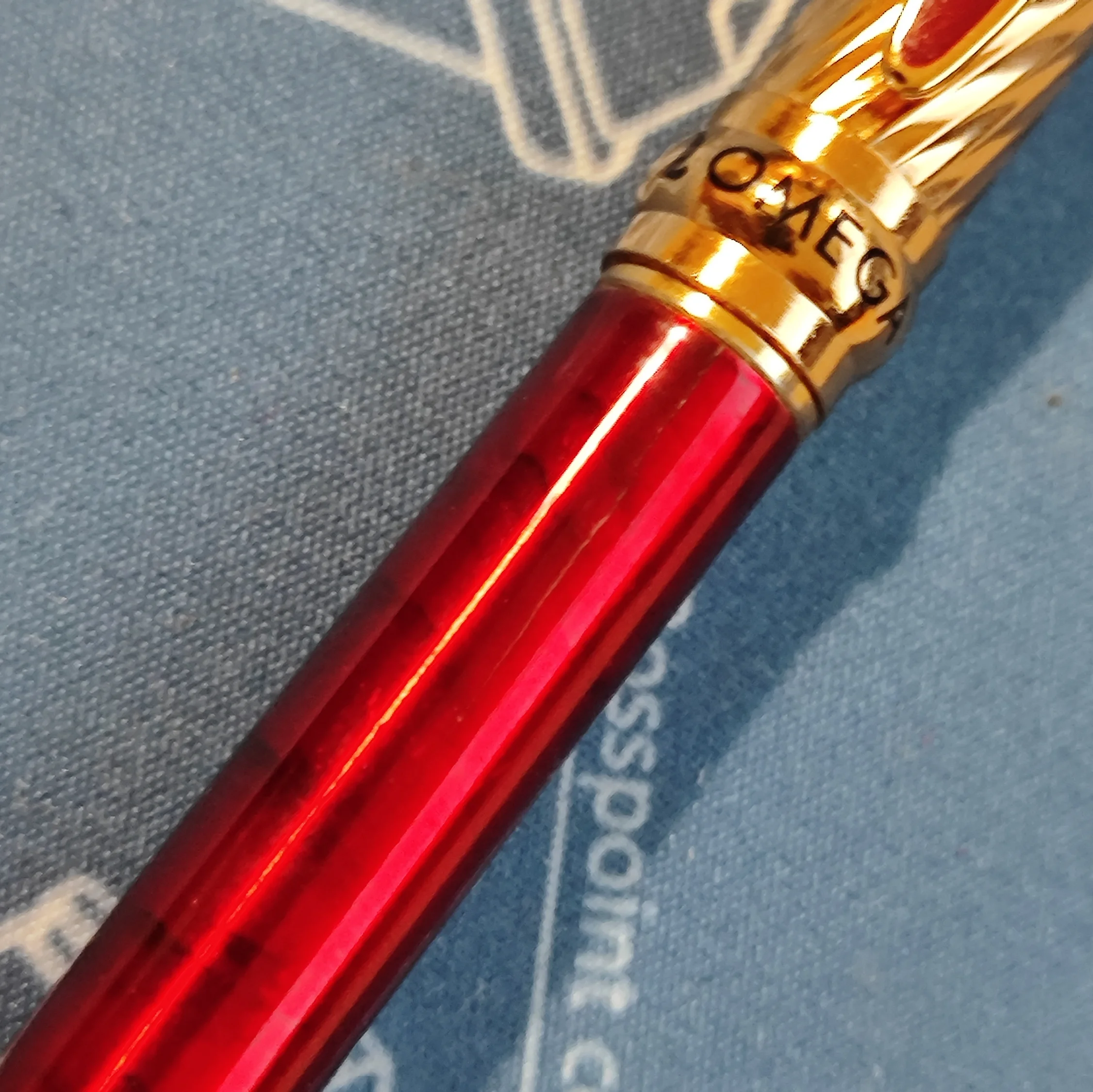

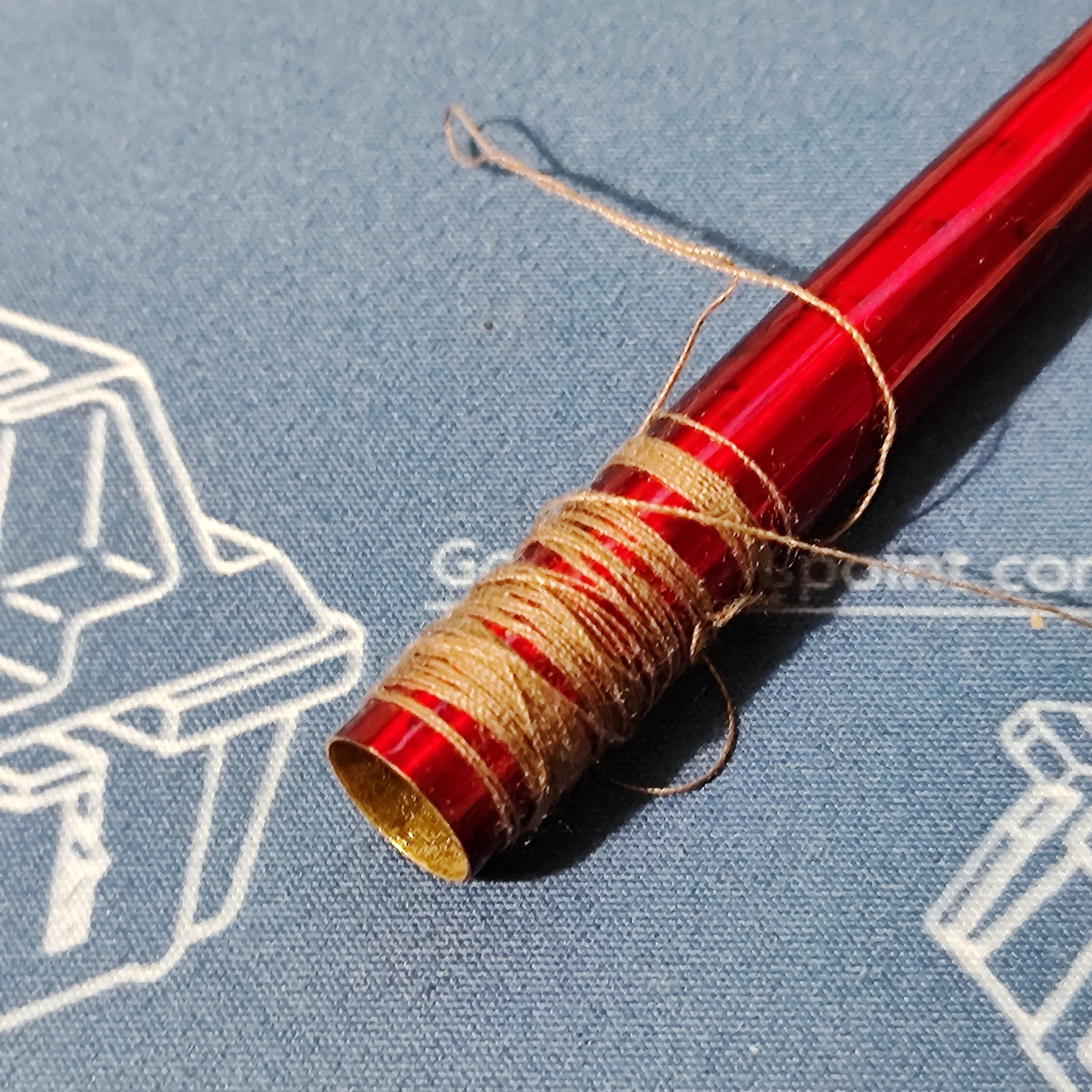

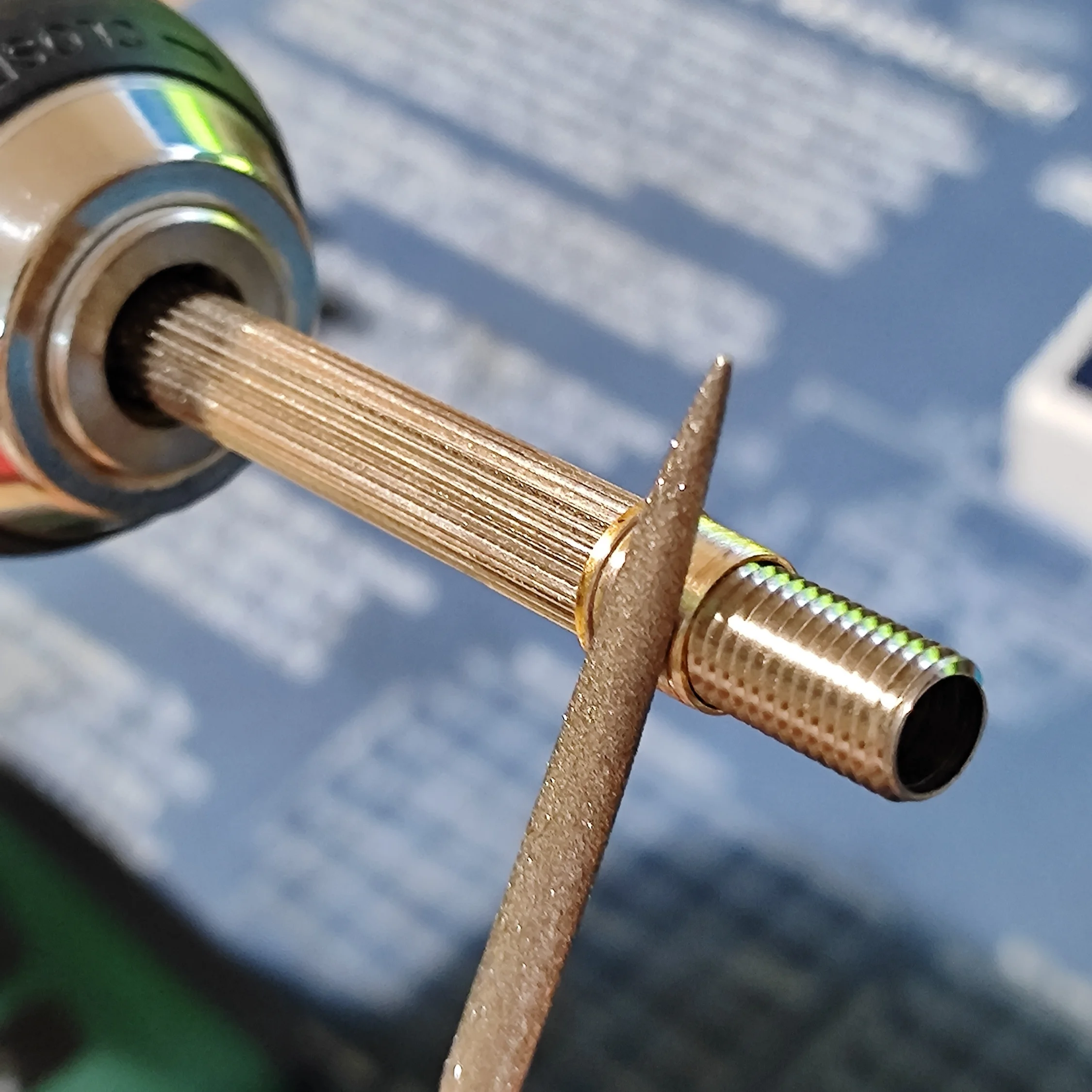

The detached barrel of the fountain pen needed a fix. First I lightly glued the inside of the crack with 5 minute epoxy, cleaning it well with a q-tip. Wrapped some string around to hold it tight.
With a makeshift lathe, removed the glue residue and a bit of metal from the middle section, until it was a relatively tight fit with the barrel. Used a 400 grit diamond file to do most of the work and polished to 1000 grit.
Finally attached the barrel with the same 5 minute epoxy. A thin layer covering the whole surface, resulting in very minimal squeeze.
Nothing too complicated of course, but happy with the result. The crack is there if you know where to look, especially in bright light, but it's as far as I can go.

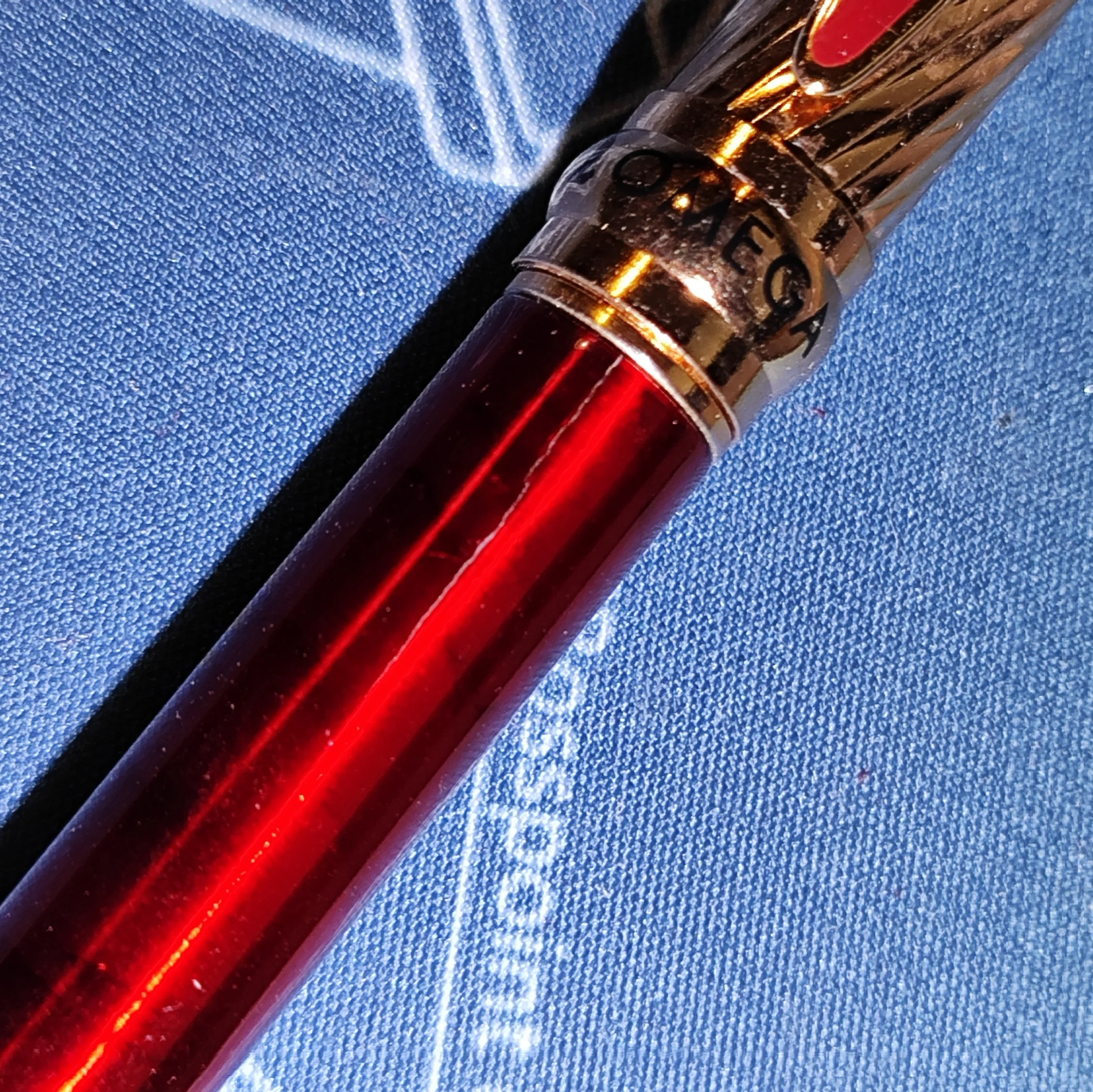

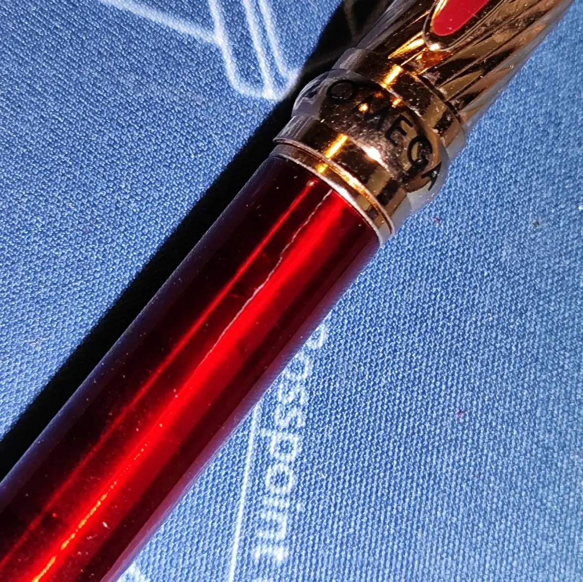

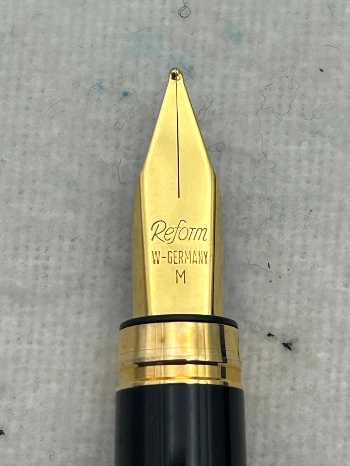

I went and purchased it. It looks like a nice set to my very inexperienced eyes, but that's not saying much. Even if it turns out to be a fake of sorts, I'll probably recover financially 😁

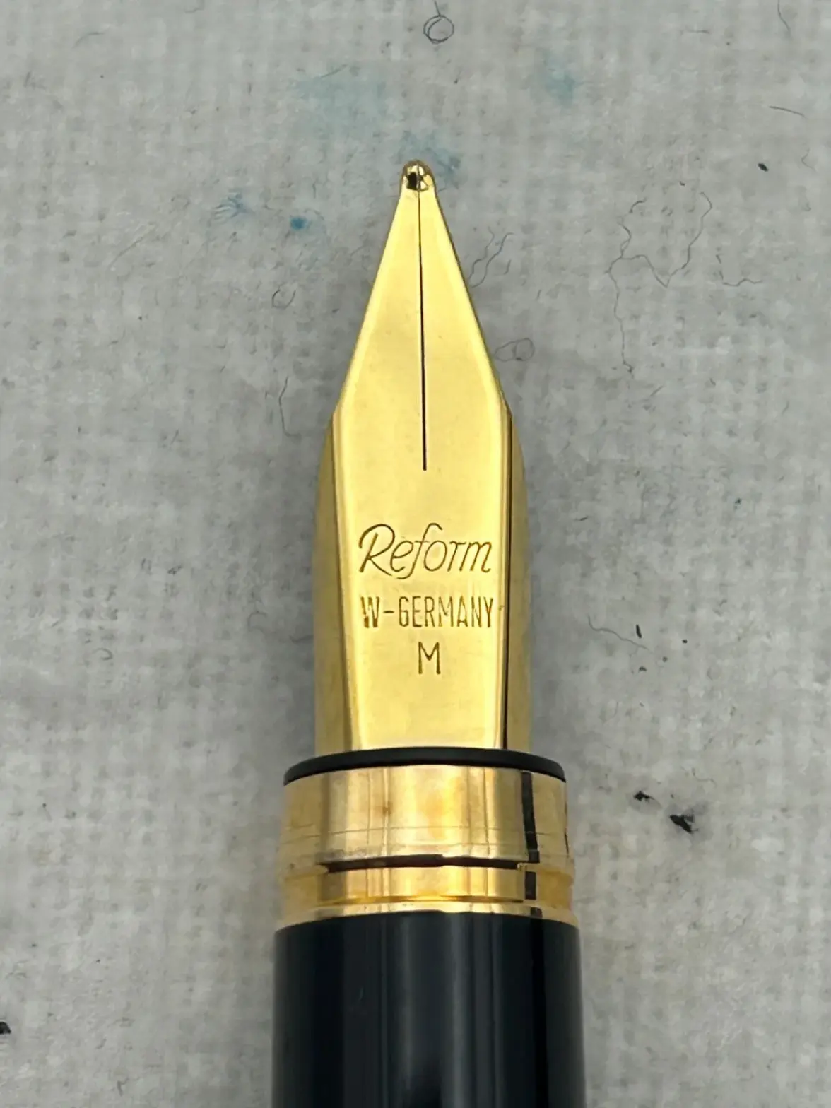

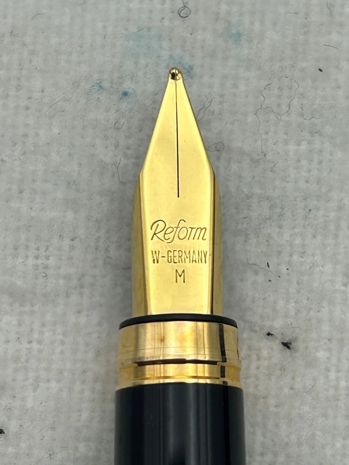

The cap is signed with the Omega logo at the top of the cap, and with the logo and text in the ring. What's interesting is that both the nib and ballpoint cartridge are signed Omega and West Germany.

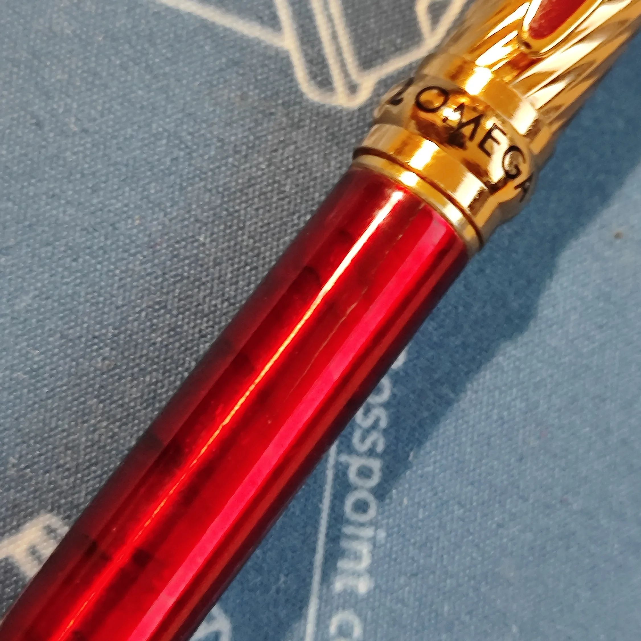

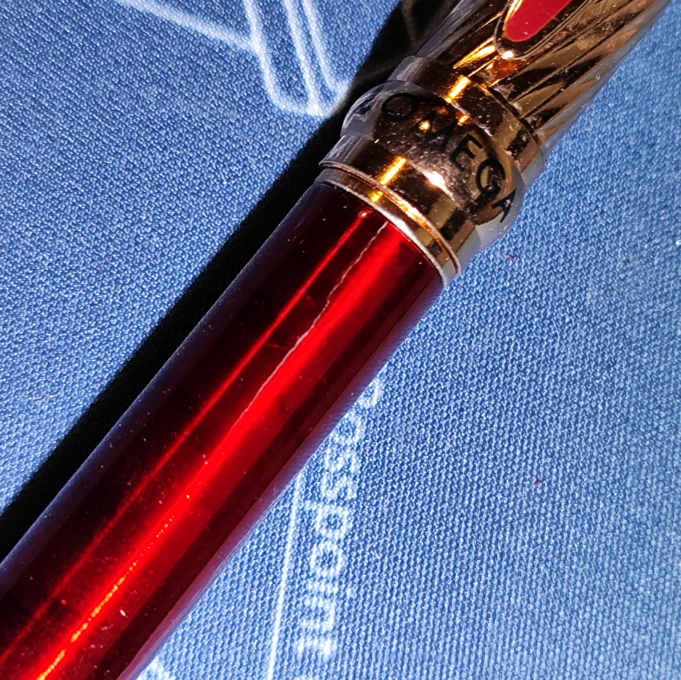

The fountain pen barrel has a hairline crack and is detached from the middle section. Found myself a side quest to repair it.
My first thought after seeing the nib on the fp was "Lamy?". If so, it may require Lamy cartridges/converter. Something to consider if standard does not fit

I discounted Lamy after not seeing the 'pin' holes that their converters typically use for retention, but perhaps? West Germany could be: Montblanc, Pelikan, Lamy, plus a few others. At the time there were plenty of pen manufacturers out of West Germany though, so its tough to tell.
See: https://www.ebay.com/itm/126721864922
Which has a VERY similar looking nib. Given the off-centerness of the slit cut, plus the general format, I'm guessing it is one of the small-W-German manufacturers, which are almost definitely going to use Int'l Std. BUT, we will see 😀
Understood on the pin holes. It was a quick glance for me based on nib shape and W Germany, nothing more. Hope standard converter fits and makes life easy!

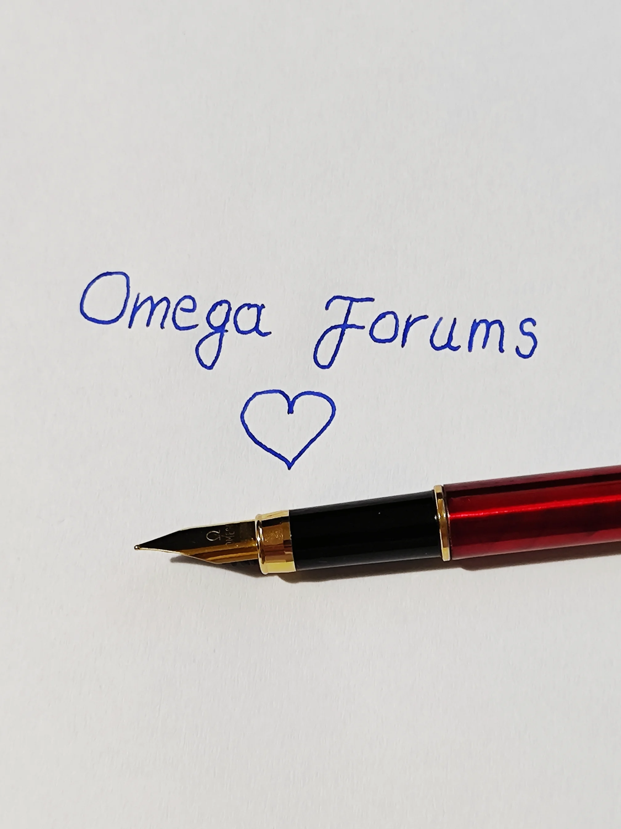

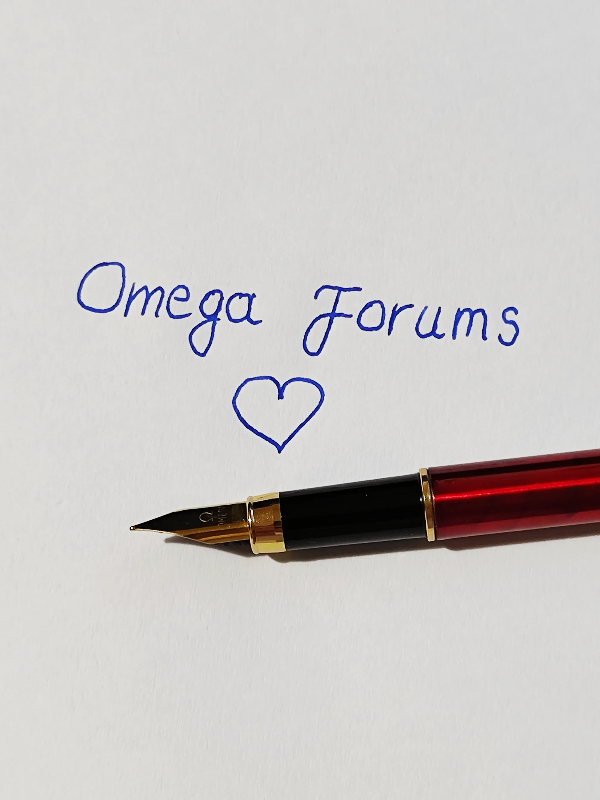

Int'l Standard it was! Excuse my first grade calligraphy, but I hardly need to write anymore.
The nice part is converters are dirt cheap, and some really cool inks are available! I'm a big fan of various sheen inks. But there are plenty of really interesting ones! Samples are available for a few bucks from a few places, you can get a good variety cheaply!
