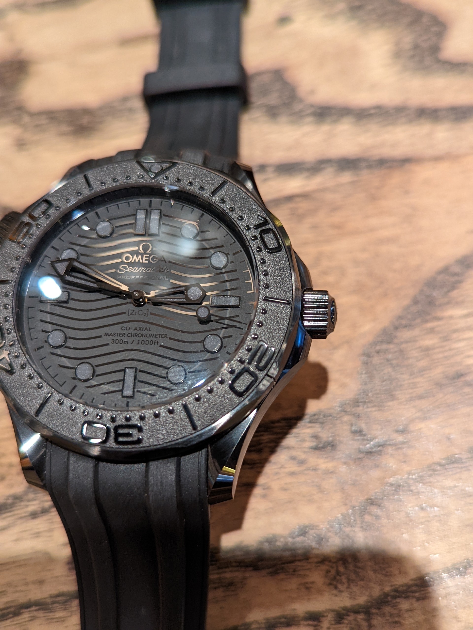

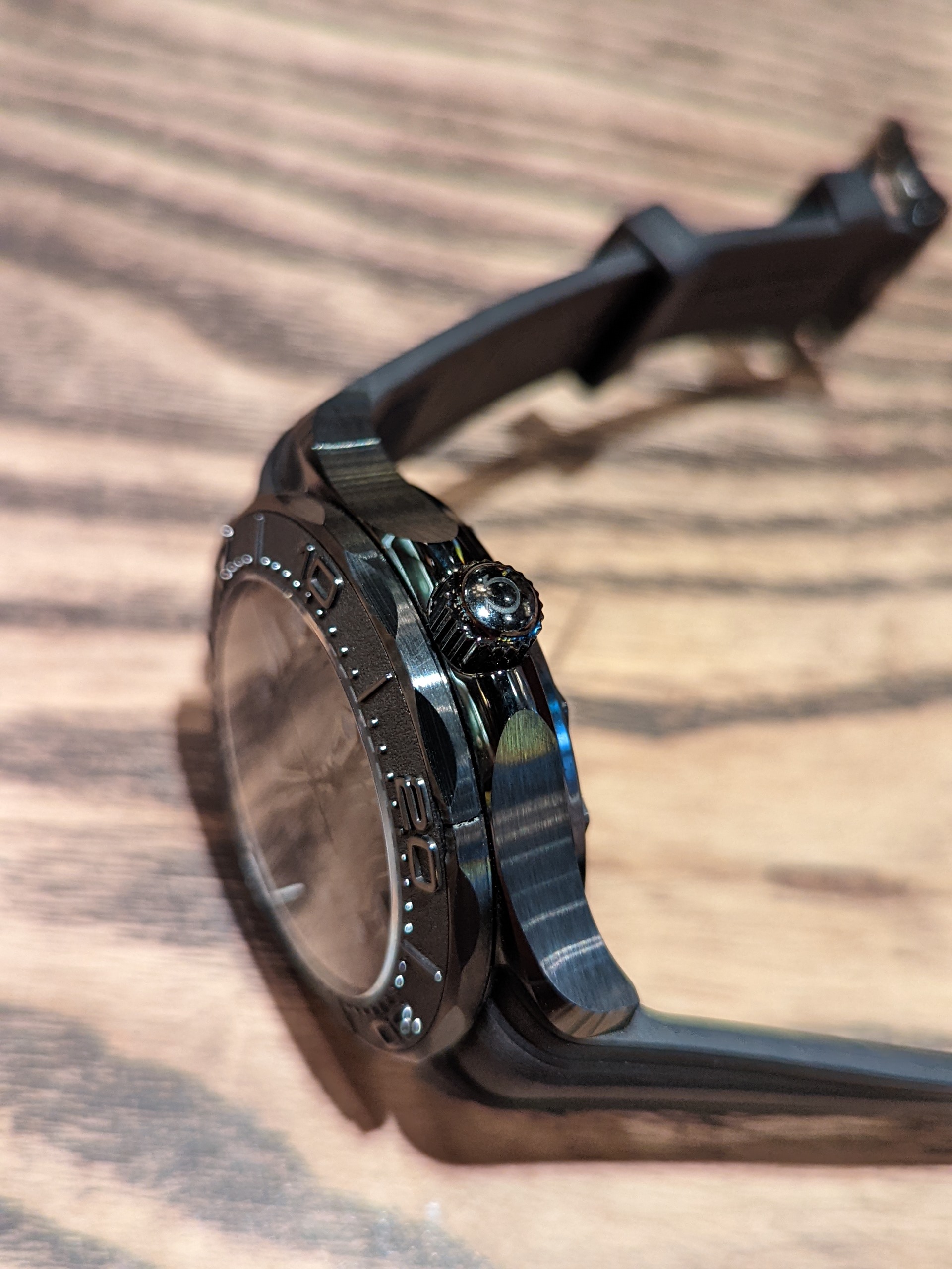

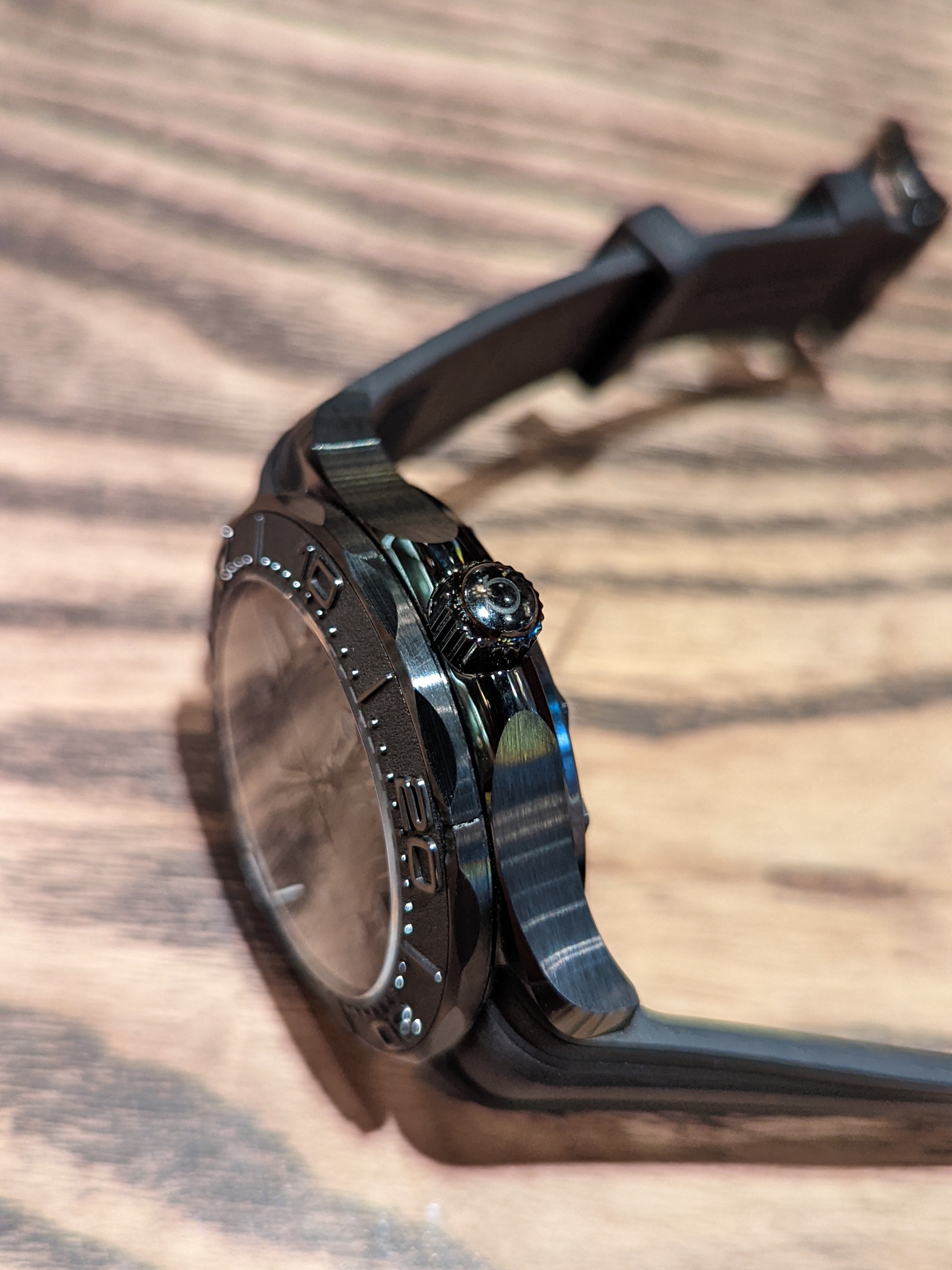

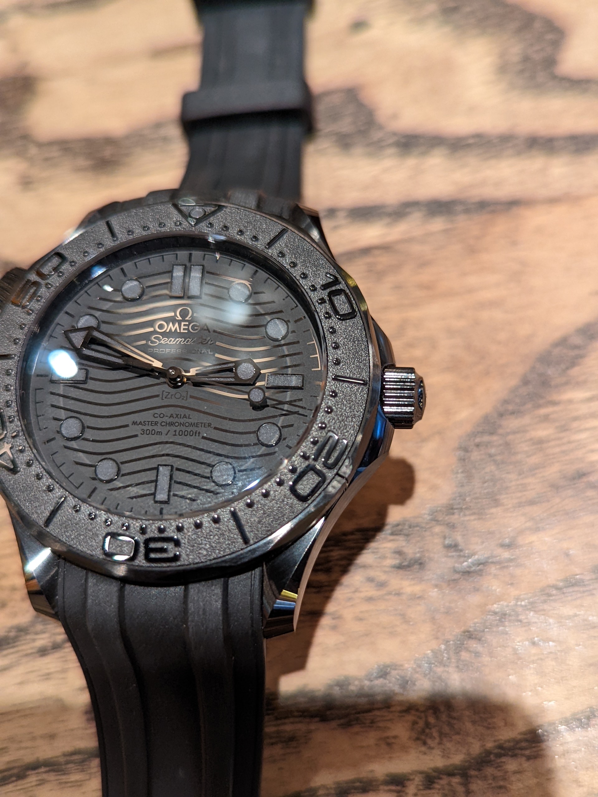

My bb ceramic seamster somehow slipped off my wrist and dropped on the bathroom floor .At first glance i though it was fine. But after closer examination, the ceramic bezel was broken at 4 o'clock . Took it to Omega HK service center, replacement of the bezel was quoted around USD 2000. The bezel can still turn, should i replace the bezel? Just bought the watch in less then 3 month, kind of worry i will drop it again after replace it with a new bezel.

Ok, so I had to really check the photo before noticing the crack. The chipped pard has the same texture as the insert, so you can't really tell unless you really focus on that point. For 2K, I would stick to it. Think of it as wabi in terms of scratches that you can't get on the ceramic case

I'd secure it and wear as is. Secure: place the watch between 2 books ( or else..) lug at 7 o'clock down. Turn the bezel until the crack is vertical up next to the crown. Slip a thin piece of plastic or even metal / Foil under the bezel at this location. Buy Loctite 406 super glue only. Use your finest screwdriver / sewing needle and place a very small drop inside the crack. It will not go far into the crack , but seals both parts. Do that immediately again until the top of the crack. Maybe not necessary , but no harm. After the setting time ( around a few minutes only ), remove that divider ( plastic/ foil...) . Let it dry one day. Then you can use one of these 4 sided nail polish files to smooth it . If it stands out, one drop matte black paint will do the trick. Good luck !
