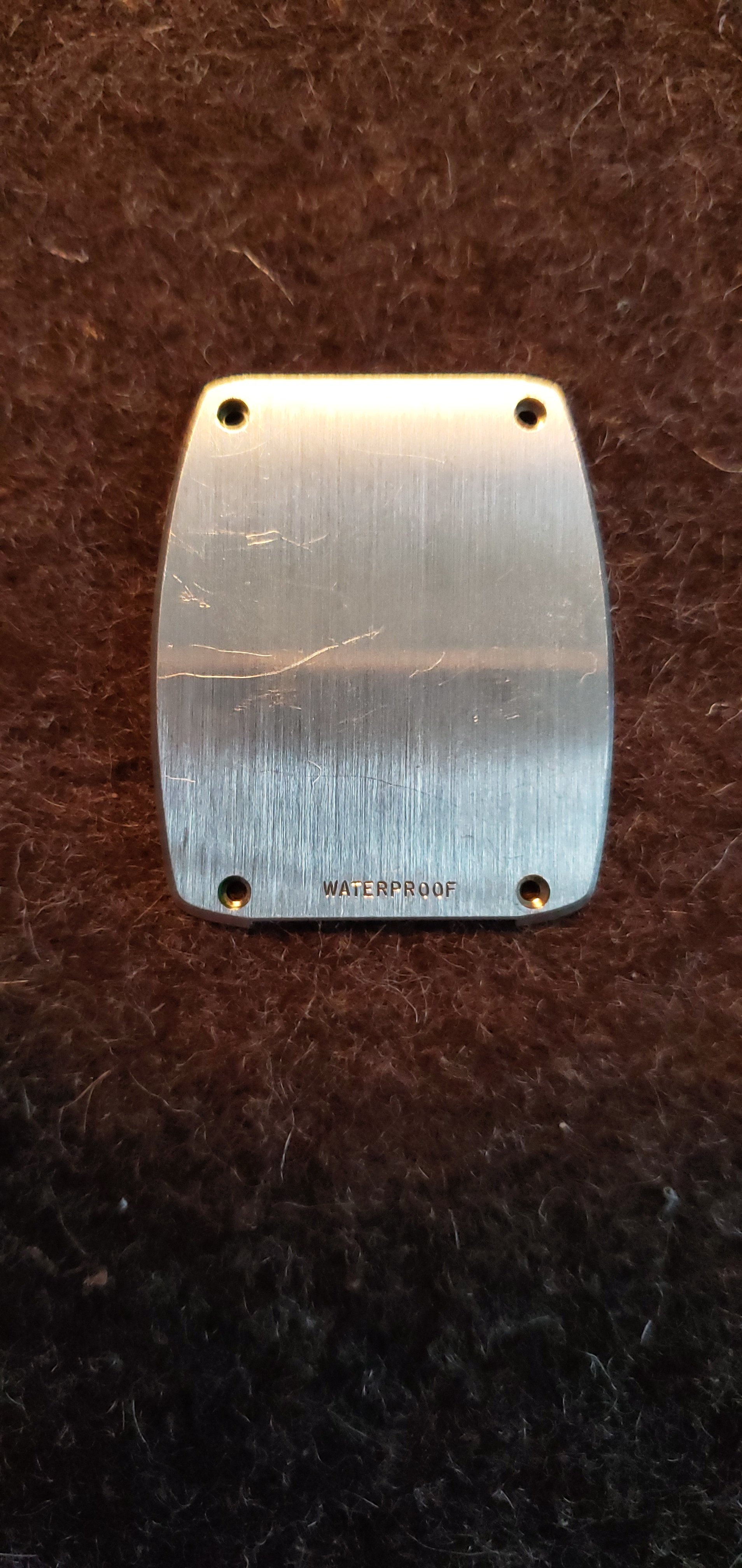

    Dear All:
    Due to the kindness of a well-known forum member, I was alerted to an Omega Beta 21 for sale. It was in great condition but without a movement shot. Nonetheless, I bought it hoping for the best.
    Just received the watch and the case back gasket has turned to sticky goo. Spent a long time cleaning it up and it is ok now - i think...as i'm not experienced at this at all.
    May I ask where to buy a case back gasket for the Beta 21 rectangular case please?
    In the meantime, is it safe or ok to wear the Beta 21 without a caseback gasket?
    Thank you!

    What is the case reference on the back cover?

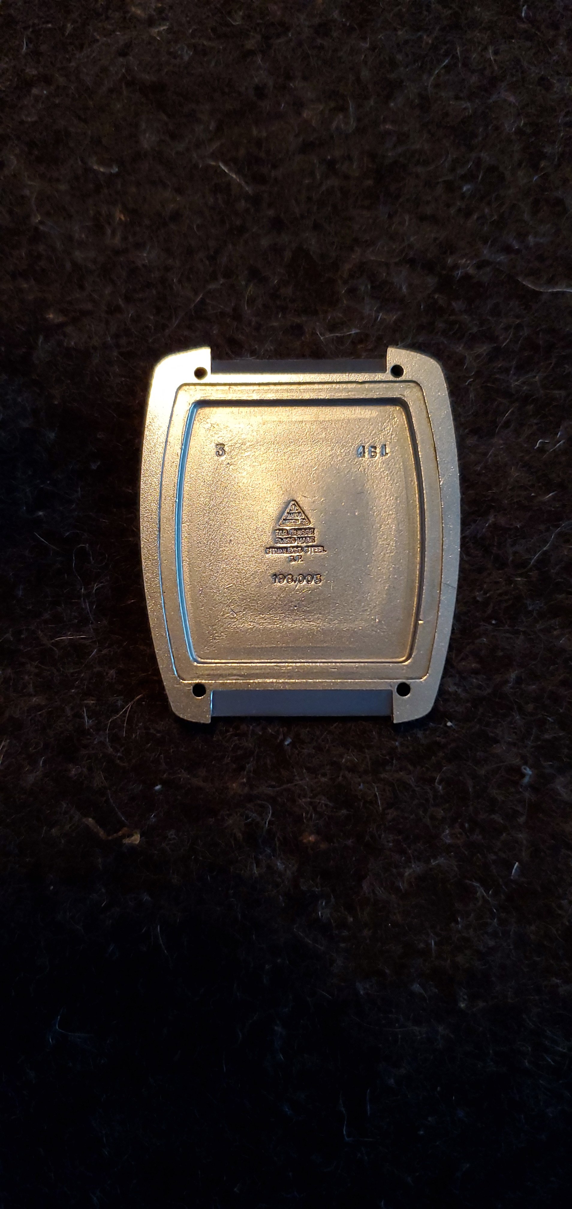

  3. Dualmonitors May 20, 2019
    80
    63
    @Chewbakkk Thank you kindly for your reply. Here is the case back (attached pictures below):
    196.005
    The issue is: these gaskets for this particular reference must have been made back in the 1970s, and as such, wouldn't they all have either hardened over time or became gooey as well?
    What should one do?

  9. Archer Omega Qualified Watchmaker May 21, 2019
    26,441
    65,457
    Omega still sells the case back gasket - part number is 088NS0104.
