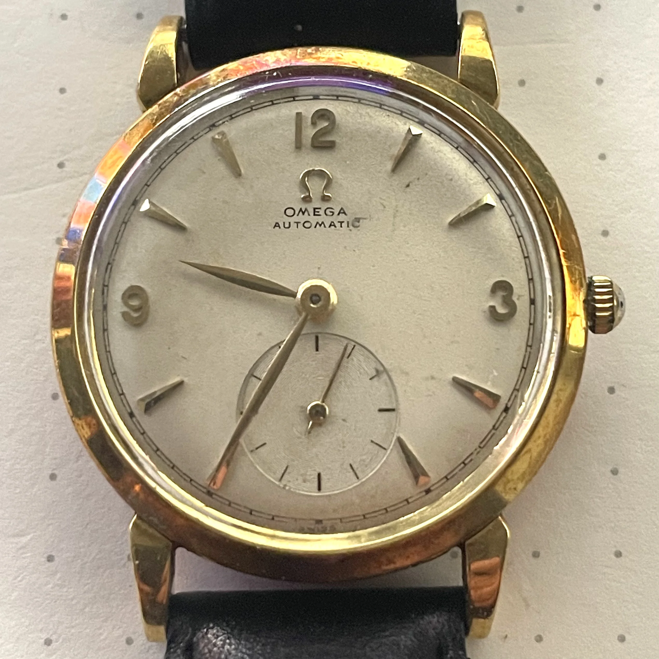

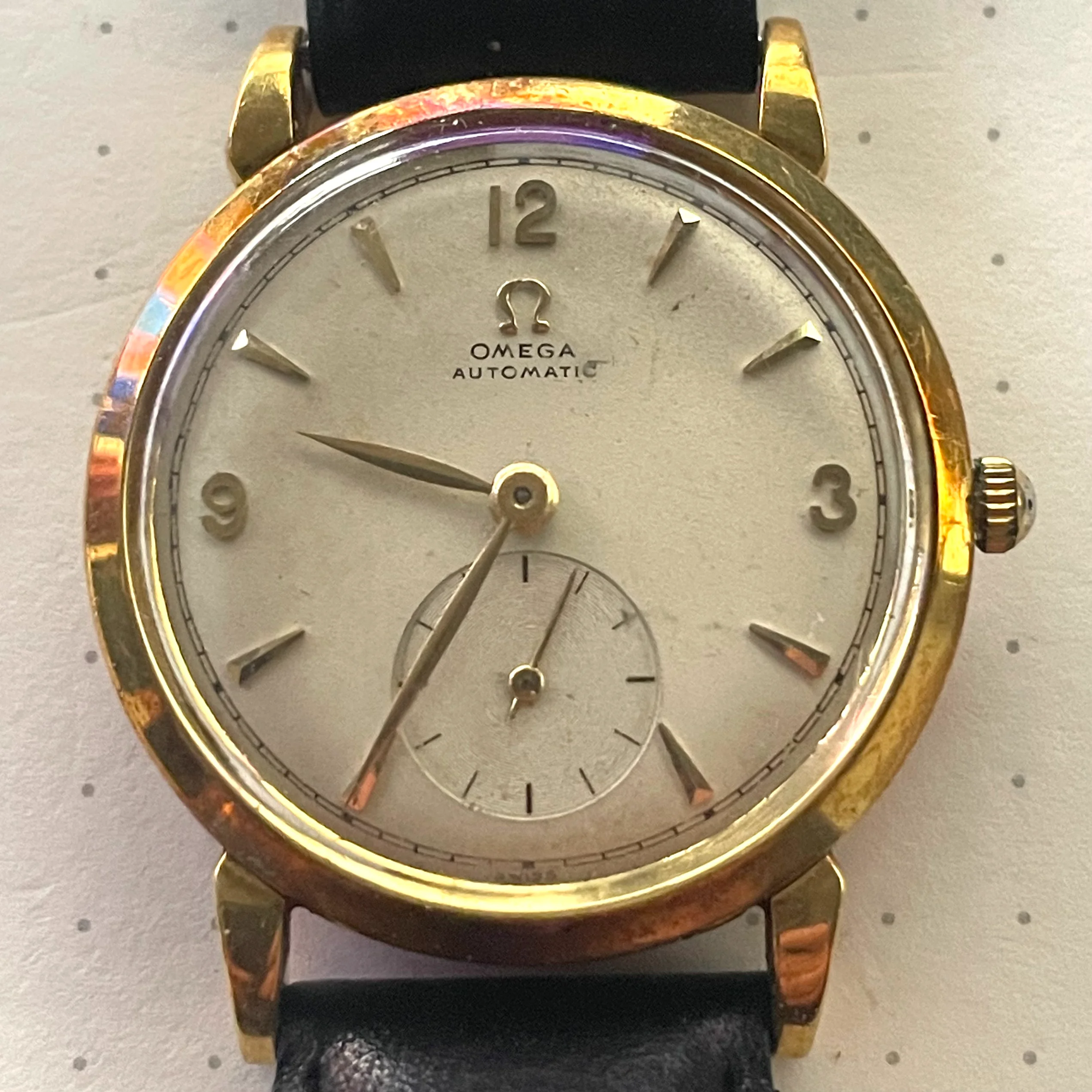

Hi there,

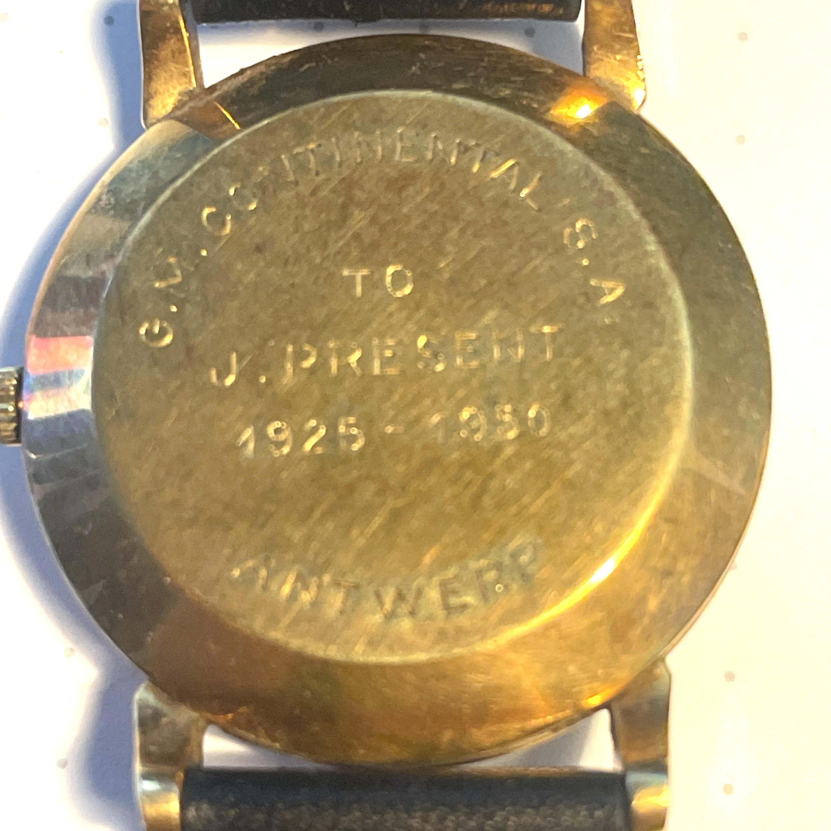

I have an Omega Automatic that the second husband of my father's godmother received in 1950 for 25 years of working at GM Continental in Antwerp, Belgium (inscription on the back). The mechanism is still working after 75 years, but it is running a bit behind during the day. According to a watchmaker, this is normal because the internal messing/gold has been worn out over the years.
I have the watch myself for nearly 30 years wearing it occassionaly.
The only information that I have is the watch itself.
I was hoping that somebody on the forum could tell be more about the type and the history of the watch.
I would also love your idea on the value of this watch.
Thx a lot.
Erik

Something off in the translation. There is no gold in the mechanism. The bearings are steel pivots what turn in synthetic ruby holes. If there is no lubrication the steel can become deformed over time.
After 75 years it probably needs a service. Most likely this was done by prior owners as it was standard practice. Omega watches are excellent timekeepers and usually have a constant rate when cleaned and lubricated.
Need to see photographs of inside the caseback and movement to get an idea what the reference is. If the case is gold, there is often a hallmark between the lugs hidden by the strap.
