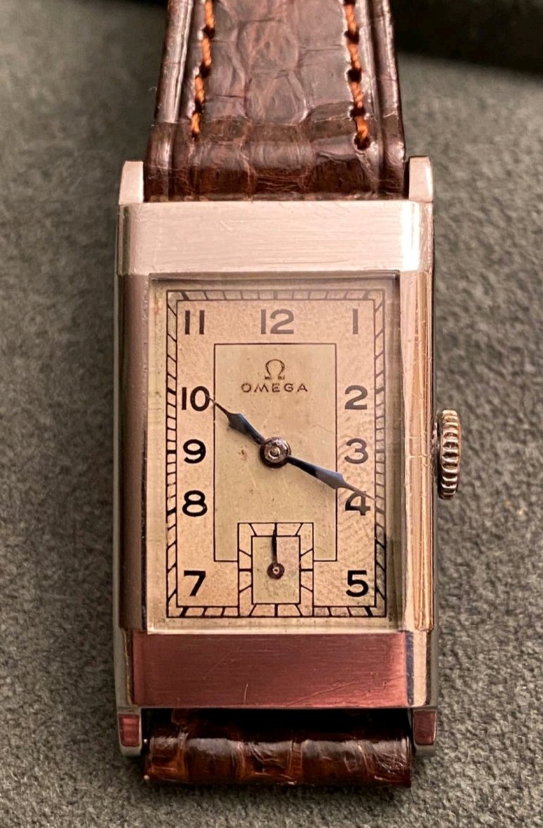

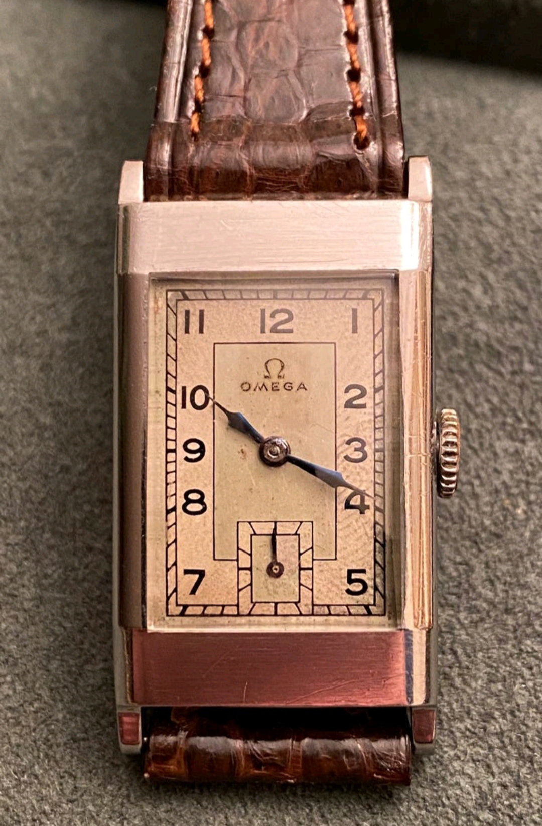

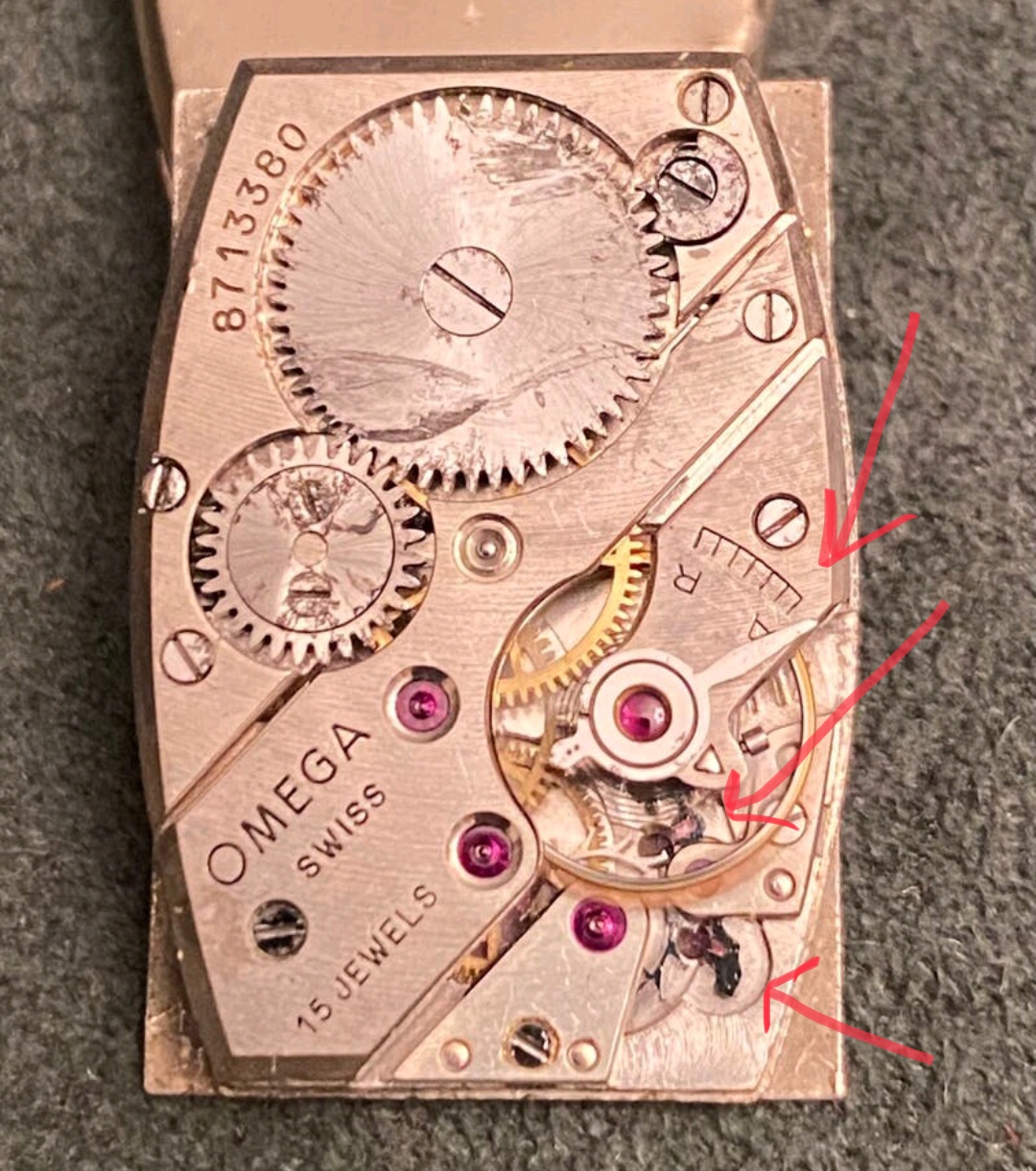

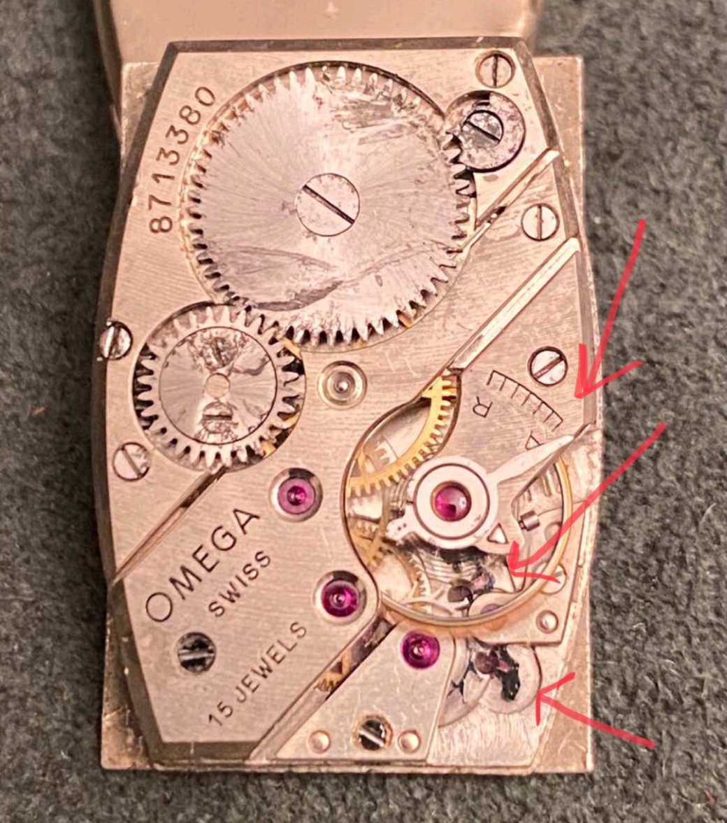

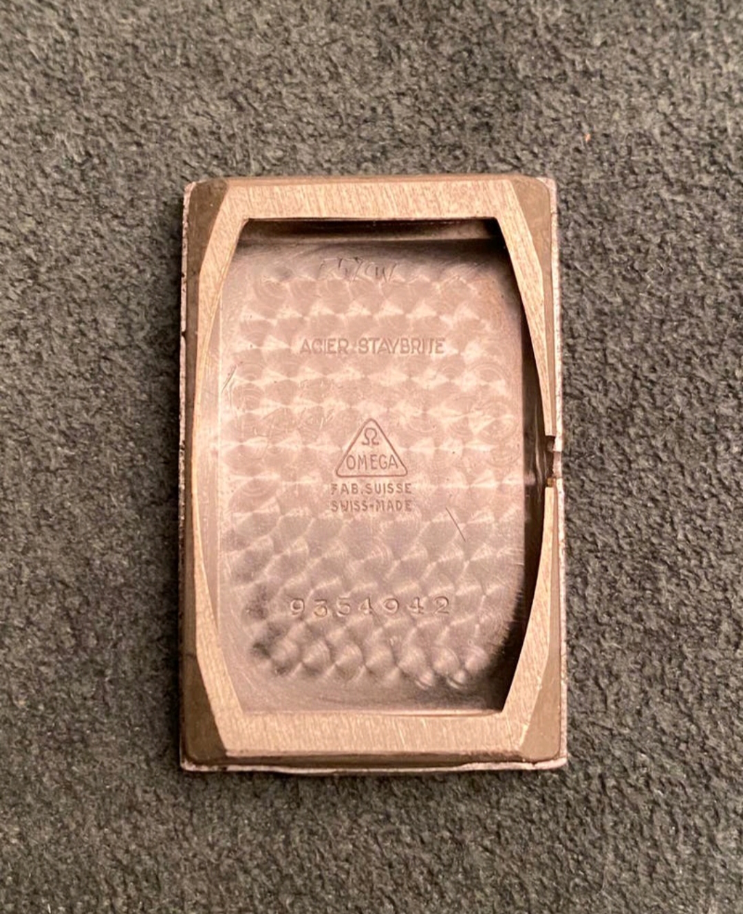

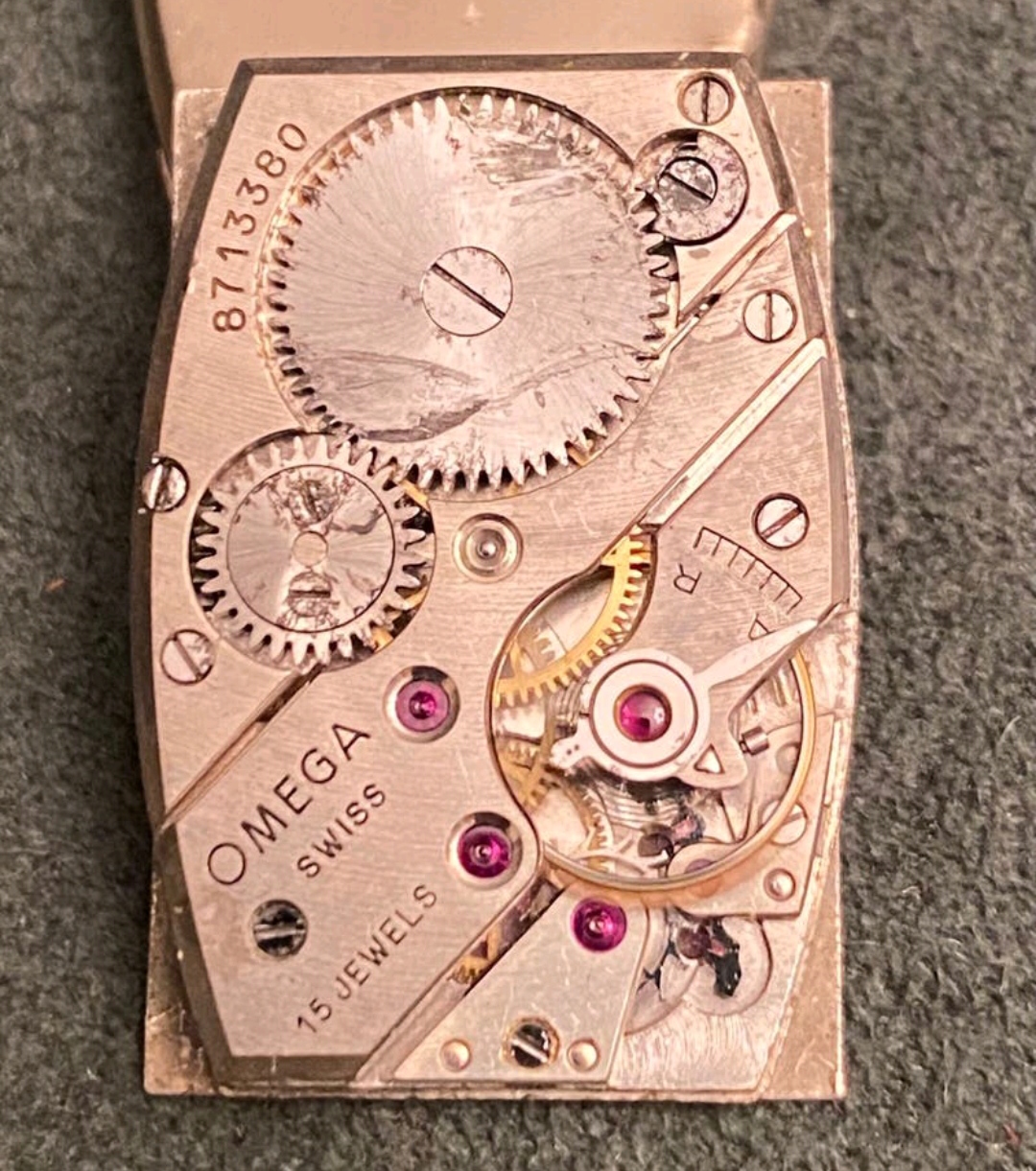

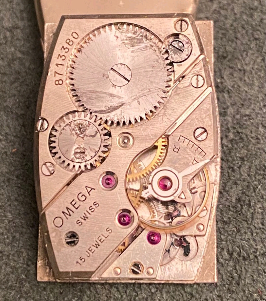

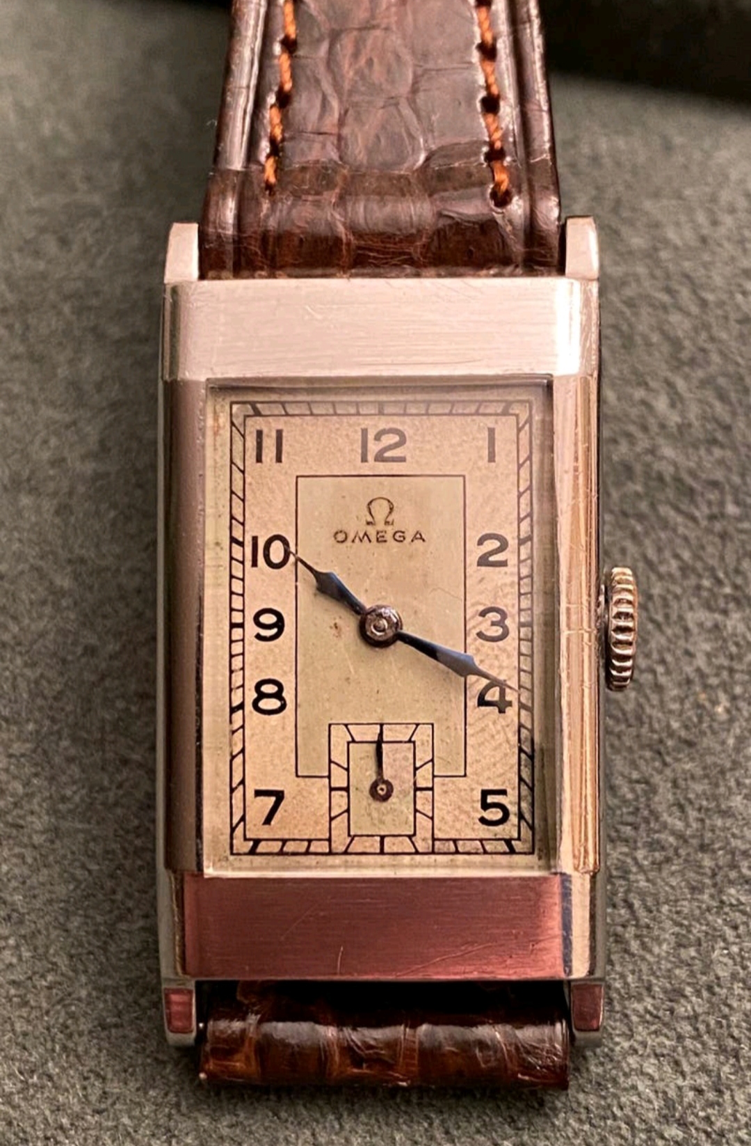

good morning. I ask for help from the experts regarding this 30's omega. How do you like the conditions and what can be a fair purchase price? thank you all in advance

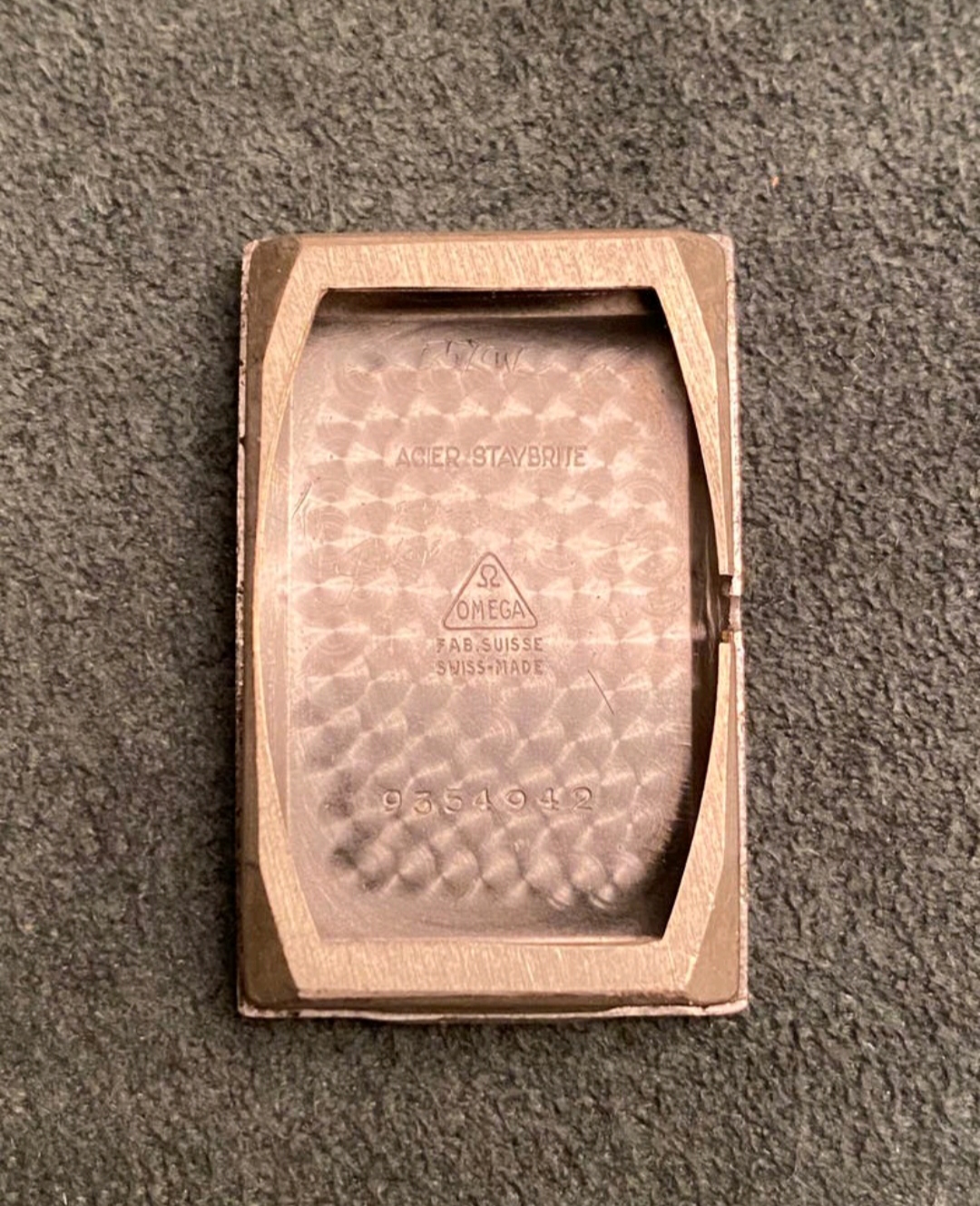

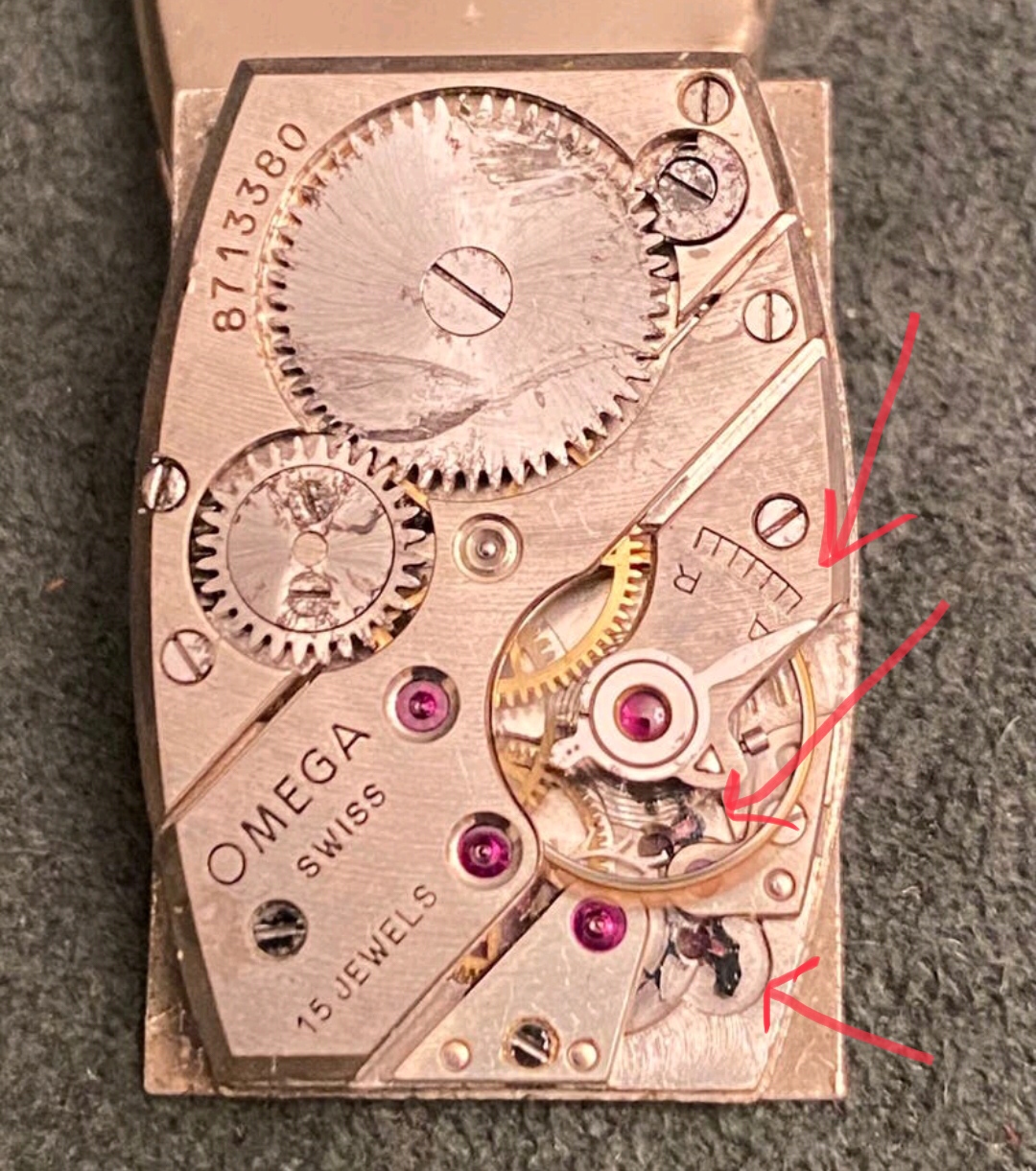

Black goop. Regulator off scale. Definitely needs a service, it’s a beautiful watch. Should a Staybrite case look so “gold” it is not marked as plated.

Looks correct so far. Dial. Hands. Case. Movement is another story. Service with parts needed not under $ 400.
