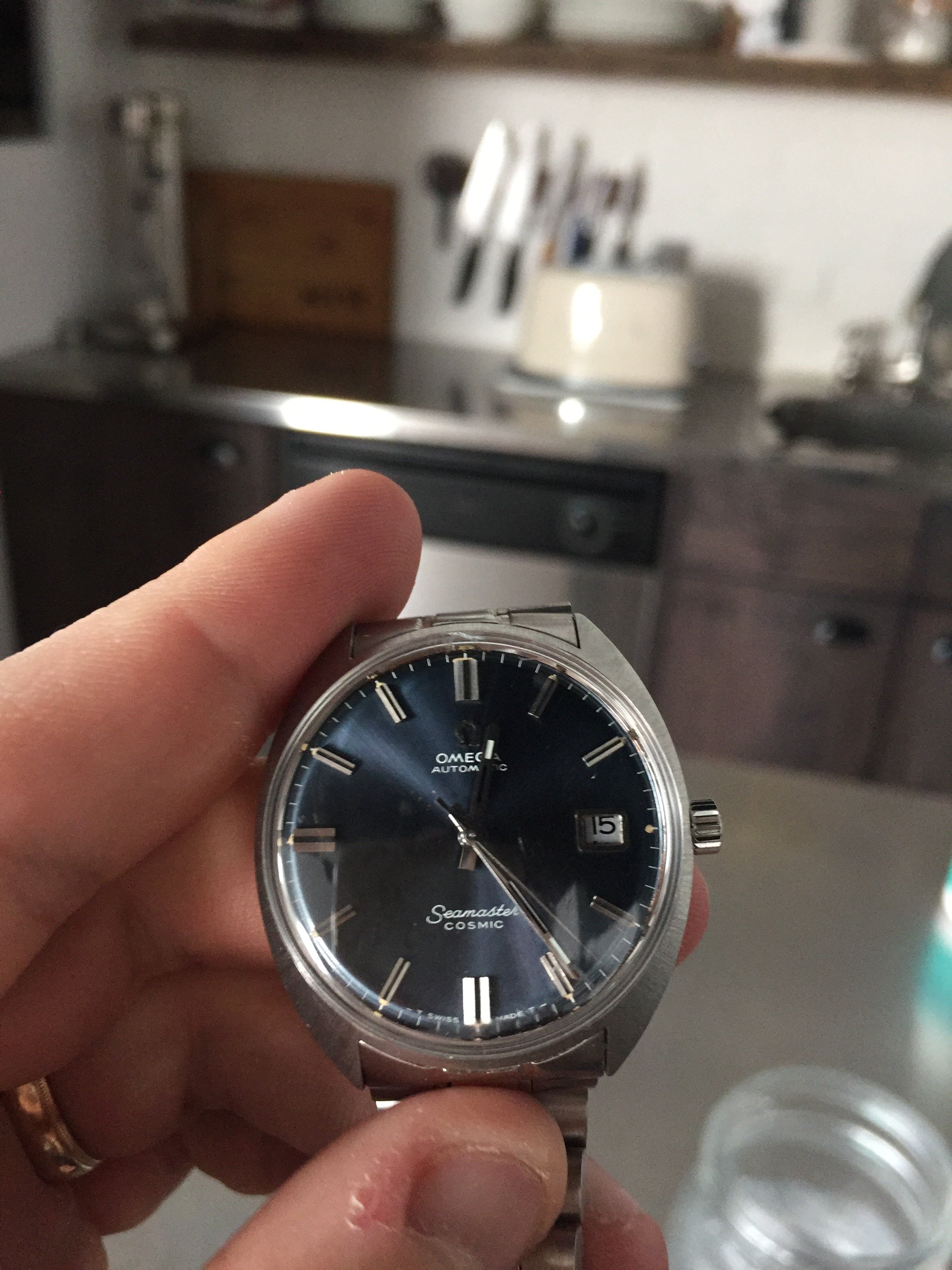

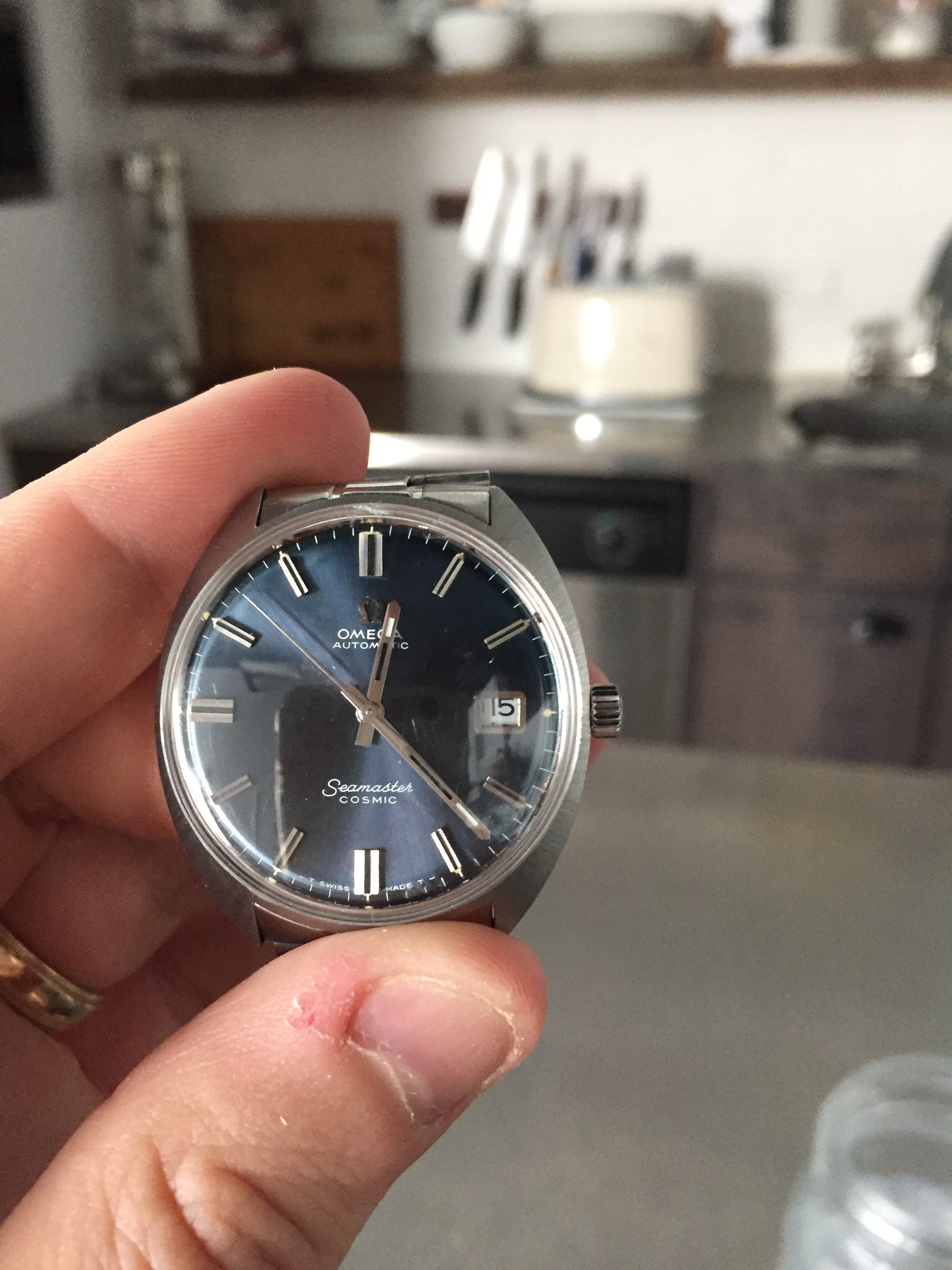

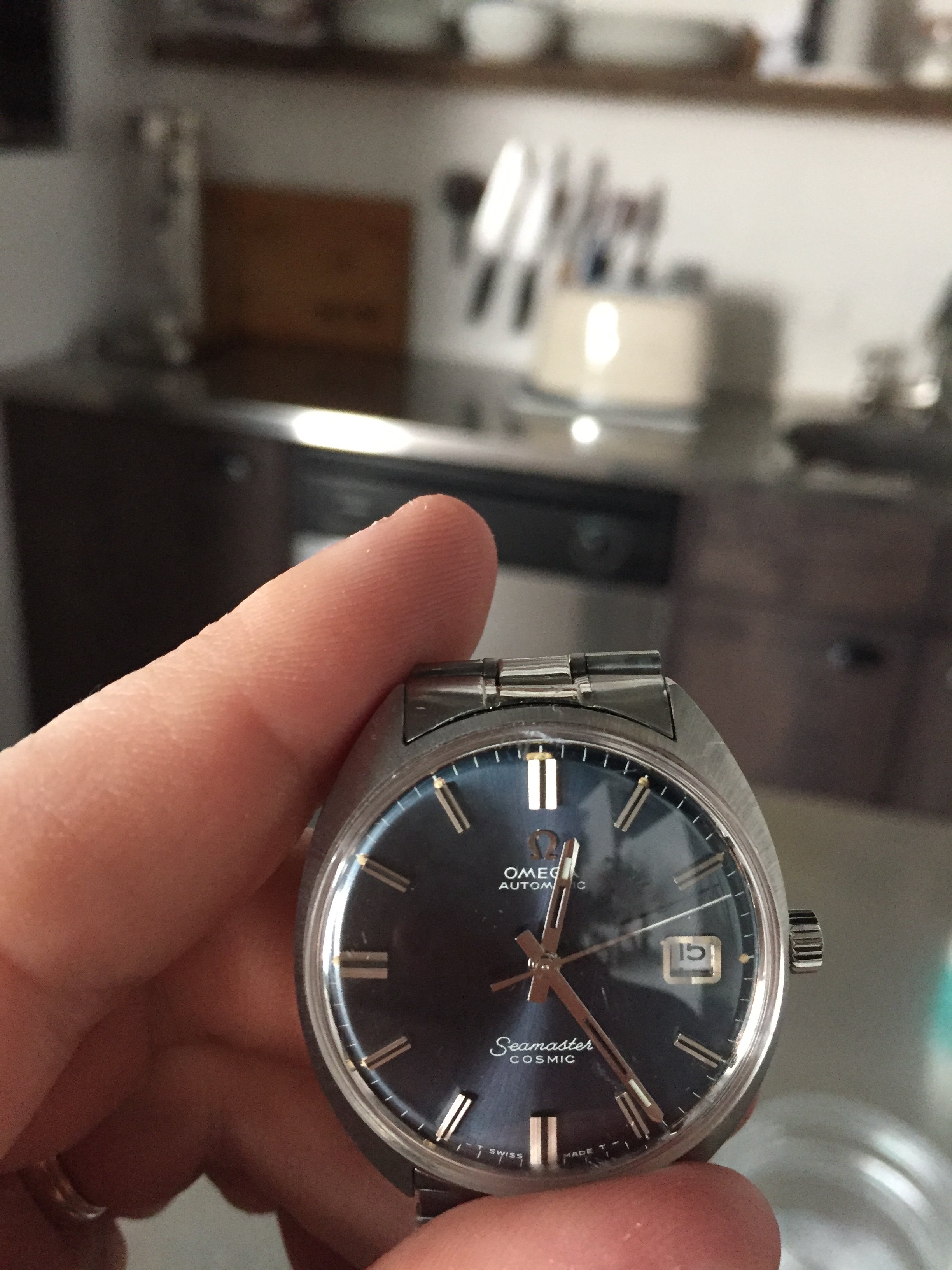

Hello, denizens of the Omega Forums. I have owned my 166.026 for a few years now. In all that time it's been an incredible watch. I bought it with unknown service history and some less than stellar timegrapher readings so in May of last year I sent it off to Omega for service (before we start that rant I know the common problems with sending watches to Omega. I didn't get duped, I had my 'reasons'). The watch had to go to Biel as the service center in my country couldn't work on a watch of this age. It came back in good shape, well regulated and despite the cost and the 6 months it took, I was relatively pleased to know that the watch had been taken care of for possibly the first time in a few decades.
Fast forward a few weeks and I go to pop the watch on my wrist before starting the day and I notice the date window is a bit cockeyed. I chalked it up to bad luck and assumed that the power reserve must have just picked down at an awkward time and not had the power to push the date over. Frustratingly it has been doing this about 50 percent of the nights now. The quickset seems to work perfectly, so does the watch when I manually roll the date over through the crown.
Somethings that I have noticed. When I change the date manually by rolling the time forward through the crown the date finishes changing with a kick near 1 am. A similar thing seems to happen around 2 am when I leave the watch to its own devices although it is obviously less powerful or complete. I am not an expert when it comes to watches or movements but I have been very alert in changing the hours to near 6 before operating the quickset date after the watch has been sitting for a while. None of this was a problem before sending the watch in for service.
Does anyone here have an idea of what could be wrong with my watch? I did some googling and this does not seem to be a documented problem with these movements. I want to have a decent idea before I send the watch back to Omega as I am worried that they will take it out of the package spin the date over, try the quickset see those functions are working and send me back my broken watch.

I'm no watchmaker, so I won't be able to explain to you what the mechanic reason for this phenomenon might be. Do note this though: The point at which the date jumps over can be adjusted, and after a service - especially once that's very much on the pricey side of things - I'd expect this point to be exactly 12 o clock. Also, it doesn't seem to be a very difficult process. I remember buying a cal. 565 Seamaster from another member here a while ago, it ran beautifully - except for the date, which jumped over at 2am or so. A visit to my watchmaker fixed the issue, cost me whatever the going rate for a coffee and a croissant was at the time. 馃榾 So, happy to stand corrected when our resident OF watchmakers chime in, but from what I've experienced this might well be an easy fix.
It's not uncommon for these to flip over at different times when they haven't been adjusted properly, parts are worn out, whatever. I just took three of my cal. 561 watches and tried: The one that got serviced recently switched to the next day at midnight, the other two (with an unknown service history) at 11:28pm and 12:11am.
I don't think there's much explaining necessary: Give the watch back to Omega, tell them that neither during normal use, nor during manual time setting does the date jump over at precisely midnight. I'd be surprised if they don't understand how that is a problem, half a year or so after their service.
Good luck!

If it has always changed at 1 am, you should send it back under warranty. The tolerance for the date change completion is +/- 10 minutes of midnight, soyours is far outside that. Now if this is something that has just started, then possibly you have some other issue than the hands not being set on properly, which is what determines the date change happening at the correct time.
It鈥檚 very easy on these to pull the crown out too far when you are just trying to adjust the time. I鈥檇 Omega finds any evidence of damage from that being done, they will not likely cover it under warranty.
Cheers, Al
