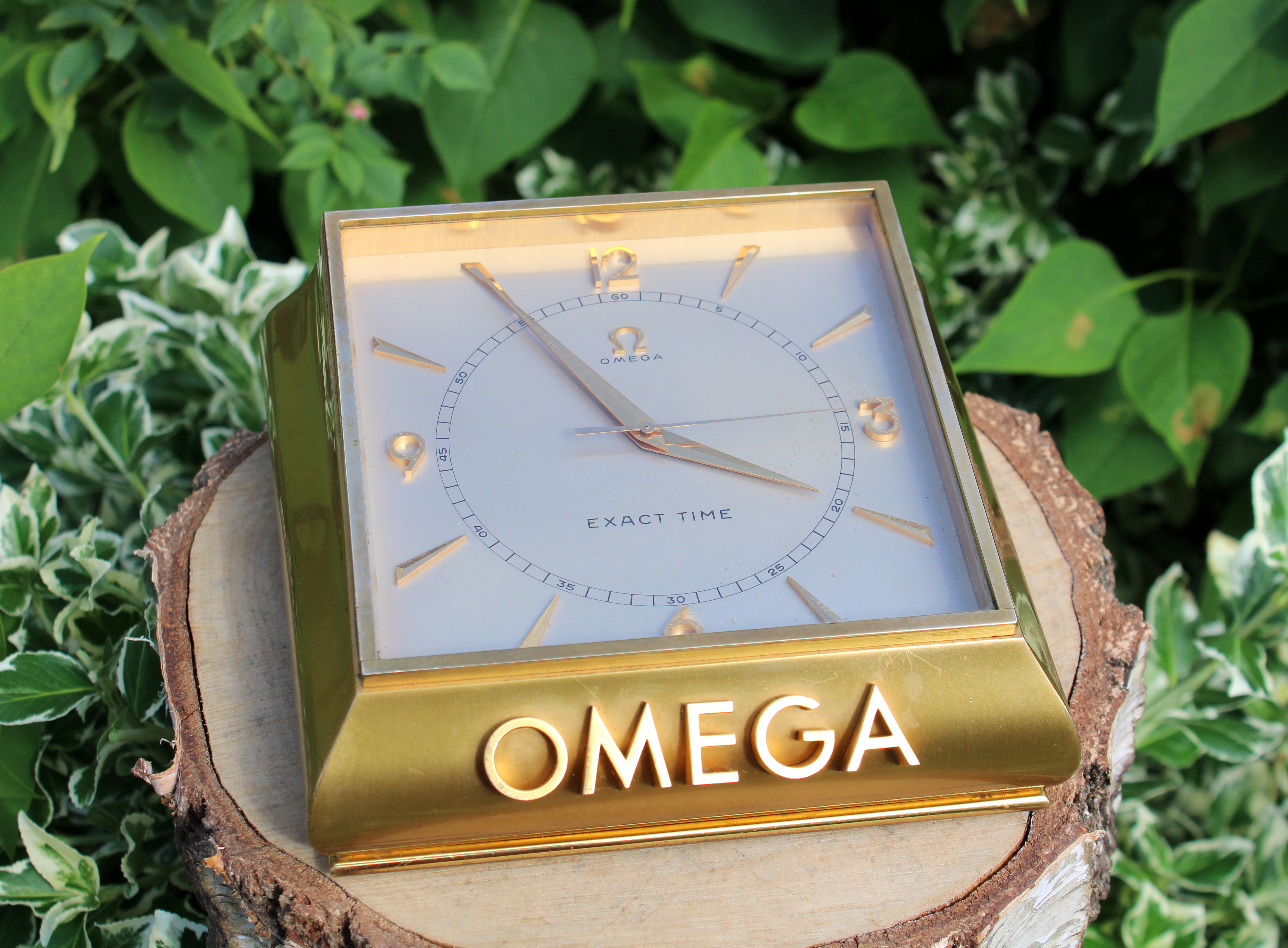

Just landed a pair of them and did some research! I found 29 of them of which I could determine the serial. I think they were produced in 4 batches:
- Serial: 716k. 10 examples found. Tank number suggest a batch of 385 pieces so most likely 400
- Serial: 808k. 11 examples found. Tank number suggest a batch of 573 pieces so most likely 550/600
- Serial: 895k. 5 examples found. Tank number suggest a batch of 191 pieces so most likely 200
- Serial: 1.125k. 3 examples found. Tank number suggest a batch of 119 pieces so may be 100/150 (but other examples may help)
I found the following texts on the dial:
- Ratt Tid: 11
- Hora Exacta: 7
- Exact Time: 5
- Genaue Zeit: 2
- Heure Exacte: 3
- No text: 1

Congrats!
Mine is 716227, ref. 5008
6,902
10,765
It is already in my database 😁
