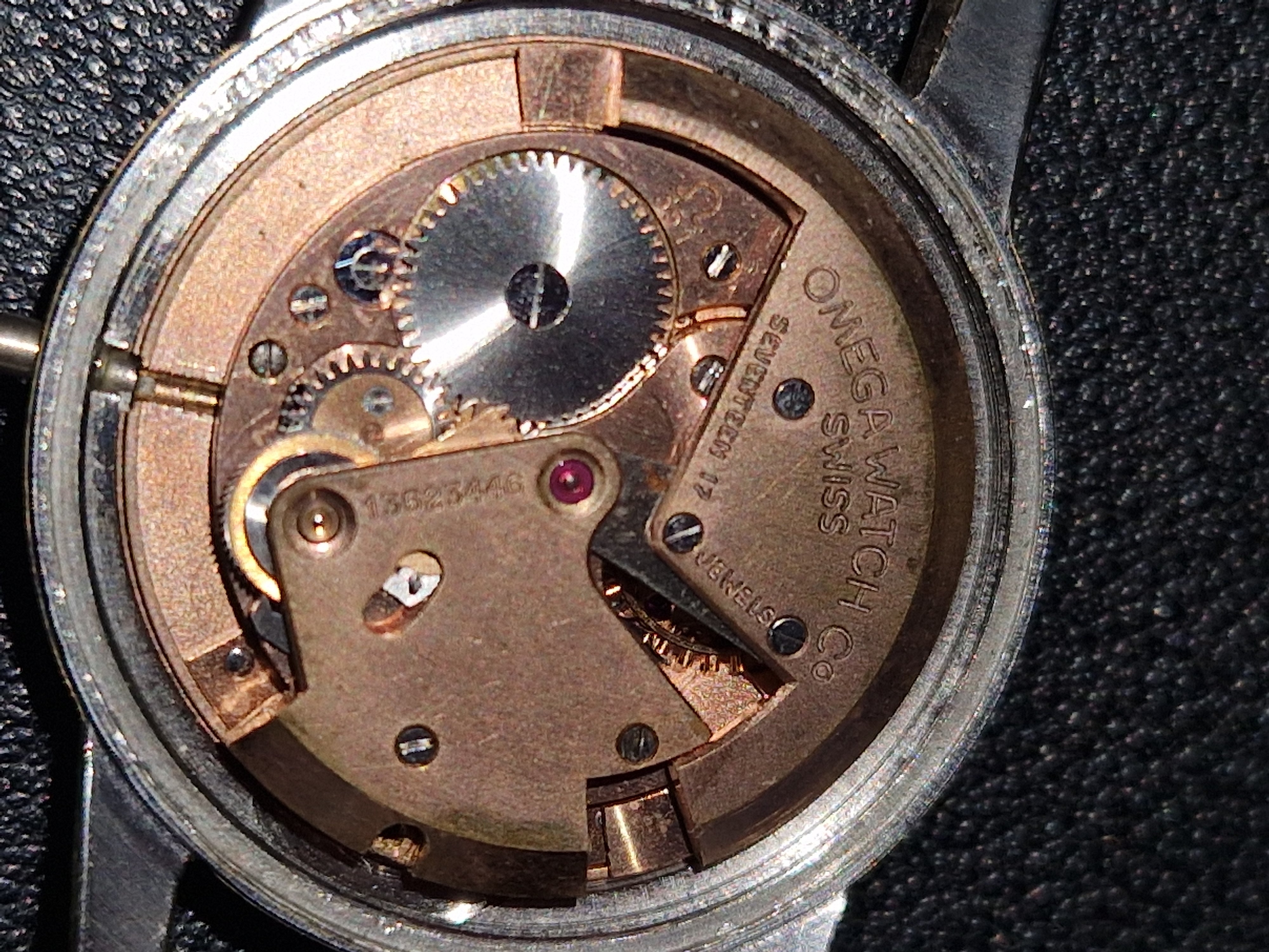

I hope someone can help me with an Omega 351 that I am trying to restore
The Cal is 351 early 1950 and it has a 2577-20 case, which appears to be gold plated

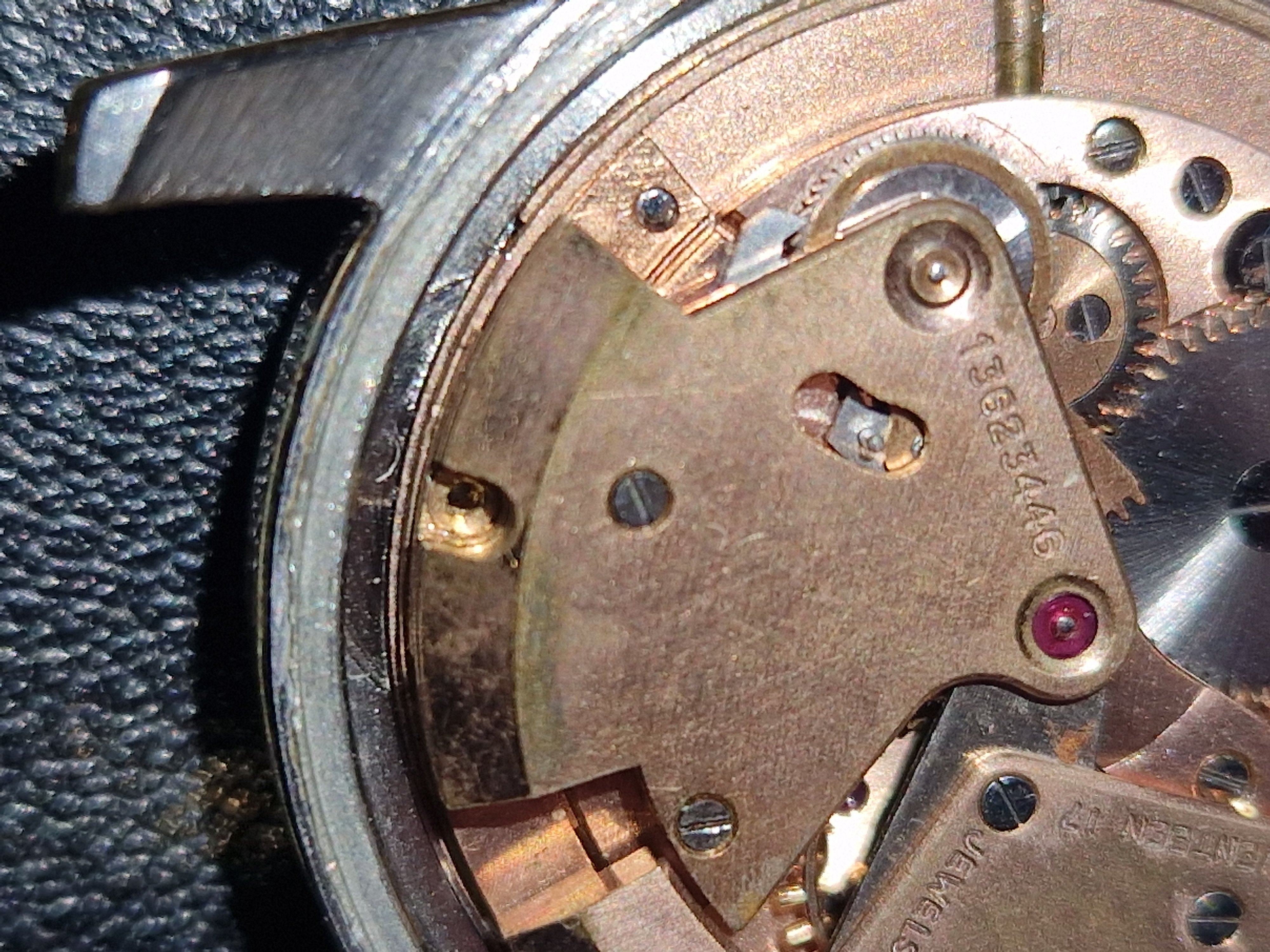

The movement case clamp missing. I am not sure if it should have a clamp or a spring?
There is a slot on the case, so I thought an angled clamp, but I have also seen pictures of a spring as well
The relief are area in the movement where the clamp or spring is attached is only 2mm wide, so its very small
Also, what is the part number for the screw and is the stem part number 72203401106 correct
Any help much appreciated. Thanks

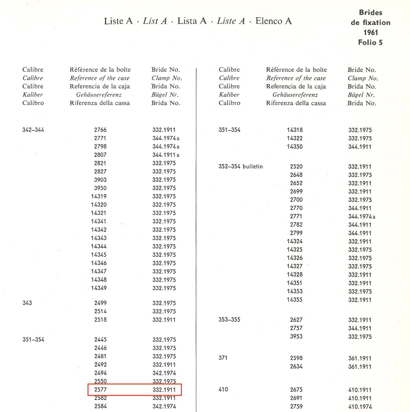

Case 2577 with Cal 351 uses case clamp 332.1911

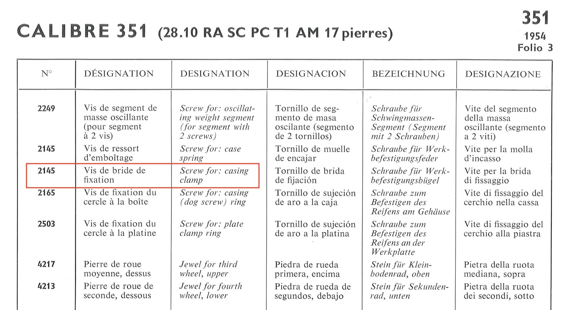

Case clamp screw on Cal 351 should be 2145
