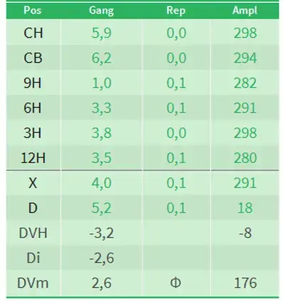

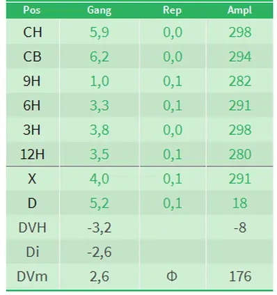

I'll be measuring with a Witschi Chronomaster Pro. The Software allows to select a coaxial measuring mode
25
3
It seems Omega also adjusts their non-master chronometers quite nicely. That's what I measured for the 3330:
