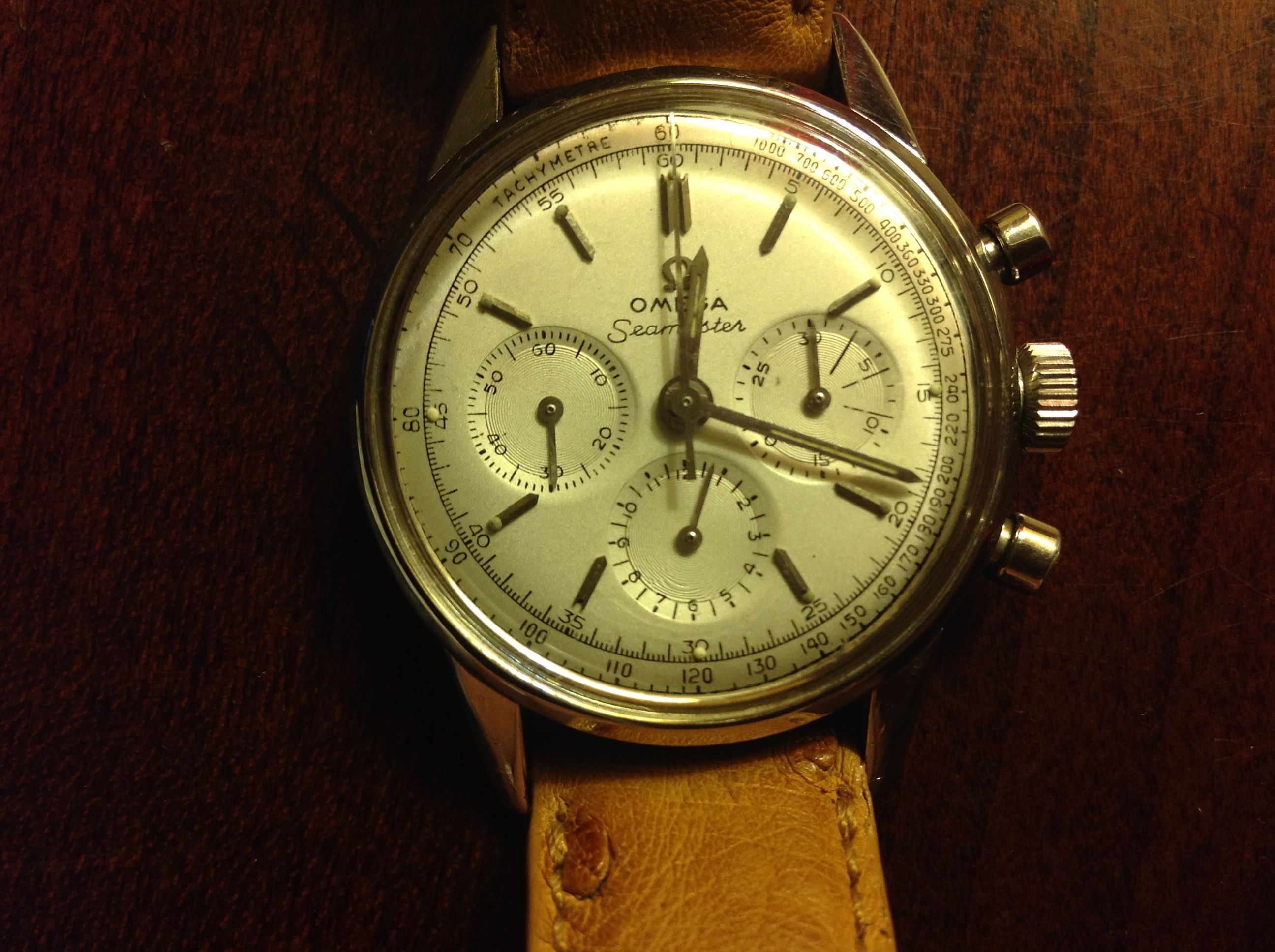

    Of all the photos of Omega Seamaster chronographs 321I have seen this is the only one I have seen with this type of dial at 3 0clock. It has three larger tick marks at 3,6,9 seconds. Anyone have any idea about this? Also the 9 0clock dial is a sweeping second hand and the 6 0clock starts at 12 and has a half tick mark and then a 2 so on and so fourth. Is this real or odd?

    Those markings had something to do with the amount of time on the phone. Back then your calls were billed in 3 minute increments I think. I've seen that on a lot of different brands.

    If your asking about authenticity we'll need MUCH better pictures than that. The quality and appearance of the fonts are vital, and if you can get a shot of the movement and inside of the caseback clear enough to read the numbers we can give you our opinions.

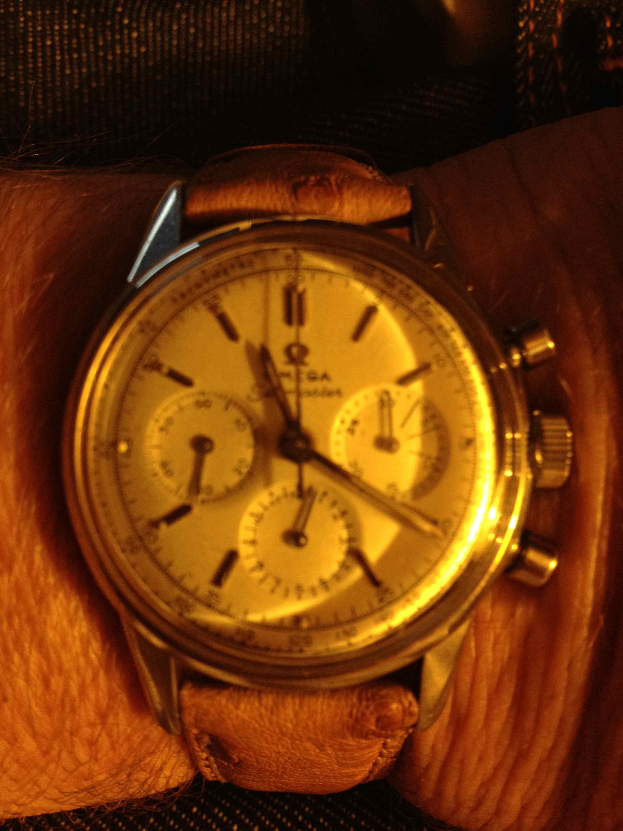

    I am not sure how to take the back off but here is the best photo I can take. Thanks again. IMG_0210.jpg

    The dial was refinished.

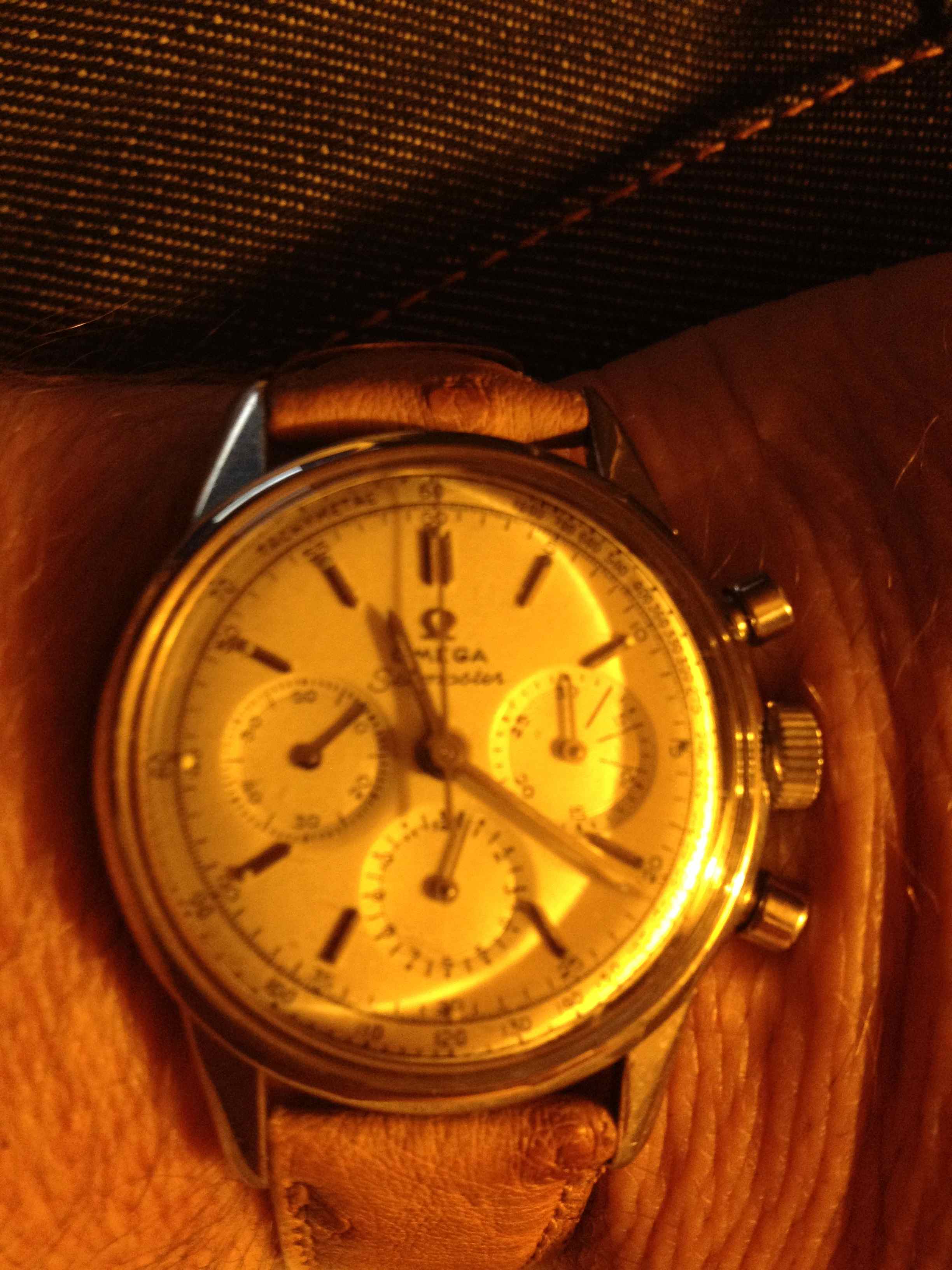

    what clues do you look for on a refinished dial? Also how hard or involved is it to reset the hour counter to zero or the 12 O'clock position? IMG_0205.jpg

    The fonts are the key. After a while you just know what is and isn't correct. Another indicator is the position and spacing of SWISS MADE. It's usually very low, below the minute track and close together - although some chronograph dials, plus some late 60's and 70's models are exceptions. Your watch is a popular and sought after model. The guys here have seen hundreds and probably owned one or two (dozen sometimes ;) ) of the various incarnations of those calibers.
