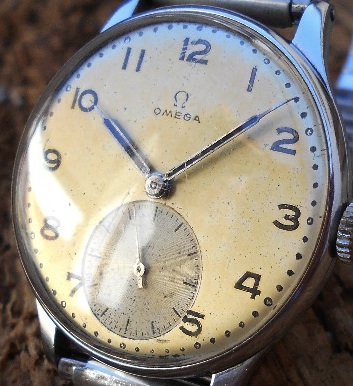

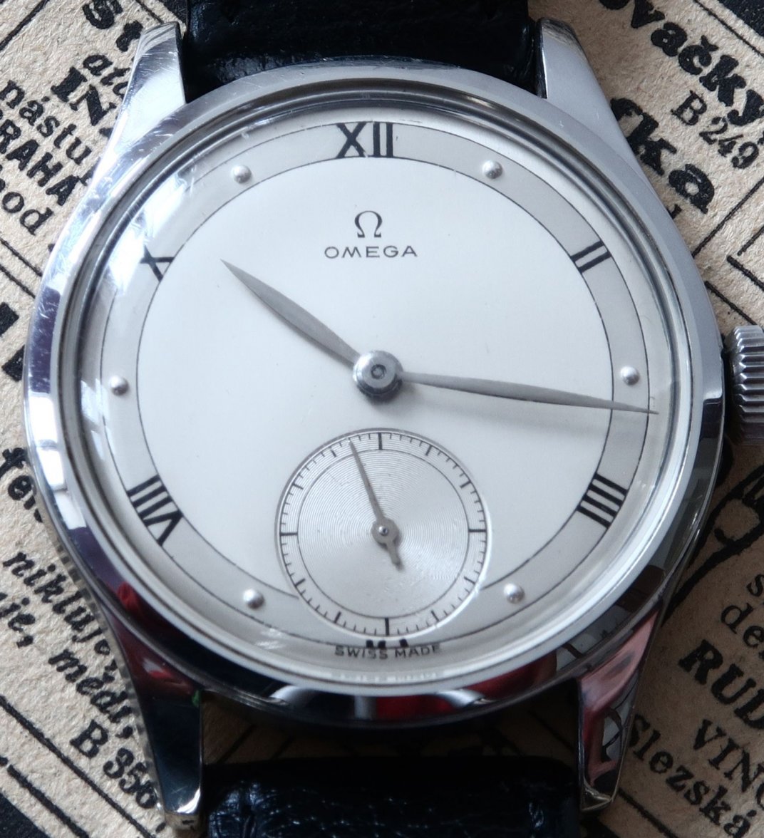

    Hi, i've been offered three 30T2 Omegas and neither of them seems legit to me without a doubt. The question is whether I am too strict, or unlucky. :)
    I suspect that it would be good to have better pictures, but those are all I'm working with. They're already the "high-res" I was sent.
    As to which one I would buy, I am still torn and it's also a question of price. I love the sub-seconds size and simpleness of the first, the case and center second (and probably gilt dial) on the second one and the elegance of the third one, although I don't like the case much. Most probably I would prefer number one, as it is how I expect the 30T2 to look like.
    Number one:
    This seems most legit to me and is in fact the one I like the most. However, the "Omega" writing just doesn't look right. Especially the "G" is super weird. The lid says 2319/11 i believe (not sure about the "9").

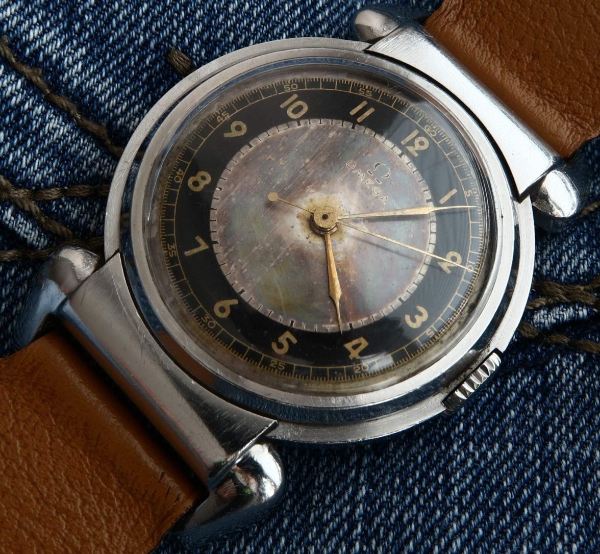

    Number two:
    This is a 30T2SC. I've never seen such a case and although I love these art-deco cases, they simply turn out to be not original mostly. What would be your take?

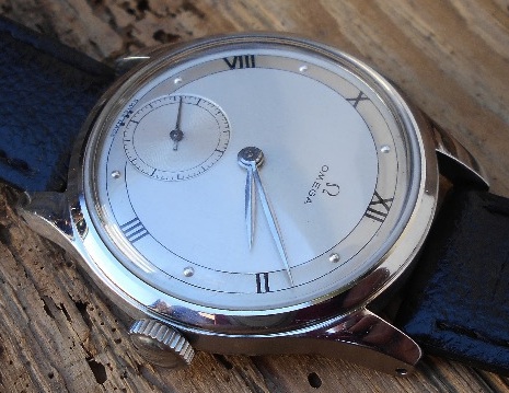

    Number three:
    This is lovely, but just looks too good to have survived in such a condition. I would suspect that it's a redial.
    The case also looks polished to me.

  2. Rman Dec 11, 2017
    2,408
    9,485
    I guess you're lucky because no one offers me any and you've been offered 3???:rolleyes:
    First things first, you have bad resolution photos and no movement shots.
    Secondly, they all could be legit, it comes down to details and price. Neither are provided.
    The dials on the firs two are probably authentic but in poor condition, the third is tough to tell...

  3. JayBe Dec 11, 2017
    395
    2,366

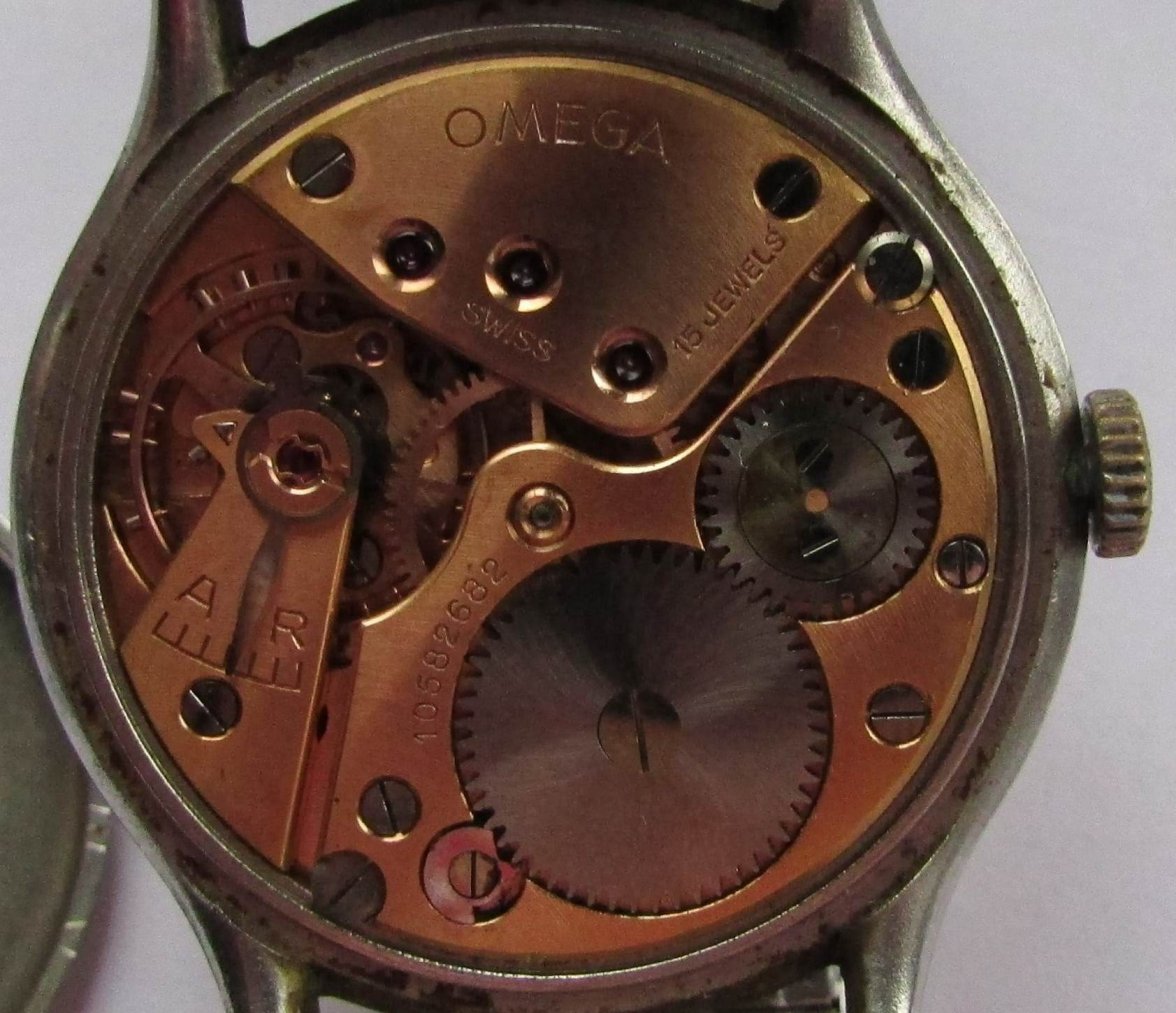

    Thank you for your comment and I am surprised to hear that you haven't stumbled upon many, they seem to be pop up quite often. In this case, I was primarily interested in the first one and have a movement and lid shot of that one, but assumed it wouldn't be relevant to the case at this point. I'll attach it to this post anyways. Should date it to around 1945. The resolution is quite good, because I didn't have to crop 90% of the picture. Who wants to see half of a tree-branch anyways...
    Should I seriously consider any of the other two, i would certainly ask for a movement shot as well, but have no doubt that there would be at least the right movement in them.
    To be completely frank, the thing is, the fellow collector offered me some other watch as well, that has shifted my attention away from those 30T2. This has happened to me with two 30T2 already and I want to at least offer a "bundle price" with one of the 30T2 this time, so that I can rest that case. :)

    As for this one , it is a large "scarab". They come in 2 sizes and they are beautiful watches. If you do a search here for "Scarab" you will see many more images of these that are owned by members. I , unfortunately only own one.

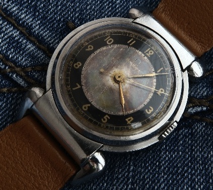

    Here are some more, a large
    [​IMG]
    And a small,
    [​IMG]
    more,
    [​IMG]

  6. François Pépin Dec 11, 2017
    1,531
    1,081
    Hello,
    All could be legit, but as said above, we need better pics of the dials.
  7. kyle L Grasshopper Staff Member Dec 11, 2017
    4,411
    11,220
    I would go for #2 or #3 if it is not refinished. #2 is an uncommon piece despite the dial aging.
  8. ConElPueblo Dec 11, 2017
    9,587
    26,961
    @JayBe - I call dibs on that scarab-cased one if you pass it up!
    As others have said, the first two look good while the third is most likely a redial.

    The second watch (scarab - one of the Medicus line) does not have a 30 T2 SC inside for sure -
    IMO it has a Cal 23.4 SC inside

    If you want to wear it : #3
    If you want to keep it in a box for collection : #2
    Btw, Mac is right , it’s probably not a 30 mm inside the scarab case , i would have say 26,5 but i may be wrong.

    However, this input has potential to eat a whole in my wallet, so I will go for number two and will call the seller right away to start negotiations. I cannot believe that I finally found an art deco case that is legit. Will keep you guys posted. I guess movement pics incoming, should he be able to open it.

    So, we had a 3hour discussion and are in a small dilemma, as the seller regrets even offering the scarab already. He knows what it is and likes it quite alot as well. I have no problem (or even prefer) to give it some time, so we stay in contact and see how things go. It is in a different price range and not just a purchase on the side anyway, so it gives me time to save up.
    I sympathize with his situation, as i agree with all of you that it has the most character of all of them and would not be among the first pieces to go, should one ever decide to sell part of a collection.

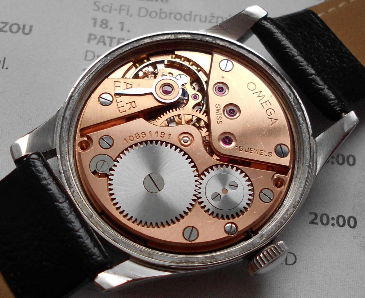

    The condition of the movement of number three (see below) seems to further support the assumption that its real.

    That #3 is stunning. The dial is almost too good to be true, but maybe it is. As you say, the general condition is great. Lets give the experts in this era time to give an opinion. I dare not.

    Anyway you don t make a mistake if you buy #3, it s a beauty !!
    I understand the interest of #2 in a collection but i would have more pleasure to wear #3

    I'd be much happier seeing a minutes track on the outside of the hour markers rather than the "SWISS MADE" at the bottom... Redial.
