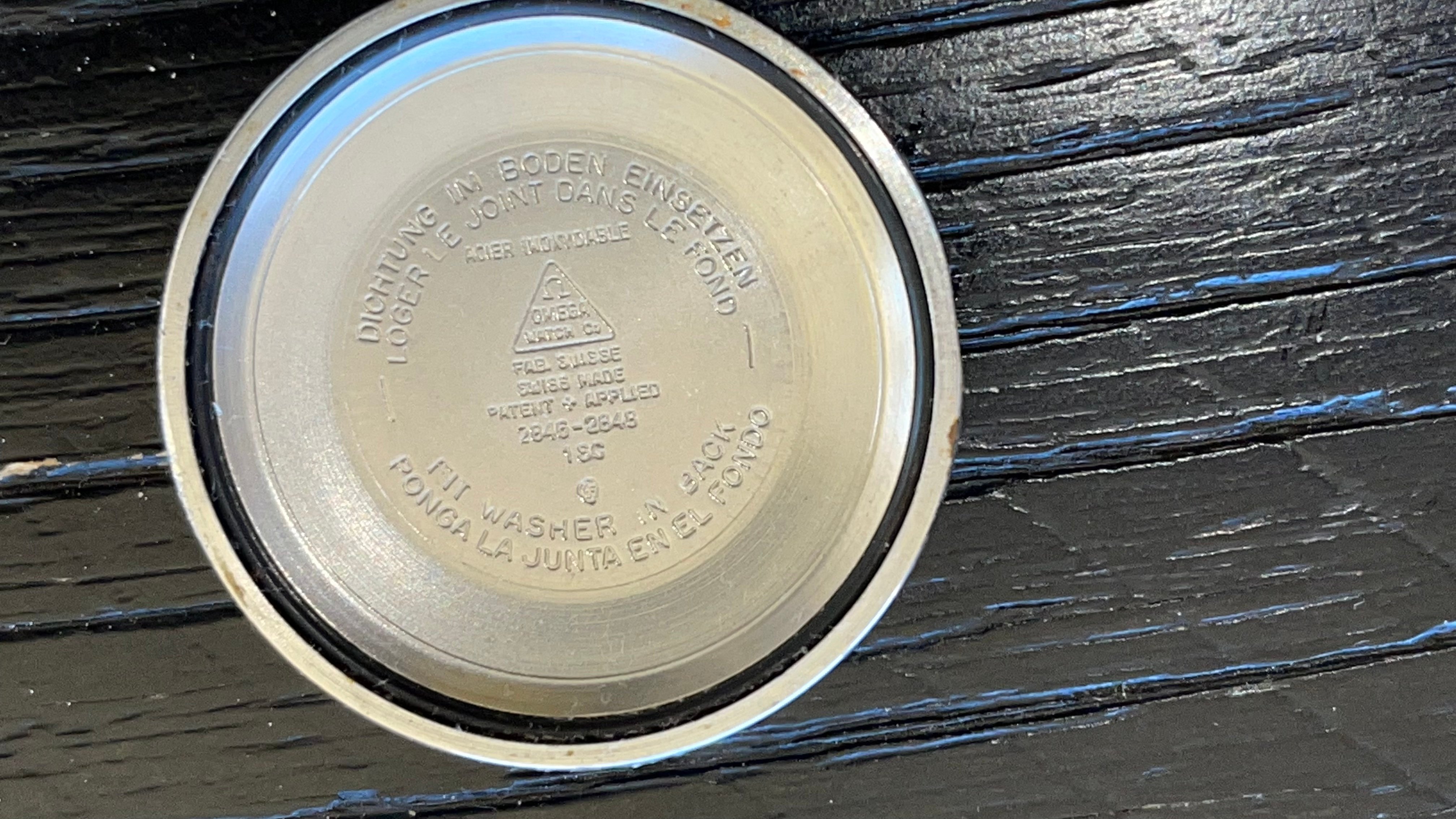

I’d like to replace the gasket and the crystal. The gasket looks like about 31.5mm OD or so. I think the crystal is PX5140 (the watch is gold color) but can I just replace the crystal without replacing the tension ring? I’m a newbie (obviously) and saw some videos with a grabber tool that compressed the crystal to remove it and vice versa. I am asking for some assistance on where to buy the gasket and crystal. Thanks.

063PX5140 if the correct crystal, and the seal is 088NS0607 | SEAL O-RING D29.75 D31.75 Ø1.
You do not remove the crystal using a crystal lift - you either press it out or knock it out from the inside of the case. You will need a press to install the new crystal.
