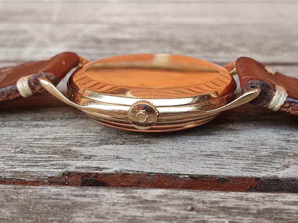

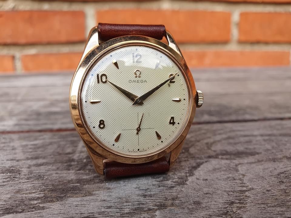

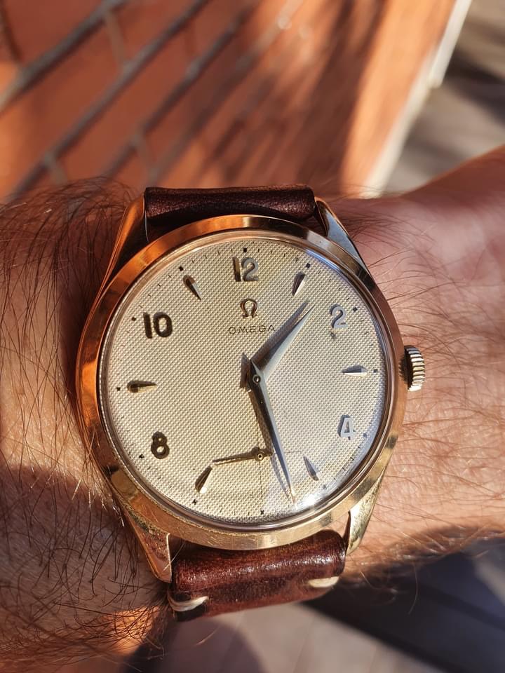

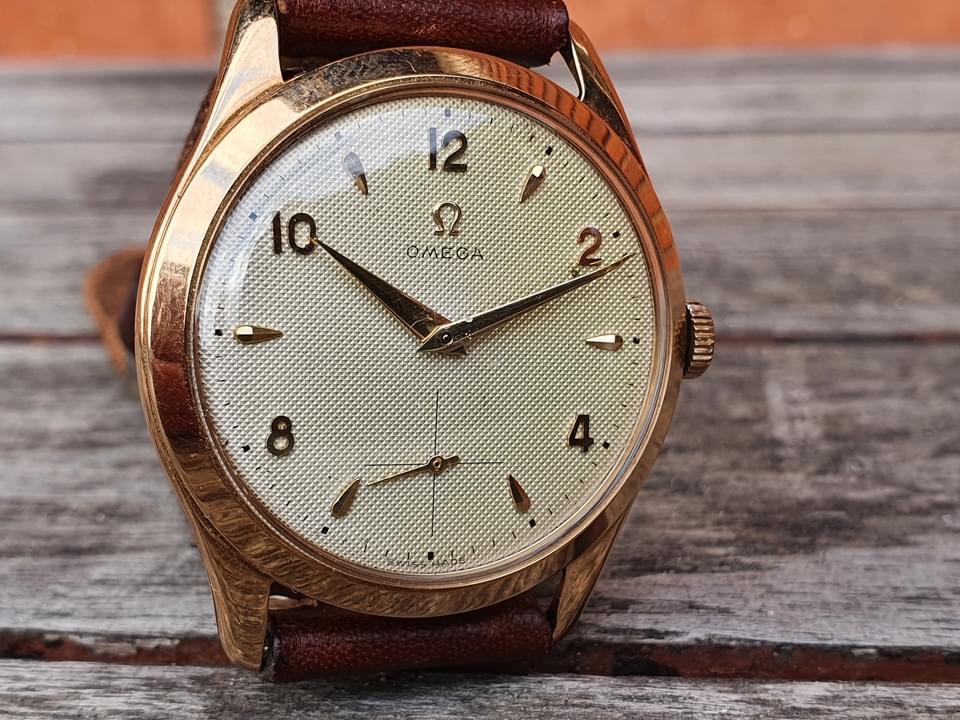

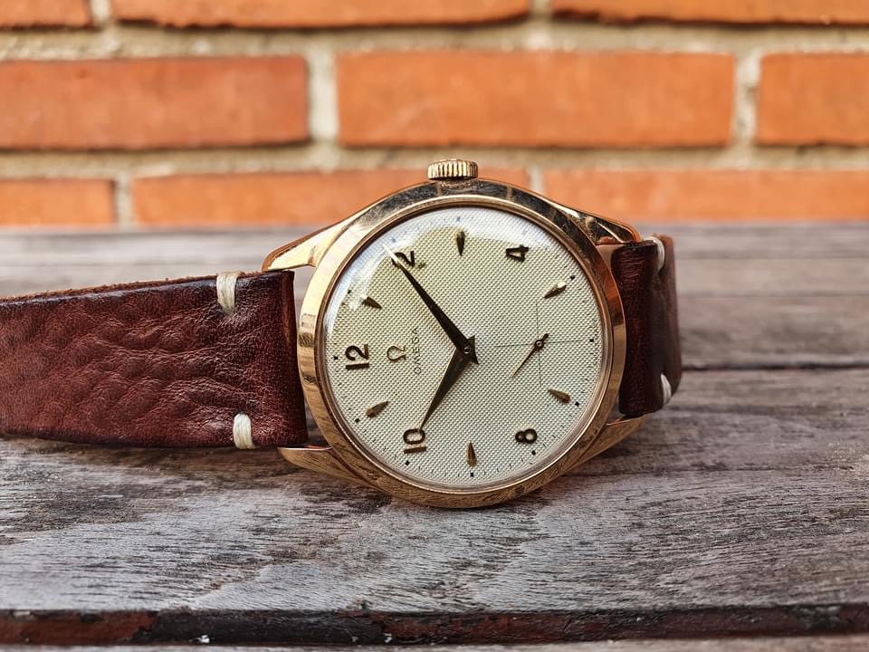

Hi everyone,
I am considering to buy this Omega cal 265 watch. It is from a private seller here in Denmark and the price is 1.060 EUR.
Compared to similar watches I think the watch looks like it is in original condition.
Seller thinks the watch is in yellow gold but based on the pictures I also think it could be rose gold.
Any thoughts the watch before I buy it?
Thanks a lot.
Br. Anders

Dial and hands are beautiful.

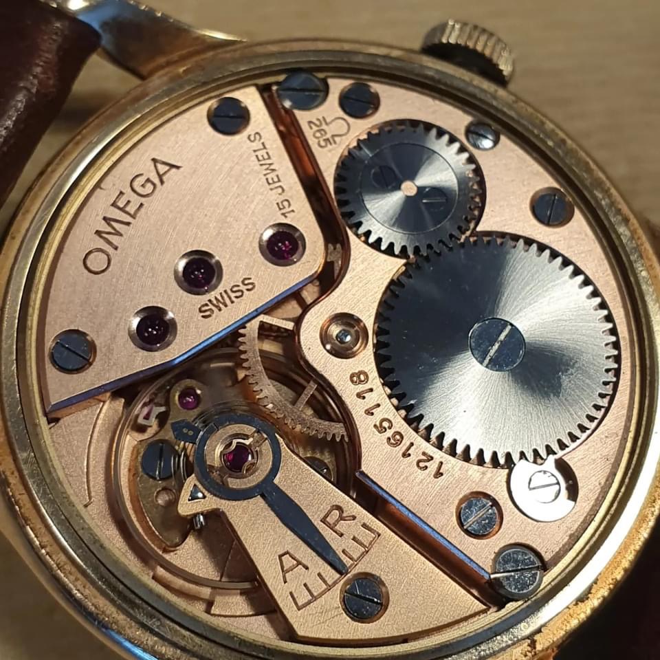

Movement is very clean - 265 is a rock-solid calibre with lineage to the famous 30T2.

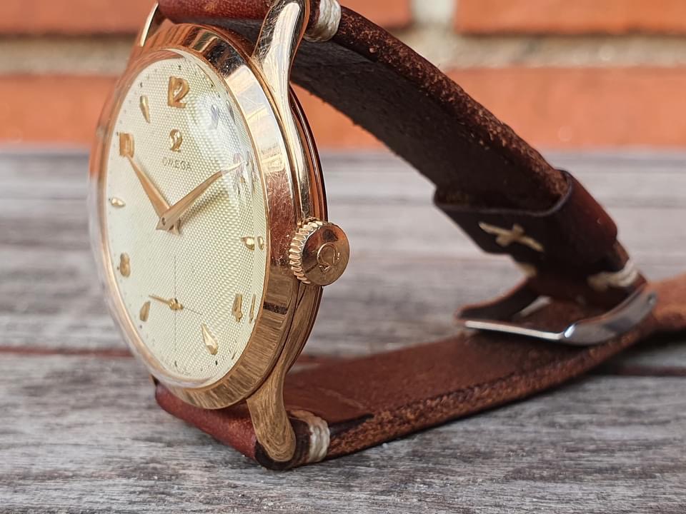

Do you have a photo of the inside case back? I have never seen the backside of the lugs gouged out like they are on this one. I would want to confirm if it is the case design or if a polishing wheel did this and need the reference number.

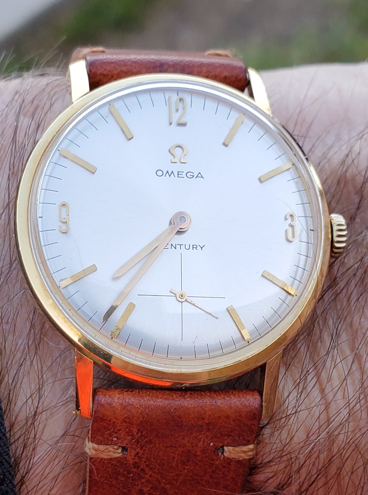

If this is the design of the lugs, the price is fair. If not, then you need to decide if you are keeping it forever or want to resell at some point. I have two solid gold 26x Omegas - 1949 260 and a 1963 263 that is below.
