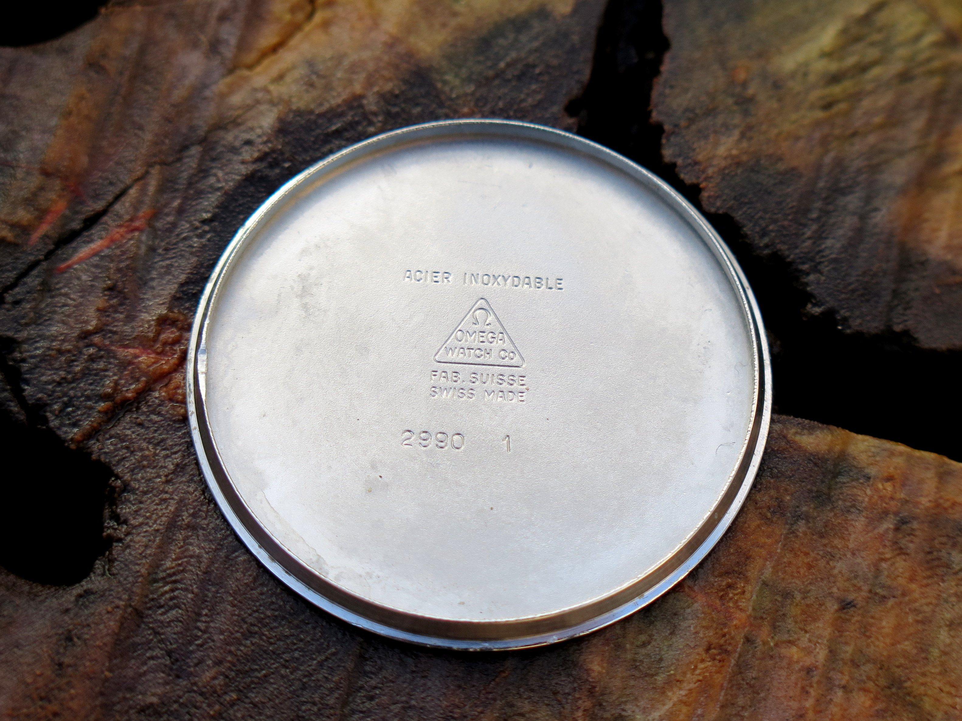

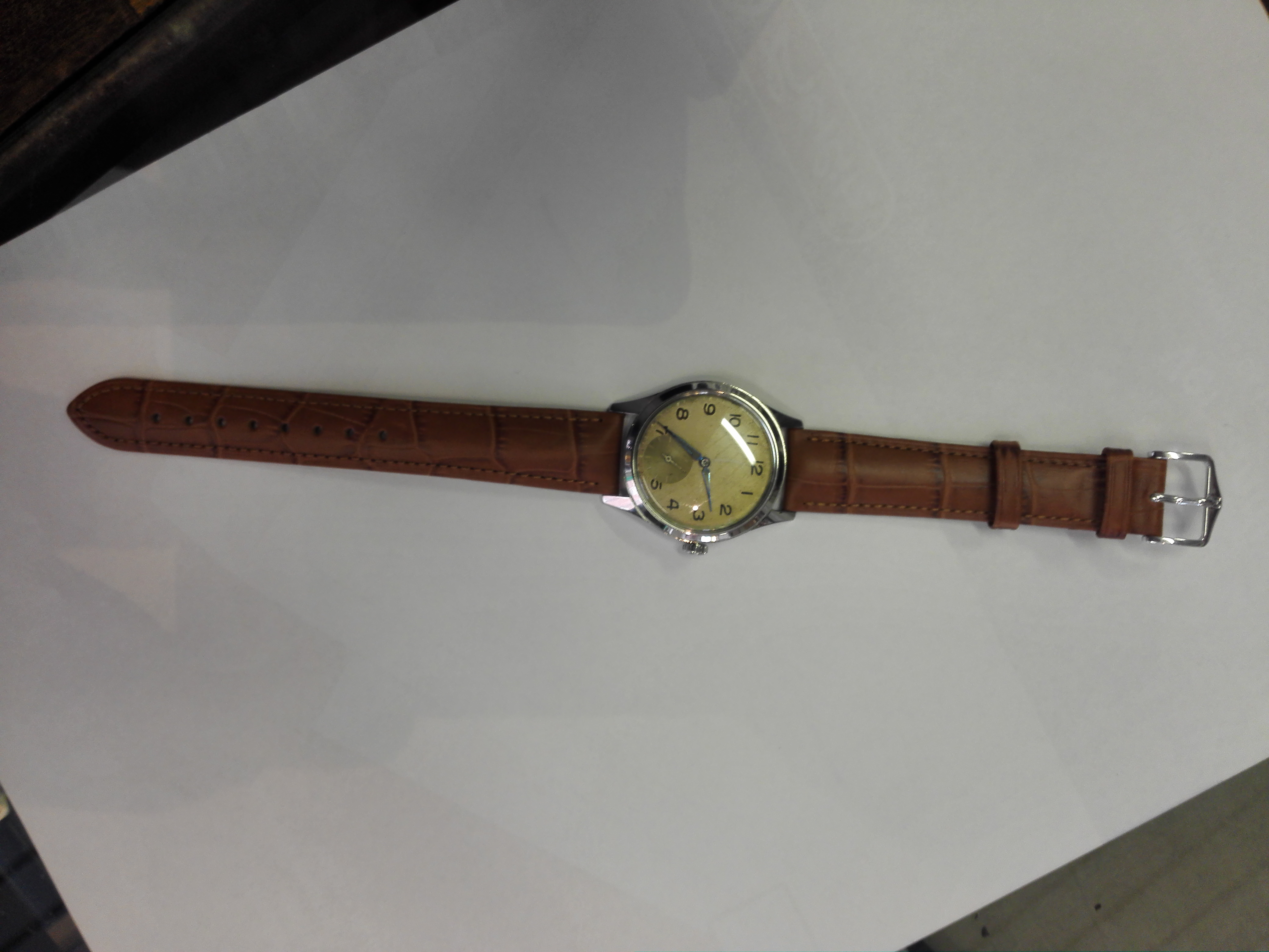

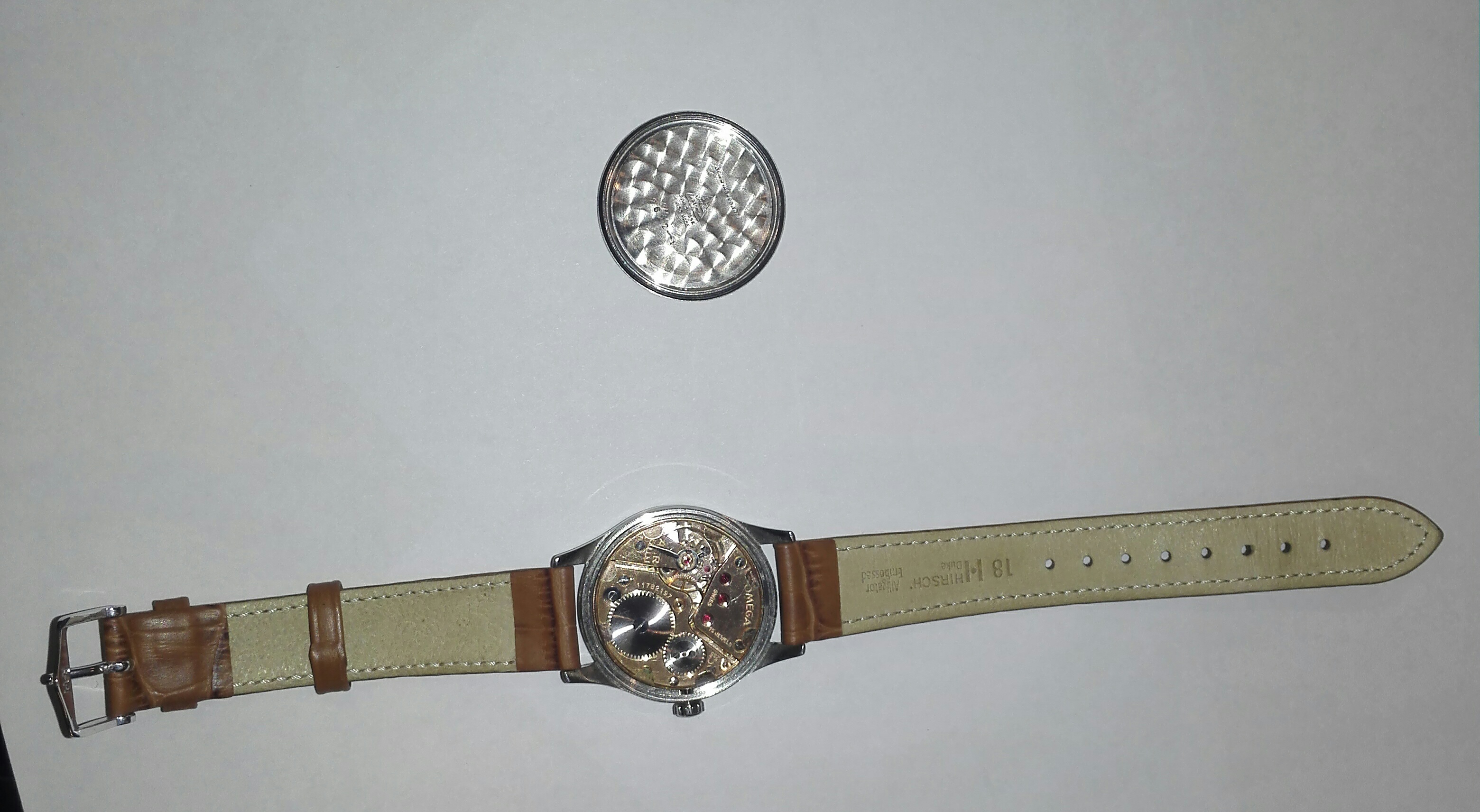

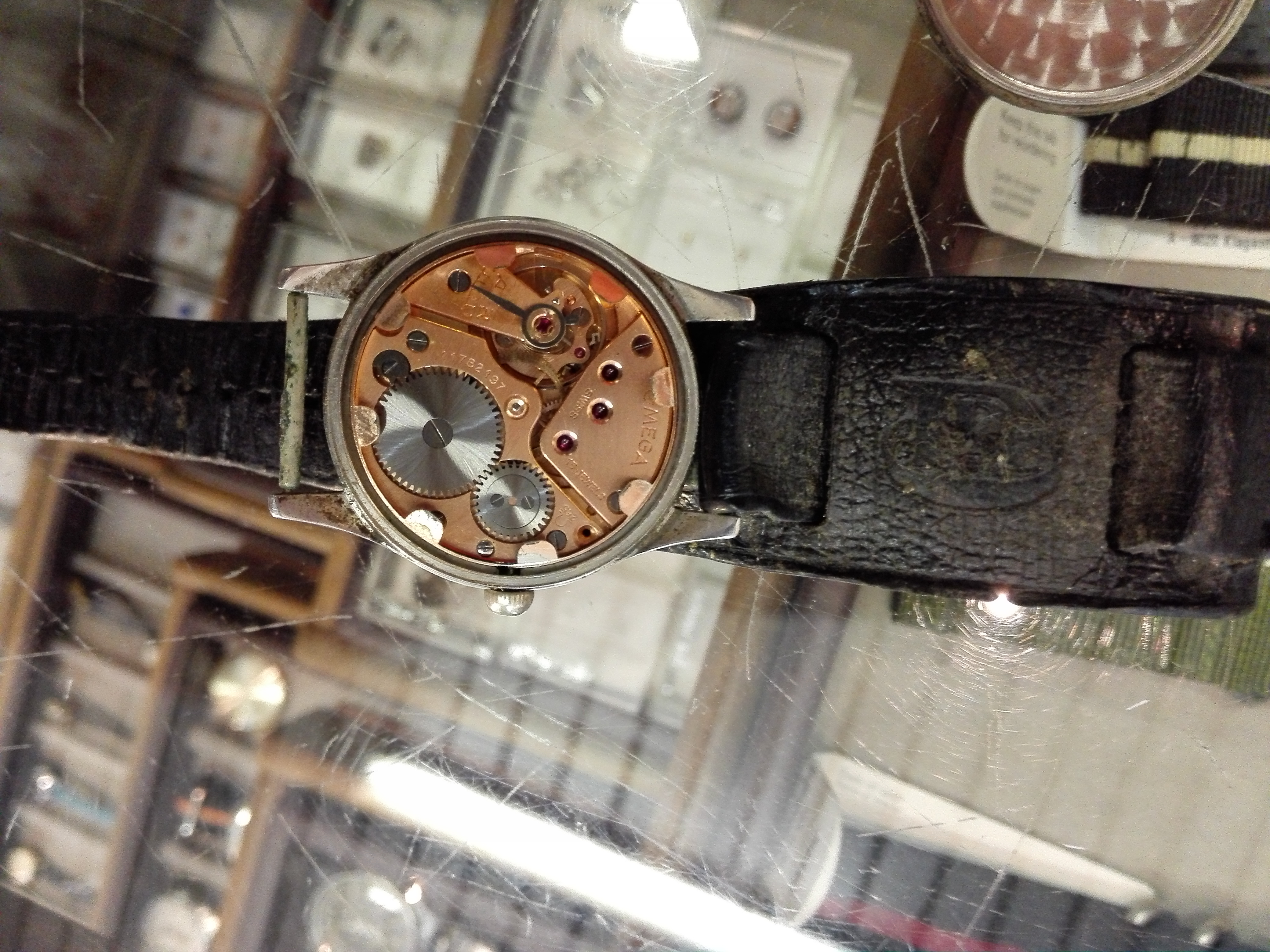

    I got a watch from my father - he said it's an Omega, bought from Stockholm approx 1951/1952. There was not any logo frontside, either any information backside.
    I drove to an official Omega watch service workshop and I was suprised, when the clock was opened - it's the Omega 265! The serial number is 11782197, 15 jewels and Swiss made. I left my beauty to the service and just got it back yesterday. You'll probably understand how happy I am now, after propriete maintanance :).
    I sent a message to Omega with history information inquiry thru their webpages over 1,5 month ago, but I have not got any response there.
    Please could you tell me more of this model and history. I am wondering why there is not any information on the front neither backround?

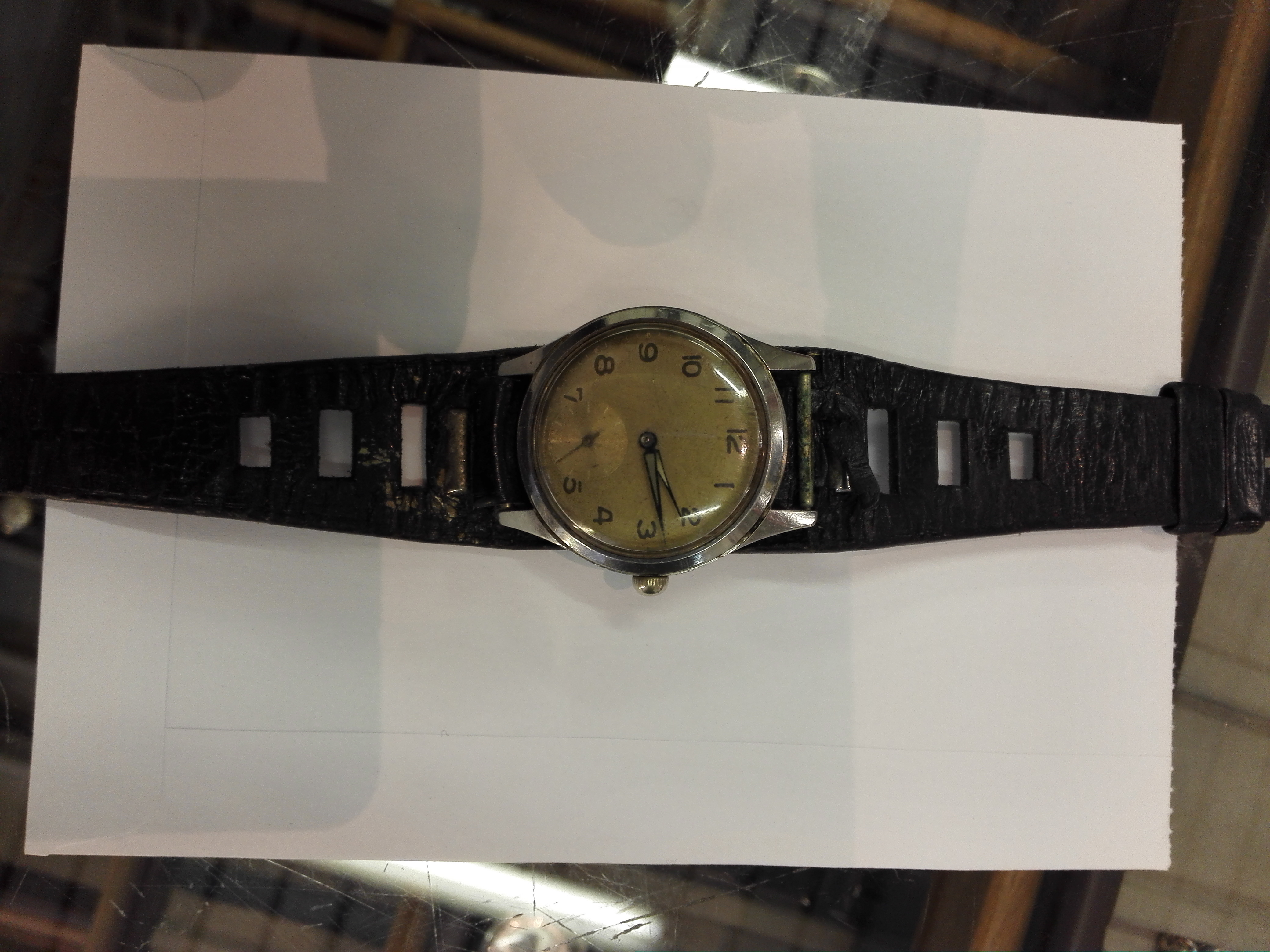

    A Suverän should have a lower serial number and different movement... And a different case back.
    Crown and hands look like they are generic replacements and the dial has been renovated at some point.

    It is not a Omega Suverän, the back of the watch would be different if ti was a Suverän and that model was from the 1940's and not with a cal. 265.
    You know the age and caliber, but if you want to know the reference you have to get it opened and in the inside of the back the reference number is stamped. You can see most of the caliber 265 references here (they were all made with several dial variations, only one is shown here) http://naligazone.com/index.php/data-watch/omega/20-watch/omega/caliber2/51-omega-cal-265
    The serial dates it to around 1947/48 so first sold in 1951/52 seems strange. http://www.thewatchguy.com/pages/OMEGASERIAL.html

    Just a quick remark: a movement from 1947-1948 could pretty well have been cased in 1949-50 and been first sold in 1951-1952.

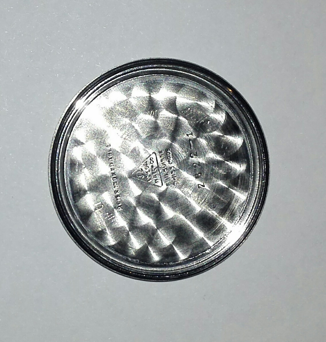

    So I drove back to workshop early in this morning, Mr Clocksmith opened the backcover and I found mystic numbers 2622-1 there.
    This watch is definitely family keeper, my daughter loved it too. Fits nice also on young female wrist :)

    Did you google the numbers?
  8. Siipiveikko Mar 13, 2017
    11
    20
    Yes, Omega seems to be "Military" model 2622-1, by the serial number manufacture year is between 1949-1950.
    I asked some more information from my father, he was working on a Swedish merchant vessel m/s Rydpoholm during 1950-1951, and he remembered that he bought that watch from Göteburg (Gothenburg) in autumn 1950. He used that Omega watch until first battery operated watches came to the markets and luckily he saved the watch even there was not any value for him.

    Well then, it must be somekind of misunderstanding (by me). I found the term when I googled 2622-1 somewhere - so it seems to be generic marketing for military style watches?
    And I still do not understand why there is not any Omega logo at front? Could this be as an early 1950's fake watch made by original spareparts?

    Very likely its been cleaned off at some point. Notice a lot of the markers are also gone, perhaps the same time the hands were changed?
