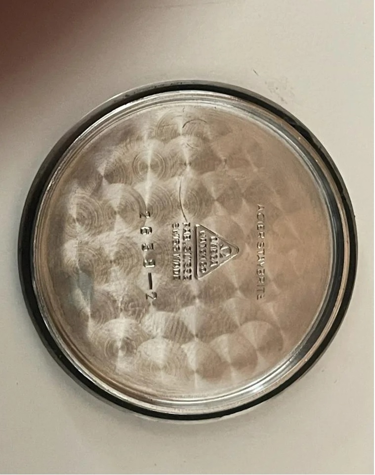

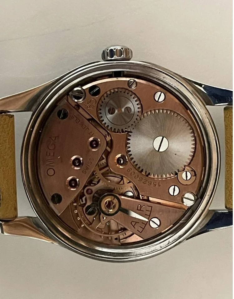

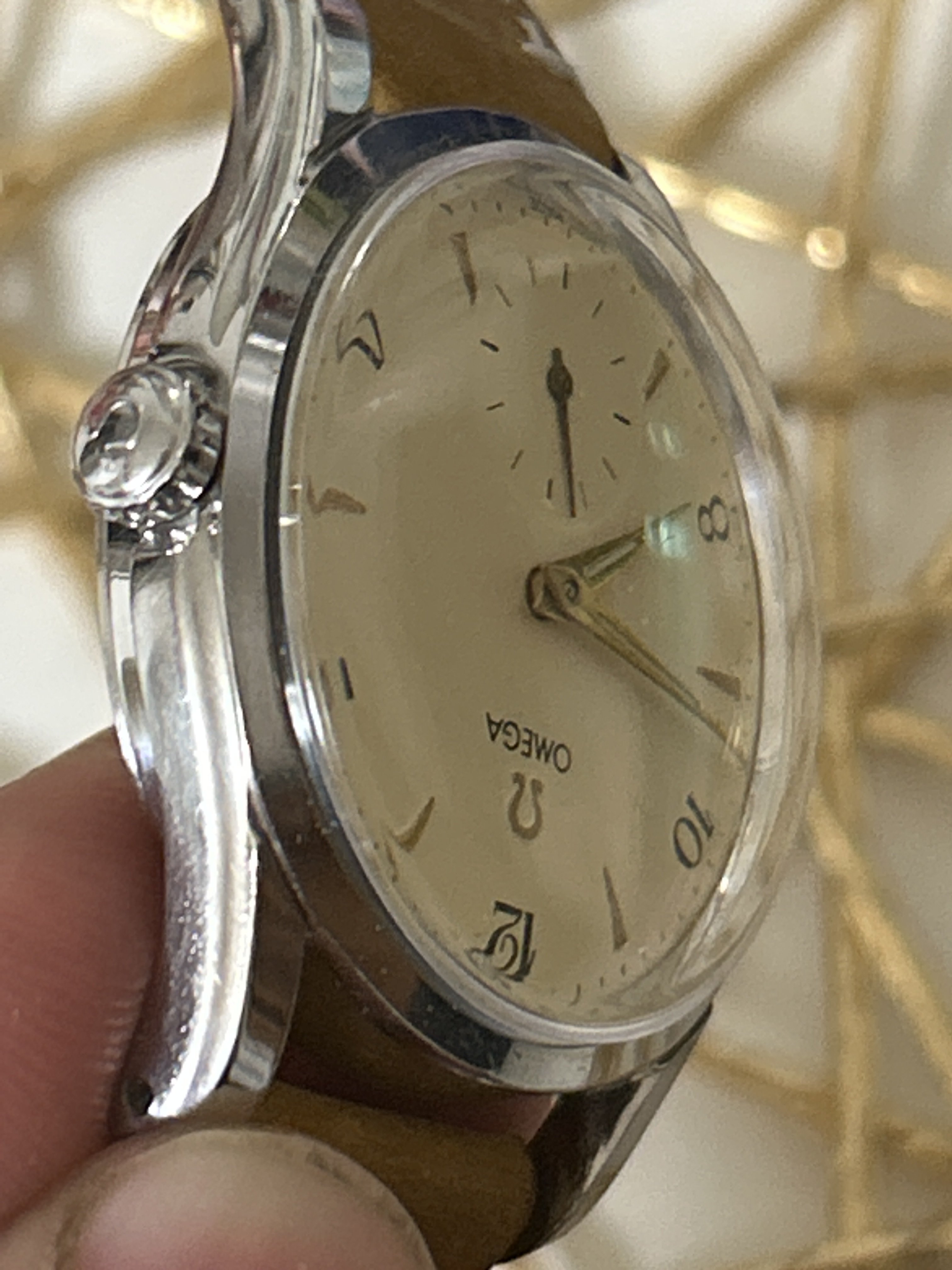

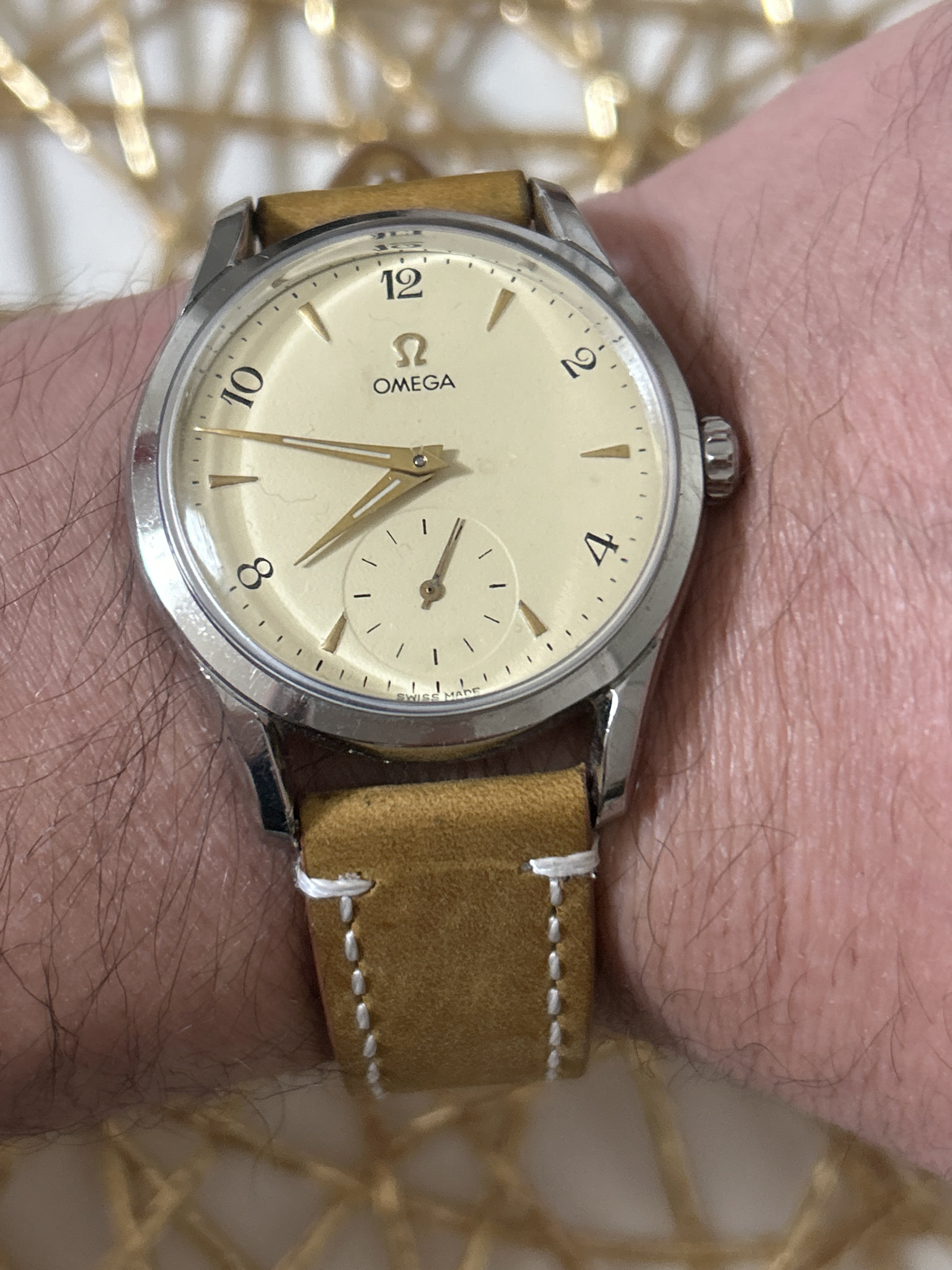

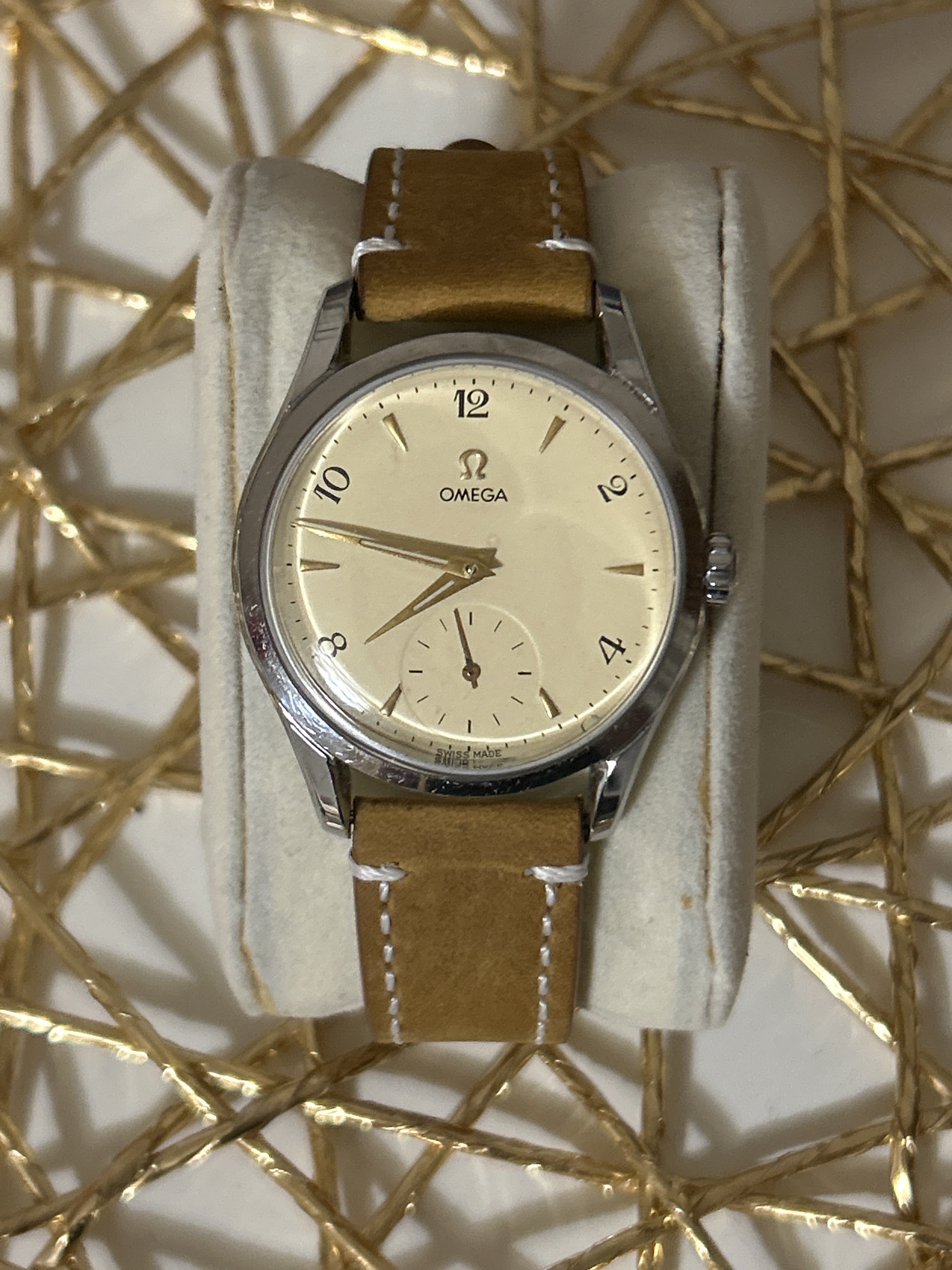

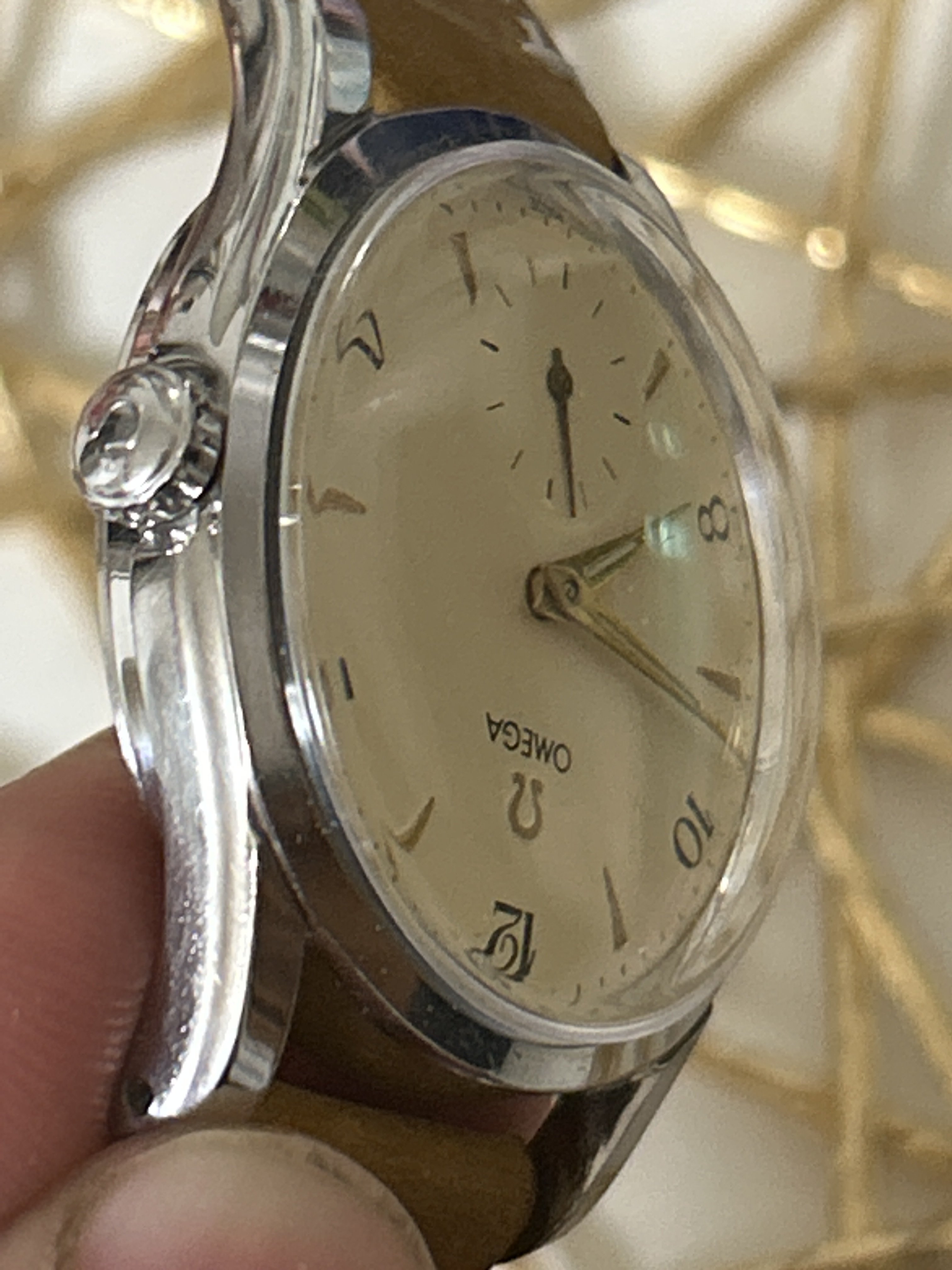

Hi all,
Been looking for an Omega watch for daily use.

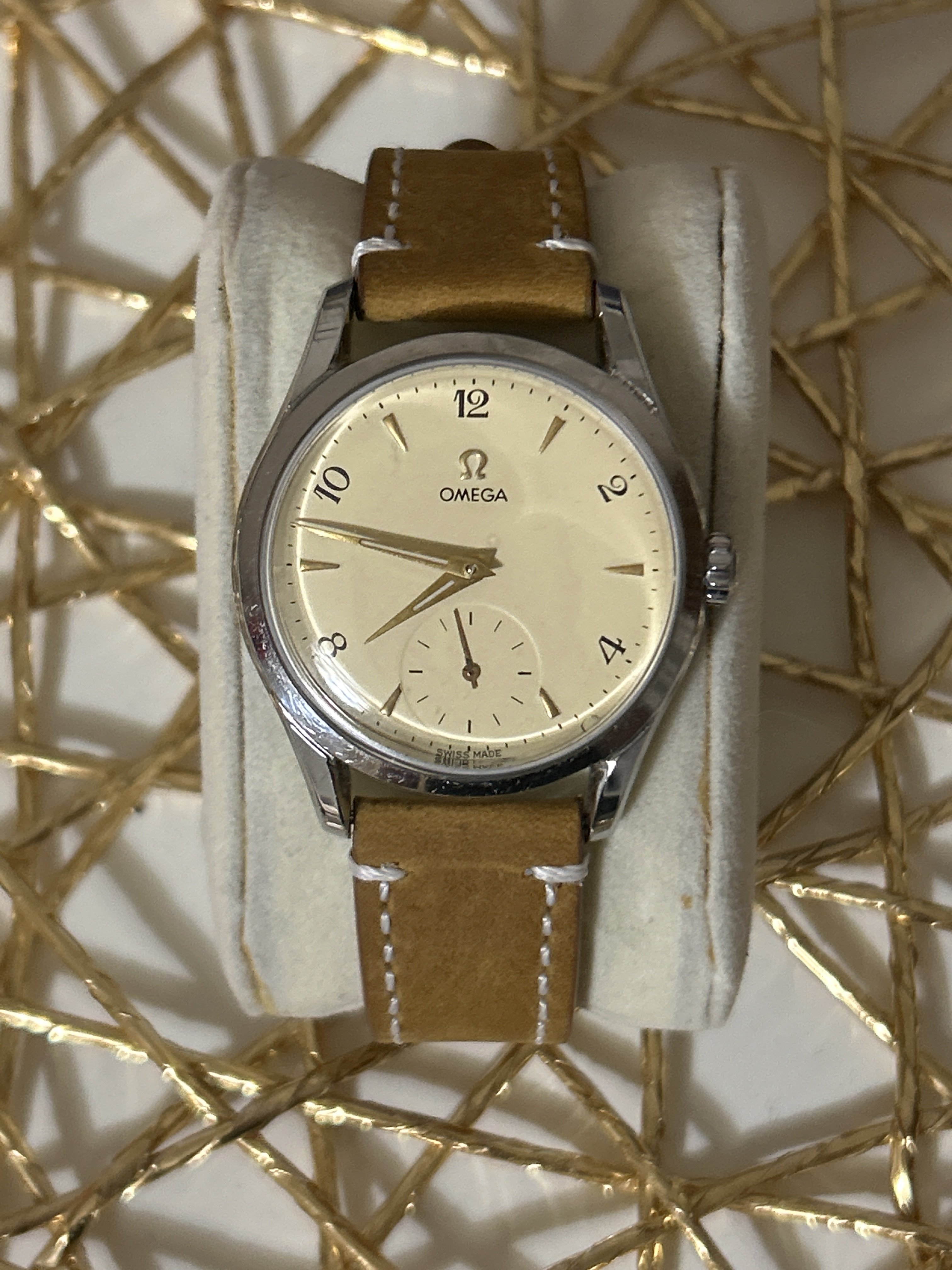

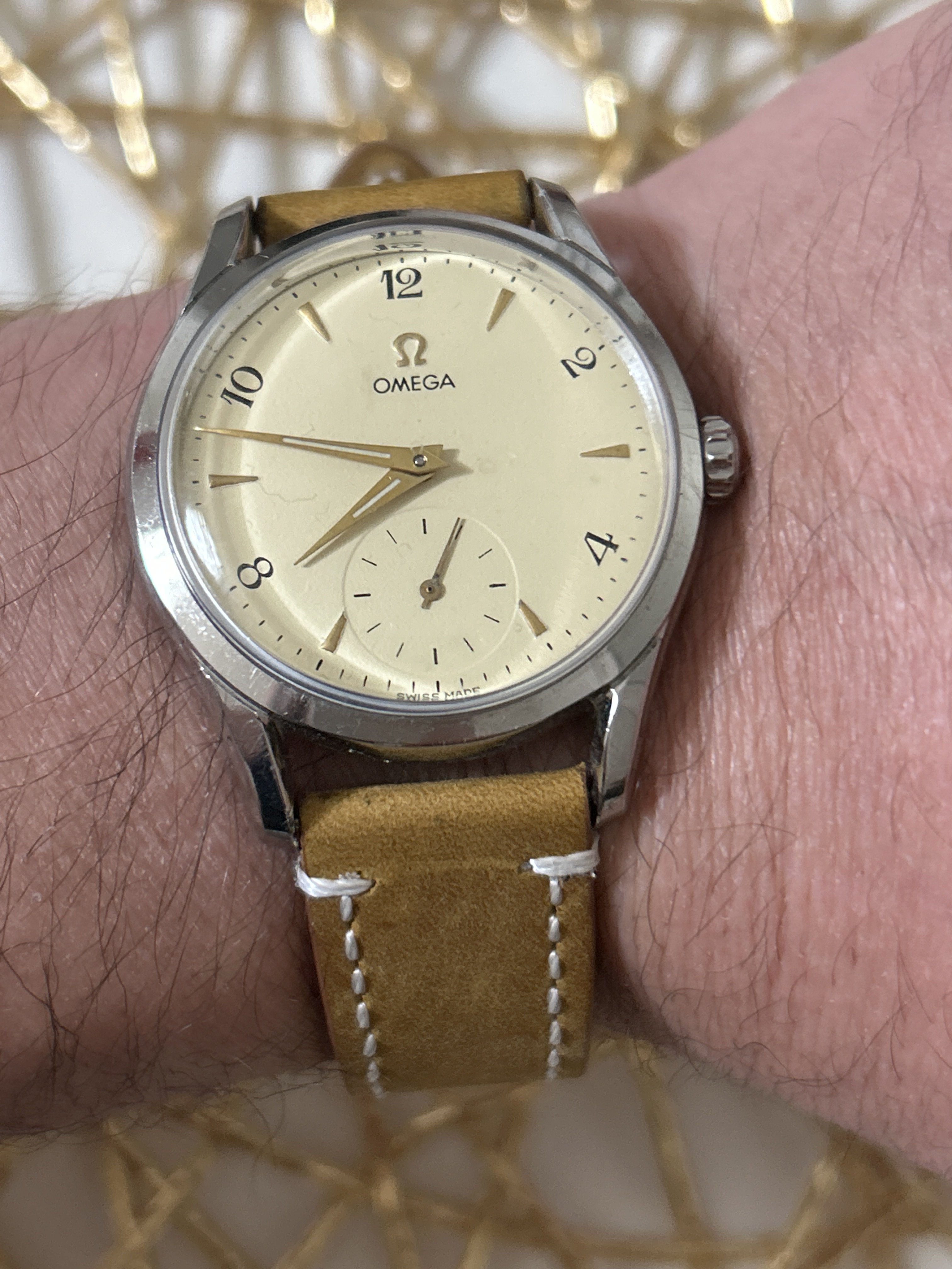

There is an Omega 2639-1 on local market that look nice and quite beatyful on pictures.
But before decision can be made I need advice from more experienced collectors.

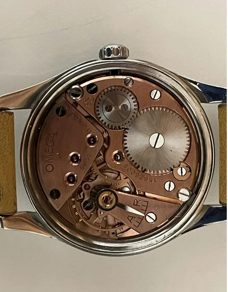

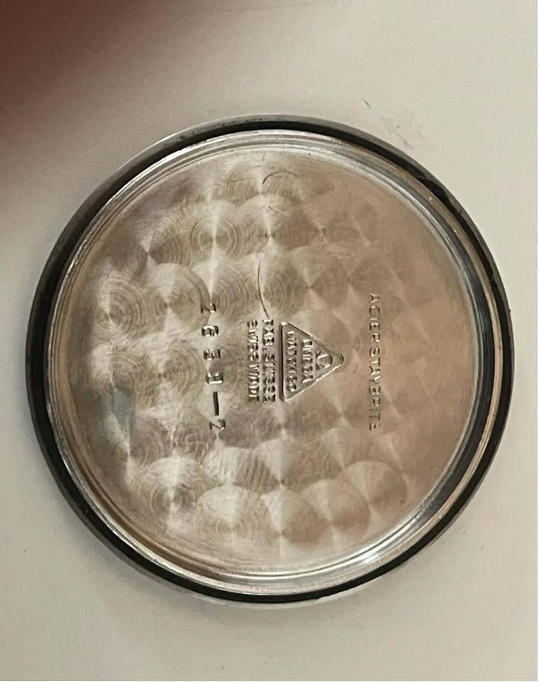

According to the seller this one have been at service 2021, reserv time holds for 20-24 hours.
Any honest opinions on this one?
2,270
15,731
Very badly repainted dial and polished case, if you looking for an original unmolested example keep looking!
3,592
13,544
Also, if it’s been serviced recently, why is the power reserve only about half of what it should be?
Anyway, since it’s a redial this isn’t really all that relevant anyway. 2639 is a cool ref and a bit larger than your average 50s Omega dress watch, but they’re also common enough for you to patiently pick a good one.

As sugested I will continue searching with more patiance because not only looks but genuaity is of importance to me.
Will cancel meeting with this seller.
It really amazes me how fast and accurate You guys could spot redial. I'm really happy to find this forum before finalizing a deal and will use Your advice onwards.
