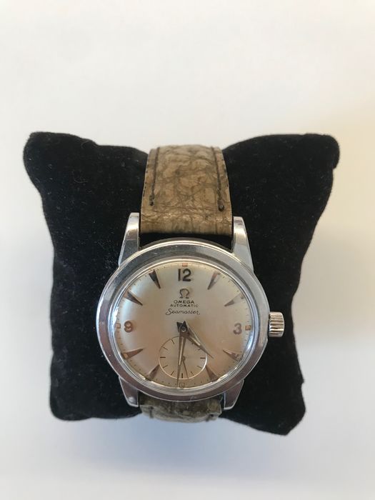

Omega 2576 bumper - correct?

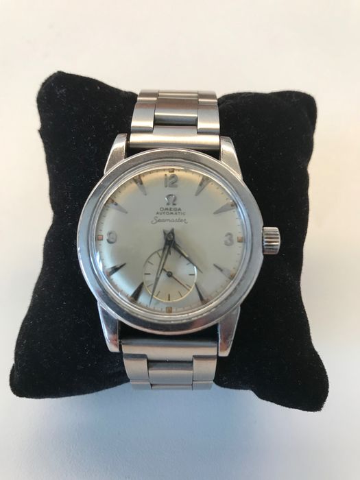

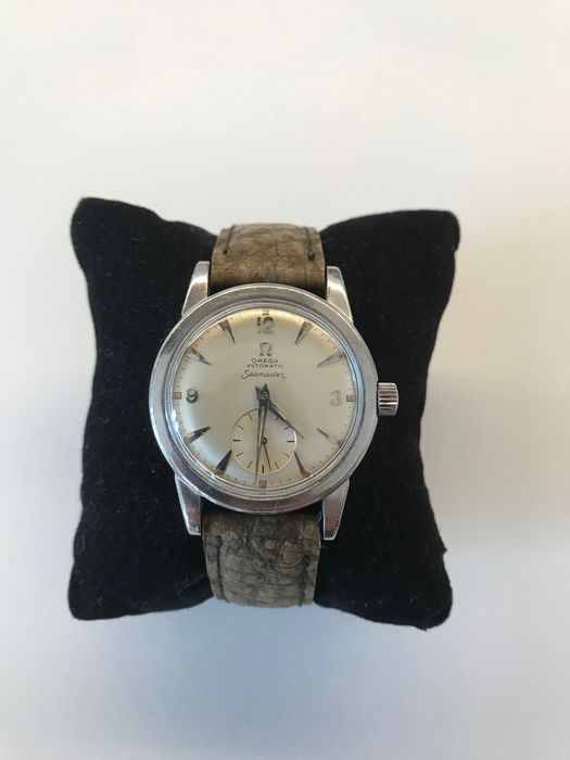

It may be fine, but the low-res photos aren't good enough to really evaluate the dial IMO.
495
1,210
I'll play desite the less-than-ideal pics: given the crown's been replaced, you know the watch has been opened/serviced. When I'm considering a watch, this always factors into things.
The hands--again, just from these pics--seem to have lighter lume than the plots. I've only handled maybe half dozen 2576s, but the ones I've seen usually have matching lume. So that'd give me pause--though, to be clear, I'm not an expert.
The dial seems basically fine; the Swiss might be hidden by the tension ring, or by the angle of the photos.
The case looks fine; nothing that'd overly concern me.
I think at 700 euro it seems basically a safe bet.

The hands may be replacements, or relumed but they are the correct style. The dial and case look fine to me.

A bumper with a "fat" bottomed S?

Or is that a fault of the pictures? Hard to tell...

I lean towards it being correct due to the fatter 15-30-45-60 hashmarks in the subdial, but for €700 I'd want more. That is a lot of money, IMO.
I had the same instinctive response, but I've seen several original 2576s with that S as well; I think it's fine, fwiw.
