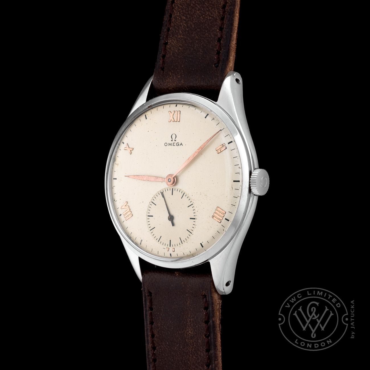

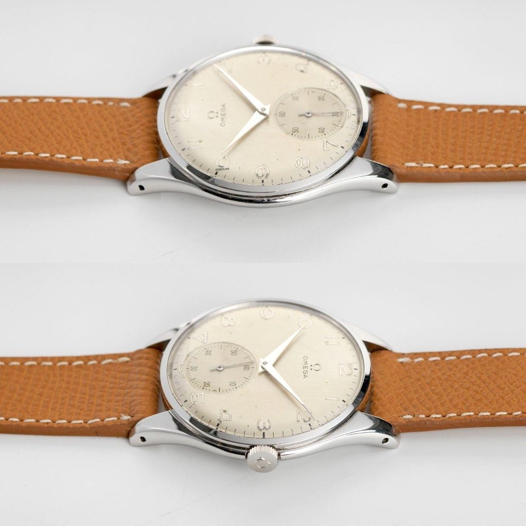

I would like your opinion on this Omega 2505.
The watch was offered me through a common friend by a well known collector that has purchased it last year from a reputable London dealer that is kind of specialized in these oversized Omega.
Thank you

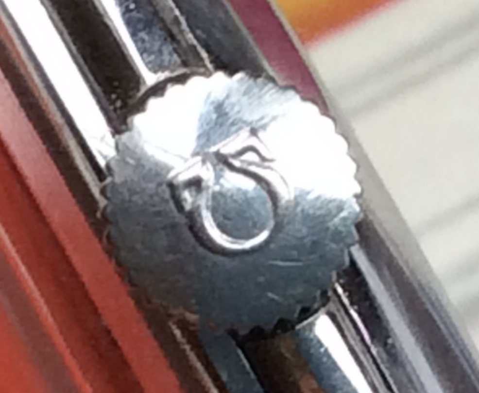

Don't know much about this ref. but the crown looks smaller than it should be, maybe a replacement
203
107
Crown is fine as far as I can see comparing it with other 2505.
Those crowns are all more modern replacements. Maybe try looking at watches that are sold by more than this one seller, who aggressively "preps" his watches. When they are all so shiny, you need to be a bit careful. Or if you're determined to buy from him, than just do it. Otherwise, sit back and allow members to give their opinions without attempting to refute every criticism.

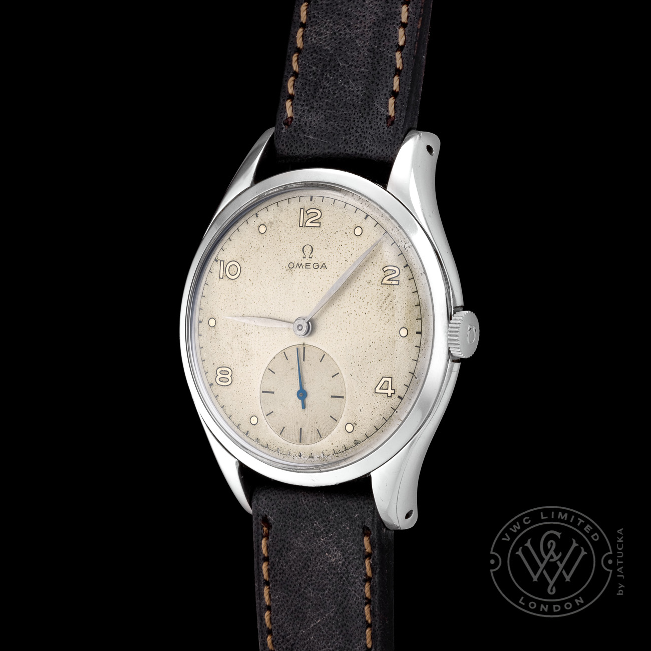

Thank you, all his 2505 had the same crown so I figured it should be the correct one ( I didn't consider the possibility that all were wrong though, probably because the original dealer is very reputable).
By the way I am not buying from him, but from a collector that last year bought the watch from him, as far as I know this dealer is also very picky, so I didn't mind about the very good condition compared to others in very poor ones I saw around.
Also, among his watches, I saw dial and case in different conditions, probably the one I am negotiating is the one in best conditions.
I am completely open to criticism and suggestions, otherwise I wouldn't have asked, I just replied to a member with few posts that for his own admission "don't know much about this reference" with my knowledge showing some pictures.

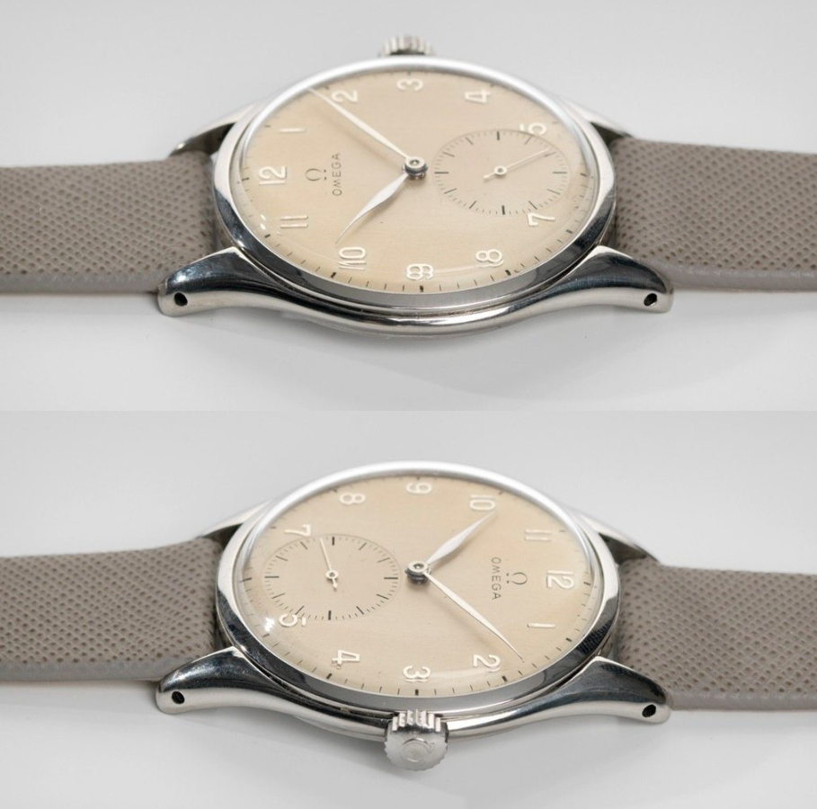

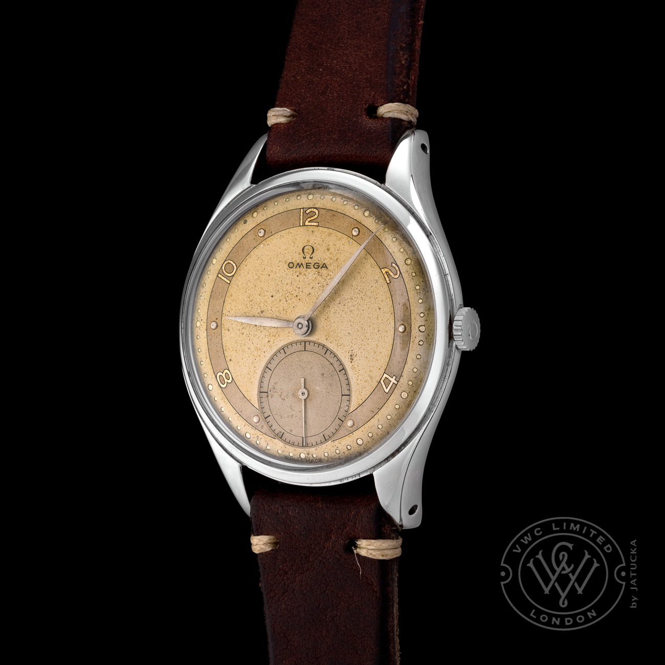

I suppose these are wrong too?
13,492
31,811

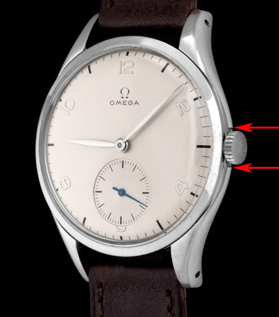

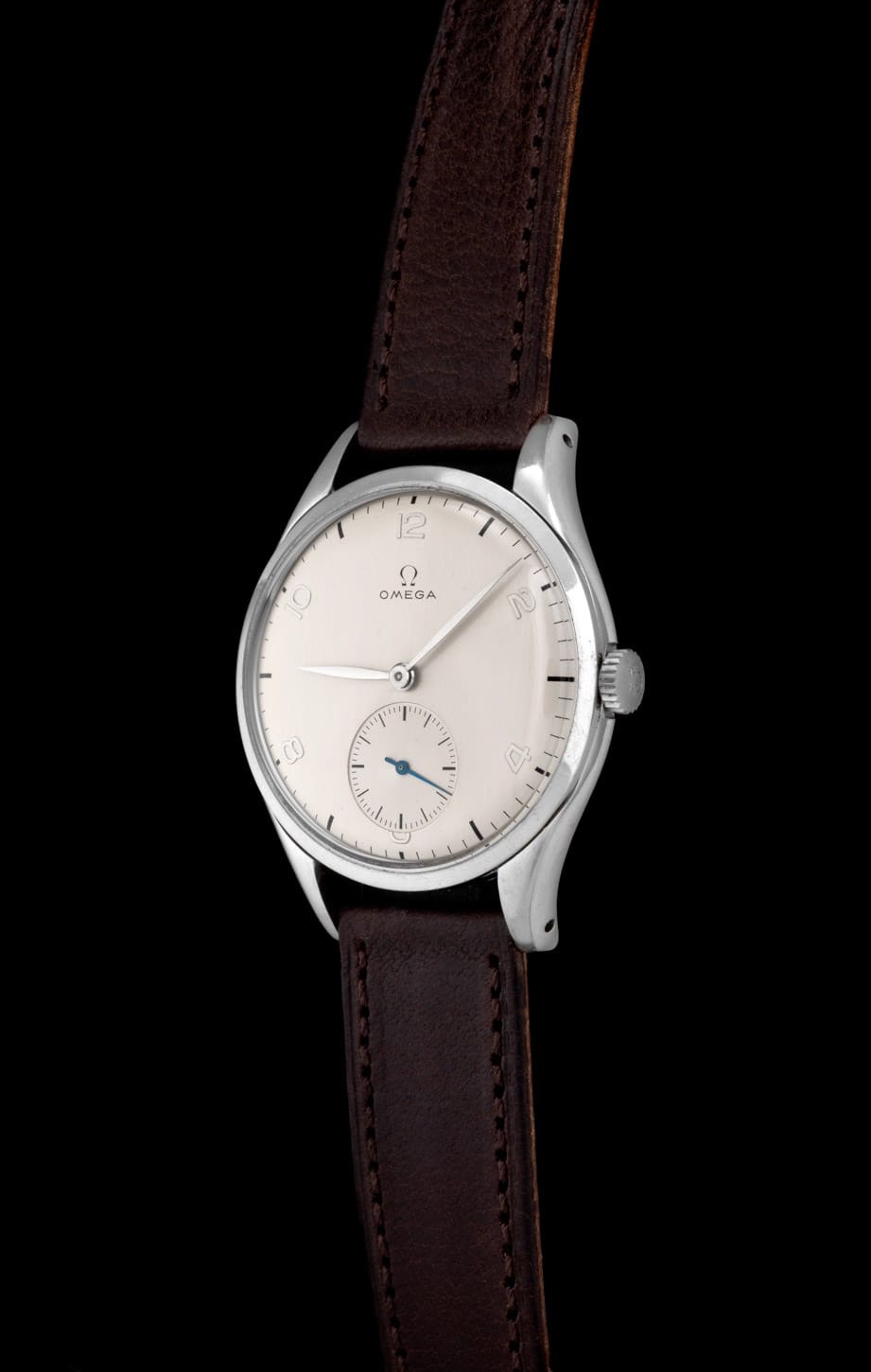

There should be no gap, the notched space should be filled with crown, on the first watch the crown is too small.
The last one above looks correct.

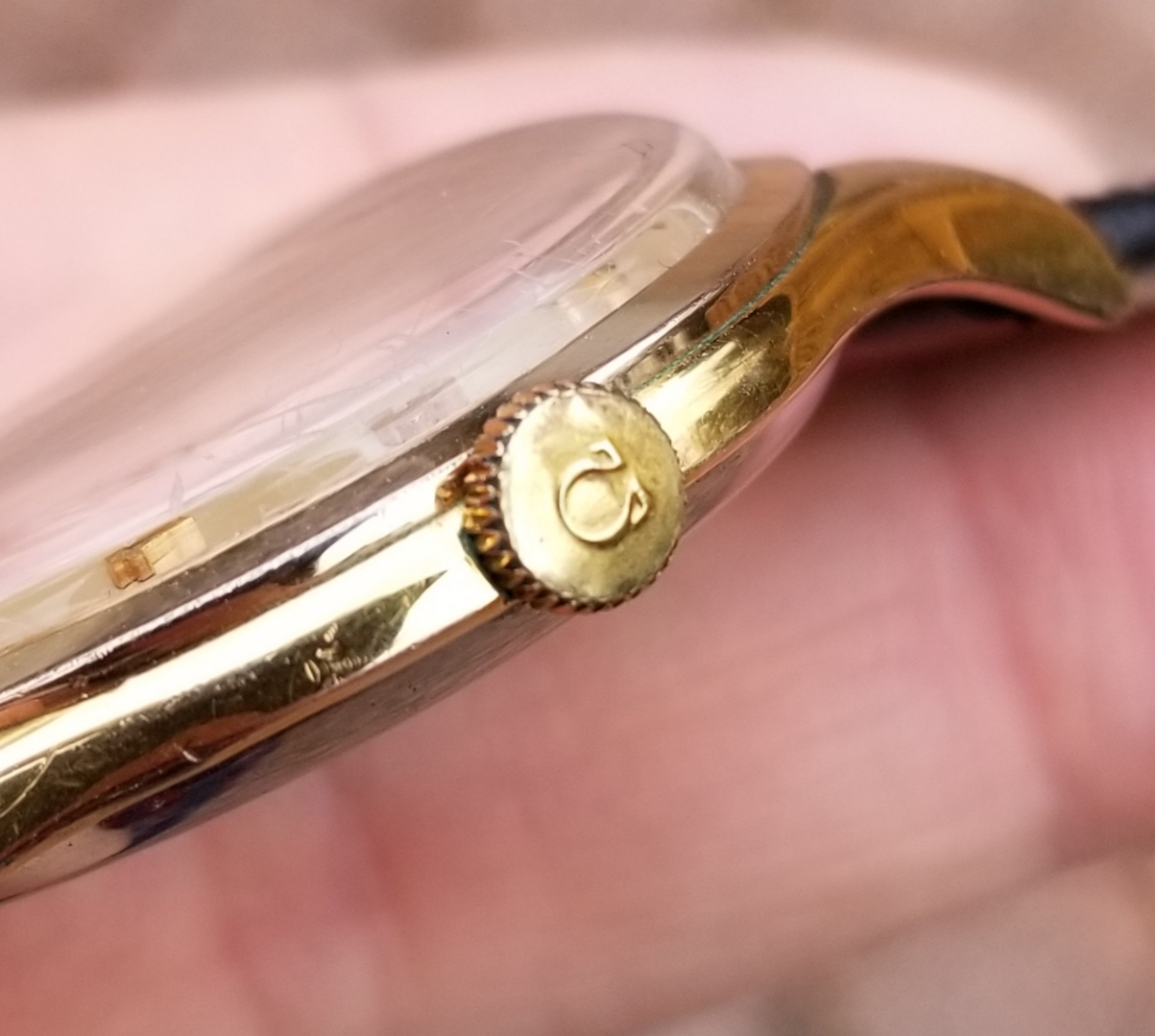

This is the crown that came with the 2505:
Sizes:
Diameter - 5.35-mm
Depth - 2.25-mm
Tube size - 2.0-mm
Tap size - 1.2-mm - #6

Crown is wrong.
