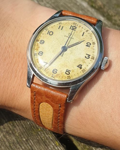

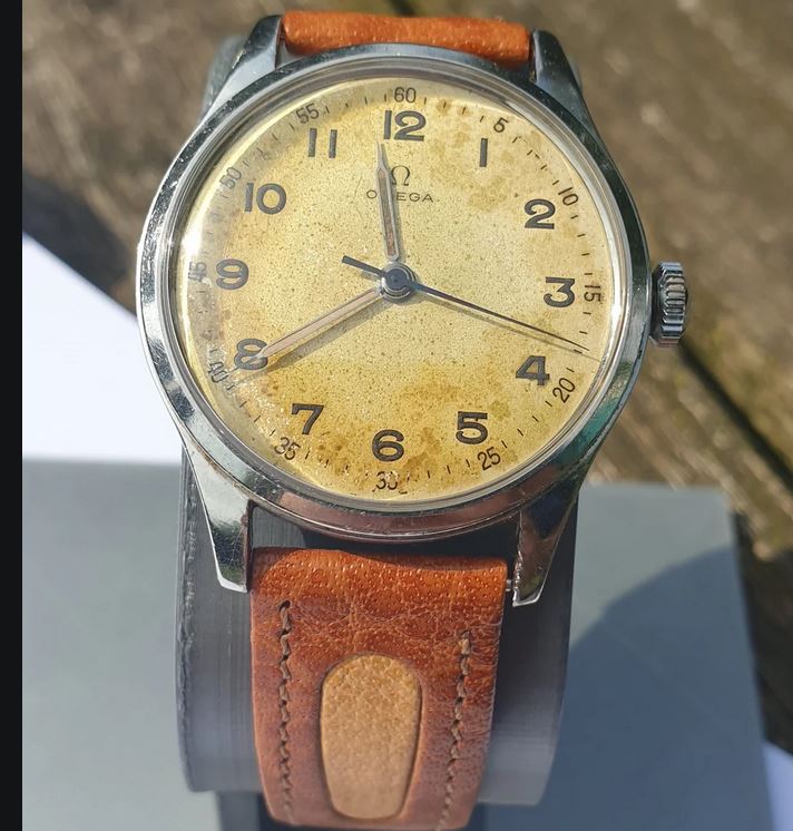

Hi all,
I came to you once more to ask your opinion about this one:

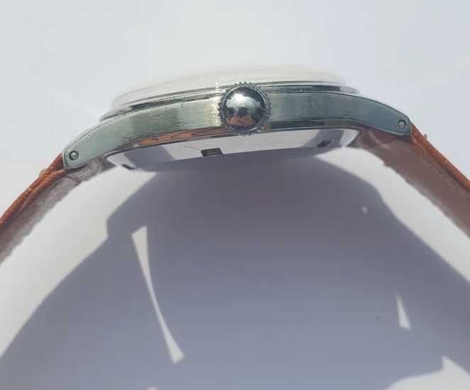

For me everything looks legit, except the crown should have the omega logo on it or not?
Thank you for your help.
Regards.

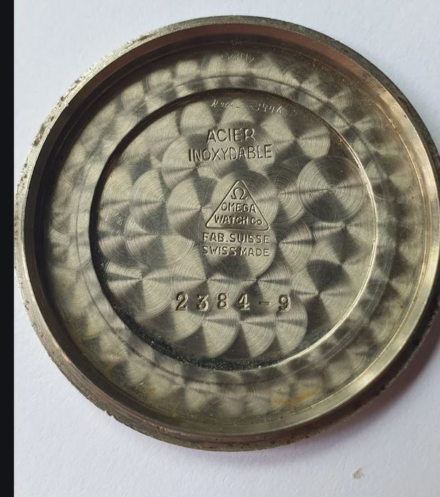

Do you have a picture of the inside of the case back? That will give us the reference number.

Maybe list the buy price to avoid the noob tax
It's in the subject line - 2384
Wow - sometimes you just can't see the forrest for the trees. Sorry about that, OP.
28
8
There you have it:
But this kind of model doesnt have the crown with logo of omega right?
Hard to say. A lot of these were originally produced that way and crowns with a symbol were substituted during the production live of this model, most likely. So, really, it's impossible to say and I wouldn't let that stop me buying it.
No crown symbol in this pic, but the shape is also different, which again is not necessarily wrong if it was Omega's recommended service part.
https://www.omegawatches.com/en-us/watch-omega-other-omega-ck-2384
DON
700€ with shipping included.
From your experienced eyes, looks like it was serviced?
Thank you for your support.
Regards.
8,848
62,672

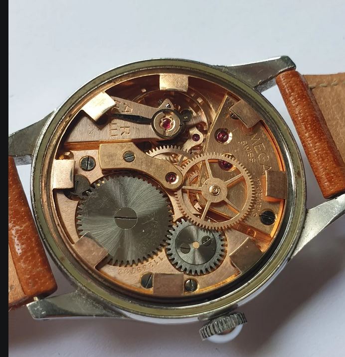

Service? Why is the original yellow gasket still installed?
Ask for written proof of service that is verifiable and even then hold your nose and hope.
Seems high with the condition of the dial. Your call on that.
4,593
10,813
Yep I would be skeptical of the service considering the grunge on the inside of the case back and yea that price is way more than I would pay for the watch, but keep in mind I'm a tight wad 😁
