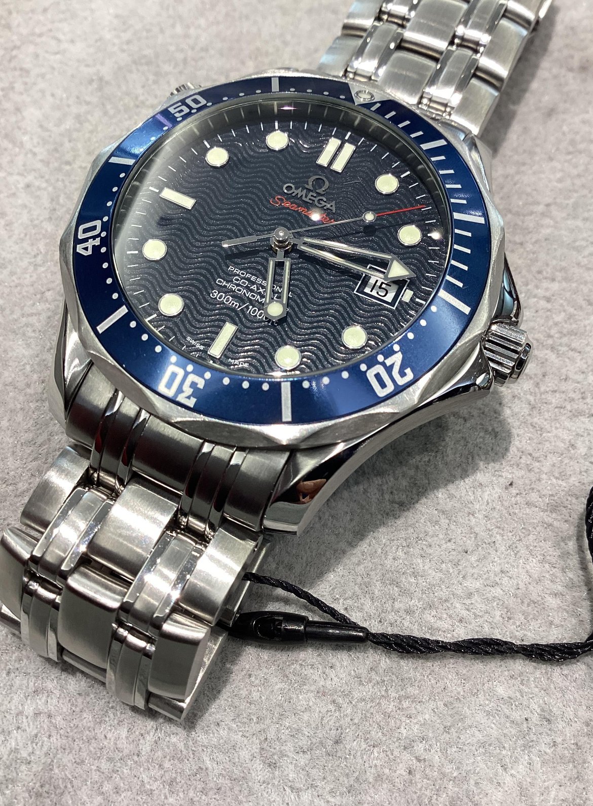

This is the one, does it look legit?
Looks fine from what I can see, some of them look very original, some look very bad, that one looks as it should but can’t say for certain, I wouldn’t be bothered by that one though.
5
Was from a company in Japan, box and papers and the company hade great reviews.
