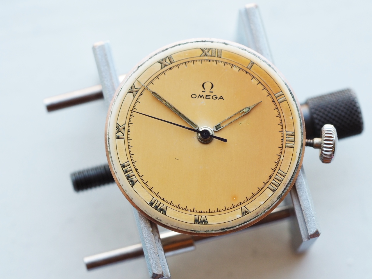

Looks all good to me. Very nice dial. Your watchmaker should have some waterbased tritium left, I hope..... If so, tell him to leave the fragments in the hand and secure from the back of the hand with waterbased tritium 2 thin layers should do. Then colour in with normal grey tinted water colours, like we had in school...... That fixes his mistake. Kind regards. Achim

Took some time but here’s a picture of the dial. During the service some lume from the hour hand fell out unfortunately.
This dial is simply a delight! I love it. Enjoy! 😀
Thanks! Not sure whether it will get much wrist time during the summer but I agree that the dial looks gorgeous. Now I just need to find the right strap and figure out what to do with the lume in the hour hand as i probably want to keep it as original as possible.
