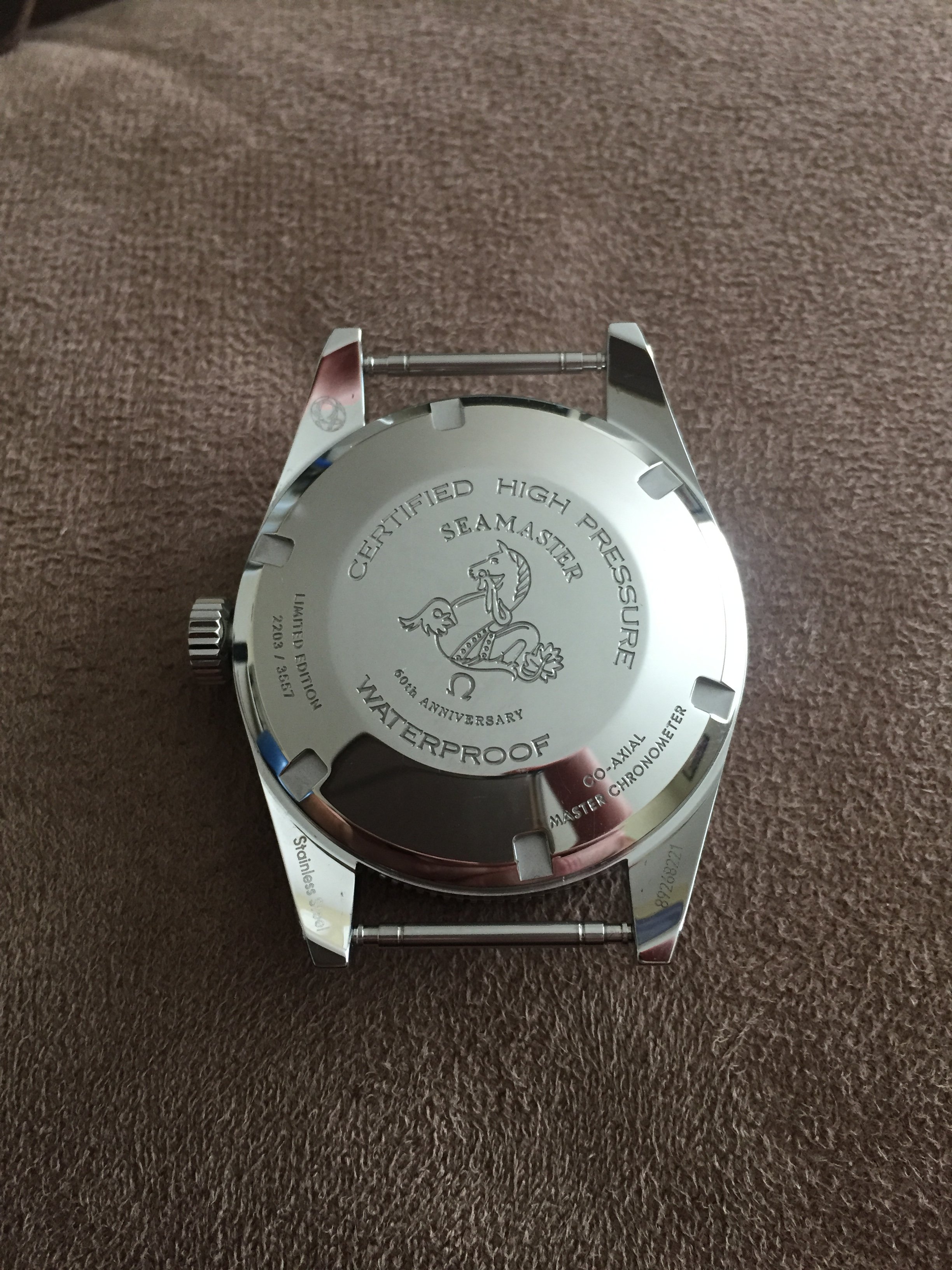

Hi I recently purchased the 1957 seamaster, and I think I read somewhere that the caseback is supposed to line up so that the logo is on center. Is that true? I dont mind that mine is off center just want to make sure nothing weird is going on with mine. Here is a pic of mine:
