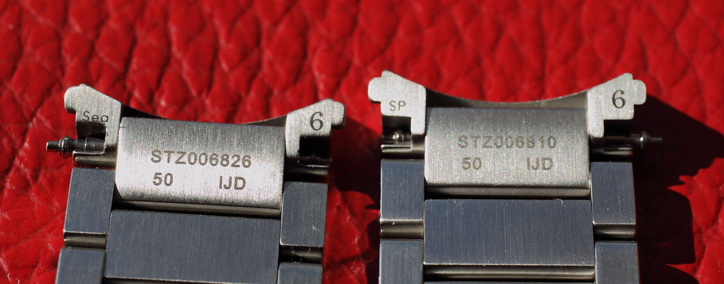

Anybody noticed that bracelets are differents ? Seamaster vs Speedmaster:
677
1,277
Clearly you have never worn a watch that really is a hunk of steel.
Indeed all three endlinks are different. I know for sure that the ones that fit the RM can't go on the ck2998.
I asked it on the boutique and they showed all three had different reference written on the end link. Being this reference for the bracelet. Maybe the end links aren't the same, but the bracelet looks to be, so I wonder if the same bracelet could be used with the three different end links in any of the watches.
231
510
There's a big possibility that you can fit all the different end links with the same bracelet. I think this question is only relevant if you have bought 2 or more pieces in the Trilogy and would want to sell 1 bracelet and keep the other. But then again, the buyer would have to buy new end links for himself as the bracelet is useless without them.
1,060
1,633
last inner link before the endlink is different too..
1,210
1,690
No sell implied in my question. One can have two pieces of the trilogy and wants to start wearing just one bracelet on both watches to keep the other bracelet new. As the three cases are 19mm but different size, I doubt they'll share end links but thought maybe changing the end link, they could share the rest of the bracelet.
