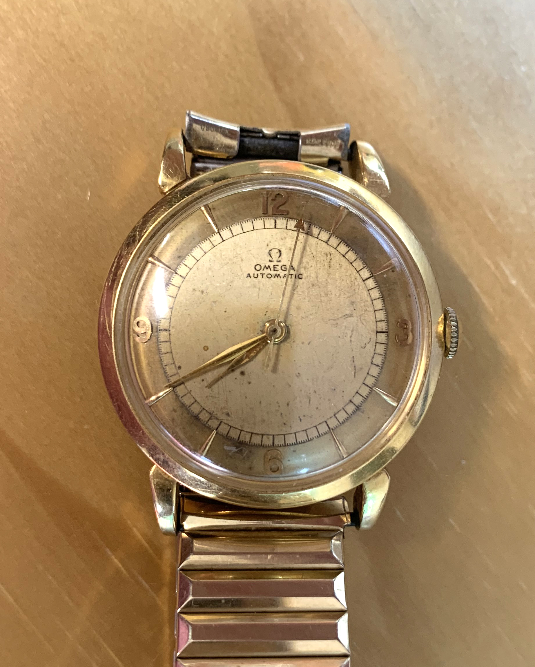

Can anyone lead me to a site that can tell me much about this watch. Someone just offered a very low price and I want to arm myself with information. Thanks, Here is what I know 510 I think and 17 jewel. Serial number leads me to a 1944 production year.

We would really need to see the inside of the caseback and movement.
From the information you provided, this would be a frankenwatch, as the Cal. 510 movement is a manual-wind movement, not an automatic.
