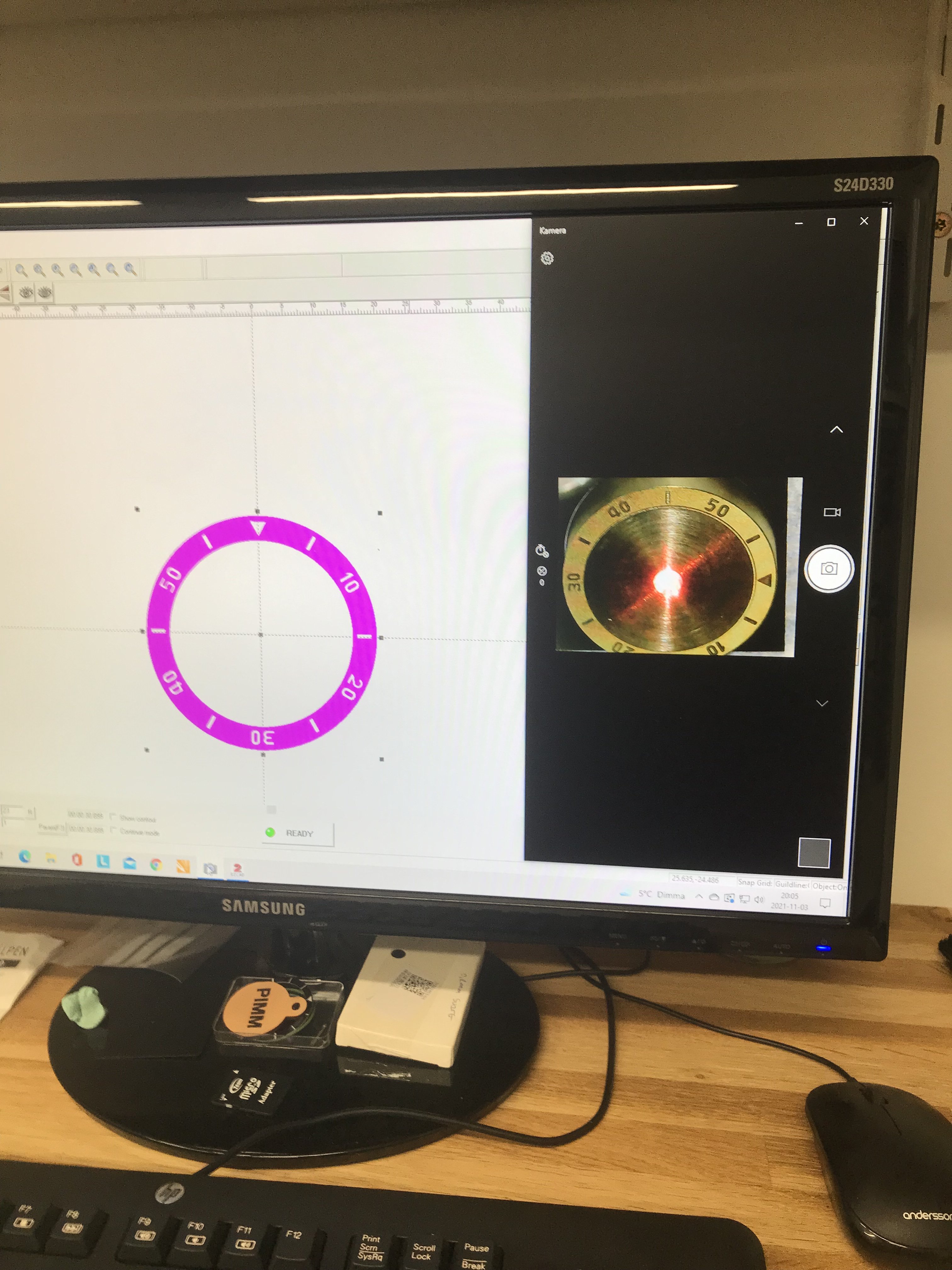

Got this bezel from a collector who wanted a more correct insert for his 165.024 -64
Made a layout and etched a forming tool.
Made some blanks from 1.25mm acrylic.
Now waiting for the paint to dry to fint out if the imprints are good enough..........

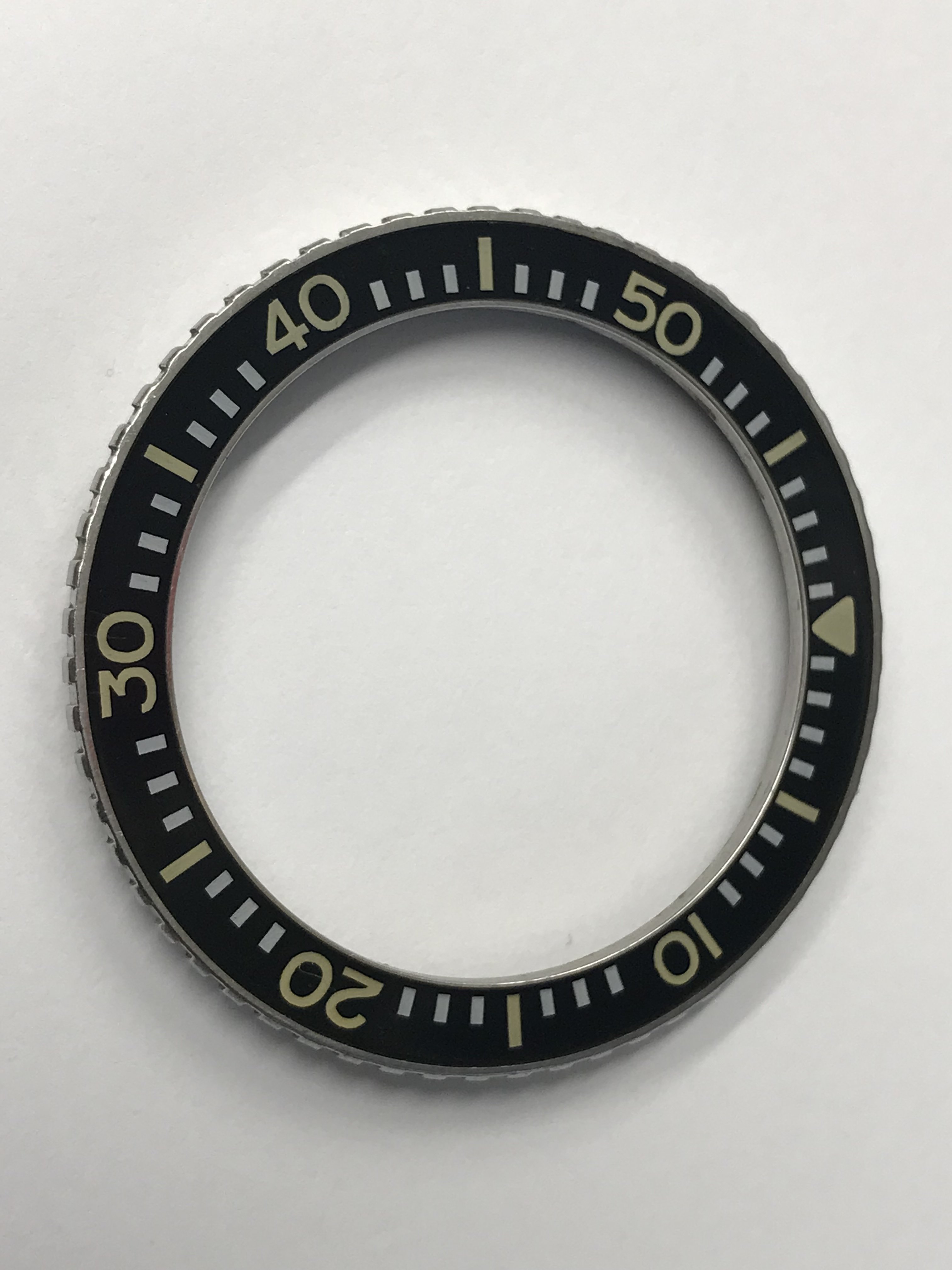

After beeing milled, the inserts are cleaned and the numbers/indexes are filled with a mixture of paint and lume powder.
Then it´s time to print the minute markers
Same here, I think I made 10 plates before I was pleased!
Here is a batch of test inserts after beeing printed.
After the markers are printed, the back gets a protective layer of lacquer so the final layer of black paint does not mix with the paint in the numbers.
A bit of touch up and they are done.

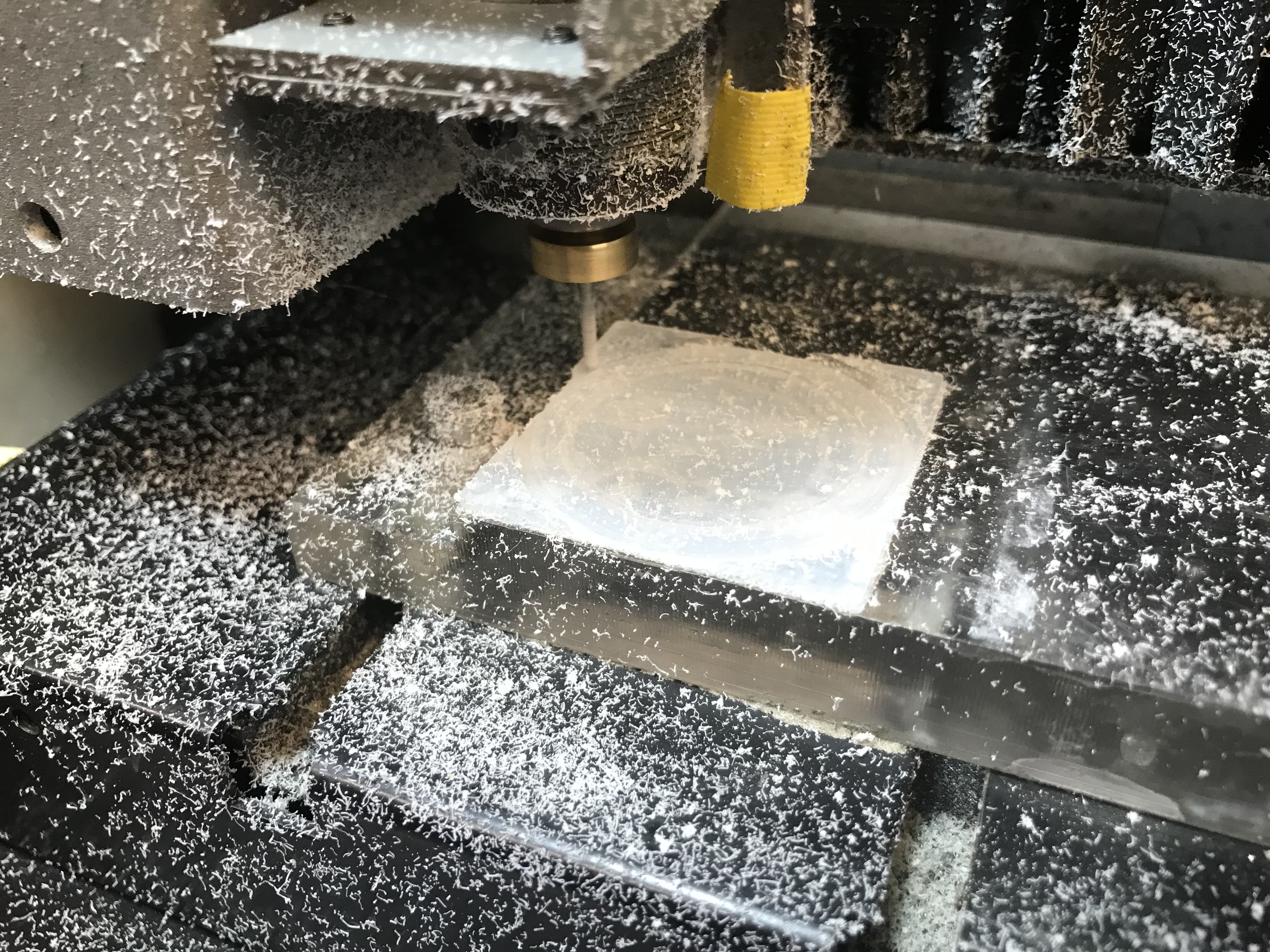

And here is a milled version..
The edges get a radius of 50um from the endmill but the back is very sharp.
Personally I like this version more, but the stamped ones are more true to the original.
