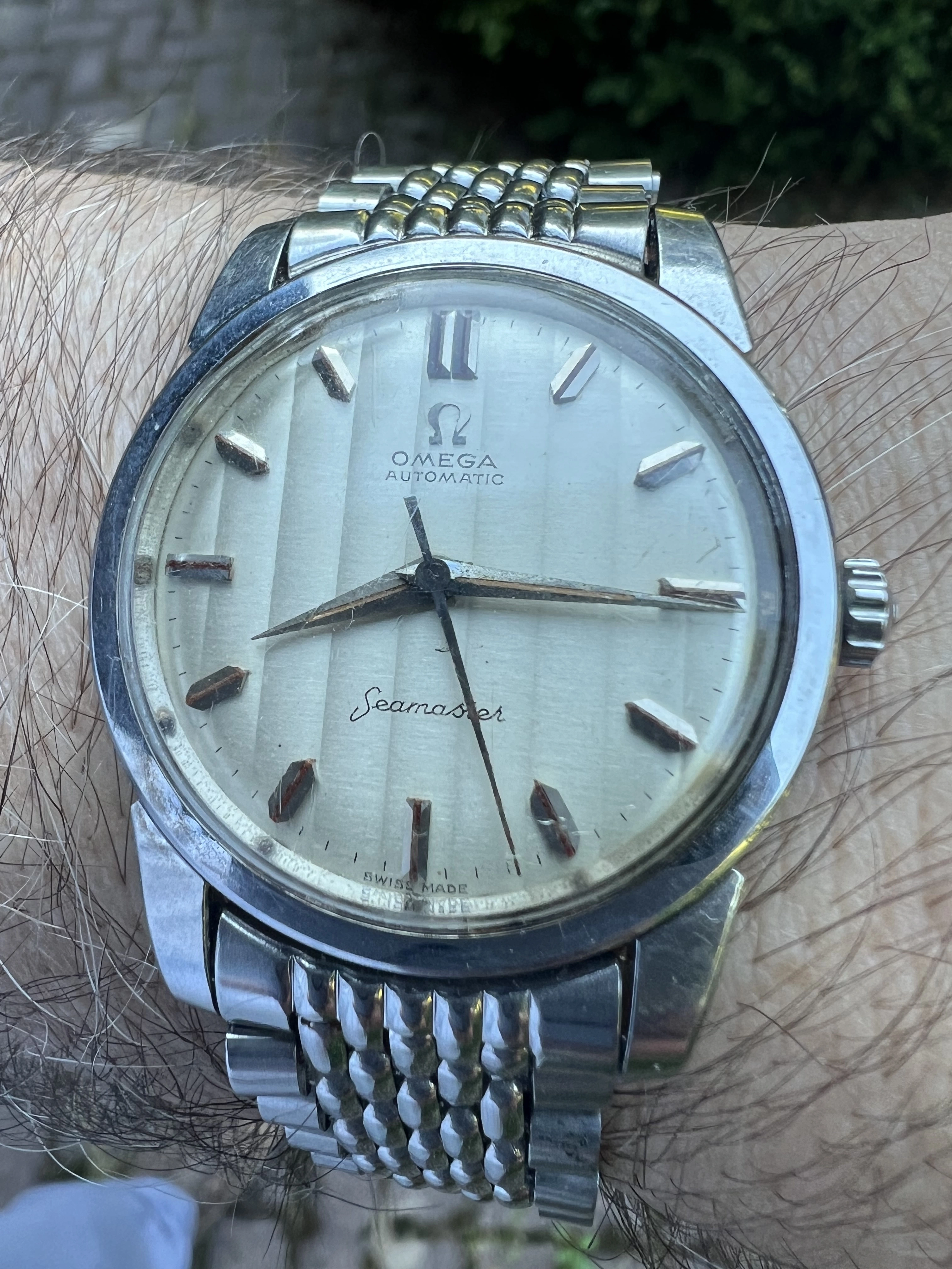

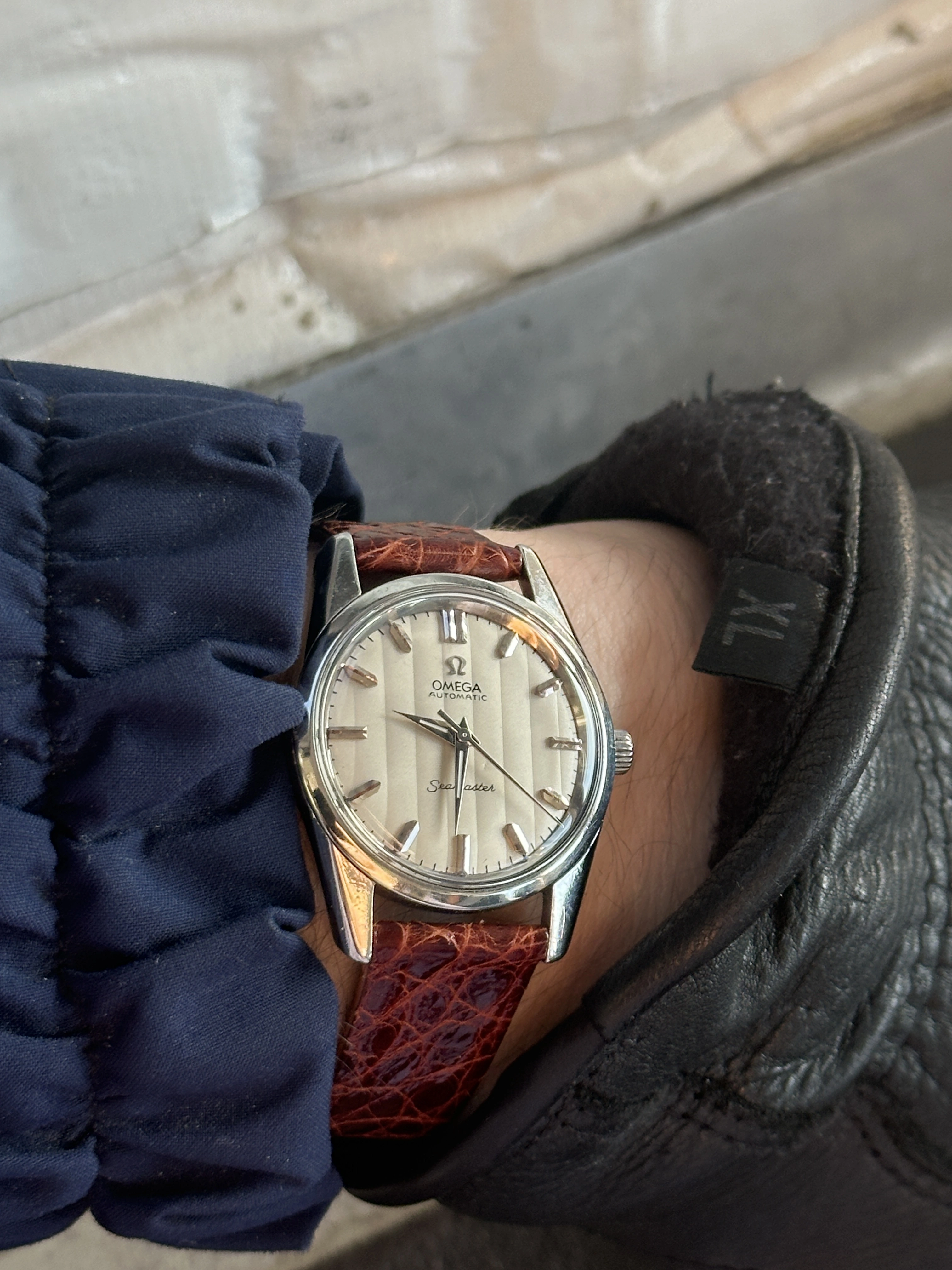

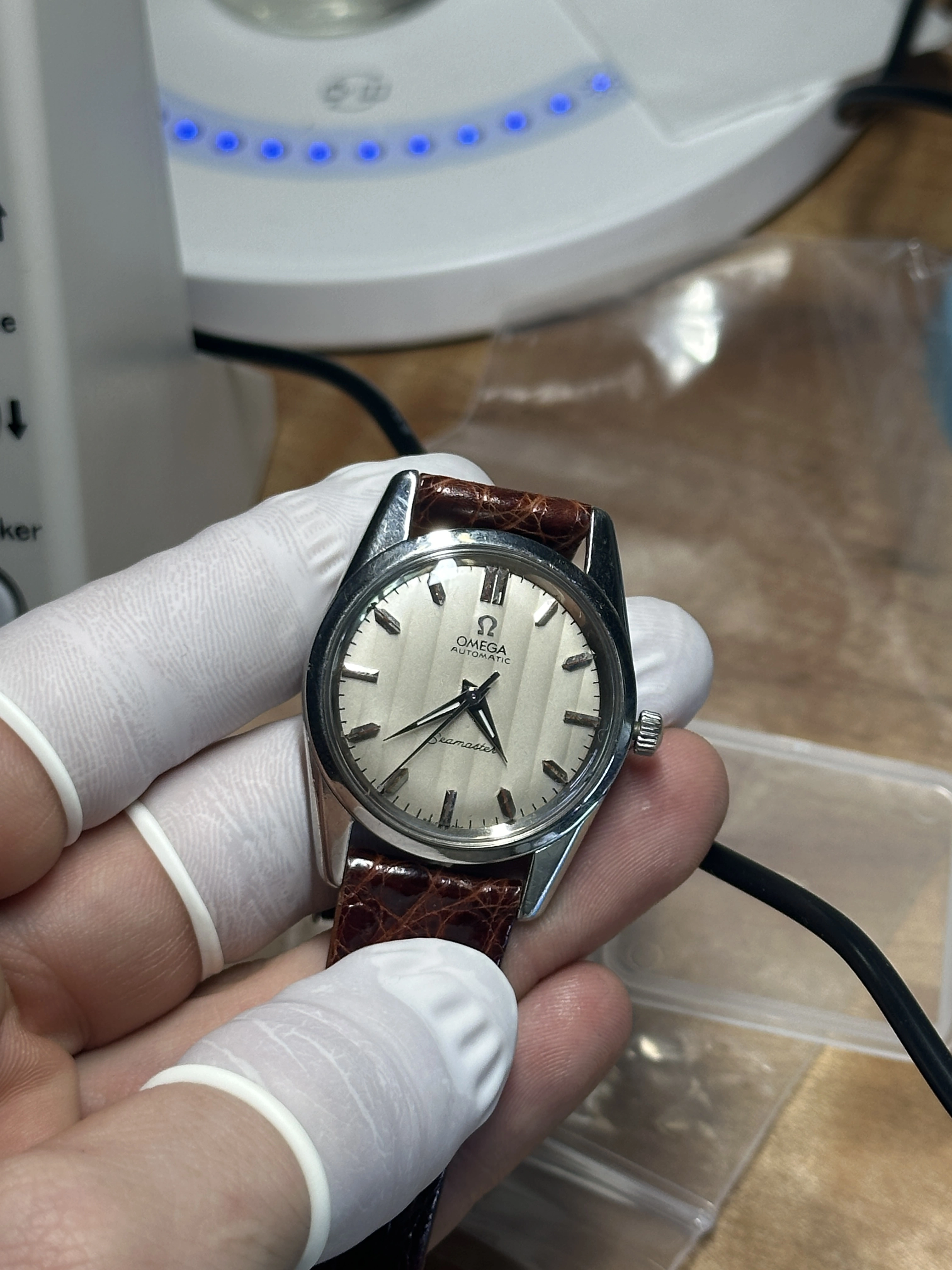

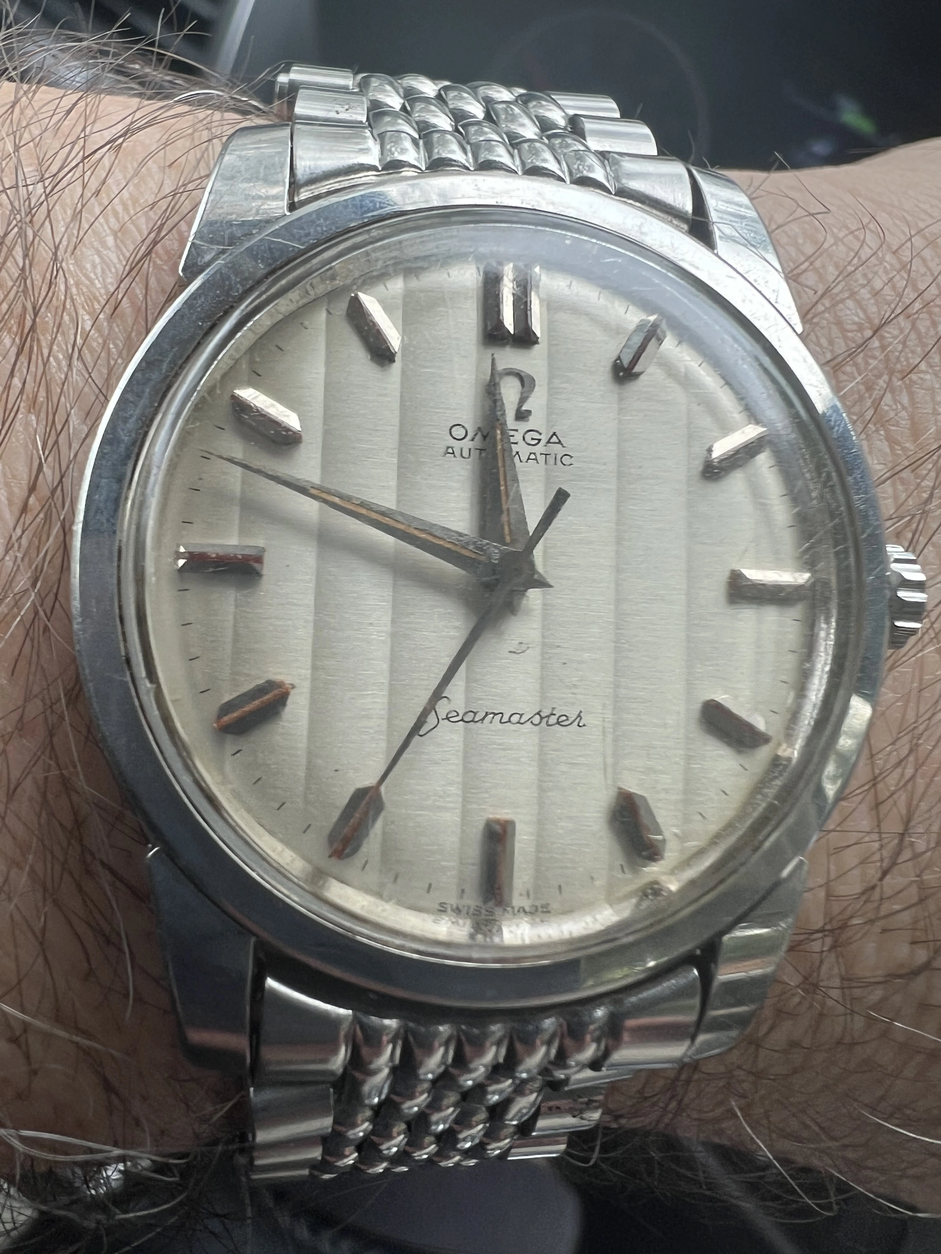

Good morning everyone,
I wanted to solicit some opinions about a seamaster that finally came off my bench and onto my wrist.
It was acquired as part of a lot by me about 4 years ago on eBay, non running with a broken balance staff and damaged impulse jewels. It was also missing hands, with a heavily damaged cannon pinion. I’ve finally gotten around to repairing and servicing the cal 550 movement, and while it runs like a top, there are many things on the dial and case side that stick out to me. I will note that the hands are aftermarket reproductions installed by me, and are just placeholders until a good set of vintage hands comes up on eBay.

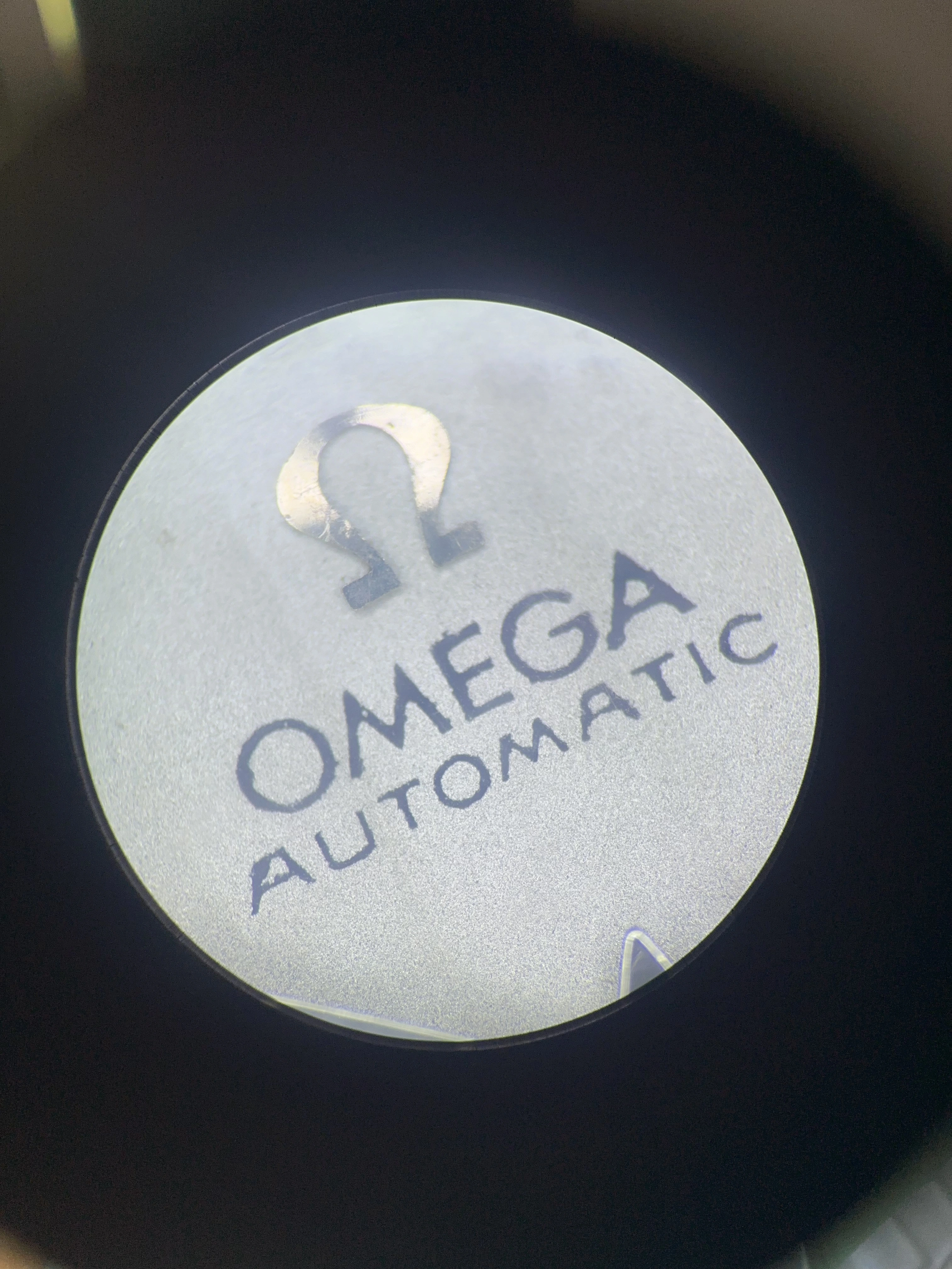

I’m guessing that it’s a frankenwatch, put together from a non matching case and dial, as it’s clear the dial does not fit the case correctly. The indexes are right up to the inner edge of the case, to the point where “Swiss made” is half obscured. Additionally, some of the printing on the dial looks sloppy under a microscope. Is it possible I’m dealing with a fake ribbon dial?
Regardless, I bought it for about $175 and with parts and my hobbyist labor, I’m not into it for more than $250, so I’m happy. Just curious about opinions. The case back lists the reference as 165.002.
3,675
8,001

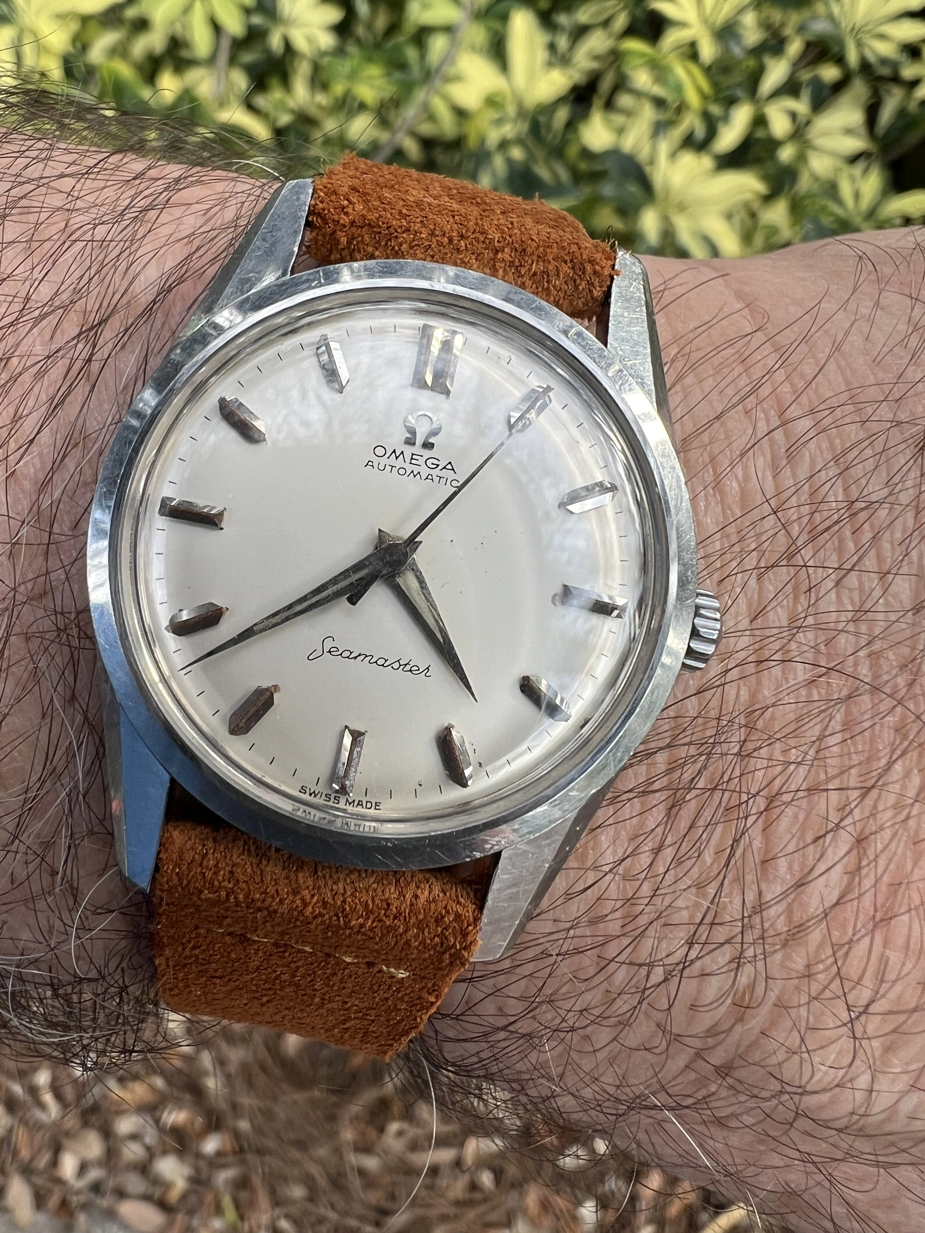

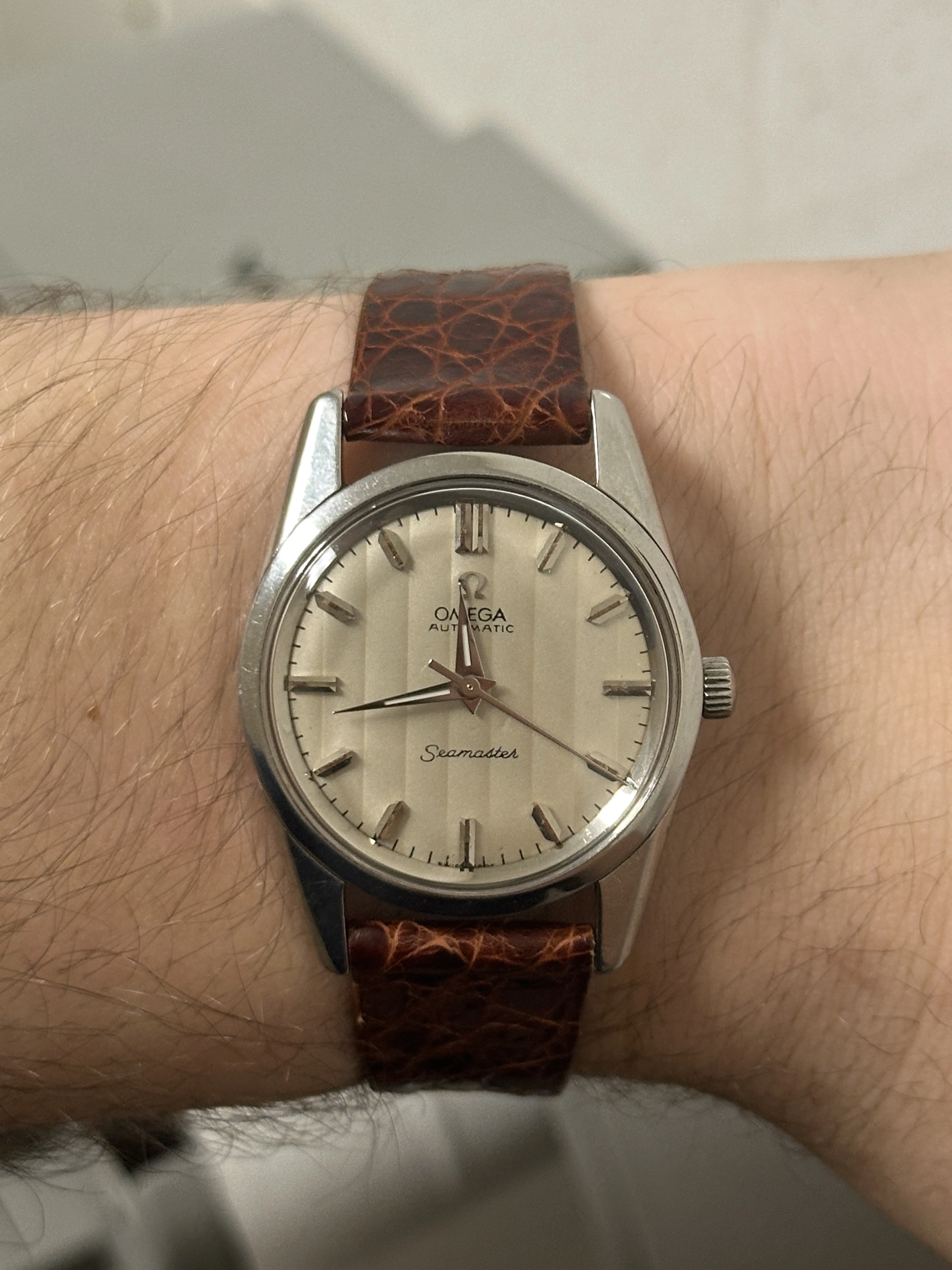

For comparison 14761 cal 552 ribbon dial. 1961. Radium lume. Coat hanger S.
Your dial has later Curvy S.
if you have UV light see if it instantly vanishes like radium the indices look like radium.

Good looking watch you’ve got there. This one definitely has the font, but upon looking at yours, the placement and line thickness looks good. The indices are definitely radium.
Your dial looks much more appropriate to the case size, so I’d guess that someone just put mine in the wrong case.

The dial has been repainted and the caseback is incorrect as the mid case is an early-mid 60’s seamaster (I don’t know the reference off the top of my head), while the case back is a mid-late 60’s 165.002 which isn’t correct for the case.
Thanks for the info, that’s about what I expected. What are the signs about the dial being repainted?
It doesn’t surprise me that the case and caseback are mismatched

The font is too thick and clumsy, not precise enough to be factory original. The minute markers are also too thick and large are aren’t accurately spaced around the hour markers

This could be your mid case- 14700 from 1961-62 - yours maybe polished version of this
14700 has cal 550 so maybe yours is that with swapped caseback and dial.
That looks about right, though my case appears so heavily polished that it has lost the sharp contours on the lugs.
I wouldn't be surprised if you're right. At this point I'd almost rather find a 14761 case and drop this into it while I look out for a 552, though the difference is negligible.
