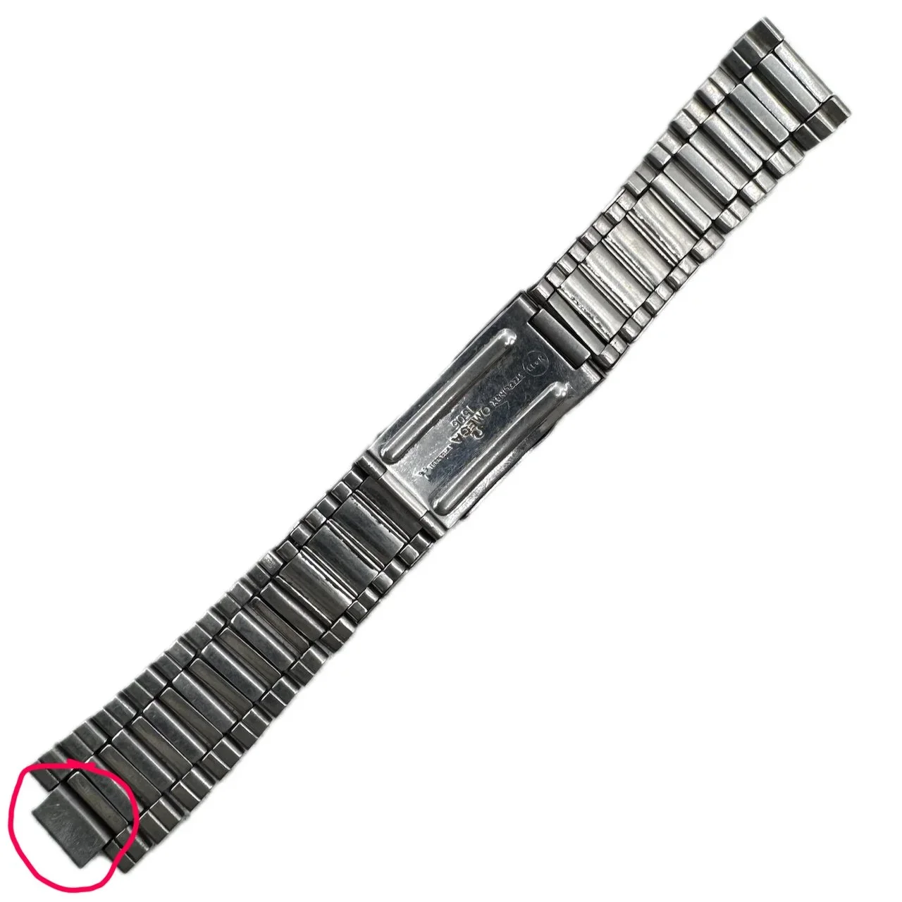

I recently acquired a 1506/16 bracelet for my Speedy 105.012-65. It doesn't come with the #16 end links (they never do hehe), but it also has the 'end piece' tab missing on one side of the bracelet - see attached pic in red for what I am referring to, and note it missing on the other side. I am having a hell of a time figuring out what exactly this piece is referred to as and whether there are any options for how I can source this piece specifically ex Otto Frei? A current non-OEM option, etc. Any advice?

Pull it tight and give a good shot of the bad side.

I’m afraid your only option is finding a donor bracelet with this part.

What @M'Bob said. You need a donor bracelet piece as it looks like you're missing the final two folded links along with the spring bar "loop" piece.

your best bet is to hunt for a partial 1039 on ebay. I think each side should have 8 folded links.
