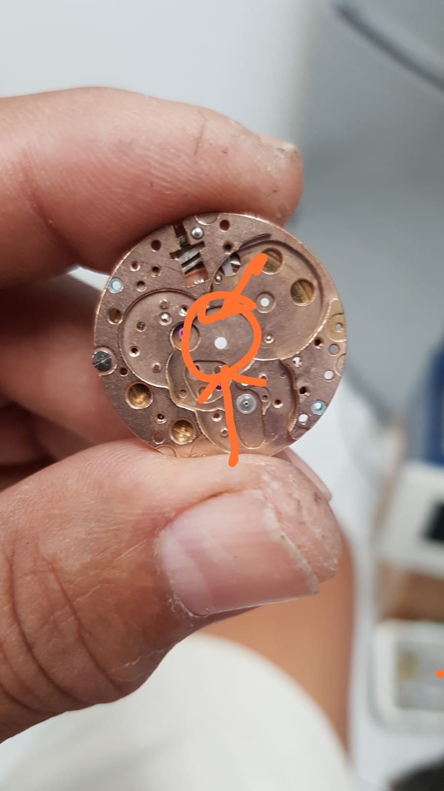

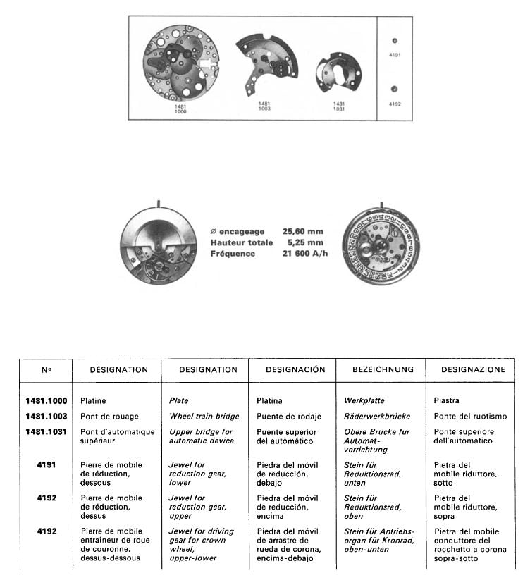

I have an Omega Geneve with a 1481 movement. Unfortunately the center jewel on the main plate has broken and I am trying to figure out which jewel part it is. I've been on the Cousins website and found the one page manual that is available for the 1481, however I am a bit mixed up on the terminology they are using.
Based on the manual they only indicate two jewels - 4191 or 4192. Does anyone know which jewel part number it is for the center jewel?

4097 is the correct number
