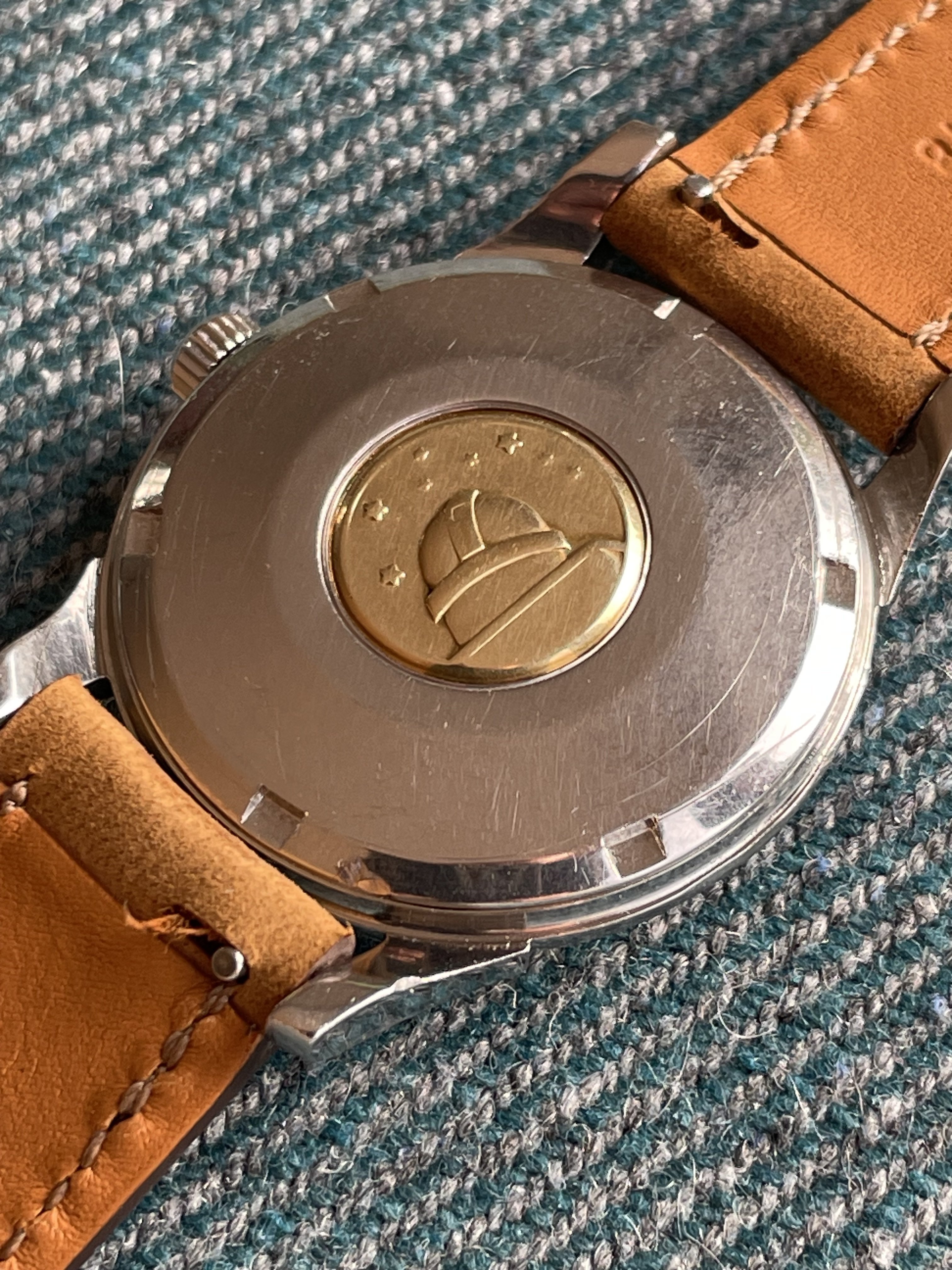

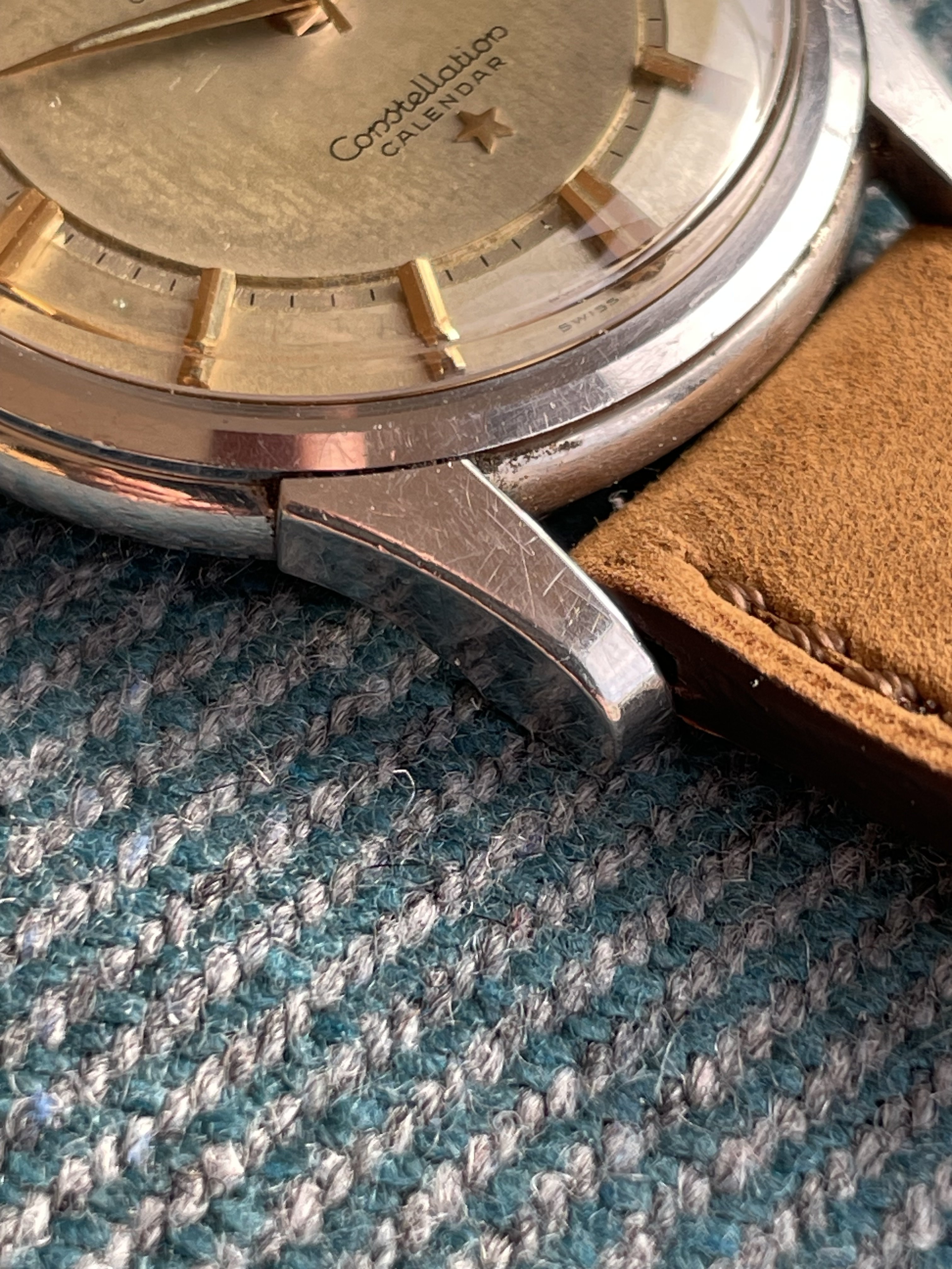

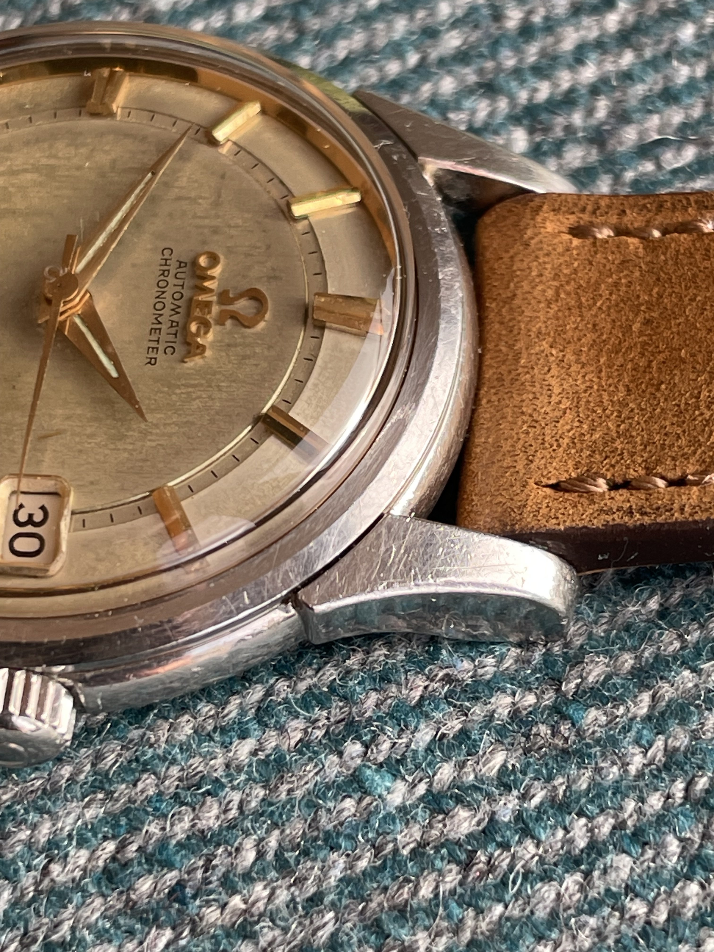

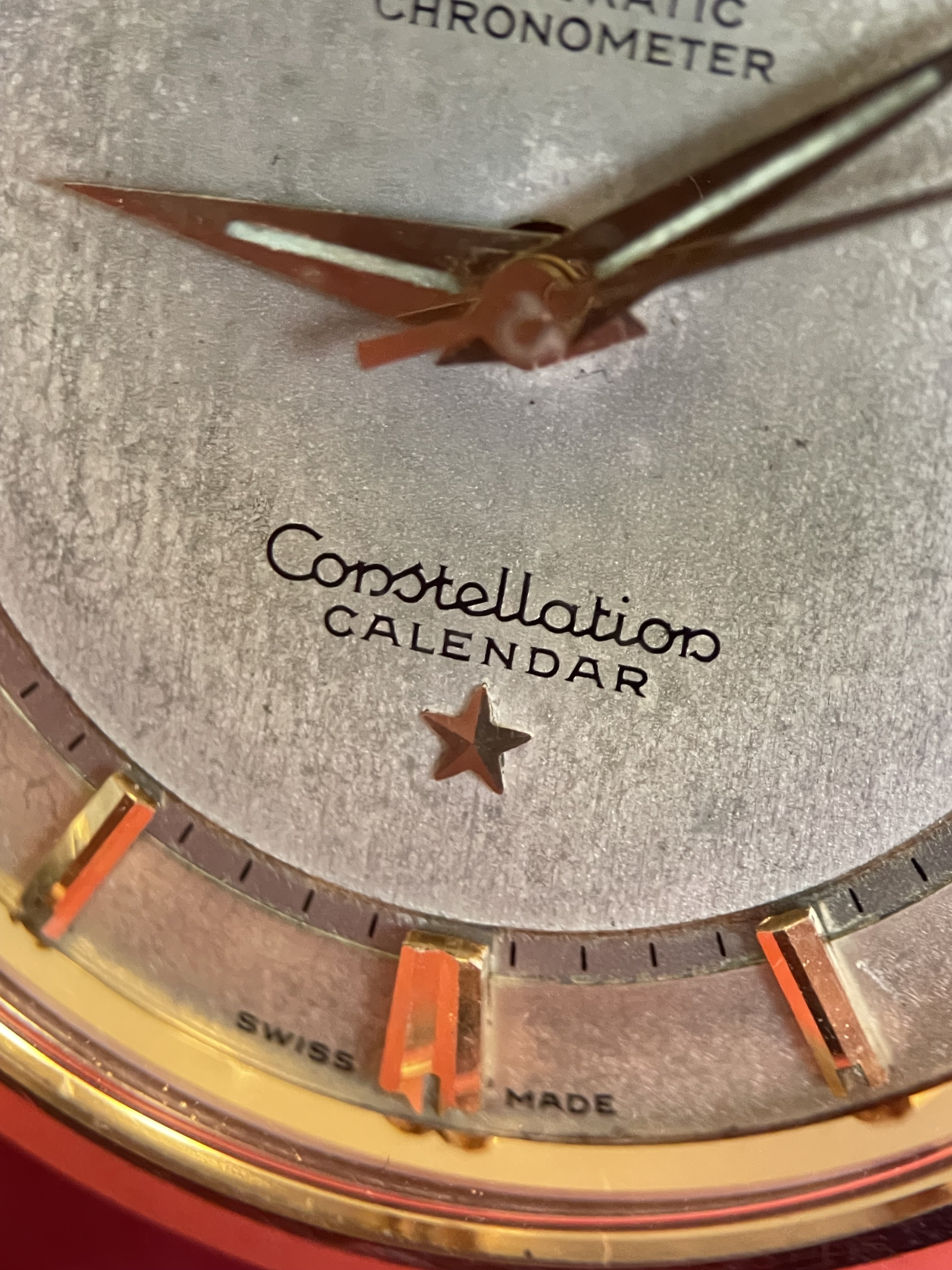

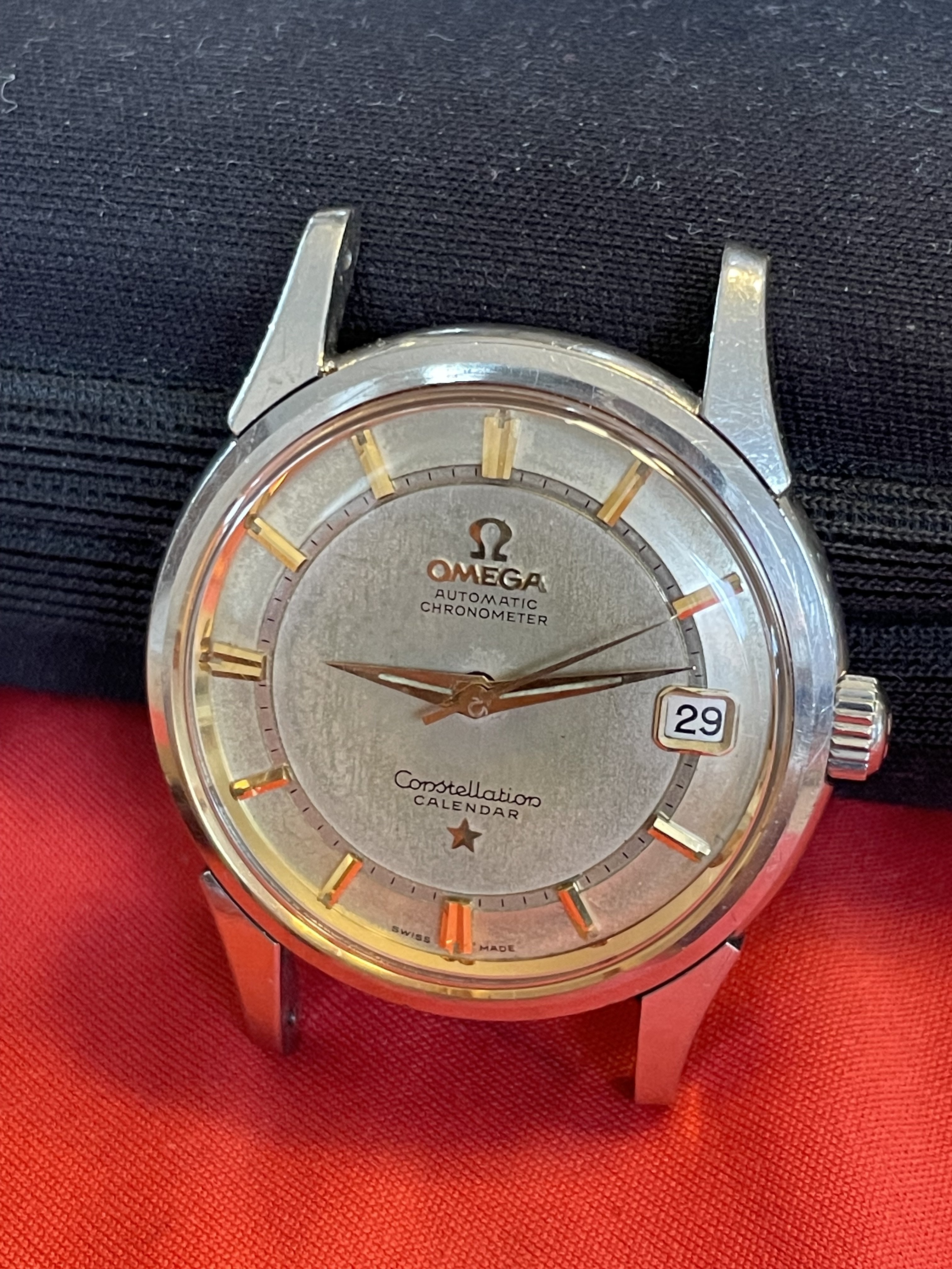

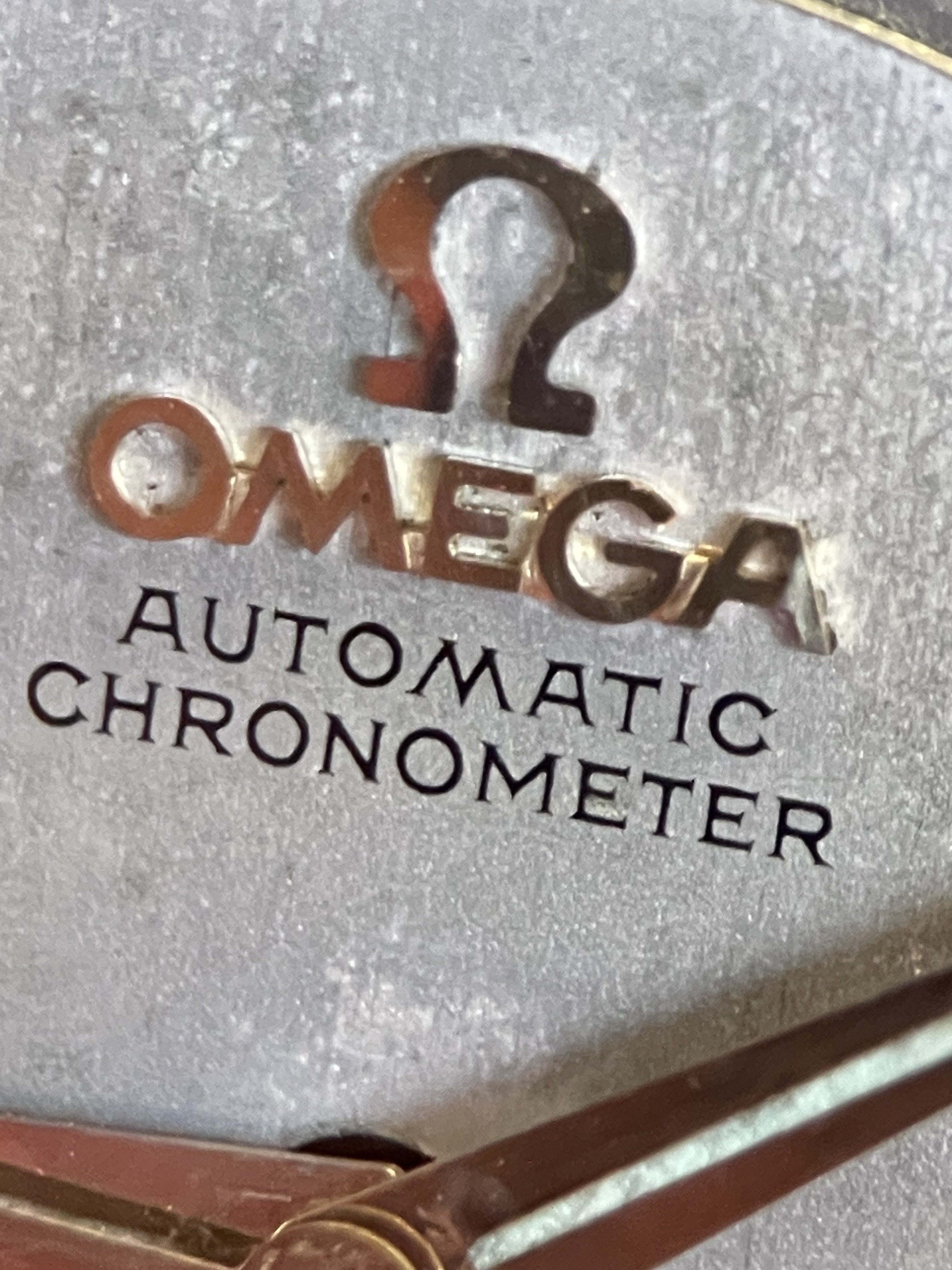

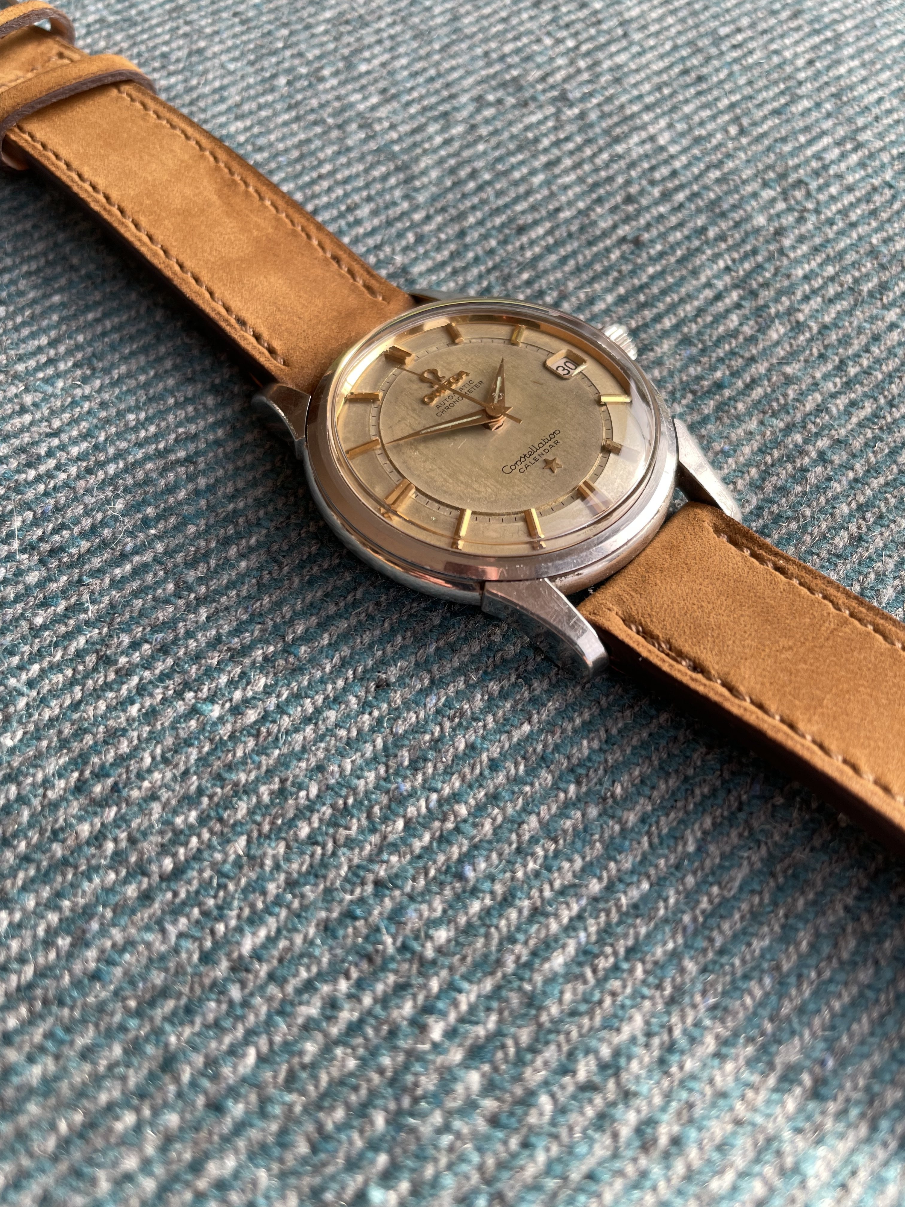

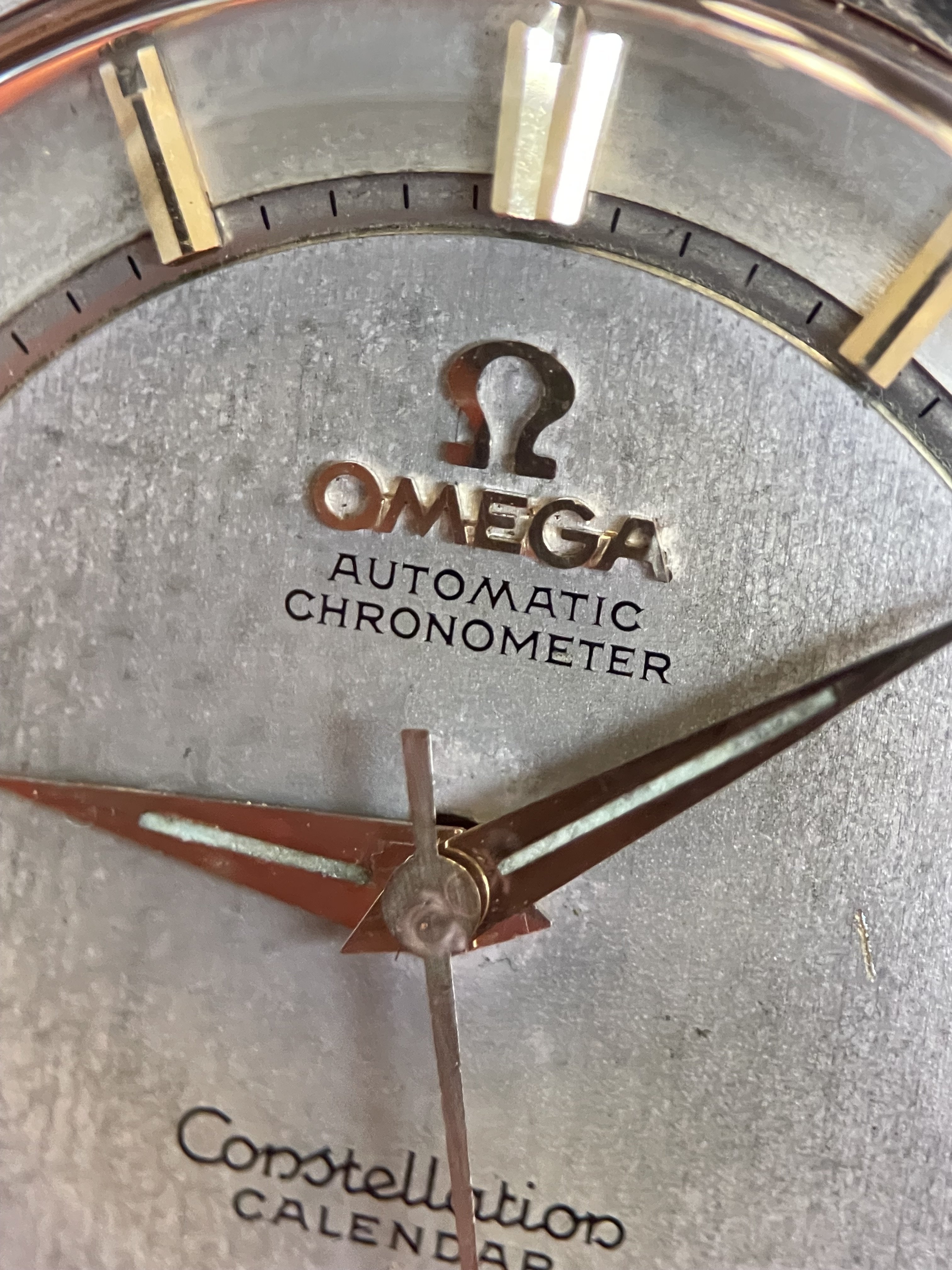

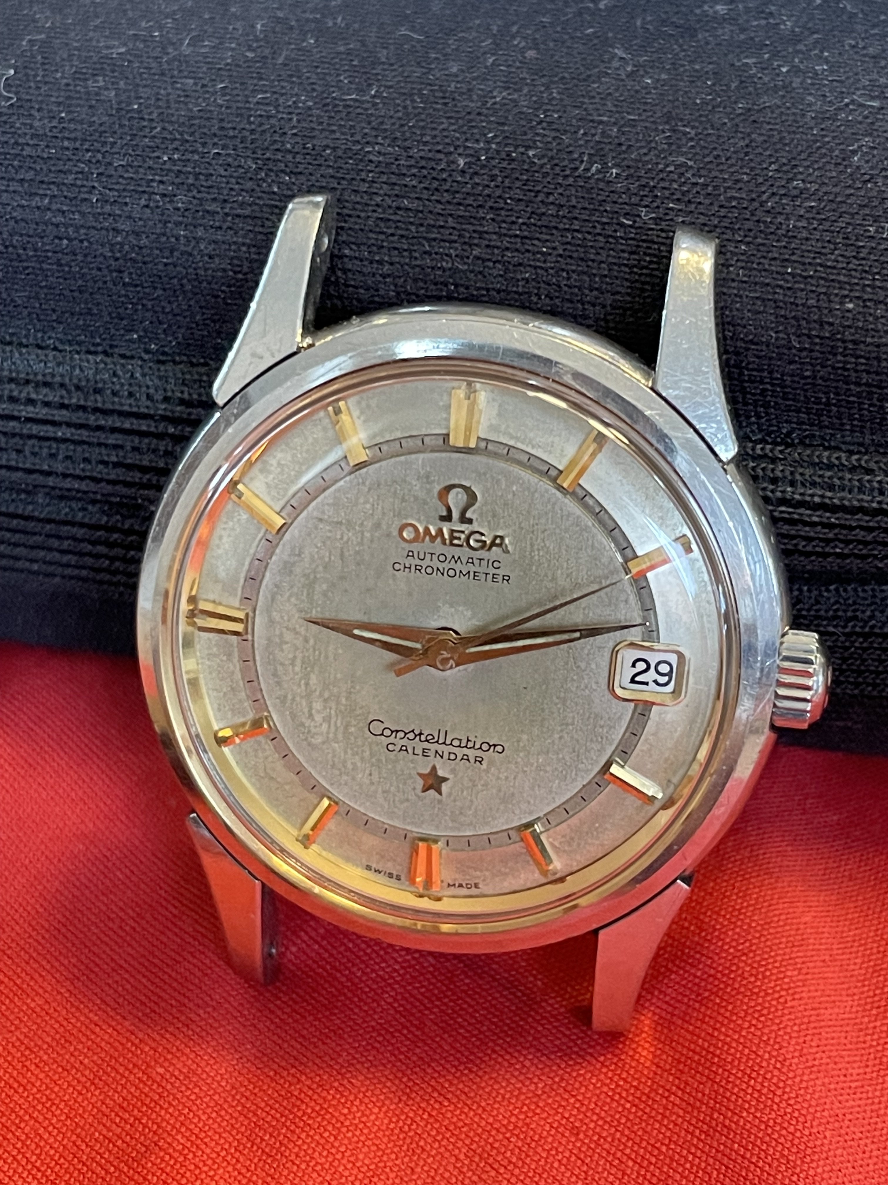

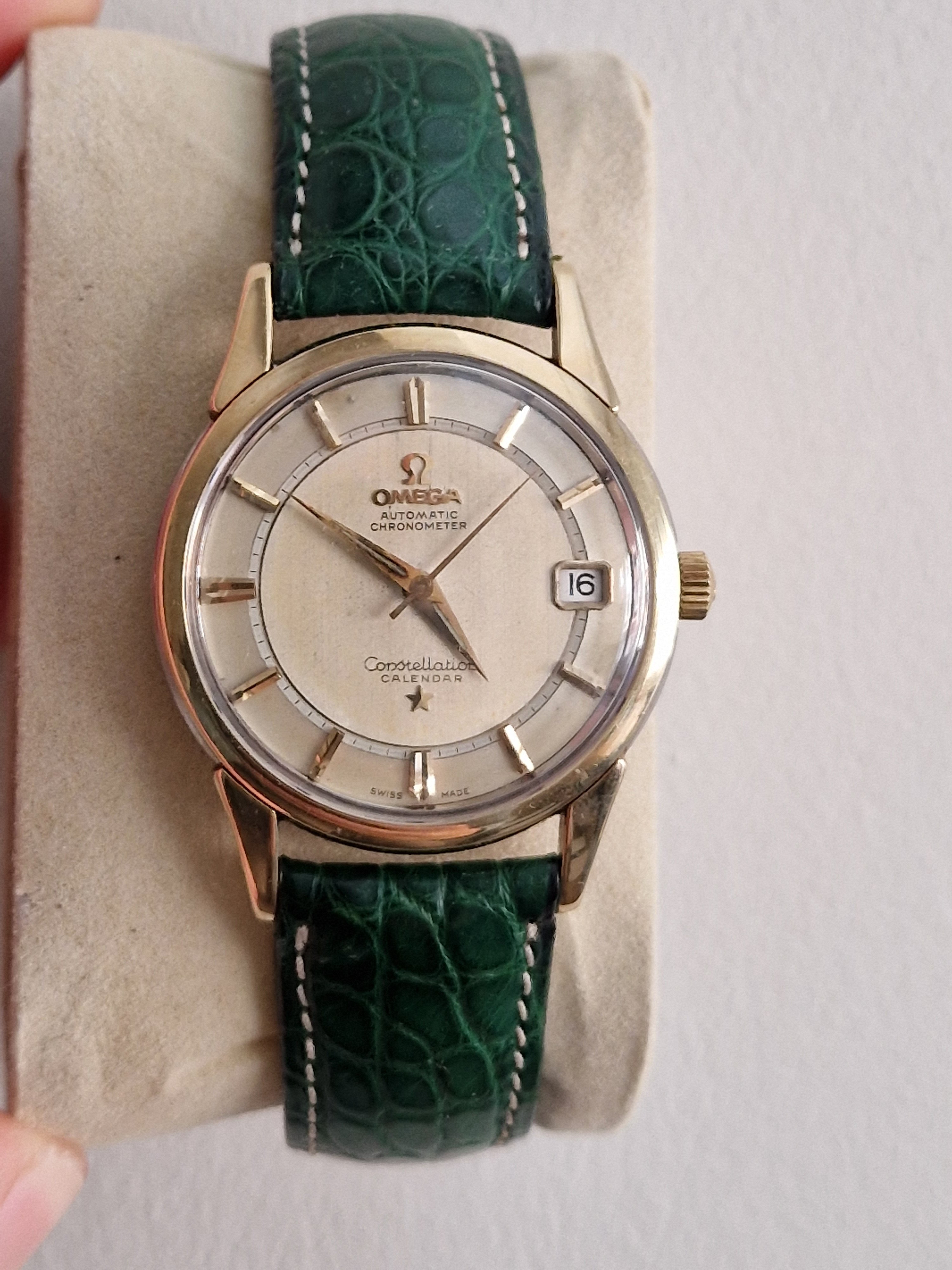

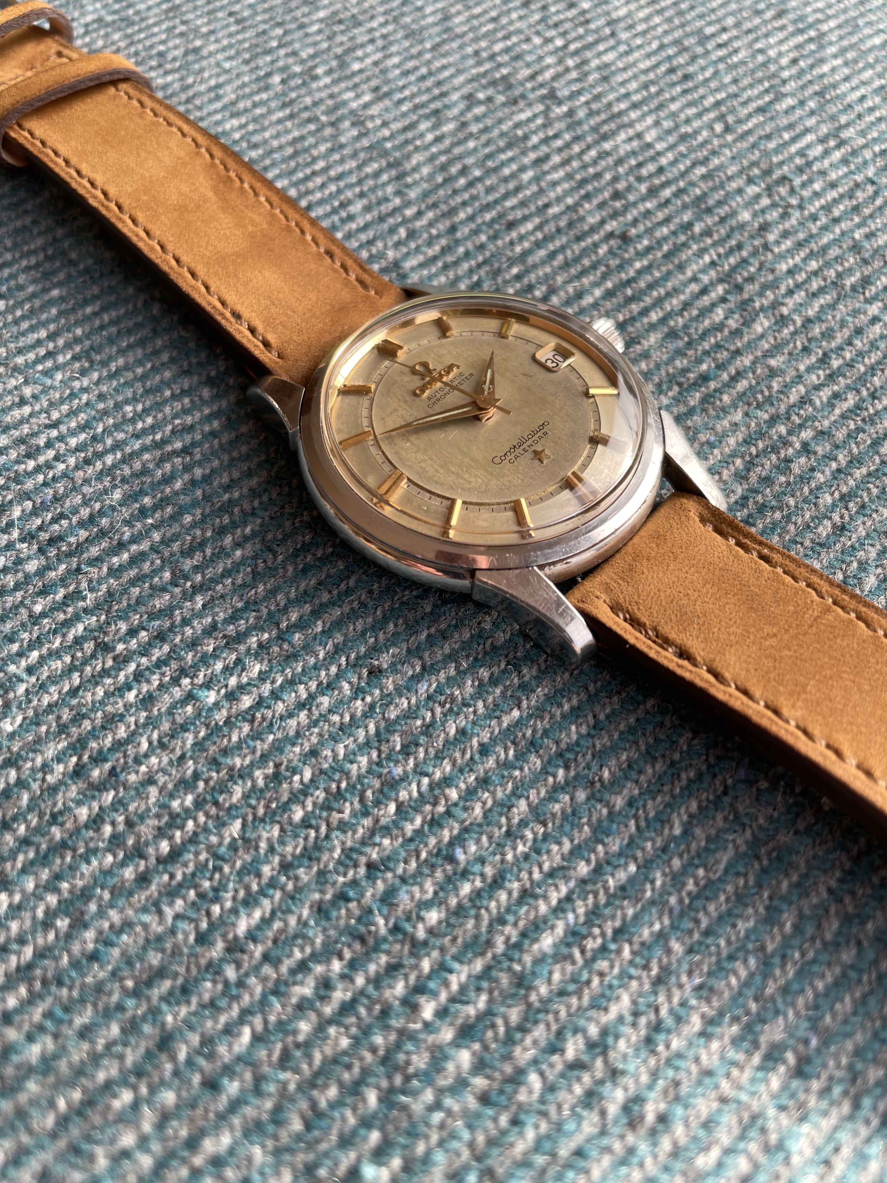

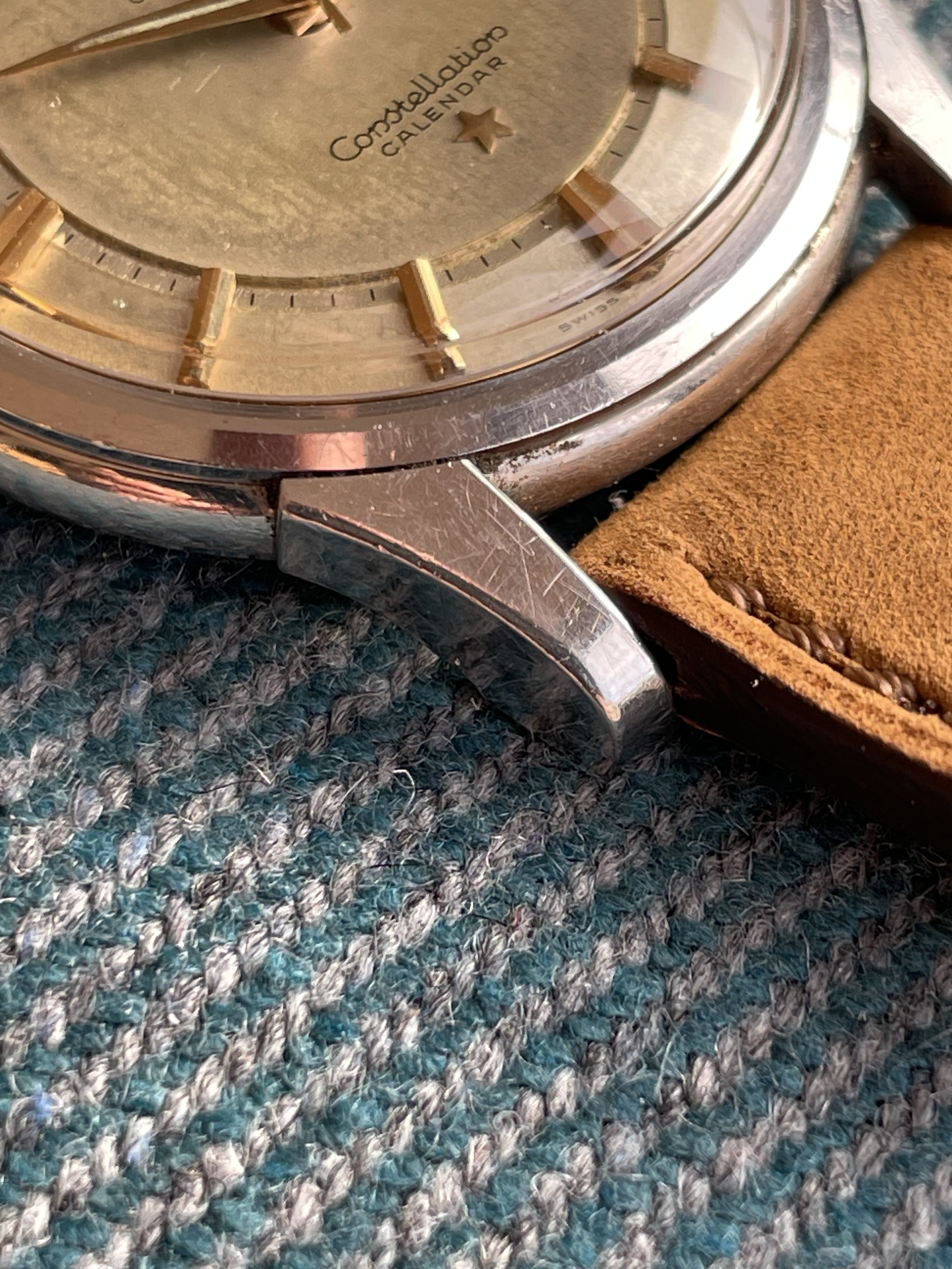

Hello everyone,
last week I spontaneously bought a 14393 Constellation Calendar with railtrack dial, which has just arrived.
My assessment:
- Case looks good, unpolished or only slightly polished
- Dial original (of course with patina) the writing looks good
- Glass original
- Crown original Omega but not correct for reference
- Hands I am not sure, but should fit
What is your opinion?
Best regards, Andreas
453
1,305

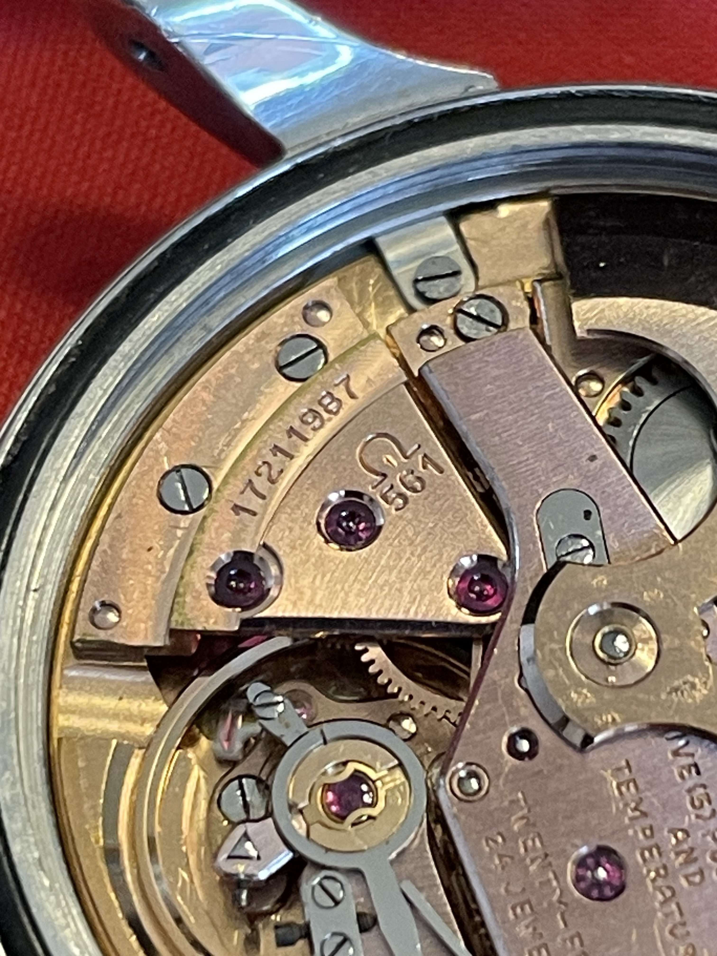

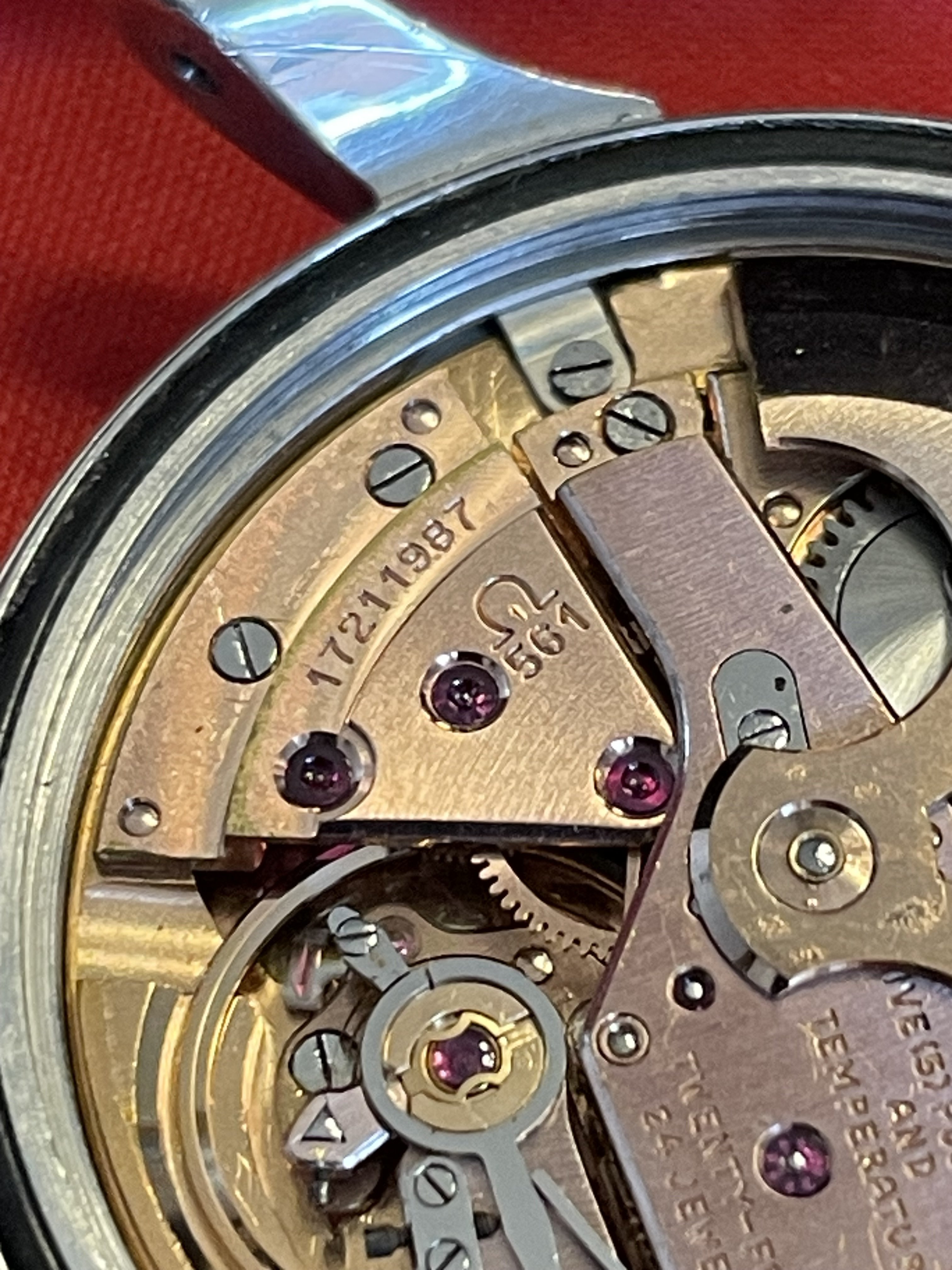

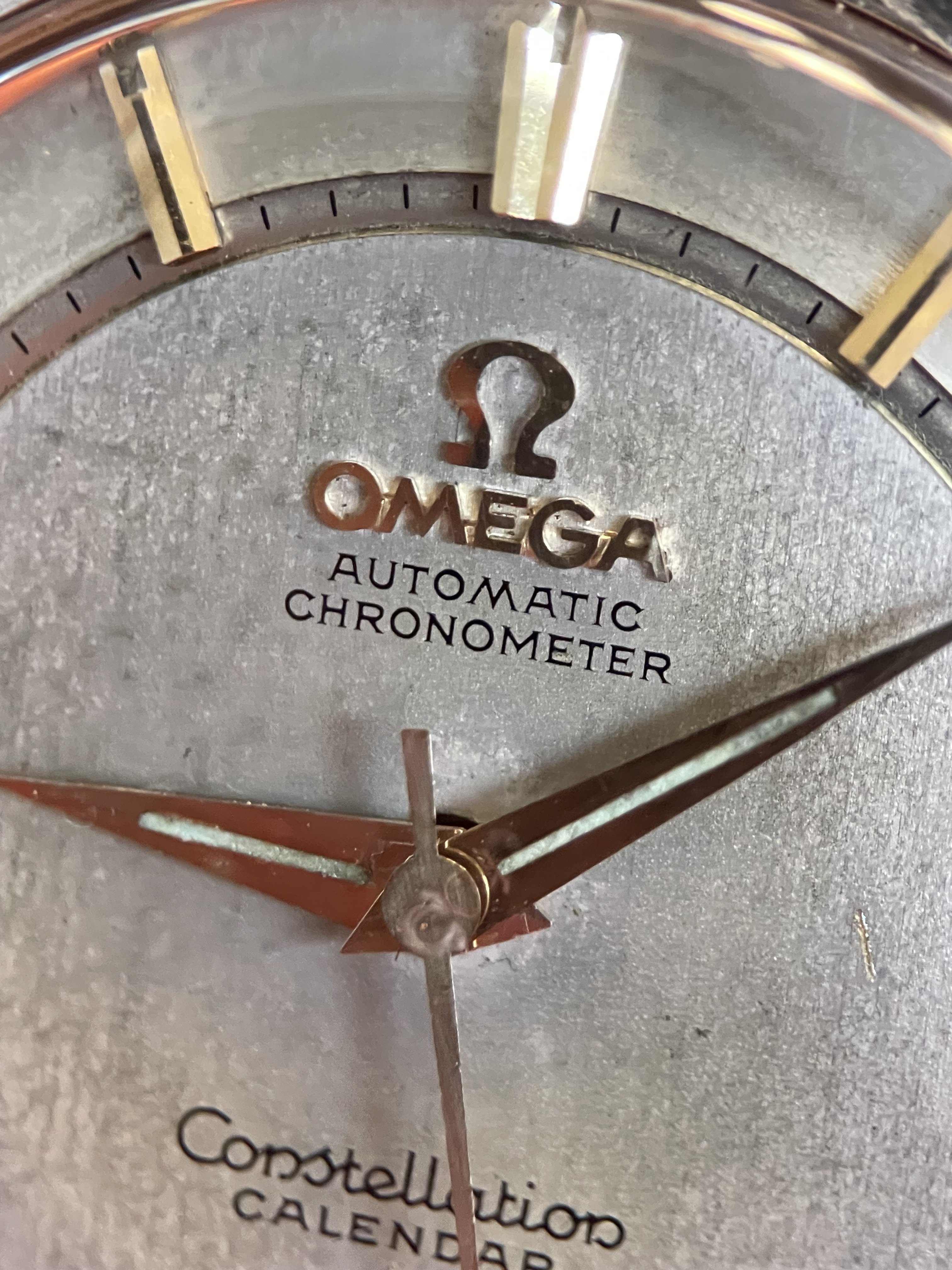

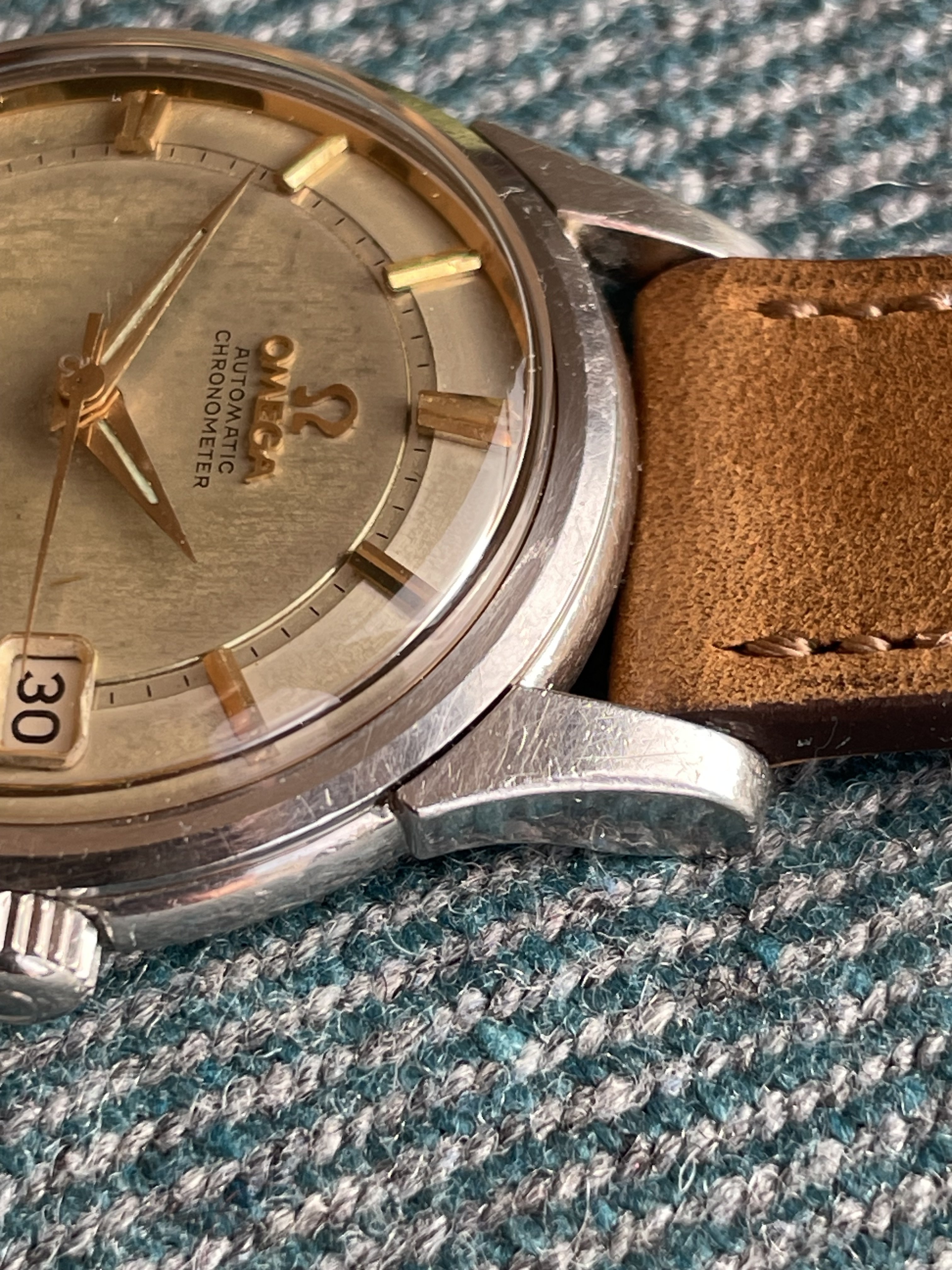

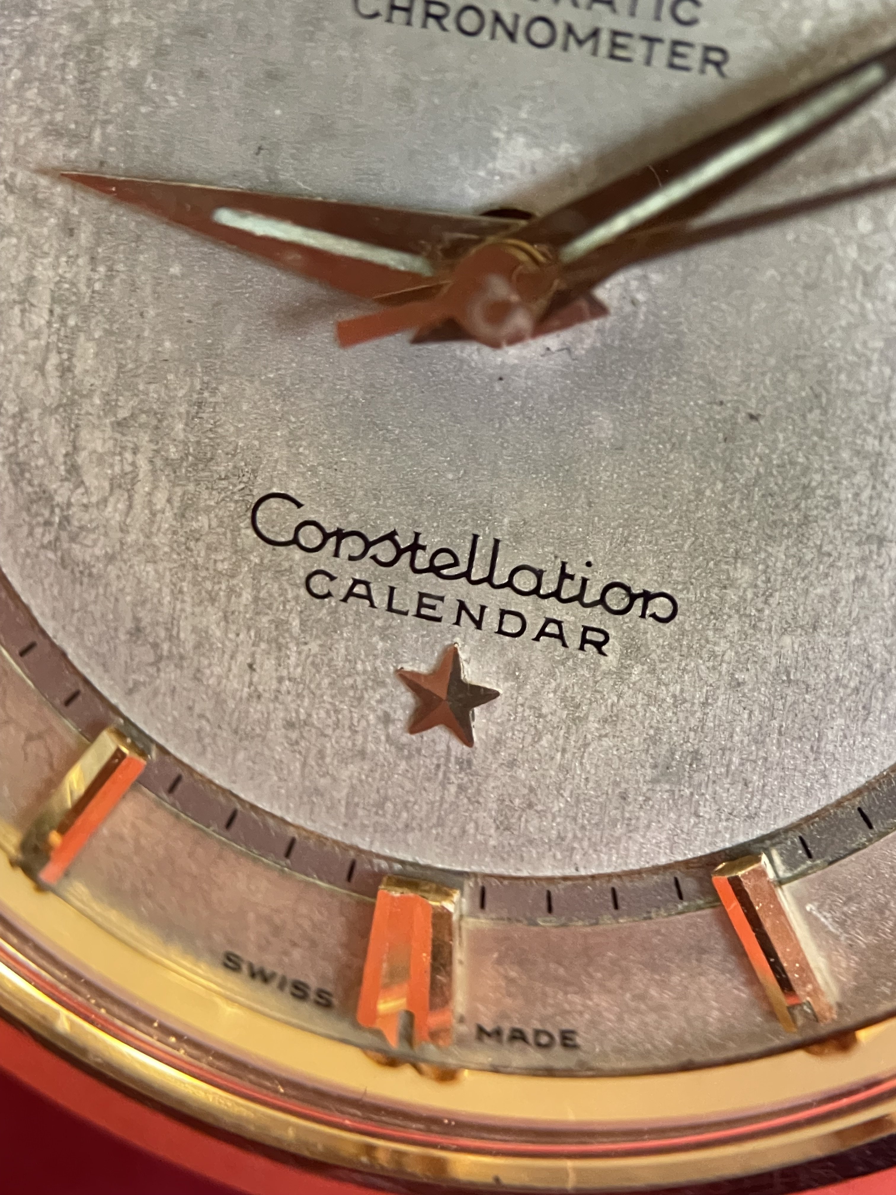

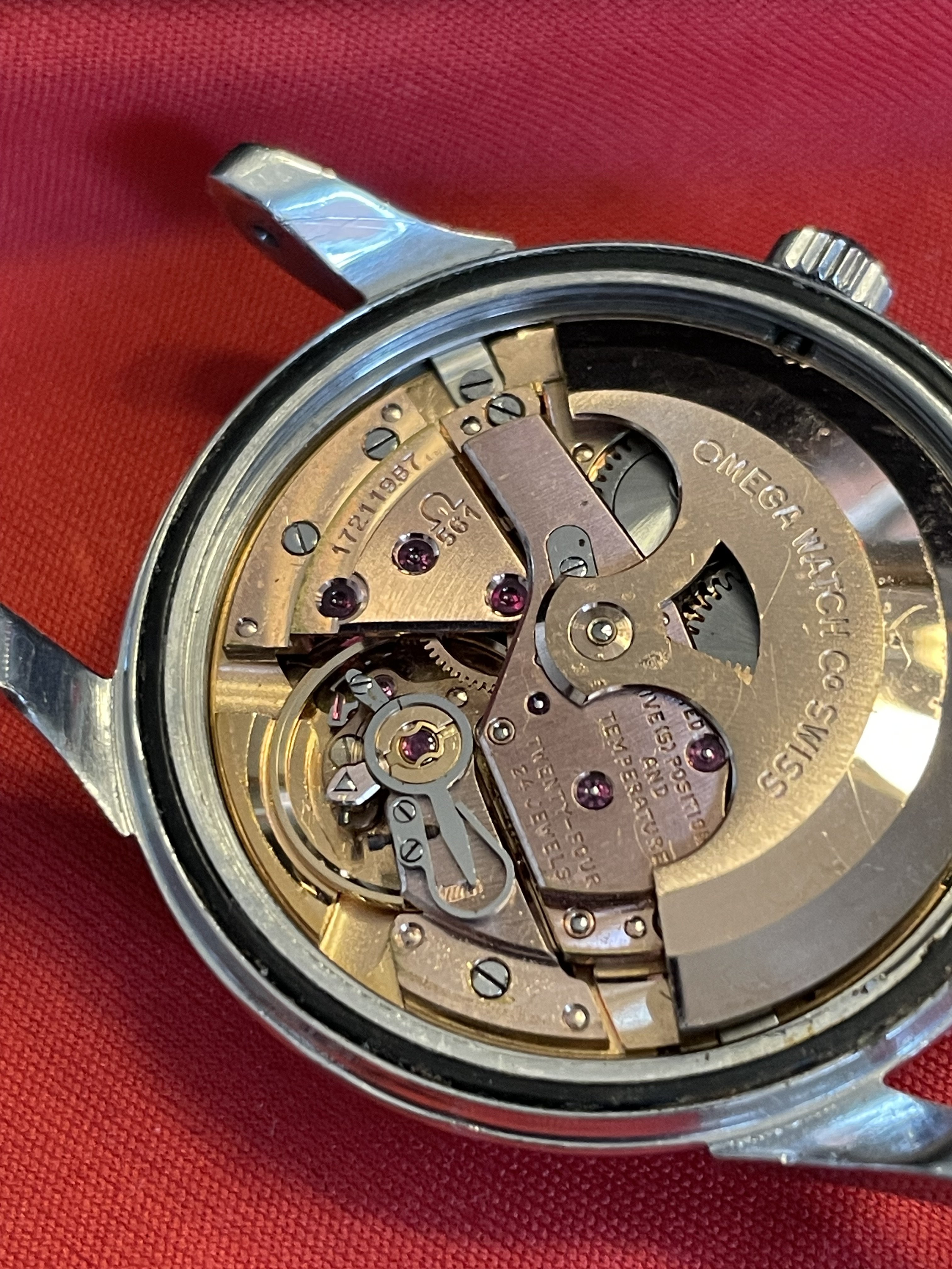

As you said, the crown is indeed not correct. The hands also seem to be relumed. The dial still has original lume on some markers.
Automatic winding framework seems to have been replaced, which was quite standard during a service.
Nice catch! I would consider changing the crown and maybe reluming the hands with a slightly more aged color.
4,856
12,282
I quite like the watch, and agree 100% with @Geezer. Finding the crown will take a little effort, and re-luming the hands should be no problem for a watchmaker. Both are worth the effort.

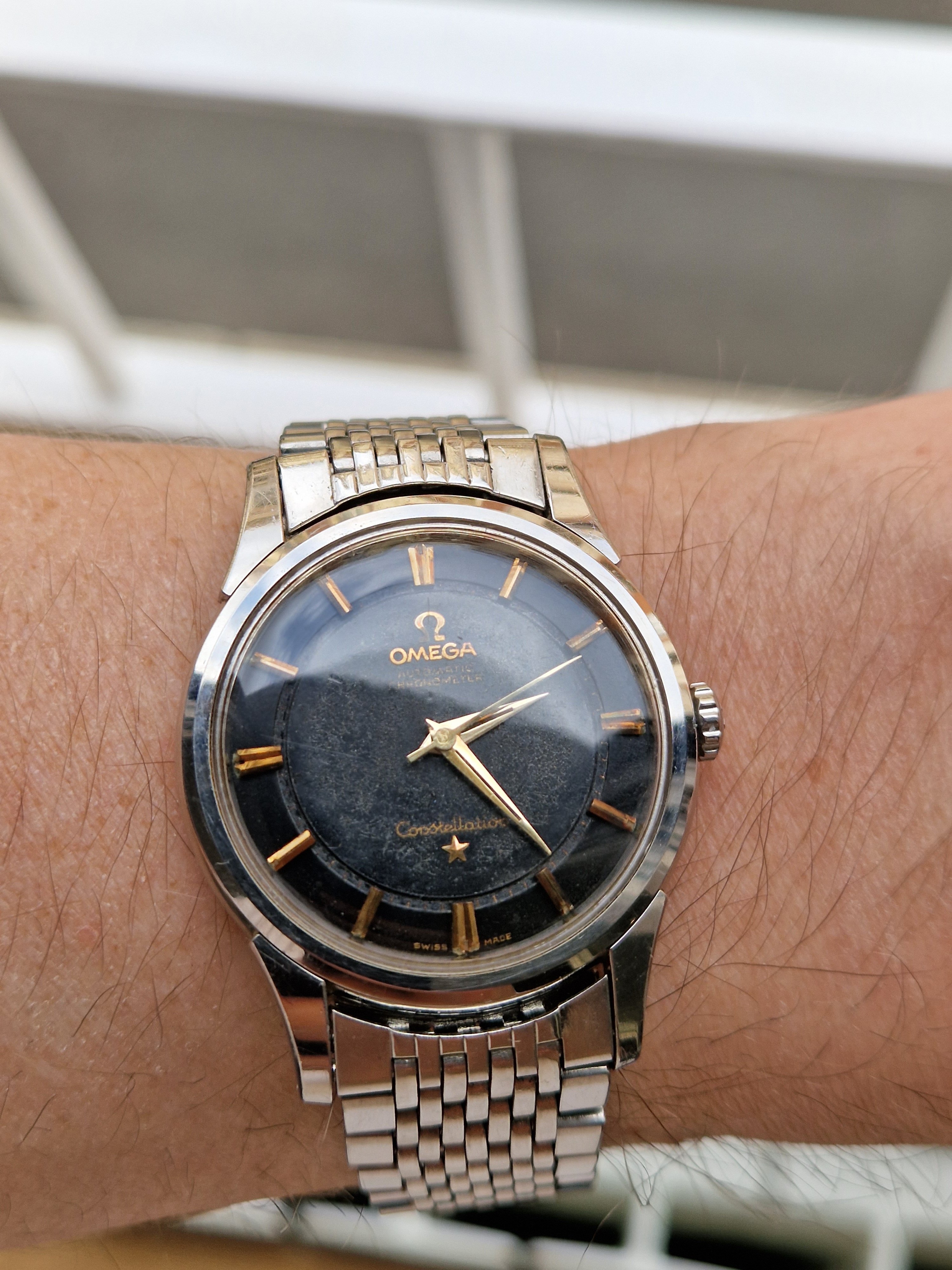

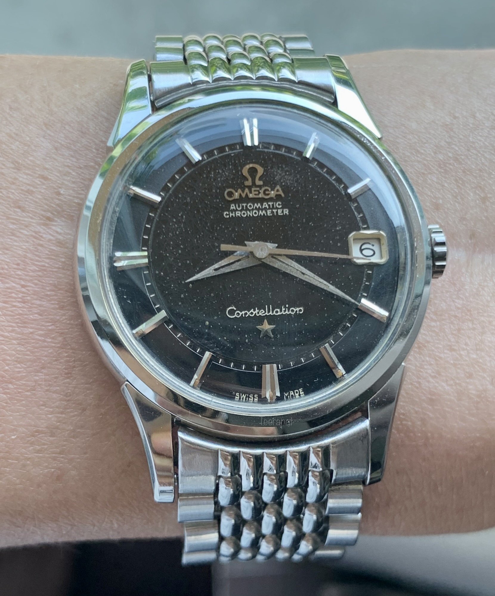

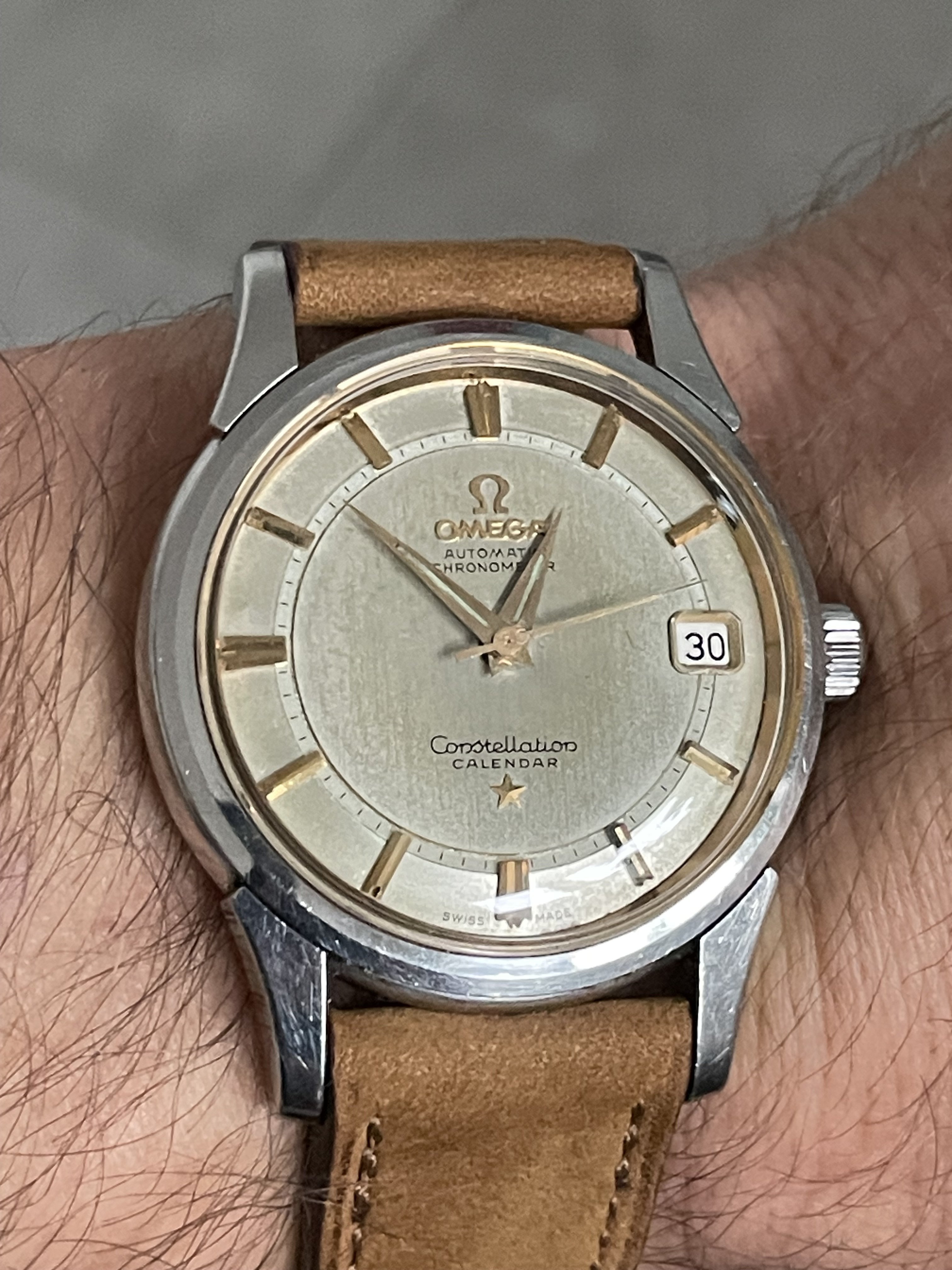

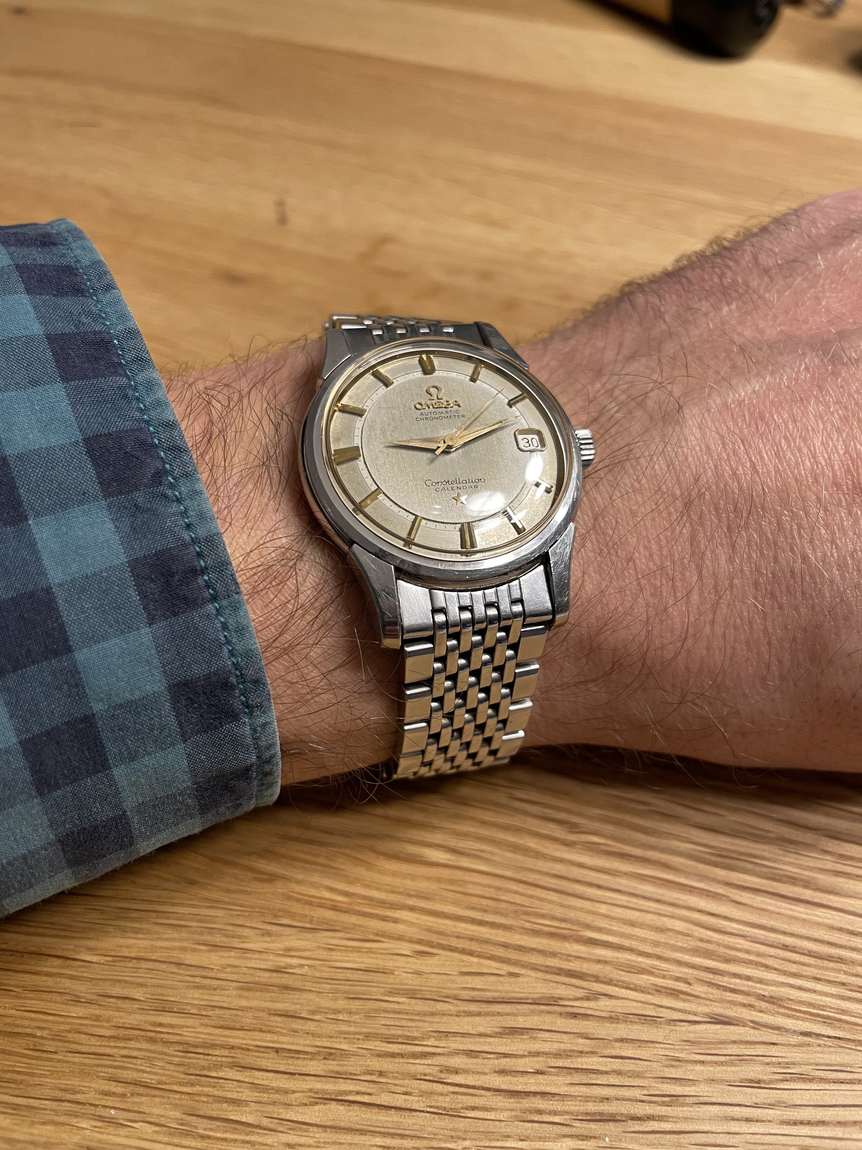

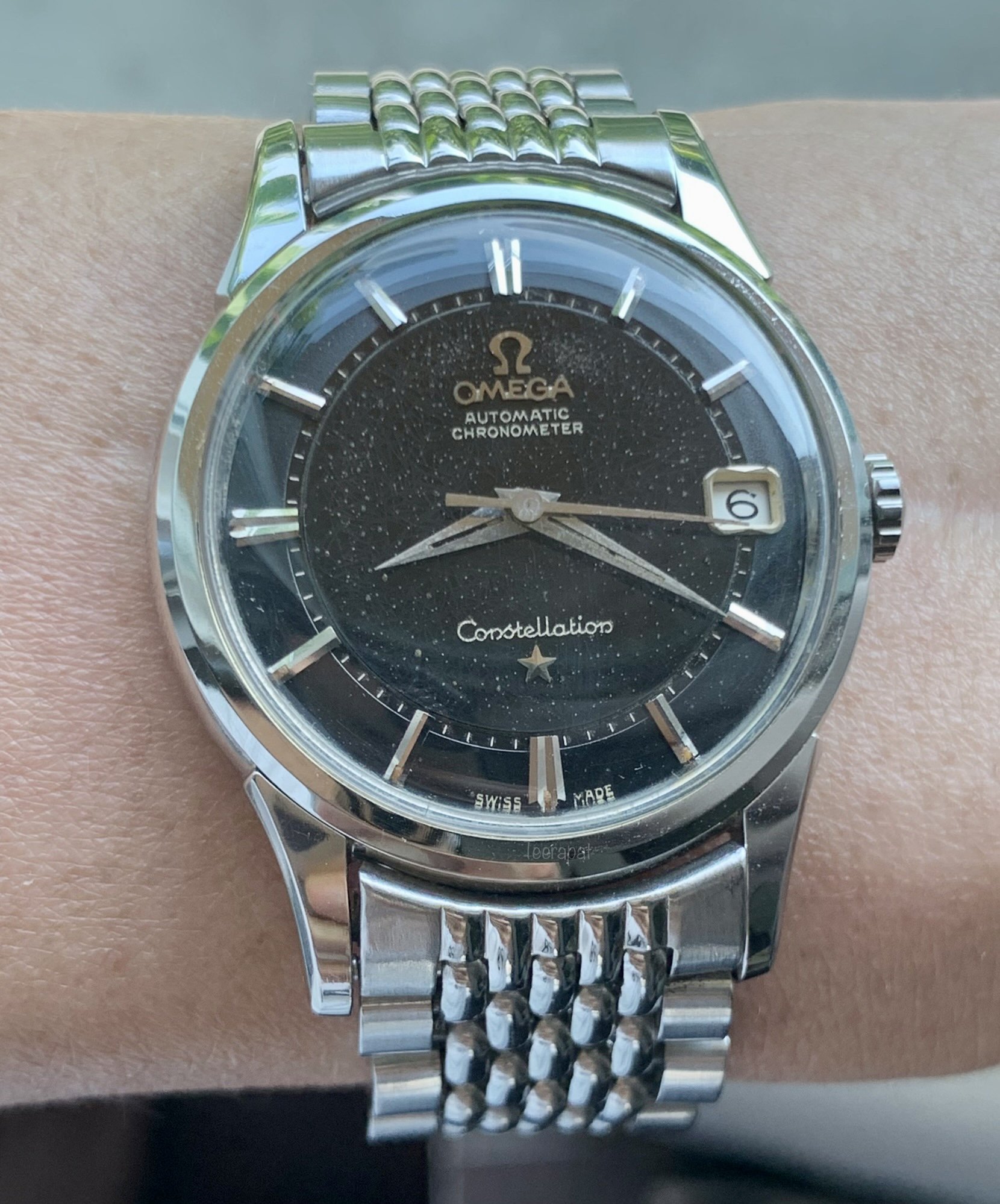

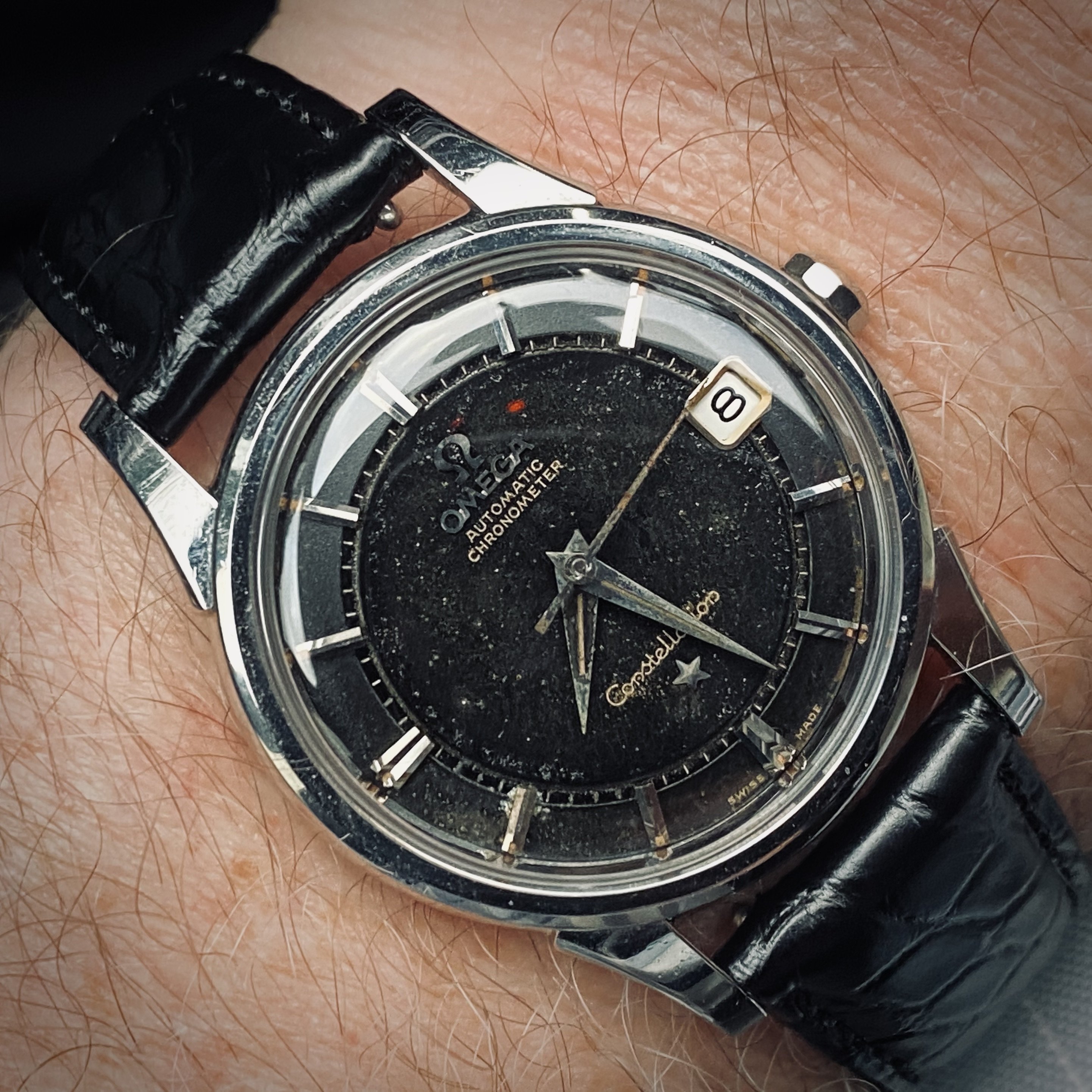

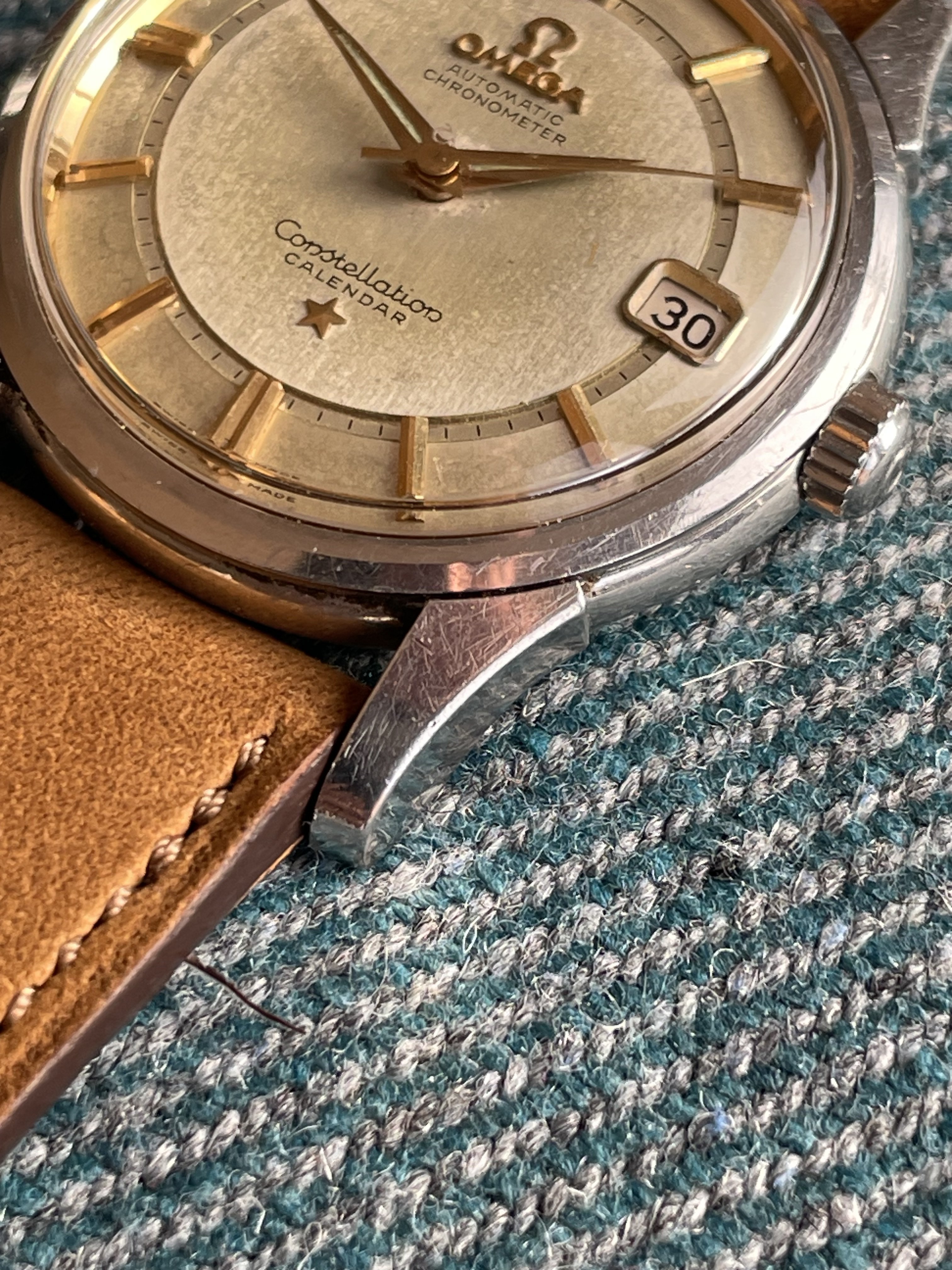

Looks good to me! Mine says hi (no date, but with correct scallow crown). An alternative would be the decagonal crown.

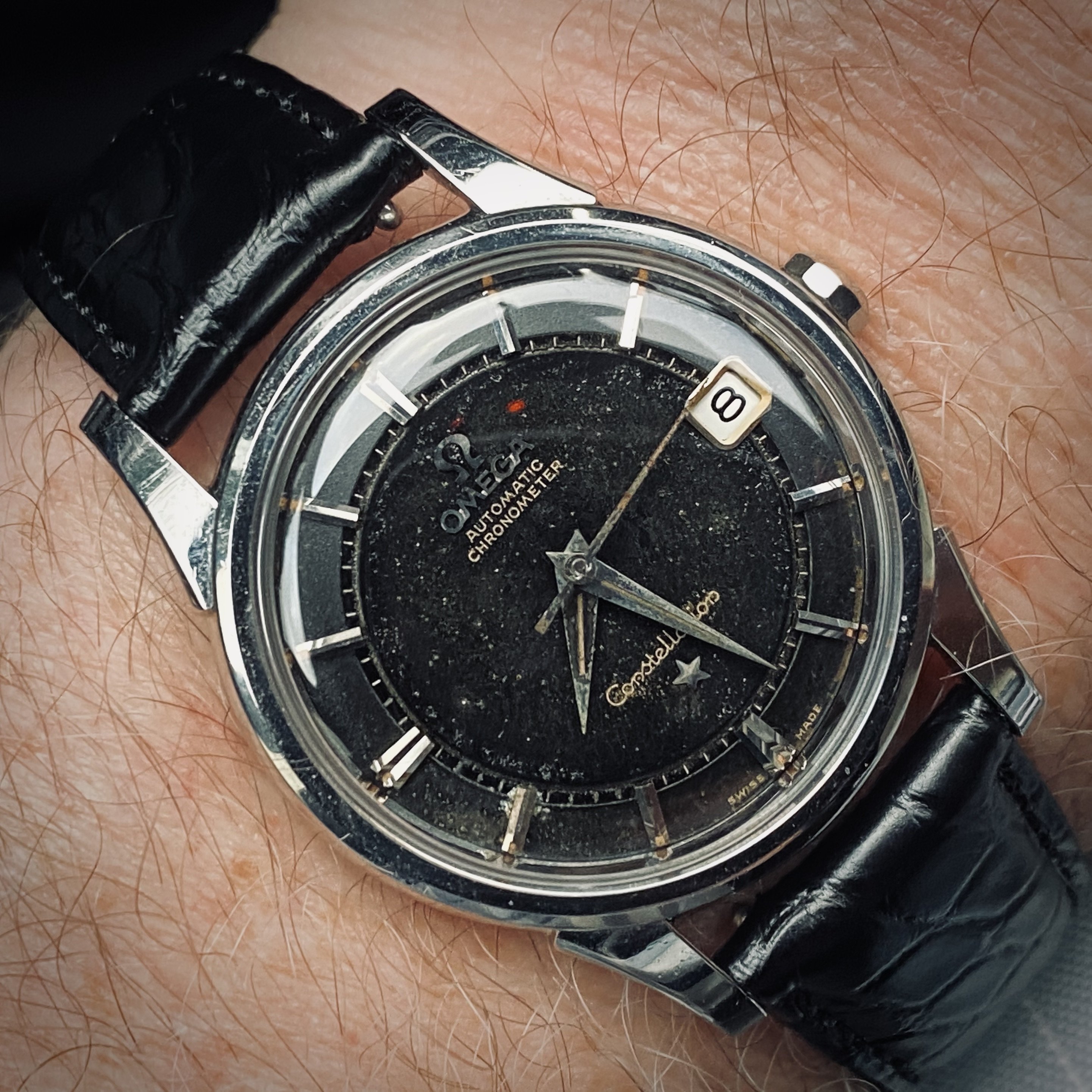

And below another one that I used to have, with the wrong crown
4,856
12,282

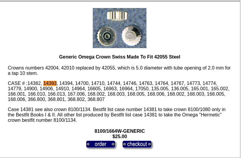

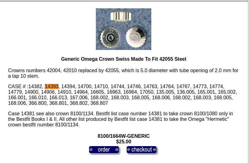

The correct dimensions for the crown can be found on Otto Frei. https://www.ofrei.com/page_147.html
If you find a vintage crown that looks right and has those dimensions, then you are good. I bought a thin scalloped crown like @Sa Calobra has on his first watch from @new_user to fit my 14710 (same size crown). I'm nor sure if he has more, but it is worth an ask.

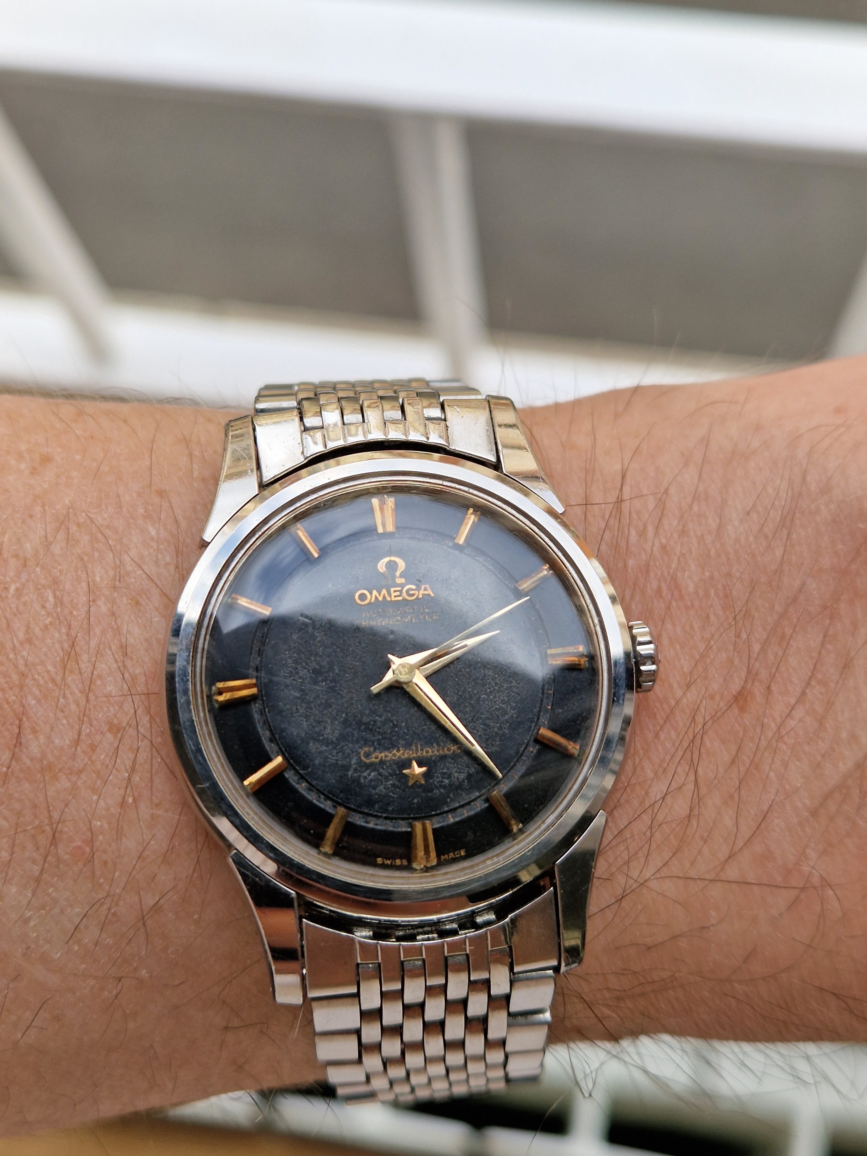

Out of curiosity - how is the model traded in steel? There are no watches for sale on ebay that correspond to this model and here in the marketplace there are mainly gold capped watches. Not because I want to sell them, but just out of interest.
Yours with a black dial are really great .

I would actually prefer the original crown
Me too, but be aware the thin scalloped crown essential nullified the handwinding feature for me. I have no problem setting the time, but to wind I find it much easier to swing the watch gently back and forth to wind it with the automatic mechanism.

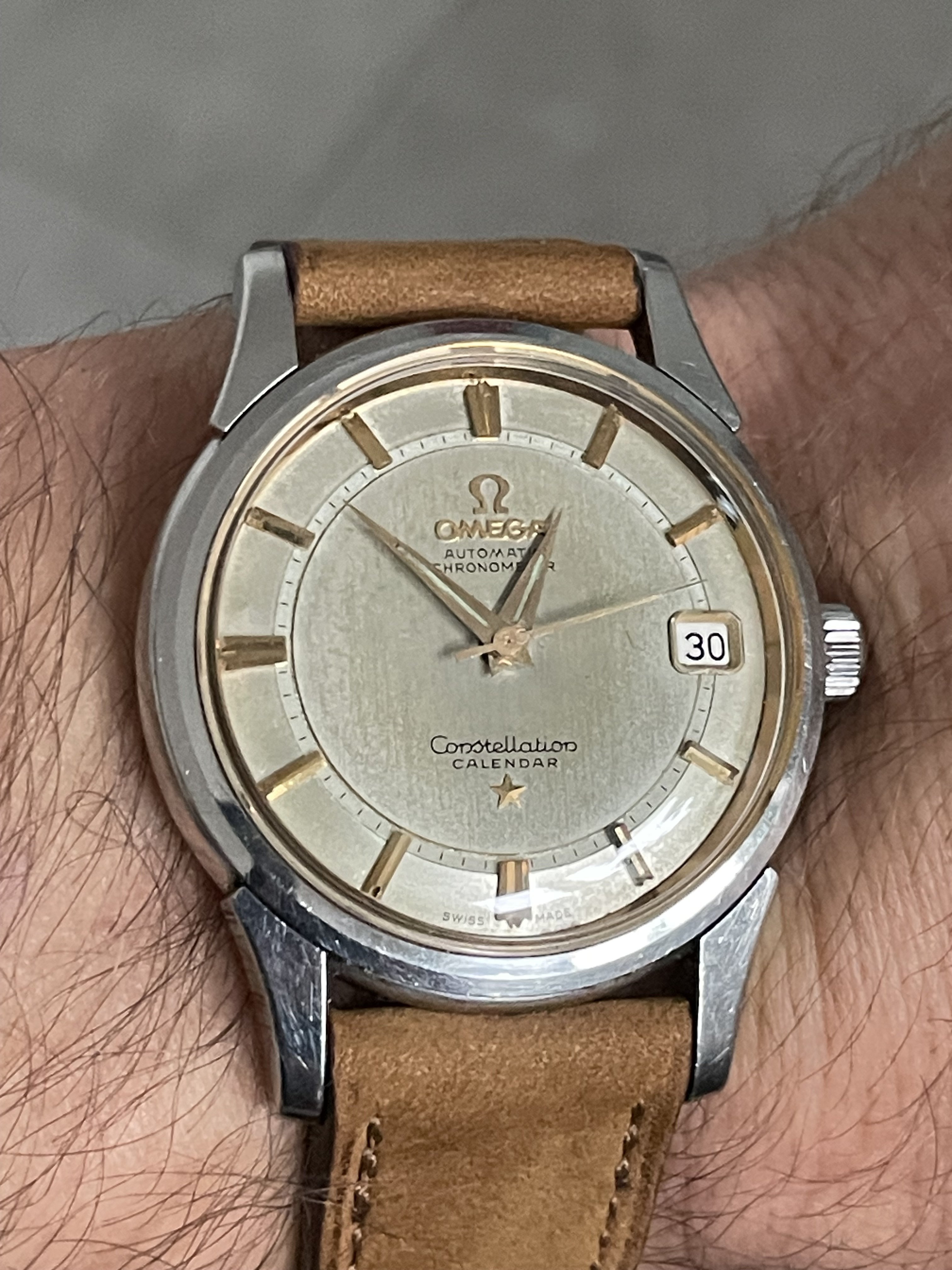

277
1,385

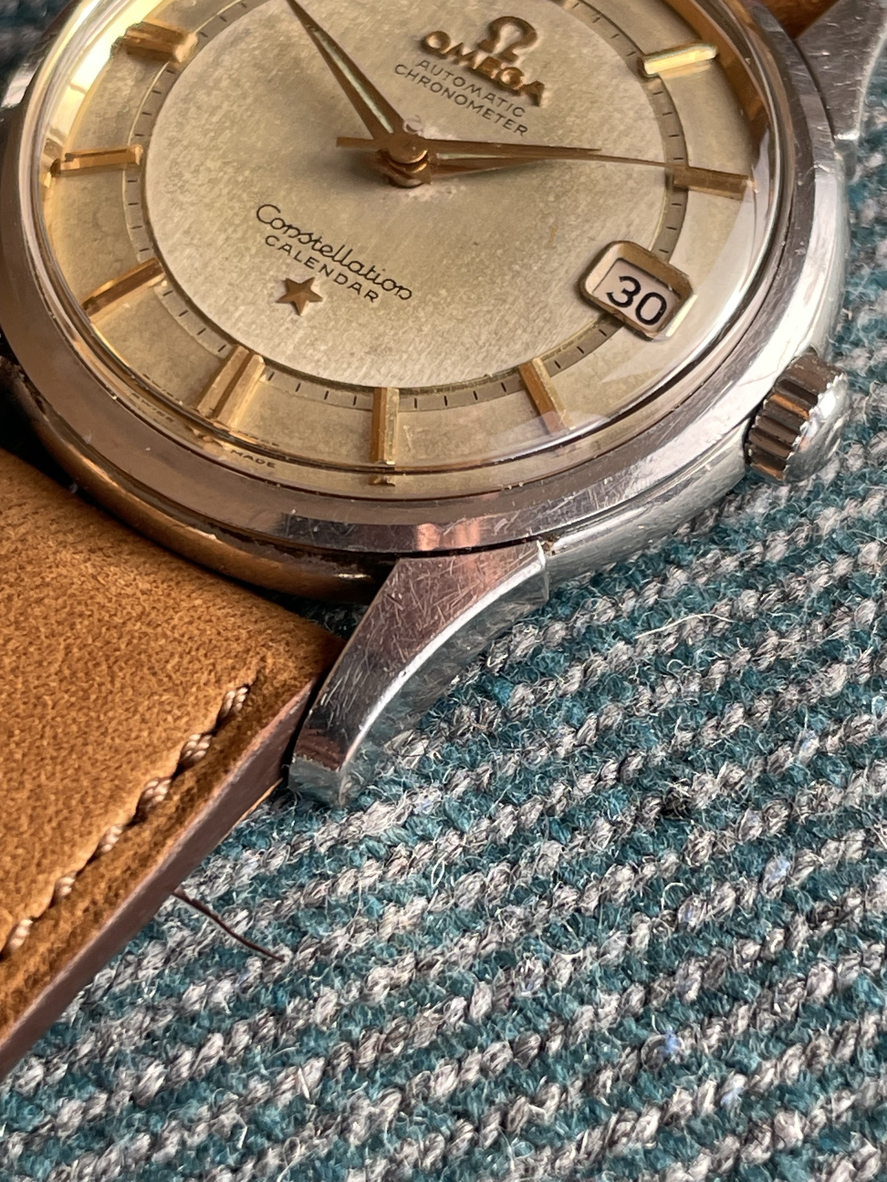

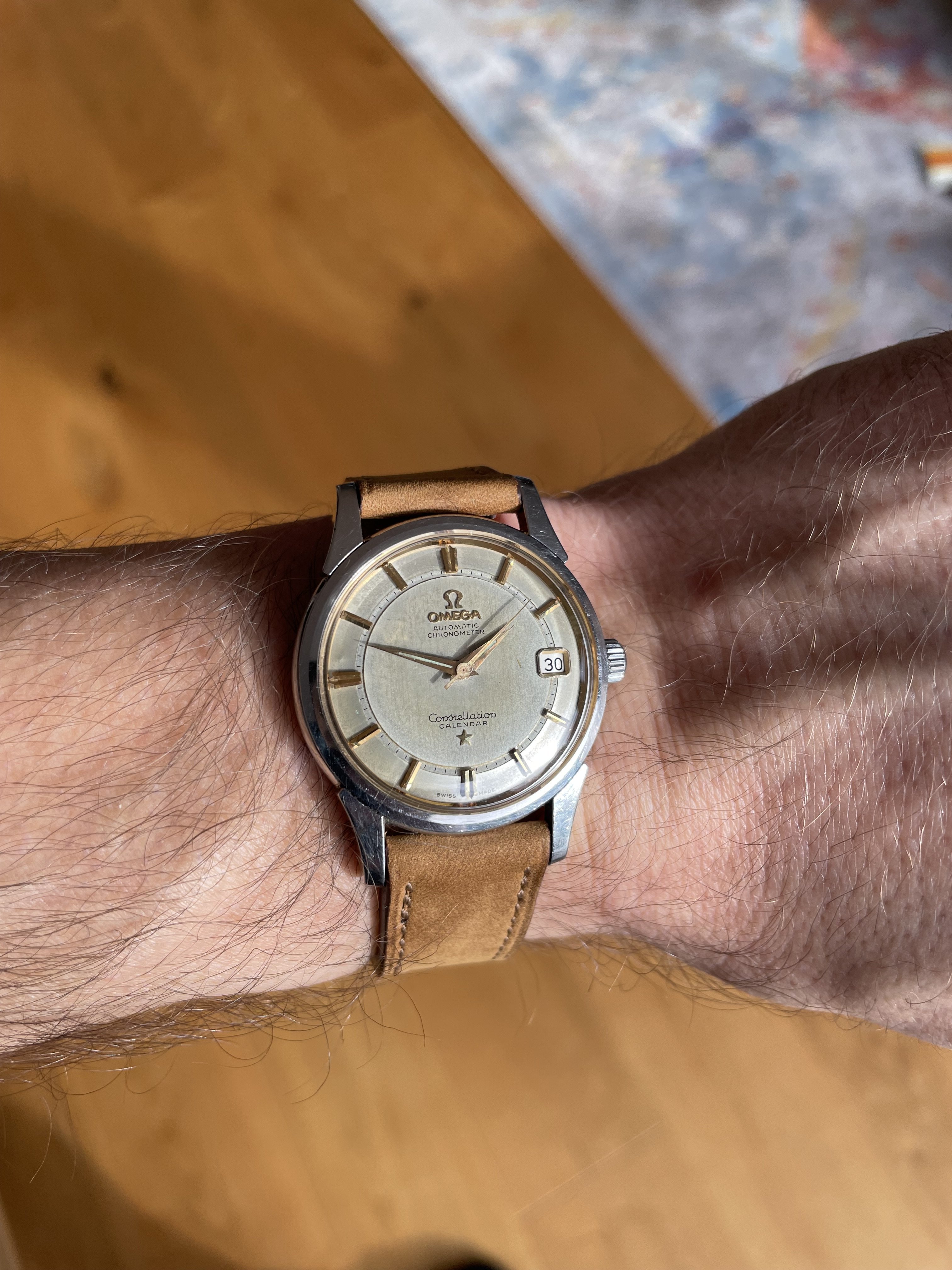

Switched to a BoR - I think it looks great on her too, although the strap also looked good 😉
13,539
23,486
Beautiful watch. One of the most attractive Connie’s imo.
901
1,241
Very nice. Congratulations! I personally have a slight preference for the leather strap here, which resonates really well with the patina!
