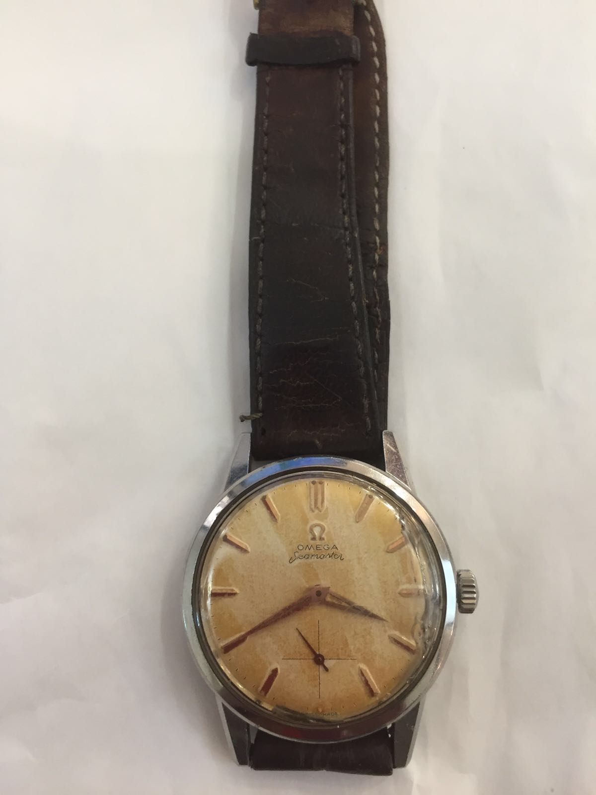

    The jewelery kindly sent me a photo. The the attached image.
  5. Tiny Iota Could potentially be the Official OF Stalker ™ Aug 18, 2016
    1,069
    3,099
    Is that patina or water damage? Looks pretty streaky.

    I don't know if the watch has ever been used. I think that the yellow color is due to a patina and not to water but I really can't be sure about it.
    I asked if they use original spare parts and they said YES. They also said me that the CERAMIC of the dial will be reworked from the original one. After your message I understand that I may have misunderstood what they wrote and they will do a sort of CLEANING of the original one. But they really wrote that the CERAMIC will be re-made.

    I'm going to call water damage. The worst is near the crown. Redialing will lower the value of the watch. What you need to balance is at what cost is a sympathetic restoration going to run vs the value of the watch to you or at resale.

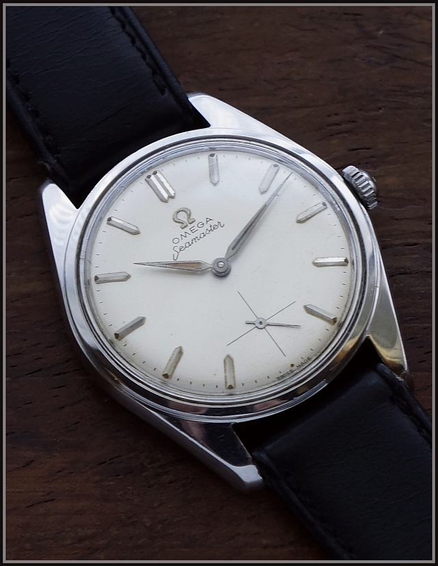

    Same dial (no ceramic:)), other reference.
