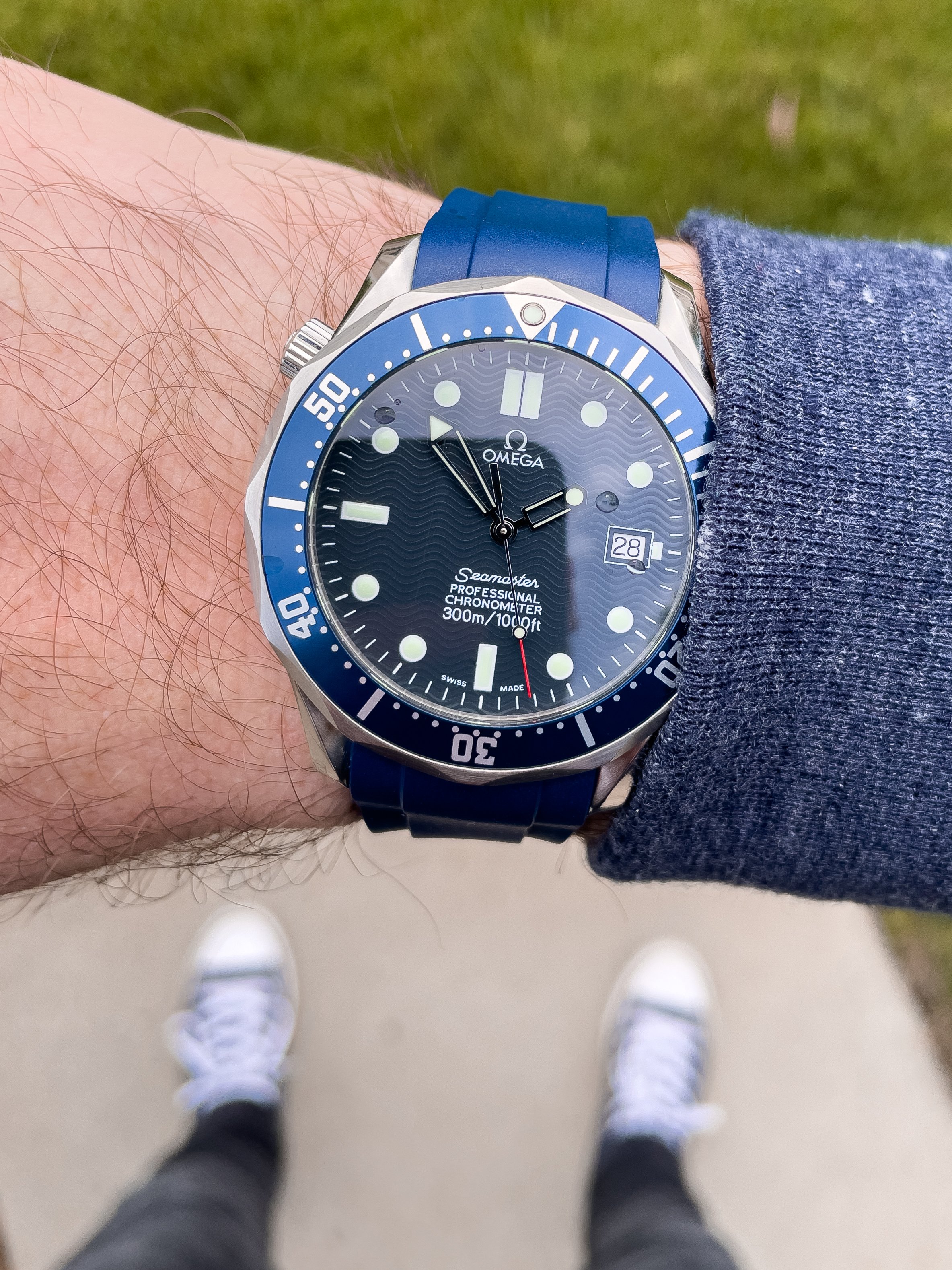

It's not often I have to demagnetize a watch, but when I do it's nearly always one of the two I have with the 1120 movement.
Anyone else have a similar experience?

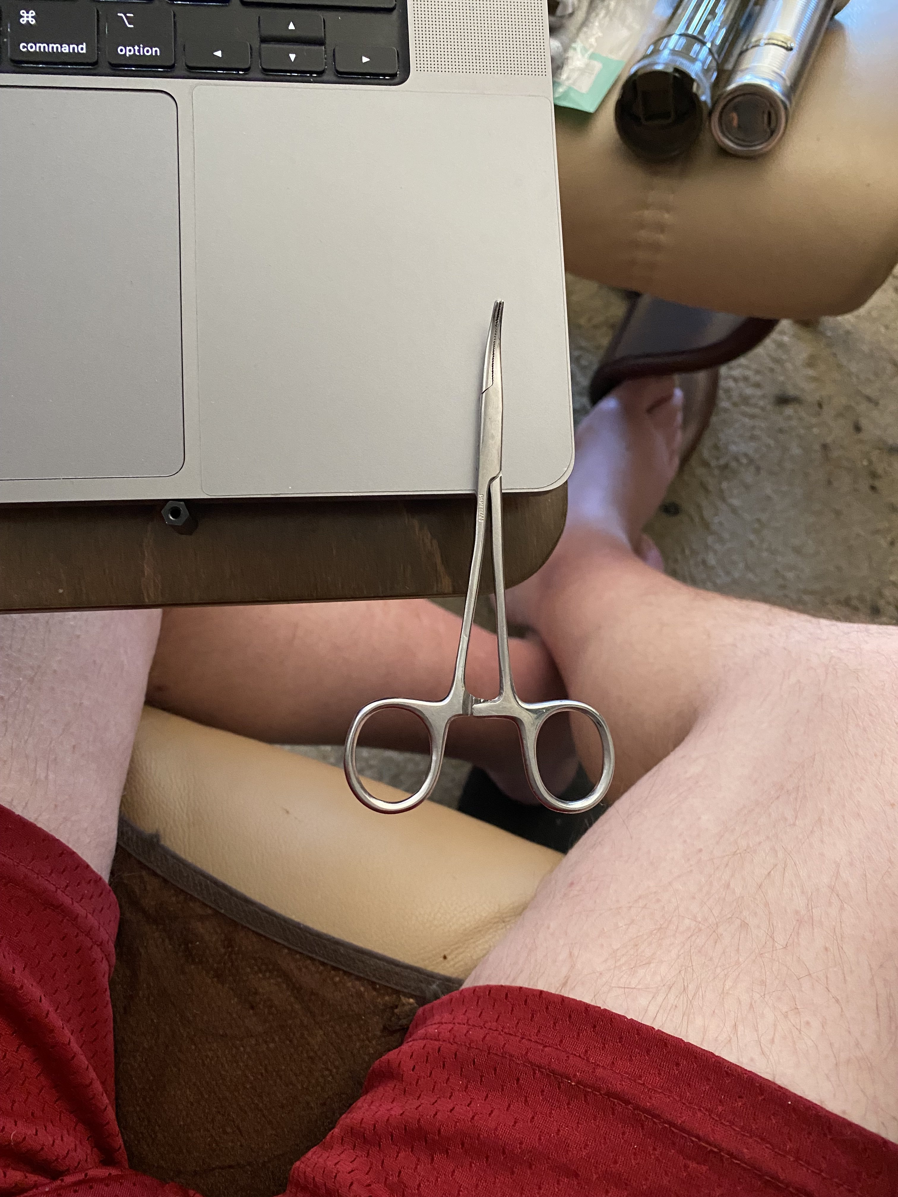

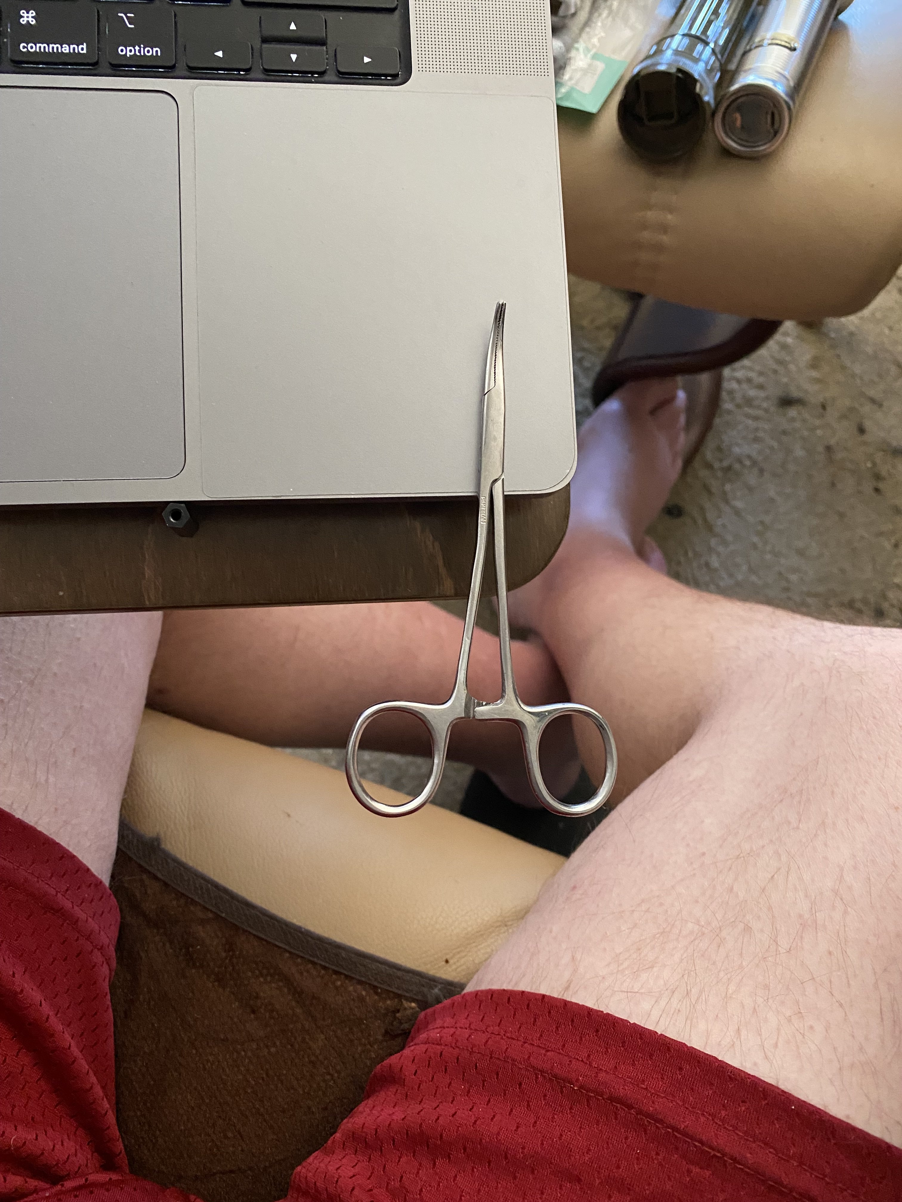

I checked and my MacBook Pro seems to have strong magnetic fields around the palm rest area. That might well be a factor.

It's one of the newer M1 models, I didn't have this issue before with the Intel MacBook Pro.

I think this magnet is pretty strong. There is one on the left side as well.

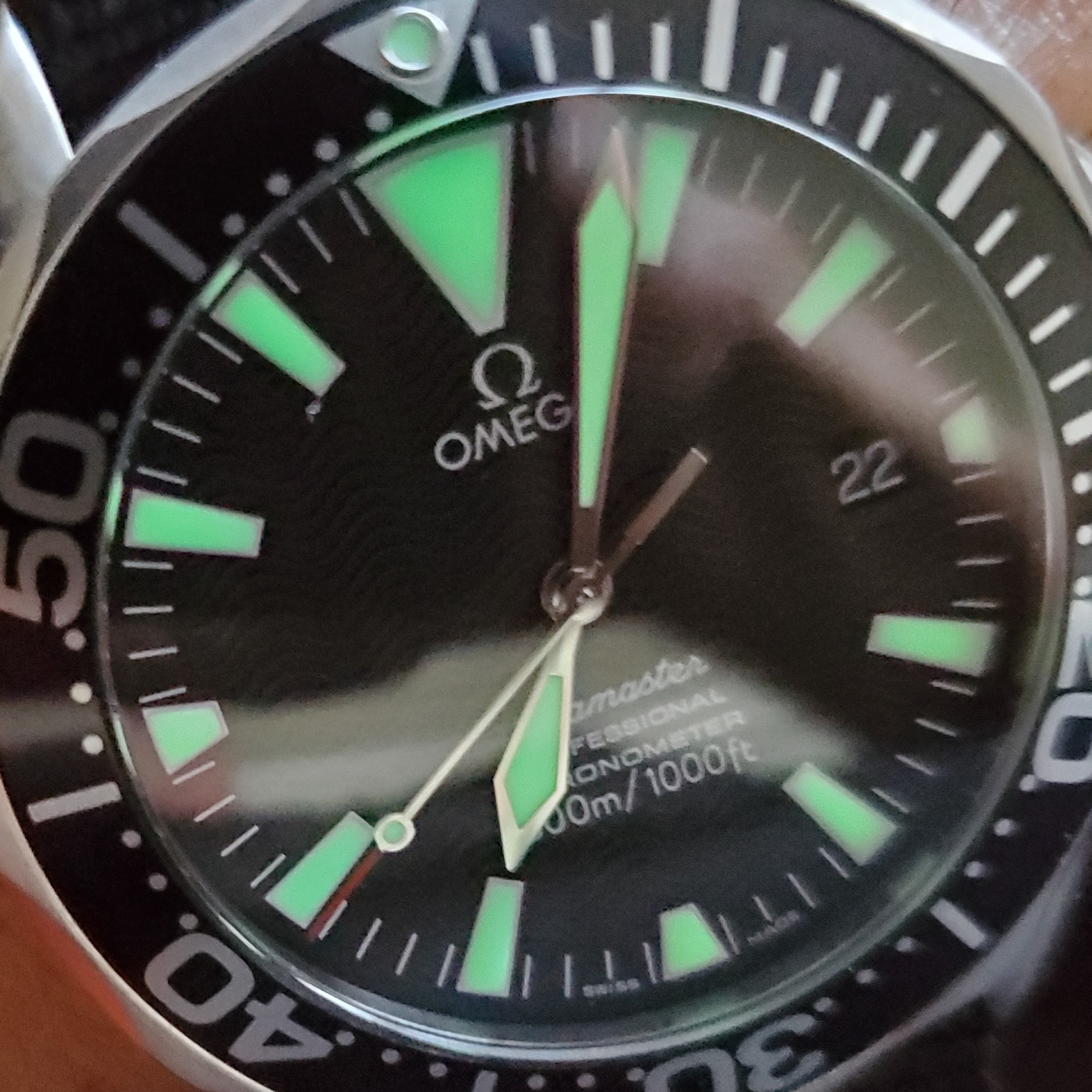

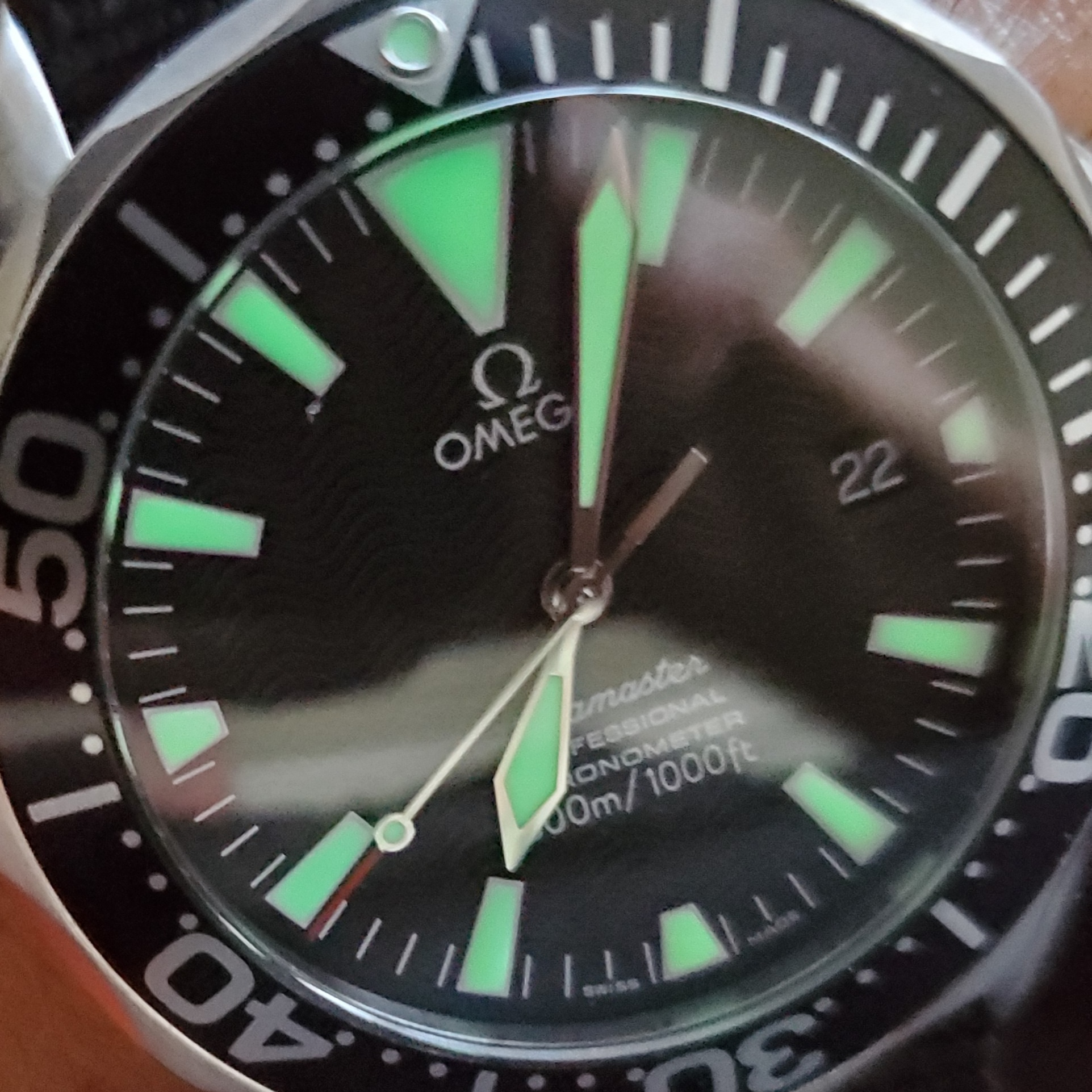

It's actually astonishing to me that, out of all of my watches from 1917 to 2020 manufacture, the only ones with an actual issue are the 1120 movement pieces. That includes a dozen Omega and ten-ish not-Omega.

This one has a antimagnetic cage, too? Looks to be a really strong magnet. Why does the M1 have a magnet there?

It lets the device know when the lid opens and also holds it closed.
