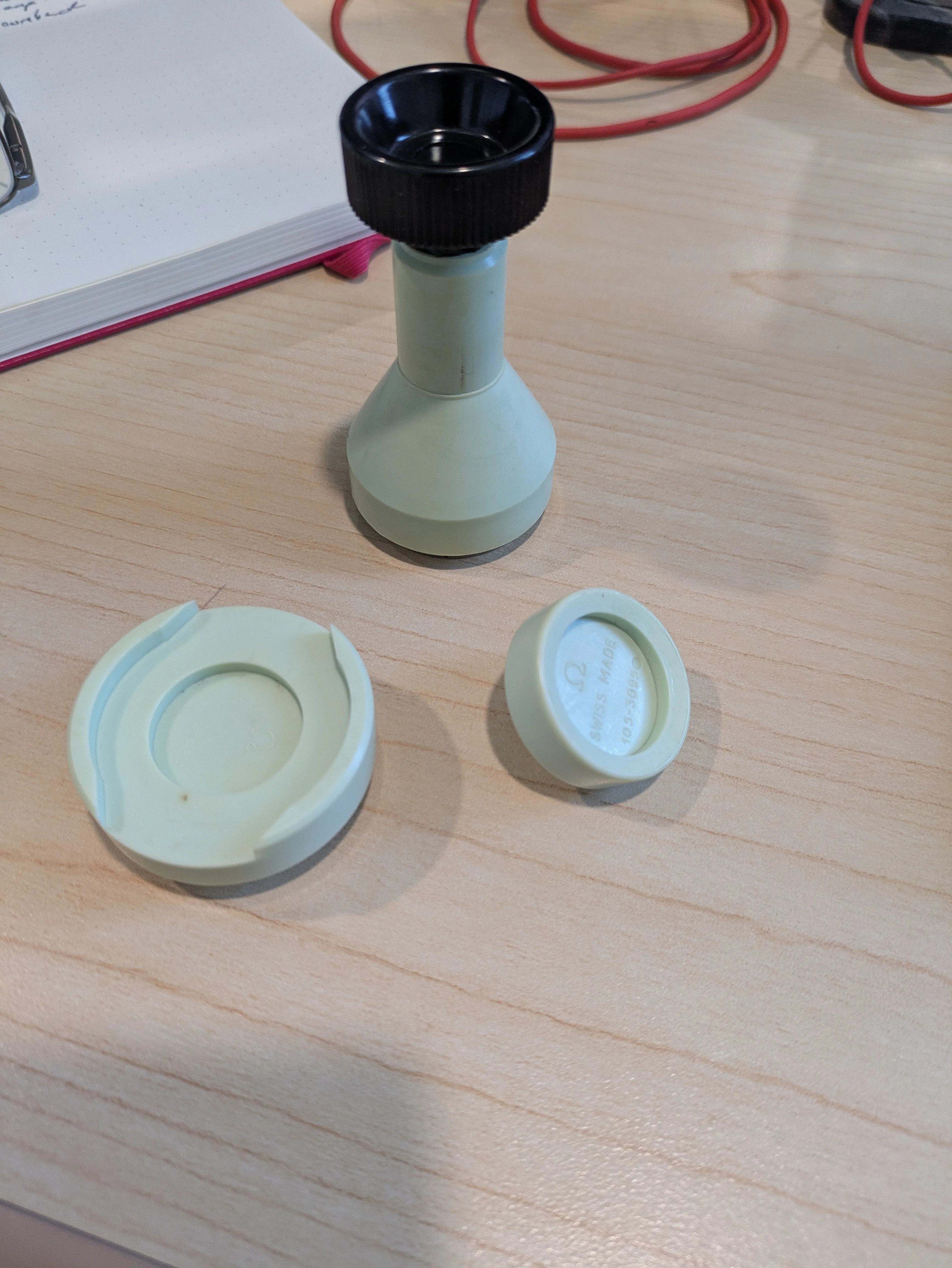

I have an Omega that requires a 105 tool for crystal removal, so I found one on ebay. I figured I could use a cheap crystal squeezer, but this seemed like a good reason to get the 'official' one.
HOWEVER, it came with 2 accessories, both with the 105 marking on it, that aren't clear what they are for? They seem to go into a separate device, and neither fits my watch it seems. Thoughts?

This style is used on the smaller dress and ladies watches. So I think the adapters are for handling these variations.

As far as the tool... it isn't clear to me how those things would be put anywhere. It almost seems like there is some sort of 'base' that I'm missing that those are supposed to 'click' into.

The bigger one is for placing the movement in when the crystal needs to be pressed in again. The smaller one is for the crystal to be pushed back onto the case. At least, that is what I think.
Yes that鈥檚 correct.

Yes that鈥檚 correct.
Ah,thanks for the confirmation! I'm guessing I'm missing whatever 'holder' they are expected to go into then.
