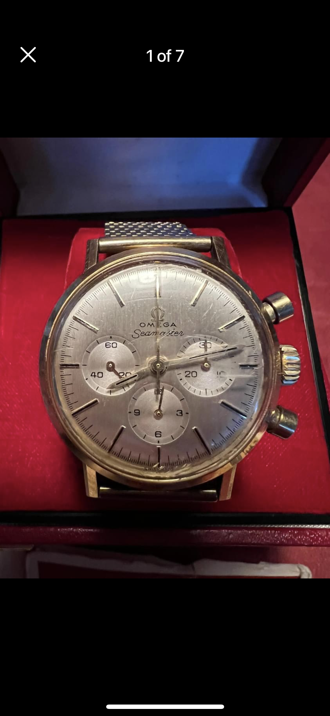

I am looking at this Omega 105.005. 18c Gold
Owner says it not currently running. Asking price is 3000 euros. So is this worth pursuing or what do you guys think?

There's no tachymetre track. Might be other problems, but that stands out to me.

Printing just looks a tad "off" to me, but I am by no means an expert. More experienced people will chime in soon I'm sure.

Yes I noticed that too. I did a little research and maybe there were some produced without the tachymetre, perhaps making it more rare?
It’s an elderly man who bought it from new in 1974 and still has receipt etc.

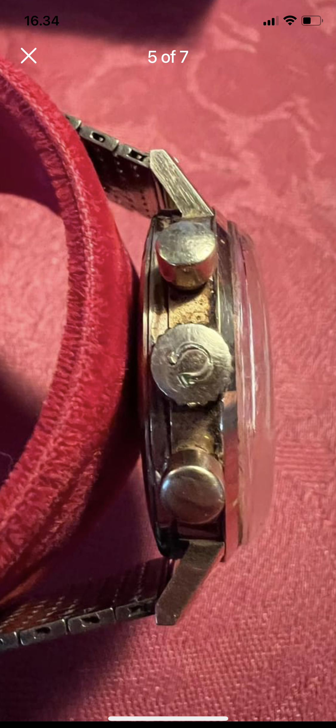

Dial aside, it looks like there is a lot of 'gunk' around the pushers / crown, probably never cleaned / serviced since 1974, I would ask for movement pictures, could be simply dirty or worse, rusty. It could cost a lot to get running.
Yes that is what I am thinking as well. I am going to inspect it and hopefully open it up and see the movement.

It could be a lovely watch cleaned up, I think the dial looks ok, caveat though, I'm not an expert.

What about the Seamaster e’s?
Good spot, they do look off, as do the subdials. As I said, I'm no expert but there does appear to be potential issues.

I think the dial is a repaint. Neither “OMEGA” nor “Seamaster” look correct to me and the subdials look like somebody touched up all the numbers.

So if the dial is repainted and the watch not running. Is 3000 euros a good price?

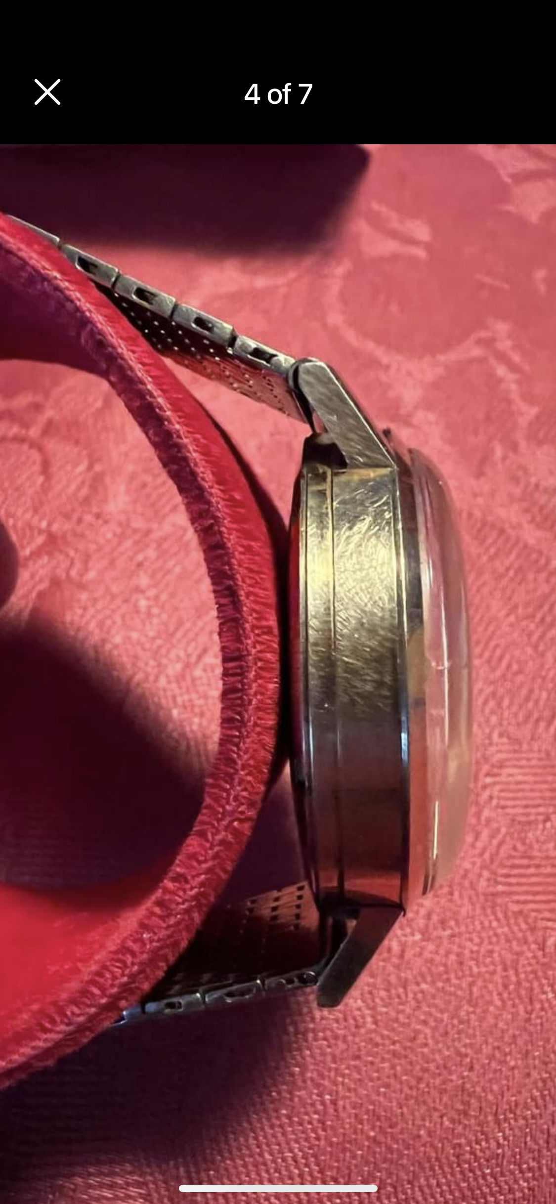

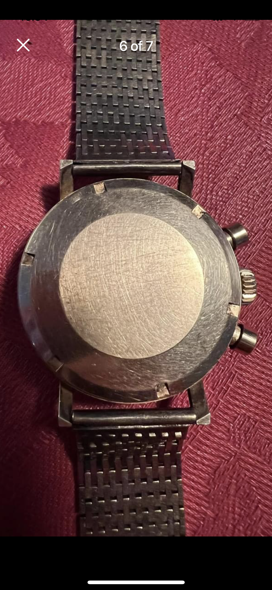

The dial is certainly refinished - notable tells are the wrong AML, incorrect serifs and thick print in Omega, the S in Seamaster, as well as rest of the print. Subdial numerals are also fat and not overlapping on the sloping recess. The vertical grain on dial is overdone and the spacing between the minute track and the case is too wide. Hands are also after market, thick and not elegant. Crown seems replacement and I'm inclined to think the caseback may be steel - which would imply not a solid 18K model, rather a GP/GF one. Tread carefully as this is a plentiful reference amongst the 321 non-Speedy chronos. Best if you inspect in person before parting with money.

There are more fish in the sea, why does it have to be this one with so many compromises? Mind you, parts for 321s can run a pretty penny.

It was just if it was a good deal and it is close to me and with original box and recept warranty
