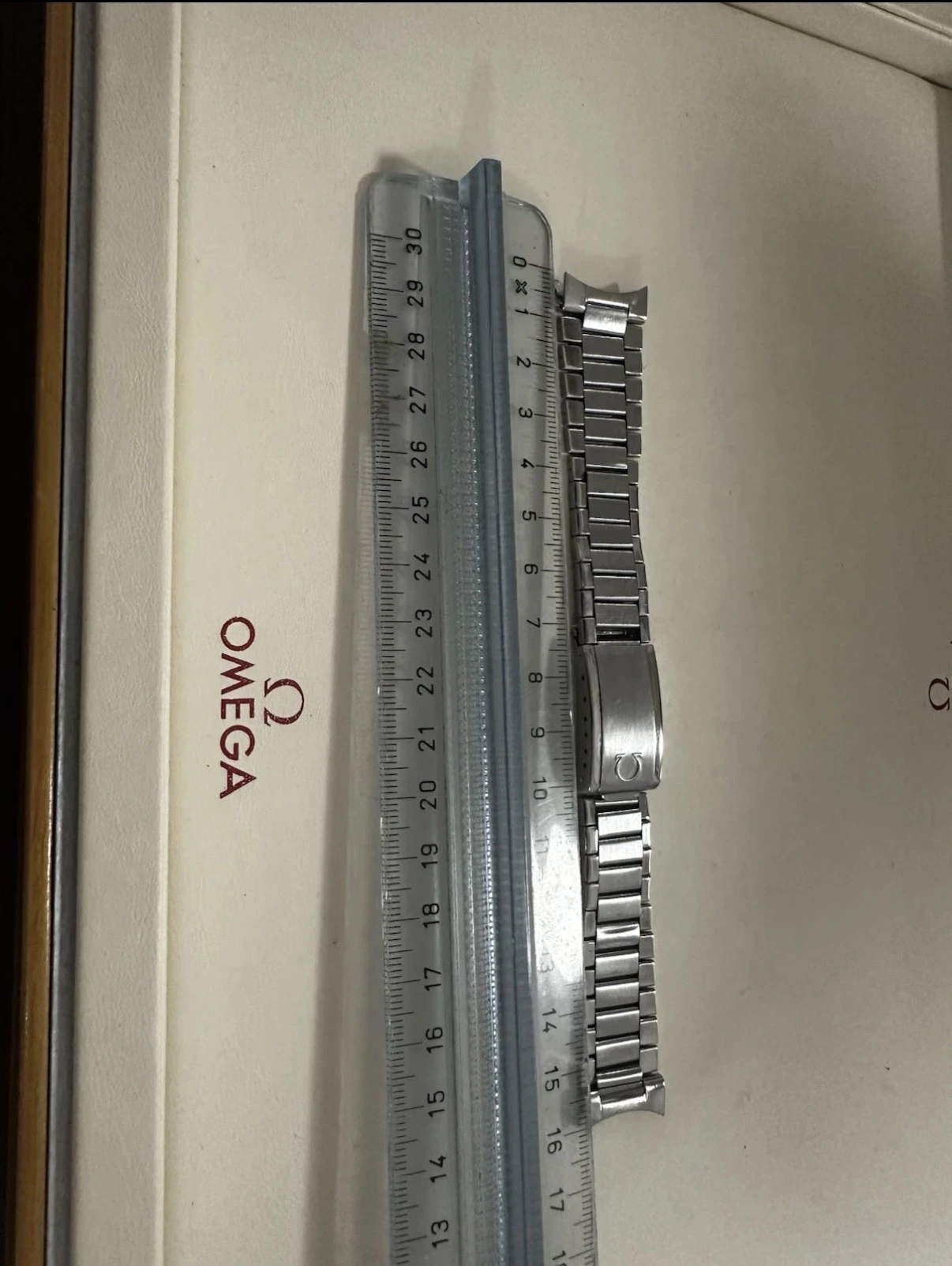

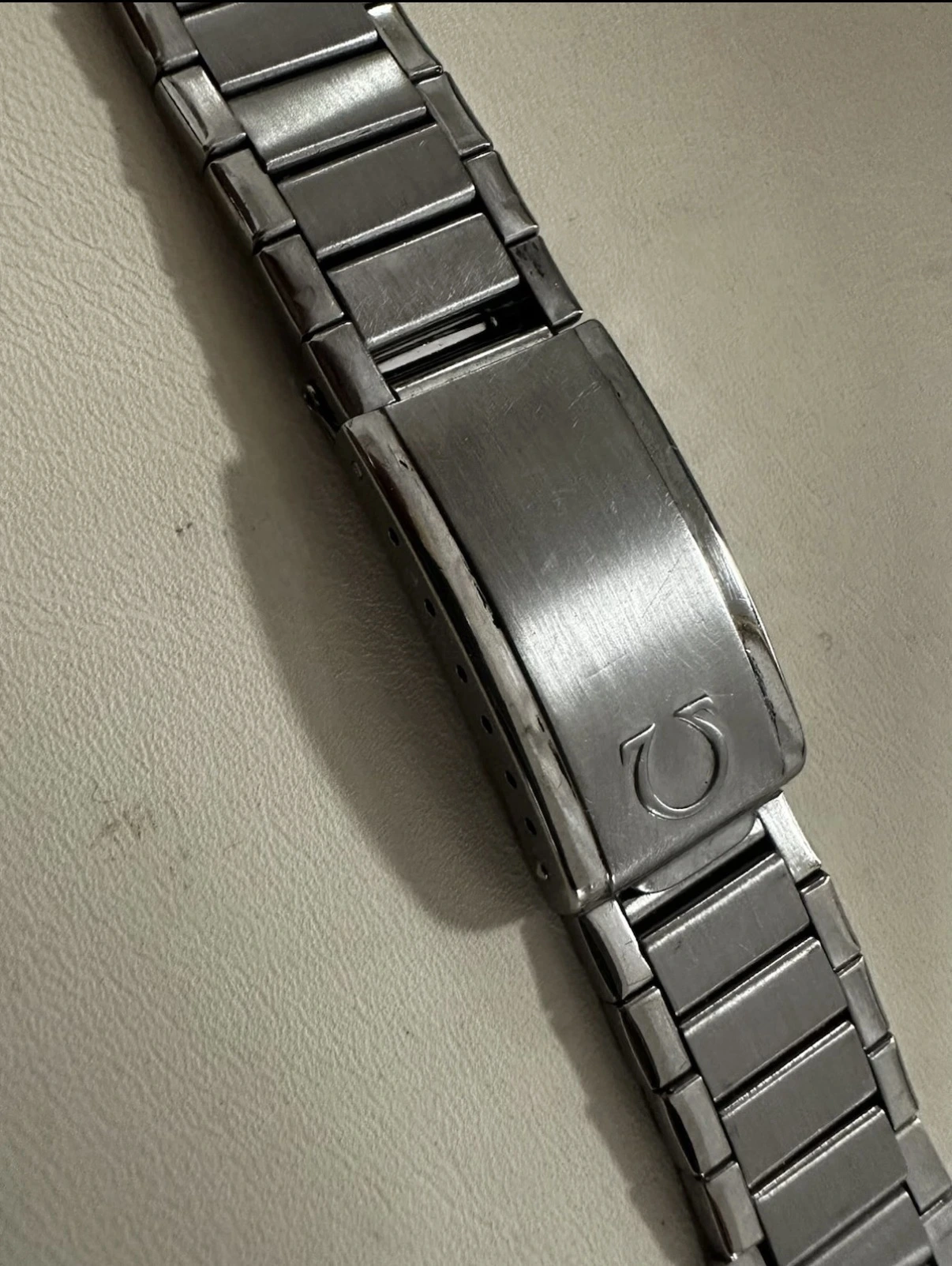

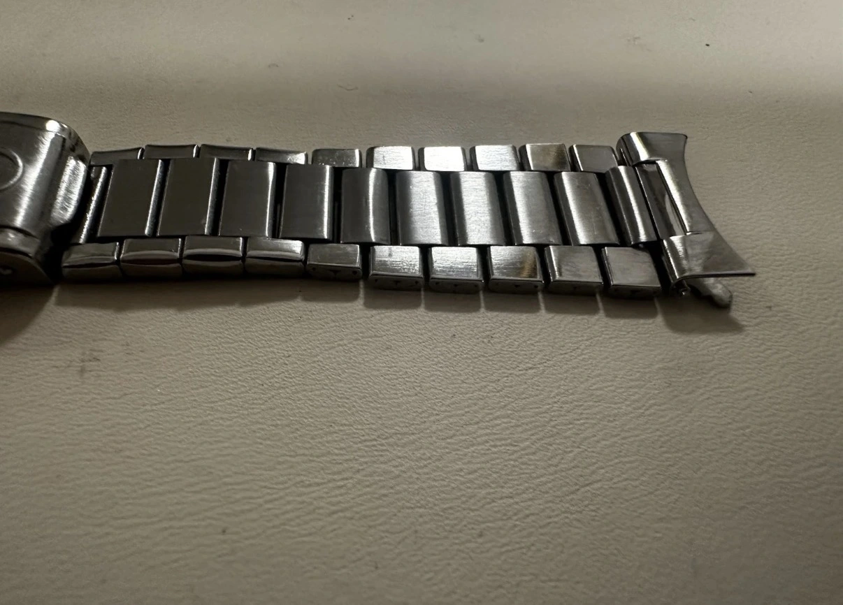

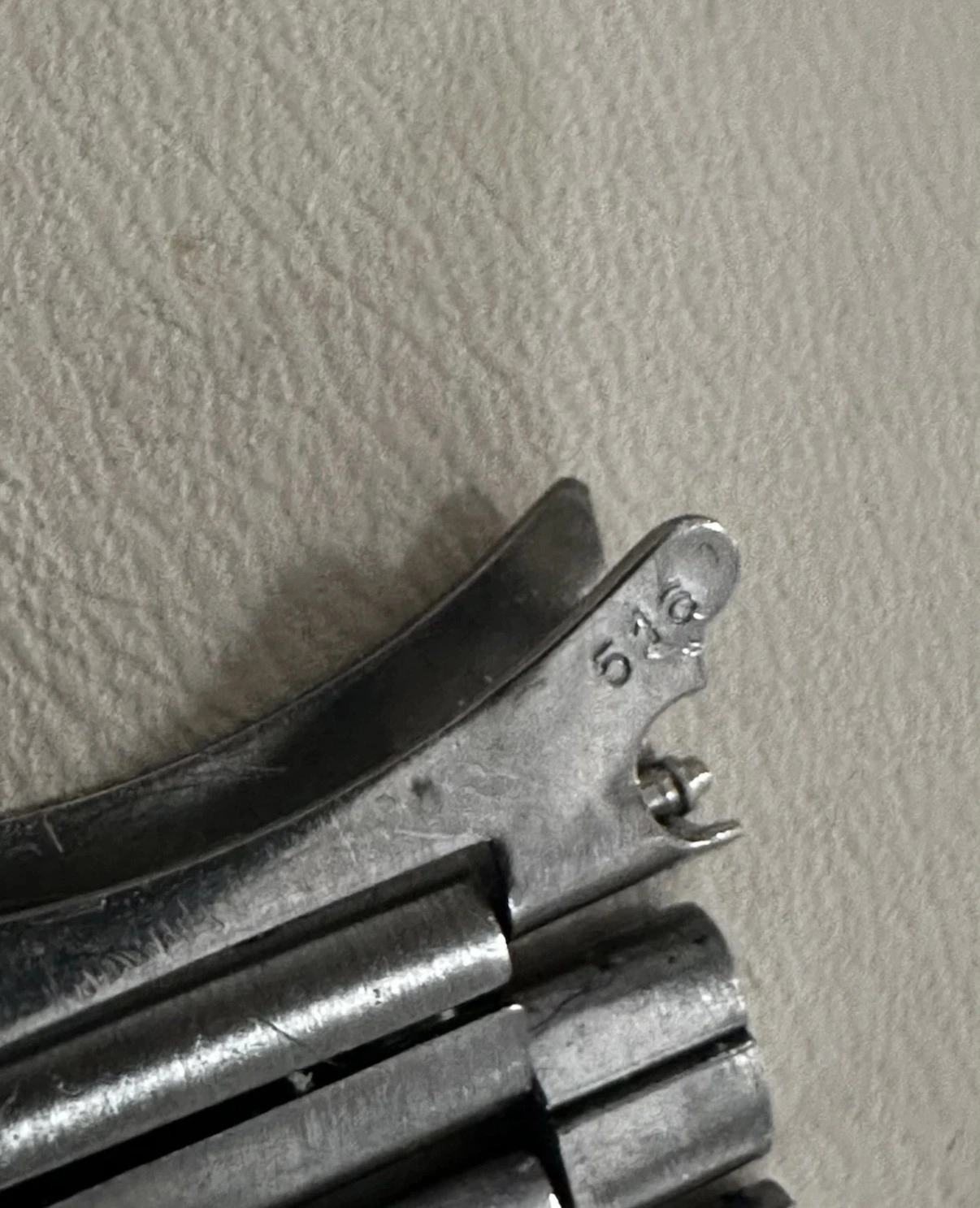

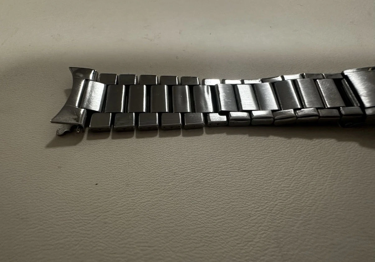

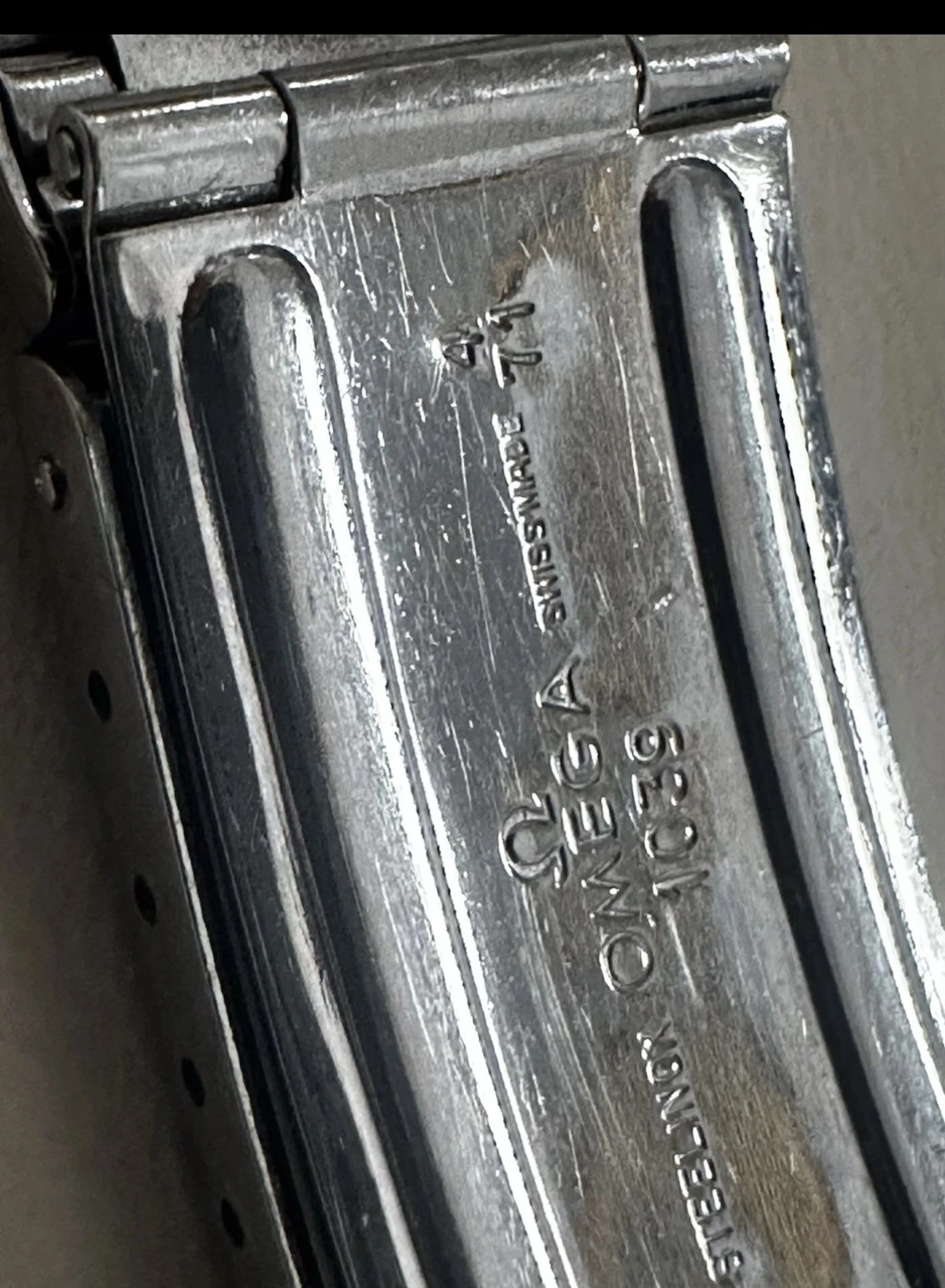

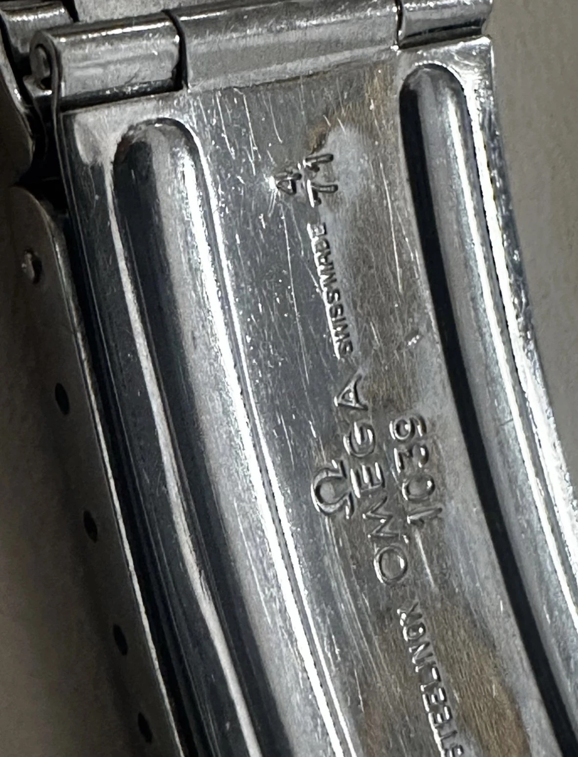

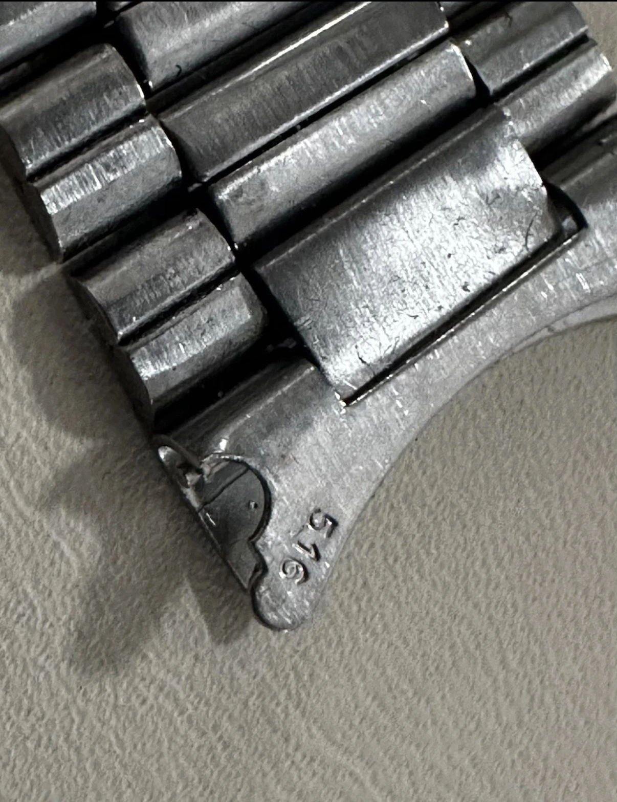

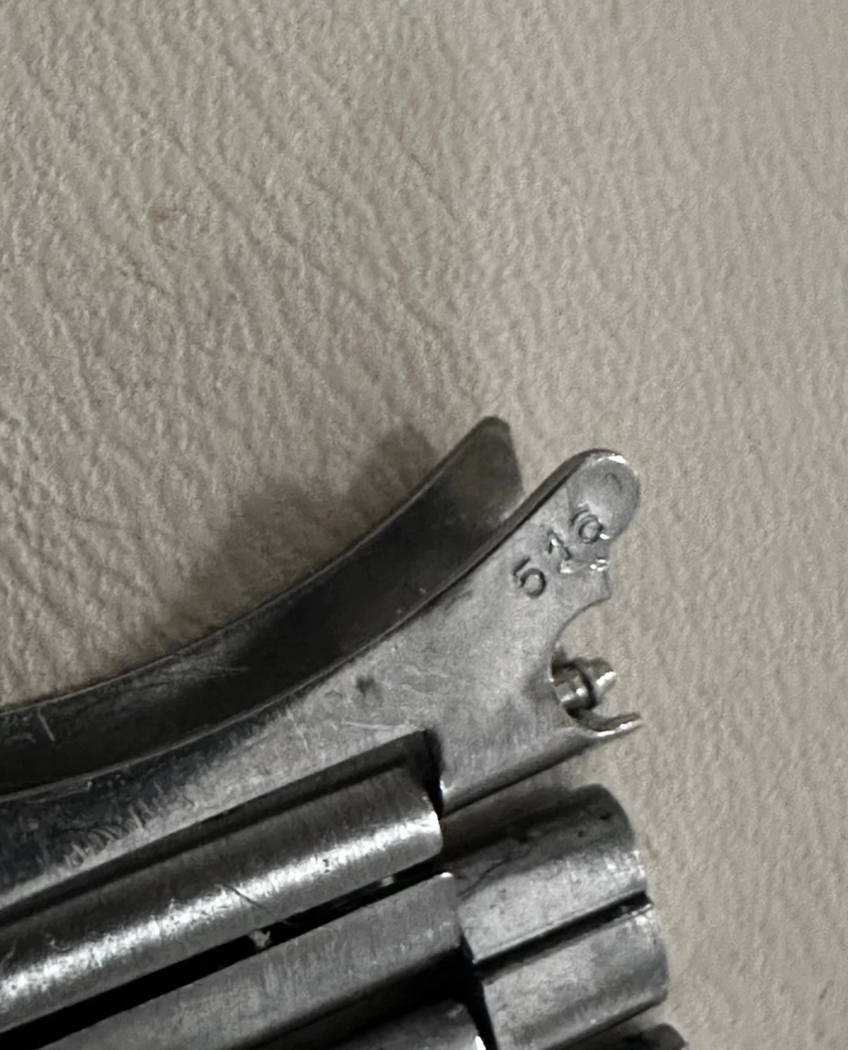

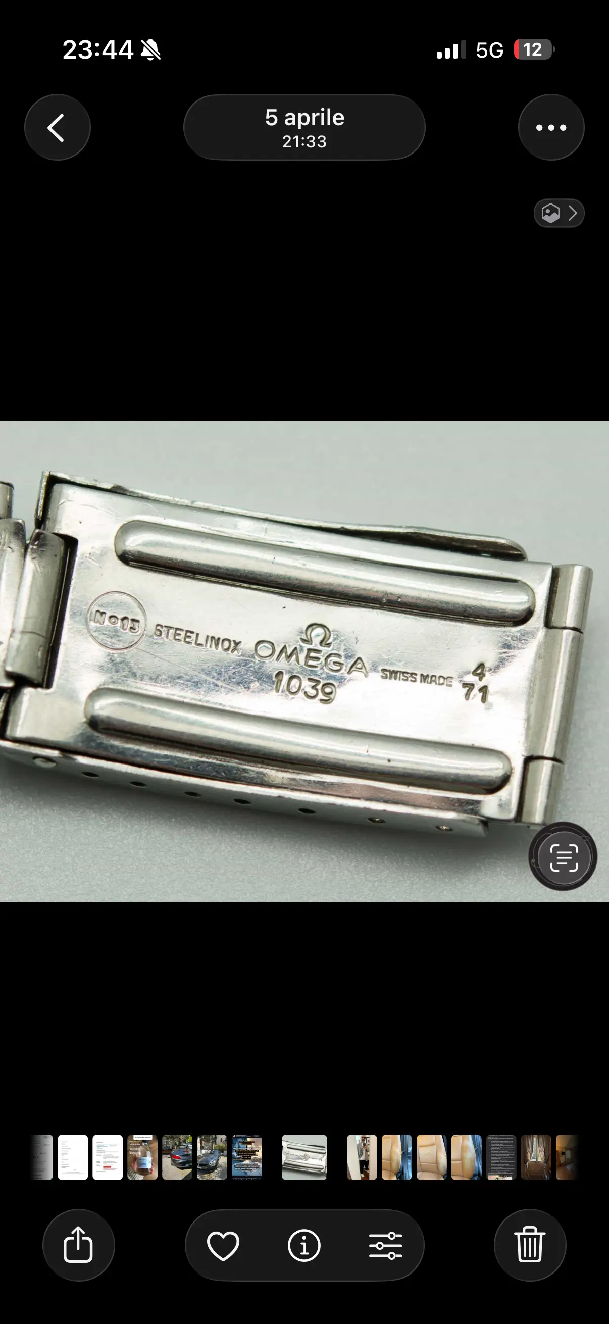

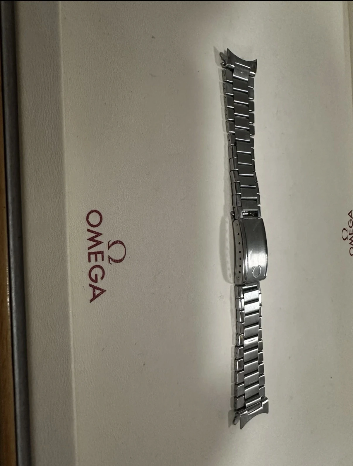

Hello everyone. I’m not that expert on Omega bracelets so here to ask you your opinion about this one I found. It looks good to my eyes but I wanna be sure before proceeding in purchasing it. What do you think? Thank you very much!
G.
1,480
6,491
The good: it's legit.
The bad: it's missing a few fixed links (there should be 8 on each side), which leads to the taper of it being a bit stepped. And it's shorter, of course. Sourcing these can be a pain, as is fitting.

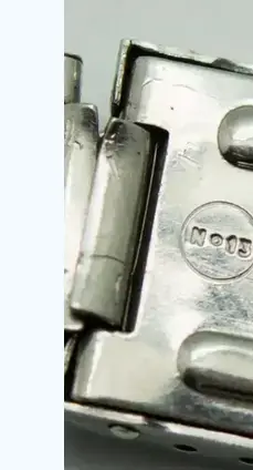

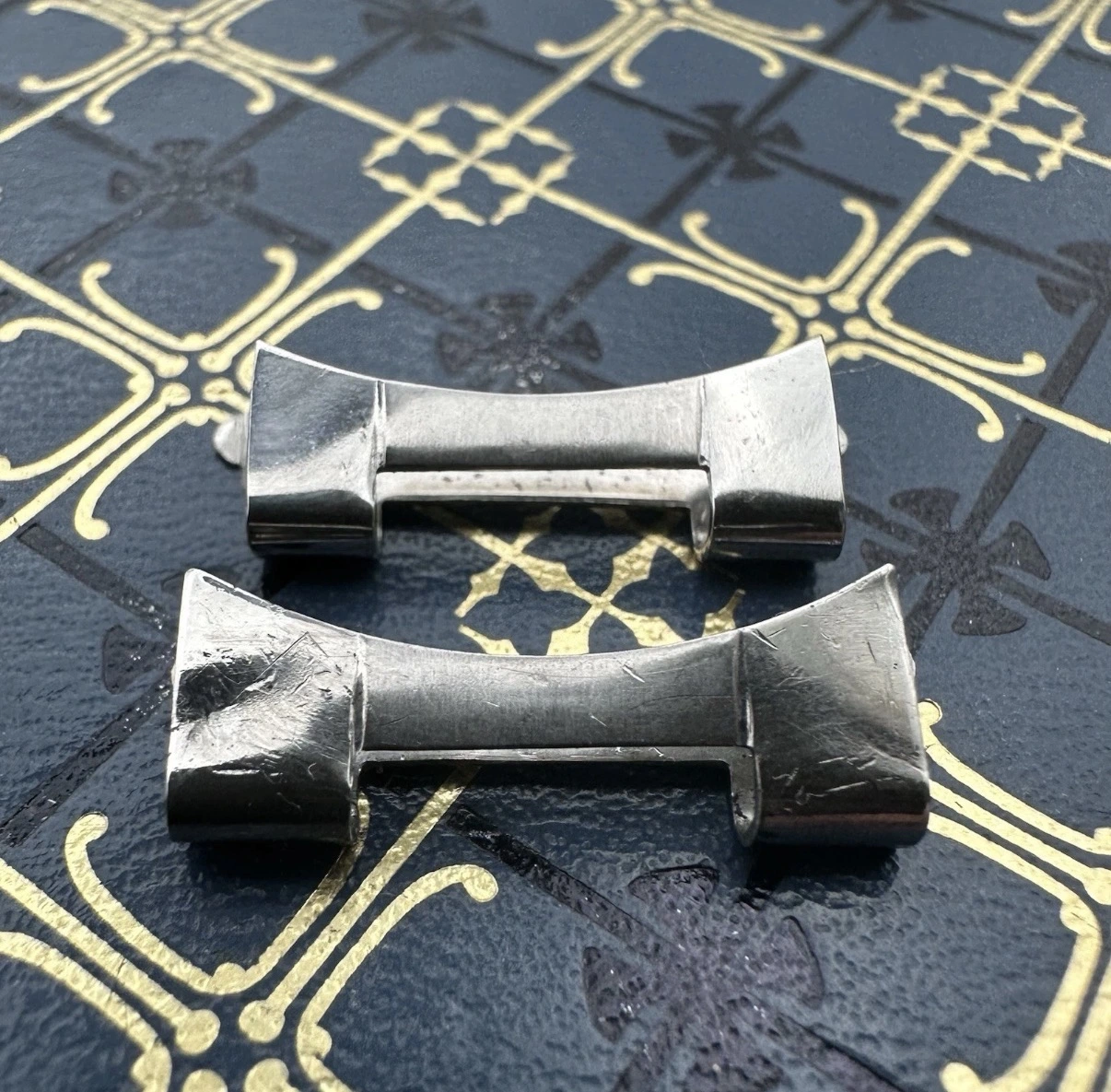

The fixed links are stretched, I would not be surprised if it has been reassamble from different parts, look at this poor bending:
6

Thank you! So it’s shorter. I have to check if it can fit on my wrist anyway. But I read somewhere that to shorter I have to take away the stretching links instead of the folded ones right?
Thank you! Unfortunately I added this pic by mistake, this is jot of the one I’m planning to buy. Sorry. But thank you for the comment, it’s nice to learn something new.
Unless it's cheap (which I don't think after seeing the Omega pad, looks like a watch dealer) I would not buy it at all!
6
Actually is someone selling just omega bracelets on eBay. He has so many that I don’t know how is it possible to have that much. That’s why I had doubts. It’s not cheap.

2150€ for this bracelt is a clear NO from my point of view...

A very nice, full length, unmolested 1039 is sitting on German ebay for weeks, price is lower than 1000€... It has no end links but with some patience you should be able to find a pair of 516...
6
Thanks for the advice. I’ll search for that from Germany. I also found one cheaper but an end link is a little dameged but I could try to fix it.
