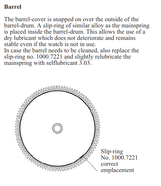

I am currently rebuilding this movement and have a couple questions;
1. Barrel Slip Ring....thin strip of spring metal inside barrel....why is it there? And where does the braking grease go? On barrel wall or inside the slip ring? Or both?

Since some answers given are a mess, I'll hep clarify...
Remove this ring, lubricate the barrel wall with braking grease as normal, and install a new mainspring.

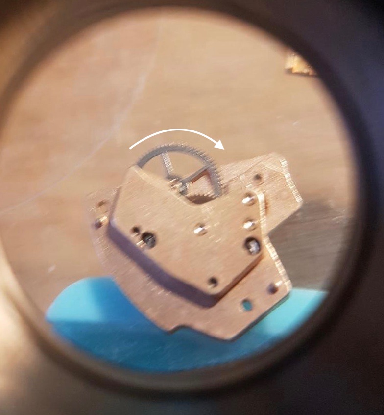

You meant disassembly of the 1464 itself or the auto device? the part no.. when you move the bigger wheel of the auto bloc (when removed) you can esily feel if the movement is not "fluid". if it's not probably a damaged tooth or a bent wheel. NB : the bigger wheel only moves in one direction as it's after the wig wag wheel.
note that there have been to version of the auto bloc. the older is with a brass (1437) wheel, and the other with a steel wheel. If you use a steel wheel the part 1464 needs to be replaced too.
details of the steel post and brass plate, direction of the auto bloc wheel

Archer,
So what you are saying is ditch the slip ring. But what was it's original purpose? And why is it no longer needed?

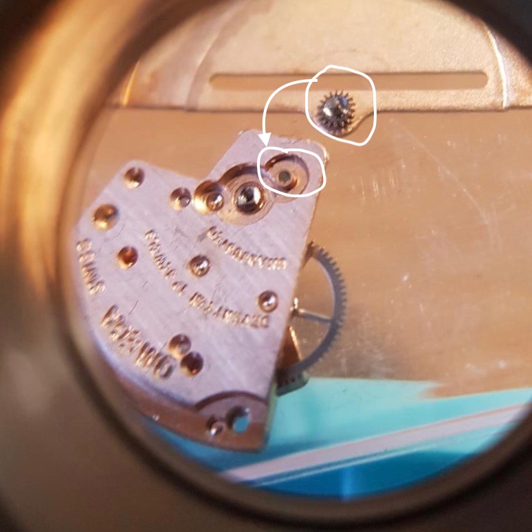

You appear to be showing parts for a 1010/1020 series automatic. These are not the same as the 1002 automatic parts. The axle is in the bridge on the 1002, not on the rotor as in your photos.

The original purpose was outlined in the documentation above that someone posted from the tech guide. The slip ring is not needed - you can keep it if you wish or follow my instructions - it's up to you.
