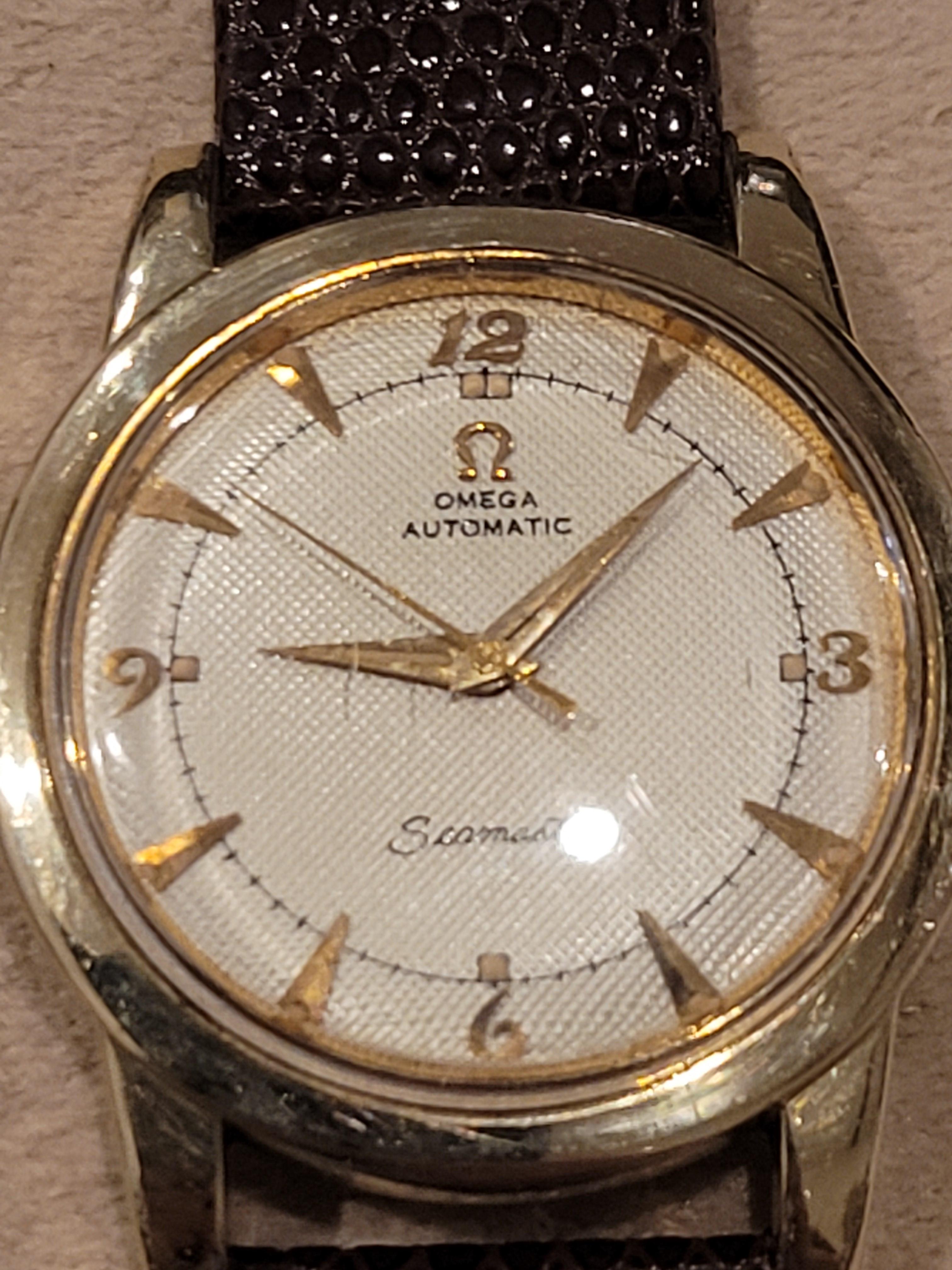

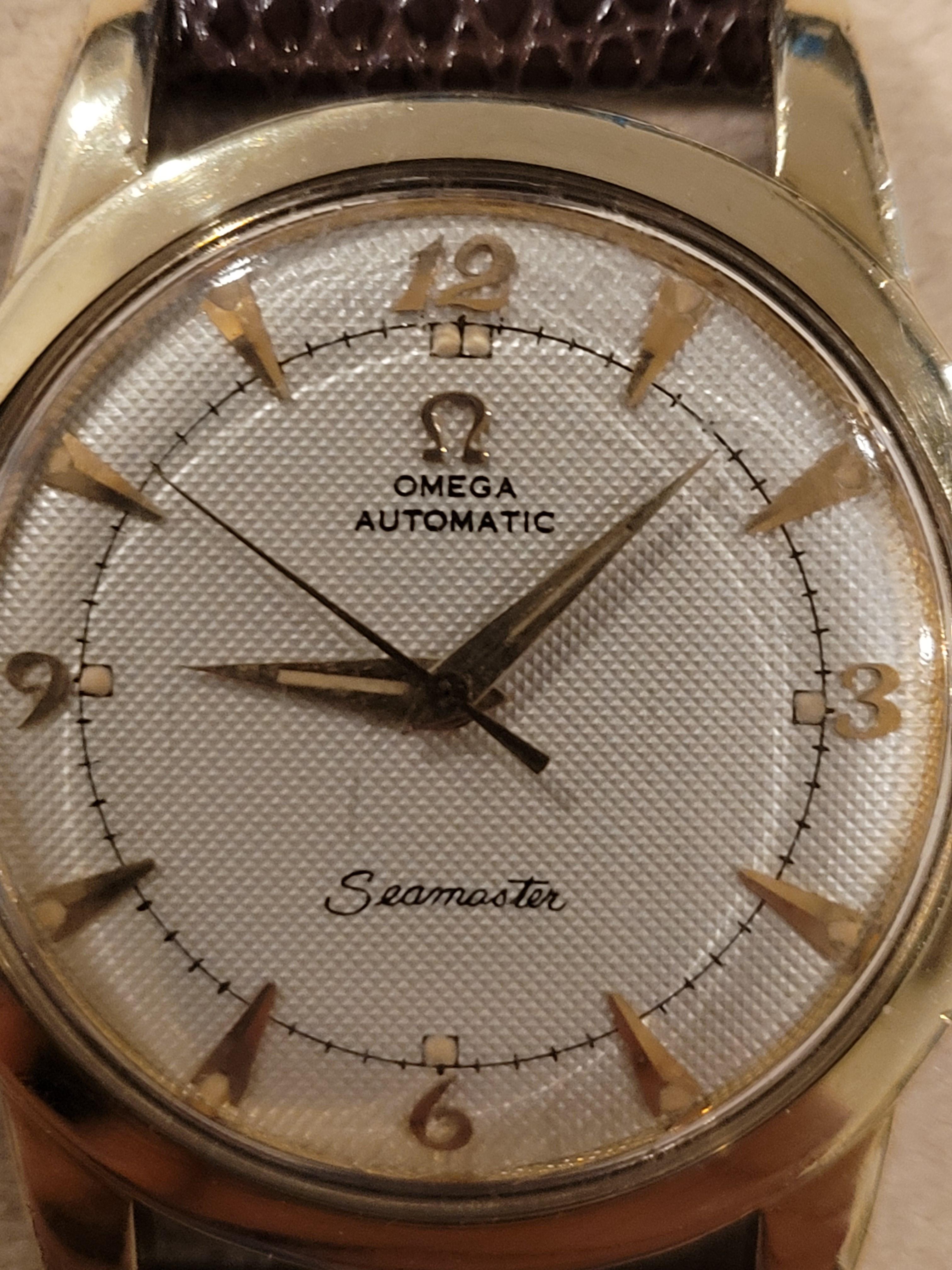

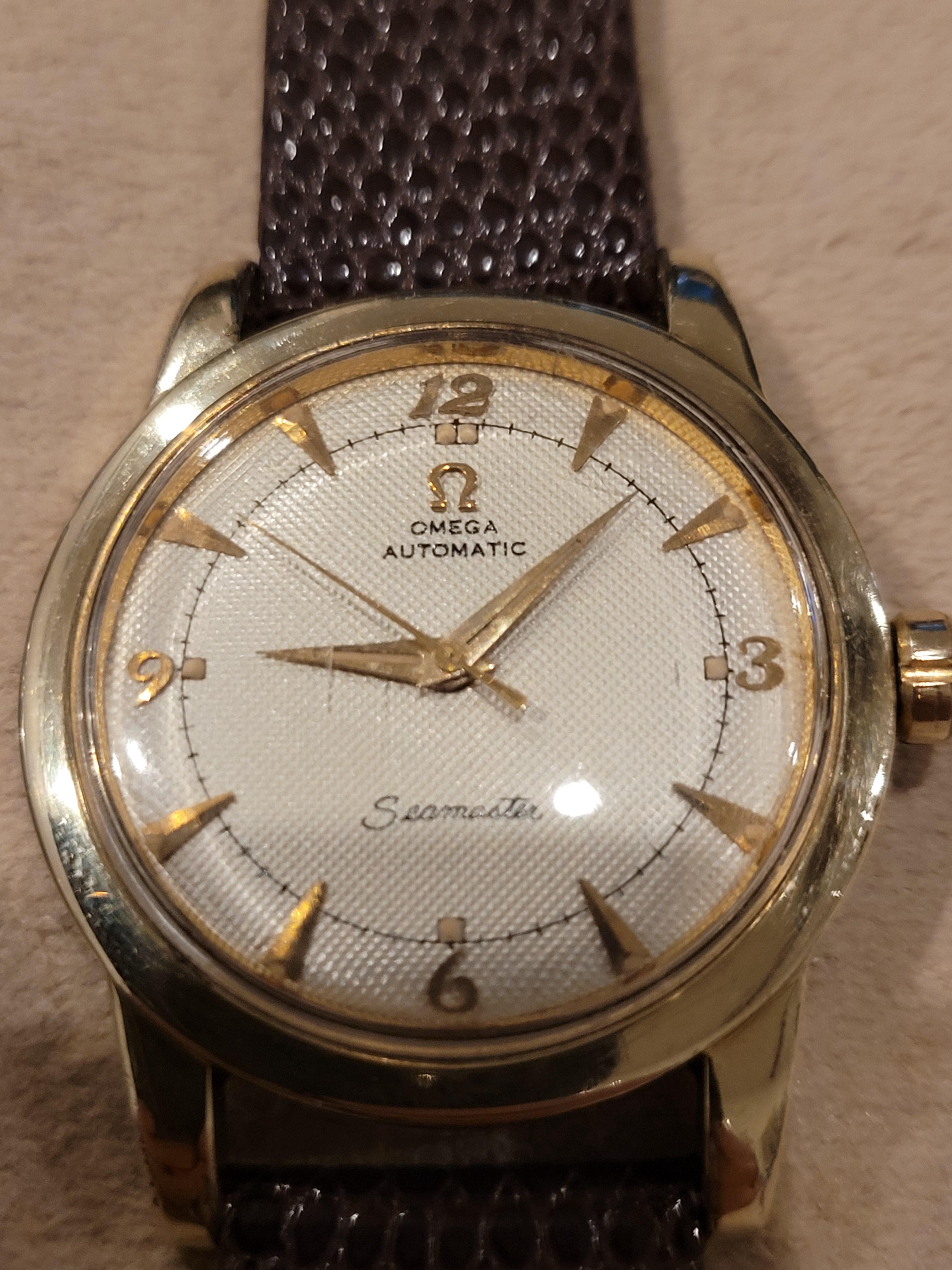

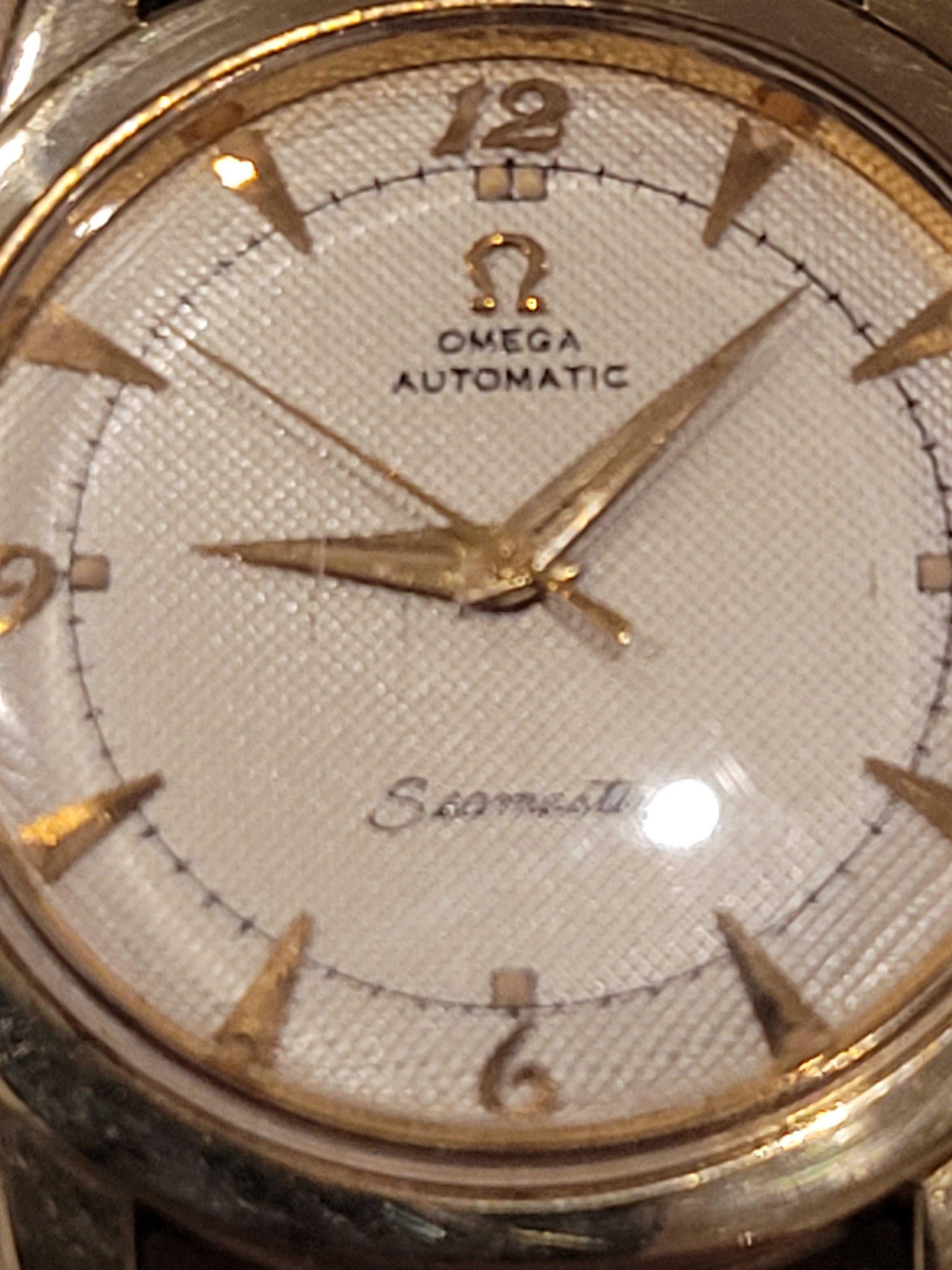

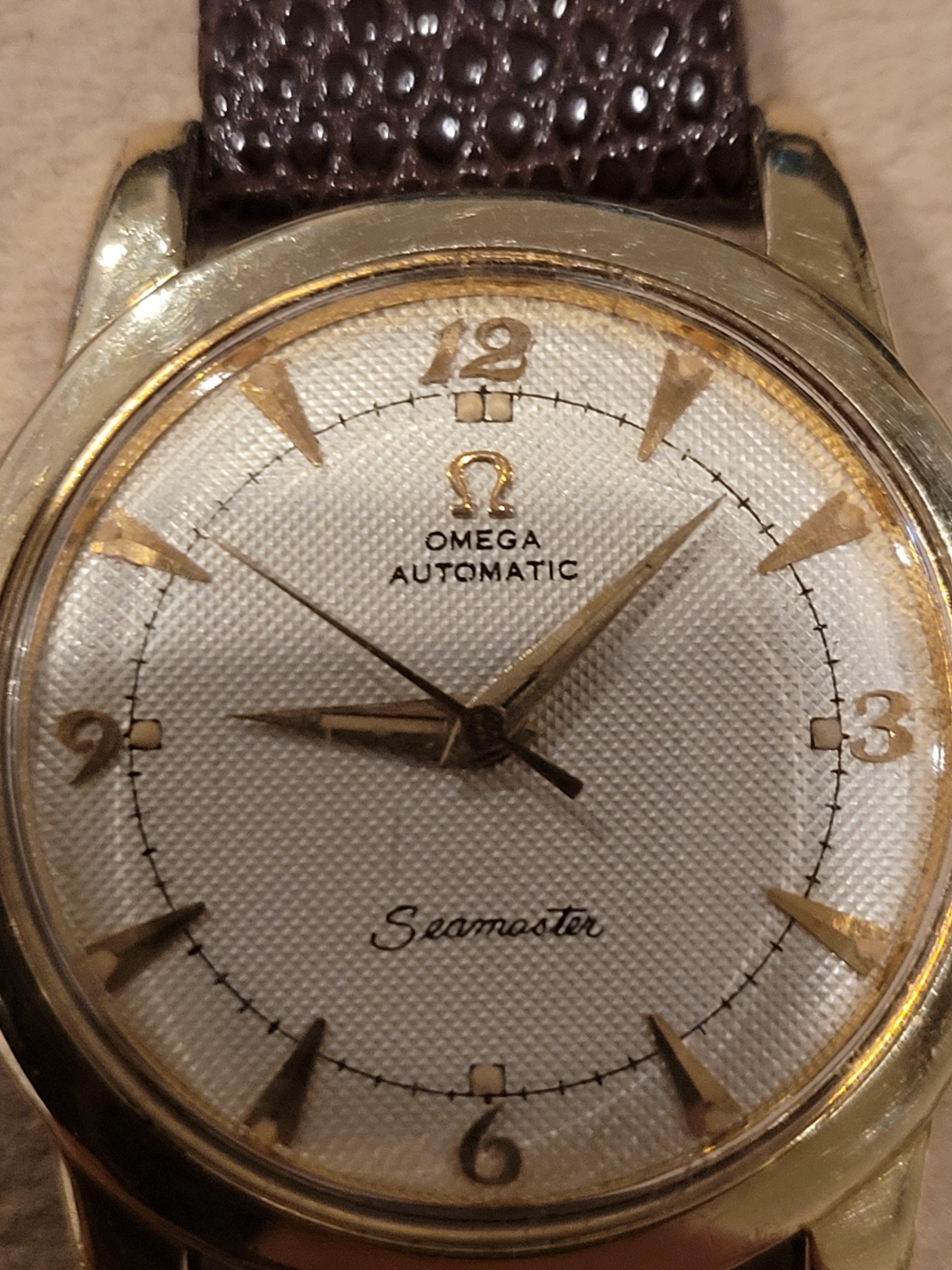

Hello all,

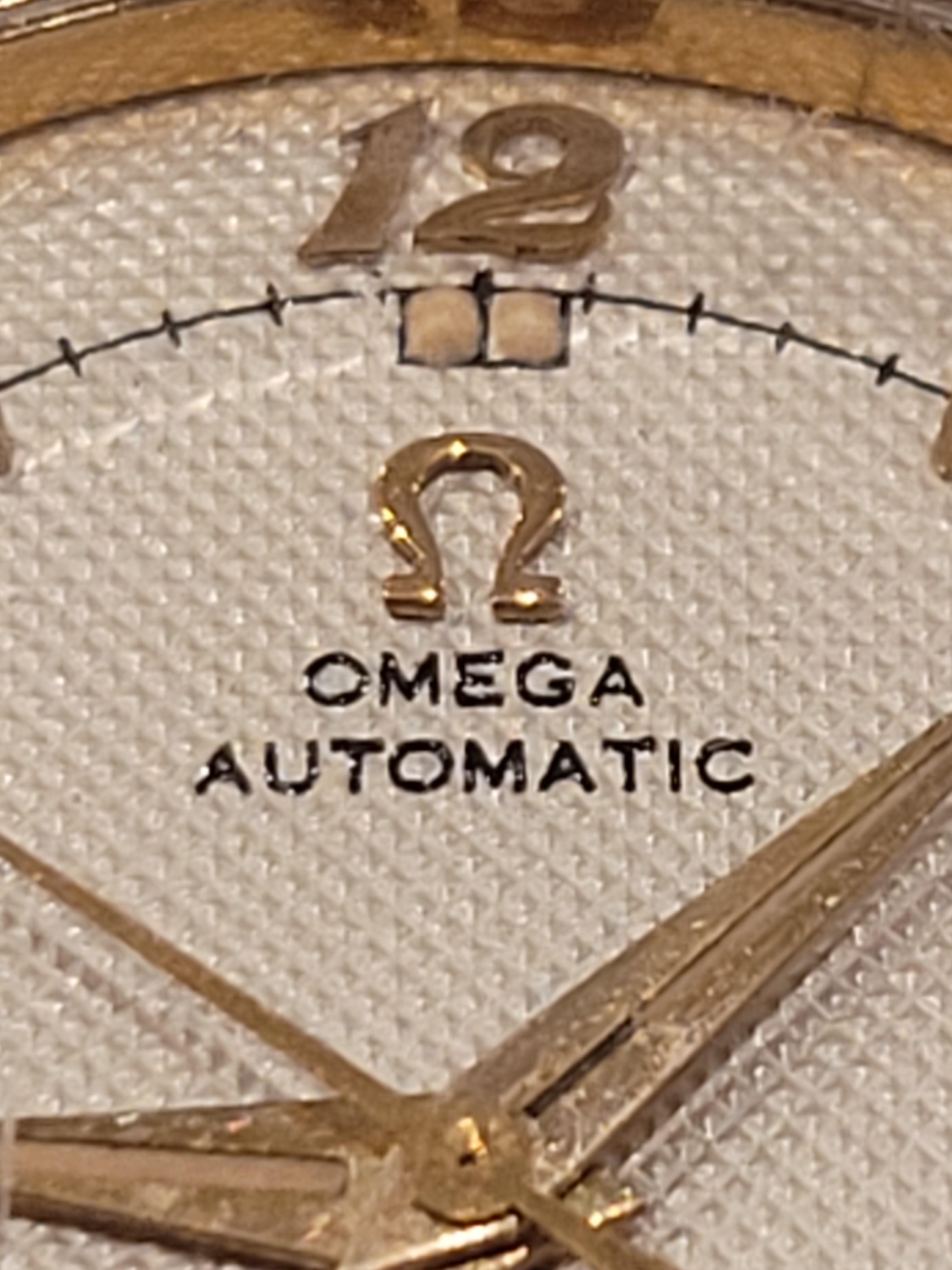

I bought this seemingly lovely gold capped waffle dial that was described as 100% all original, but the dial printing seems a bit suspicious to me, especially when compared to my other very similar watches. To me, the printing seems a bit thick and the text of omega looks a bit weird. There are also some minute markers that seem a bit thicker to me, 30-35 minute markers
Itll be a shame if it indeed a redial, because the lume is absolutely beautiful on it.

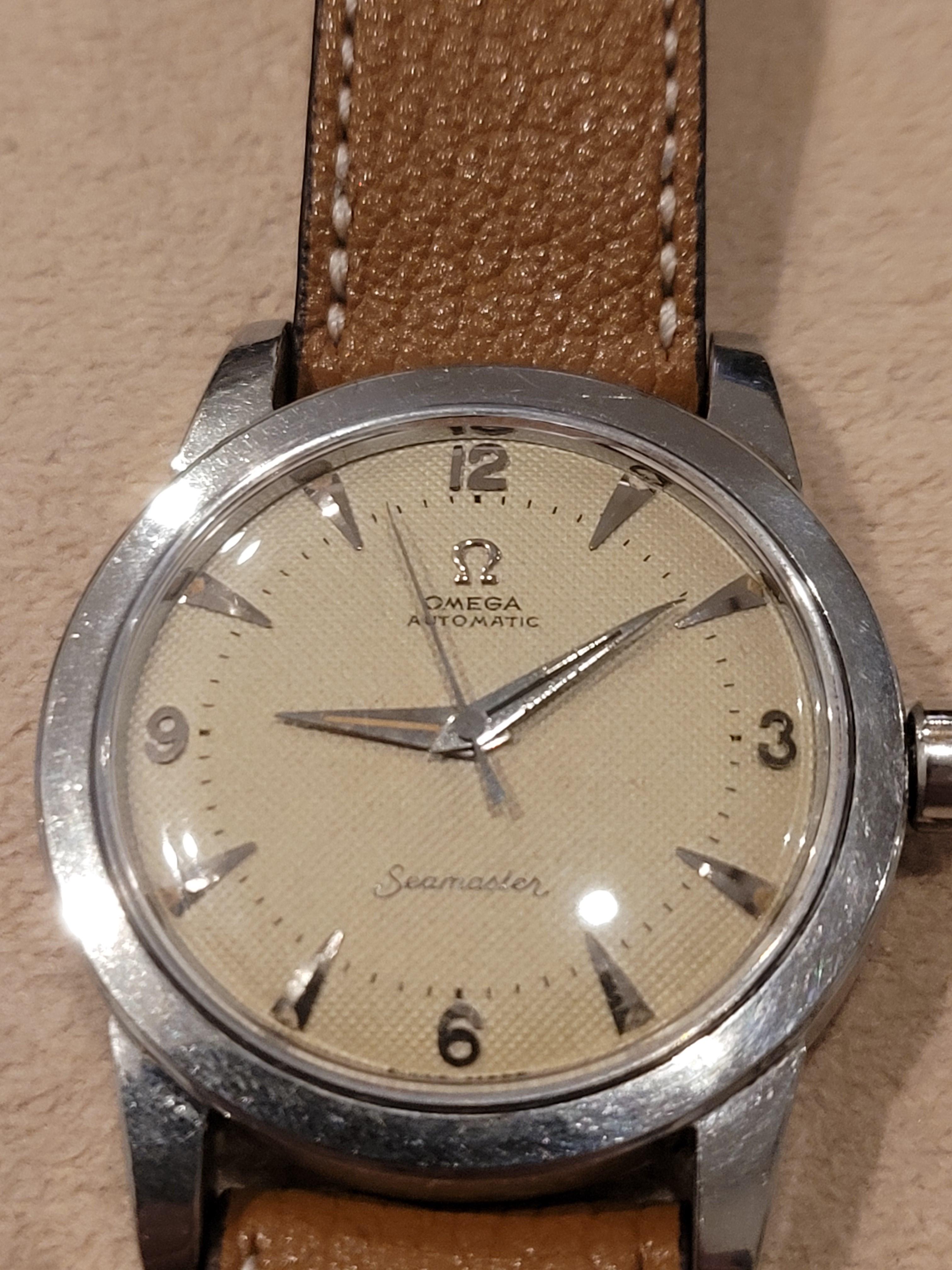

The last photo is my 100% all original not redialed waffle seamaster for comparison.
1,024
4,126
Oh. Don’t buy more watches from this seller.😉
