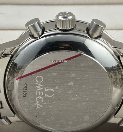

    So I found a very interesting older Omega to me from a dealer on chrono24 that said they got a it from an authorized dealer. He He described the the watch as "Watch is new, never worn with tags but has a new ( not original for this age )
    omega warranty card with date 2016 and 2 years warranty and omega box".
    Is having a non original warranty card "for this age" a weird thing? Should I be concerned with the watch's authenticity?Am I being scammed?

    It's absolutely impossible to answer your questions with the (lack of) information provided. Pictures would help, of the watch and the warranty card. Ideally a pic of the watch that shows the serial number so you can verify it matches the card. Is the card stamped with an AD identification? etc.

    Ok...well the serial number on the warranty card is not able to be seen. The closeup of the serial number on the watch is not complete so I'm assuming it is photoshopped out? The blurry picture shoes the serial number that is blurry but seems longer to me. I am sorry I didn't post pictures originally, I guess I was just thinking about the practice of a "Watch is new, never worn with tags but has a new ( not original for this age ) omega warranty card "

    Walk away. The card and watch don't match.

    match in what way? the photos don't show a full number.

    The in-focus pic shows six digits, so missing two.
    The sixth digit on the watch is 3, the sixth digit on the card is zero.

    Good detective work .

    Thank you. I didn't notice that.
