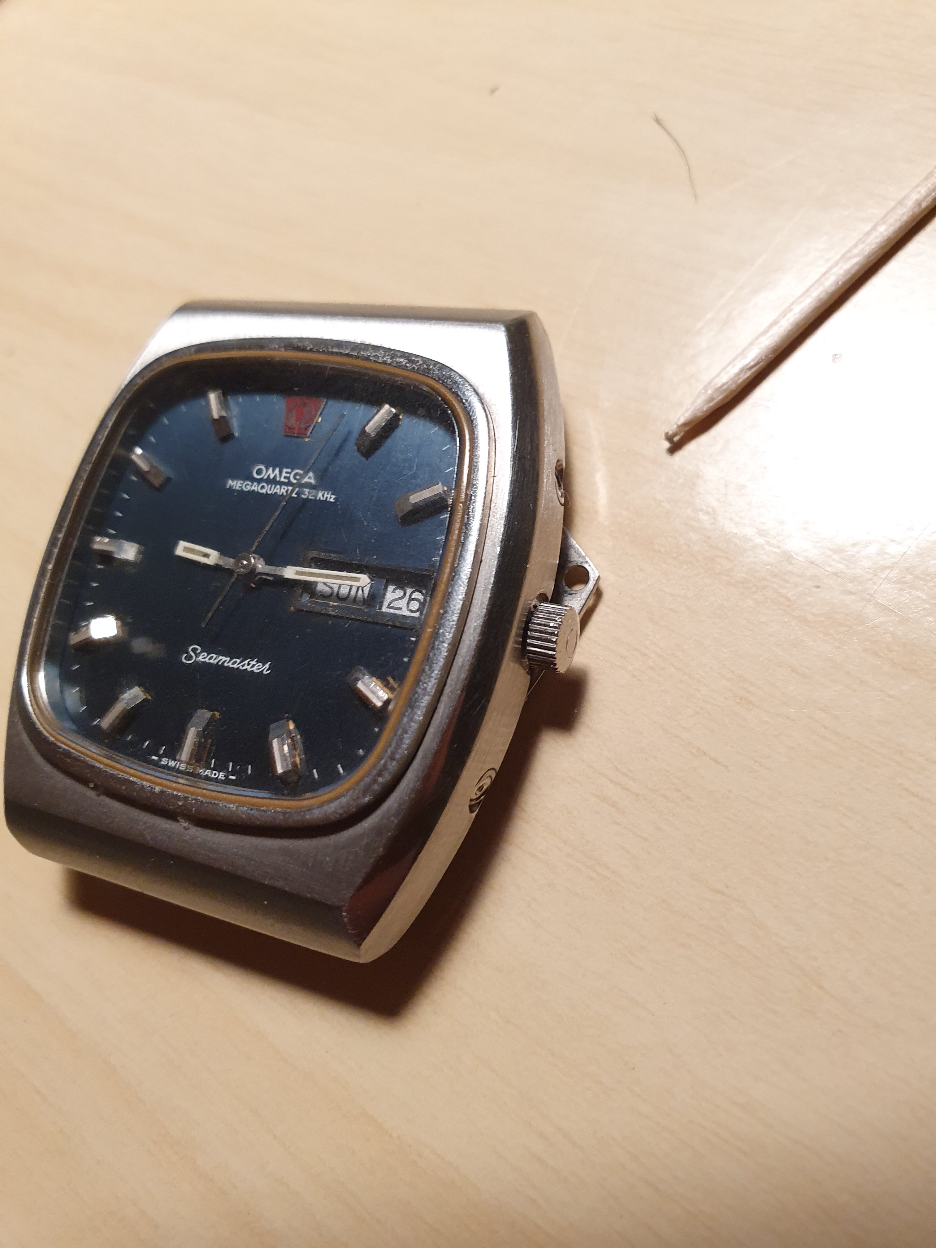

Posts 98 Likes 22 ukchrono ·Dec 26, 2021 there is an example of electronic Omega bottom pusher change the date the top pusher might not work on my watch want to ask if anybody knows what is for?
Posts 2 Likes 9 _Maxim_ ·Dec 26, 2021 Hello, it is a caliber 1310, the top pusher hacks the second hand for precise time setting.
Posts 121 Likes 70 AtomicGrog ·Dec 26, 2021 [edit opps i was too slow] The other I believe is a seconds hack, it lets you stall the seconds to allow accurate time syncronisation.
Posts 98 Likes 22 ukchrono ·Dec 26, 2021 funny thing is when you set the time the second hacks by itself so is pointless

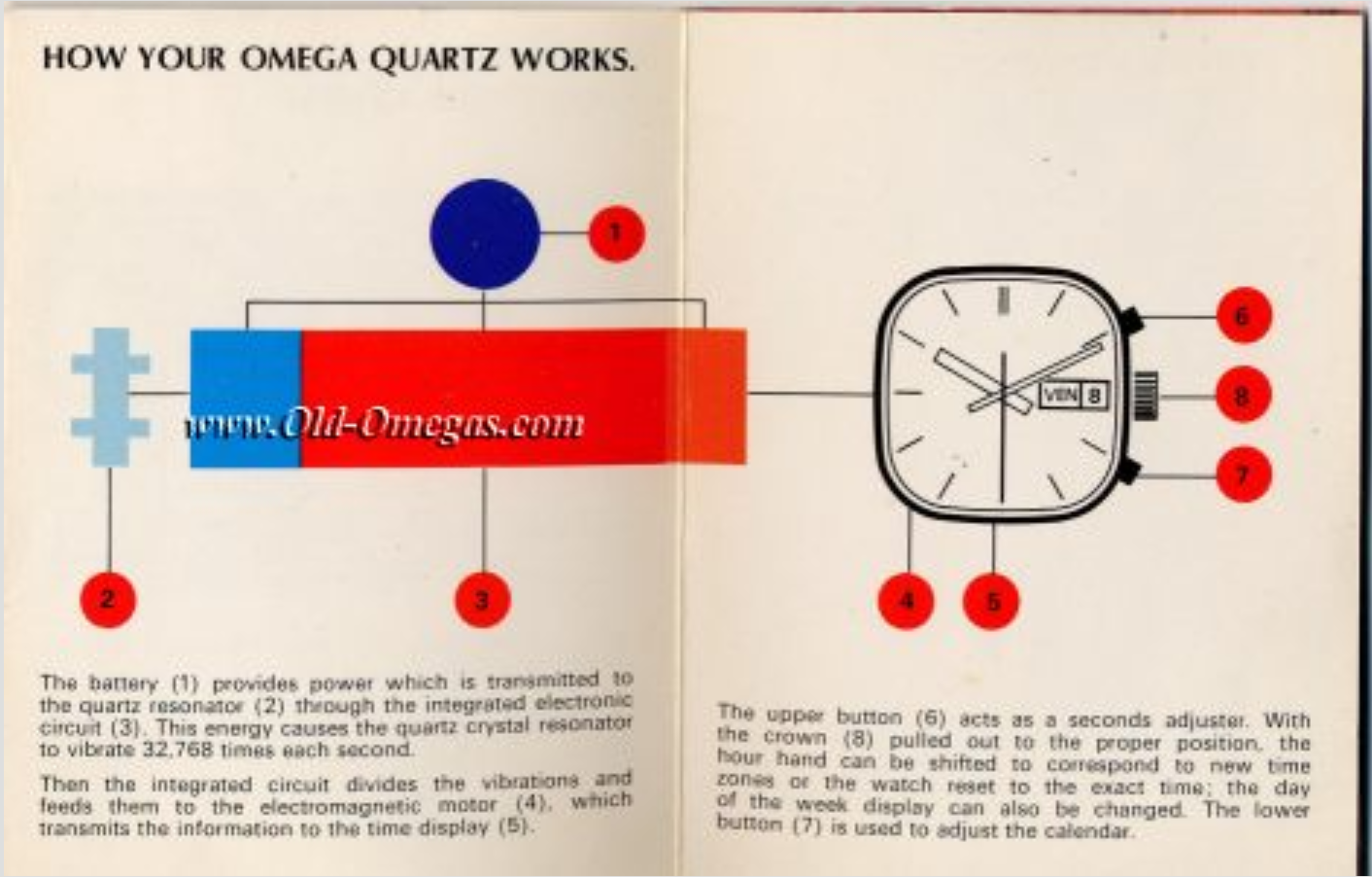

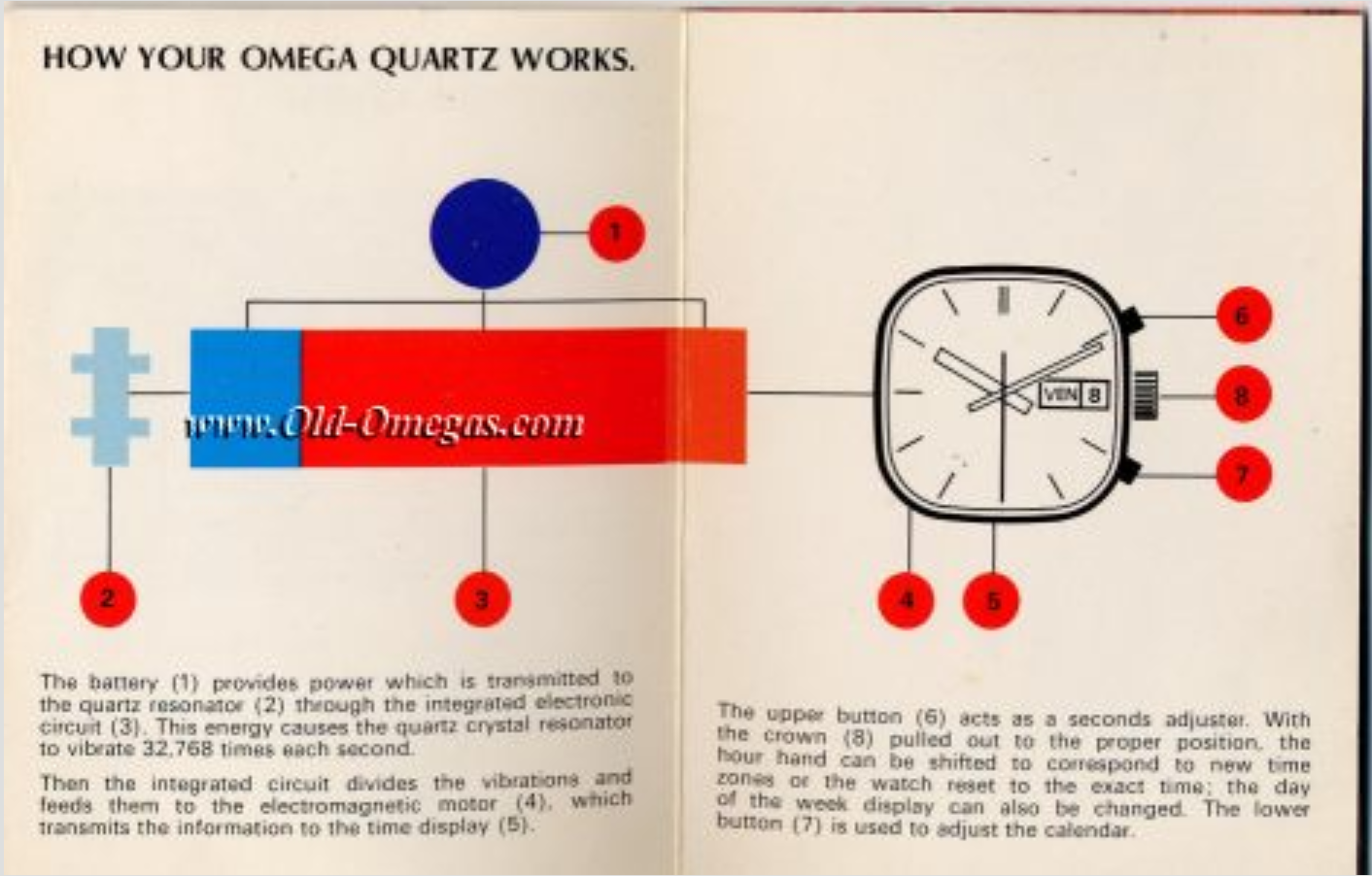

Posts 453 Likes 682 Wuza72 ·Dec 26, 2021 This should help Link: An English Omega Owners Manual for a 1310 movement (old-omegas.com) And a fast screenshot Best Wuza
